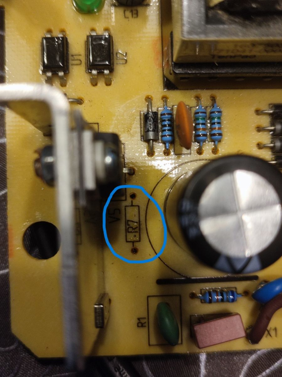

    I'm looking for the electronic diagram for Bosch charger 1830 CV
    It no longer charges
    I would particularly like to know the specifications of this resistor R7 which is HS
    Thanks for your help
    Section of a PCB with various electronic components and an unpopulated spot for resistor R7 marked in blue.

    Hi

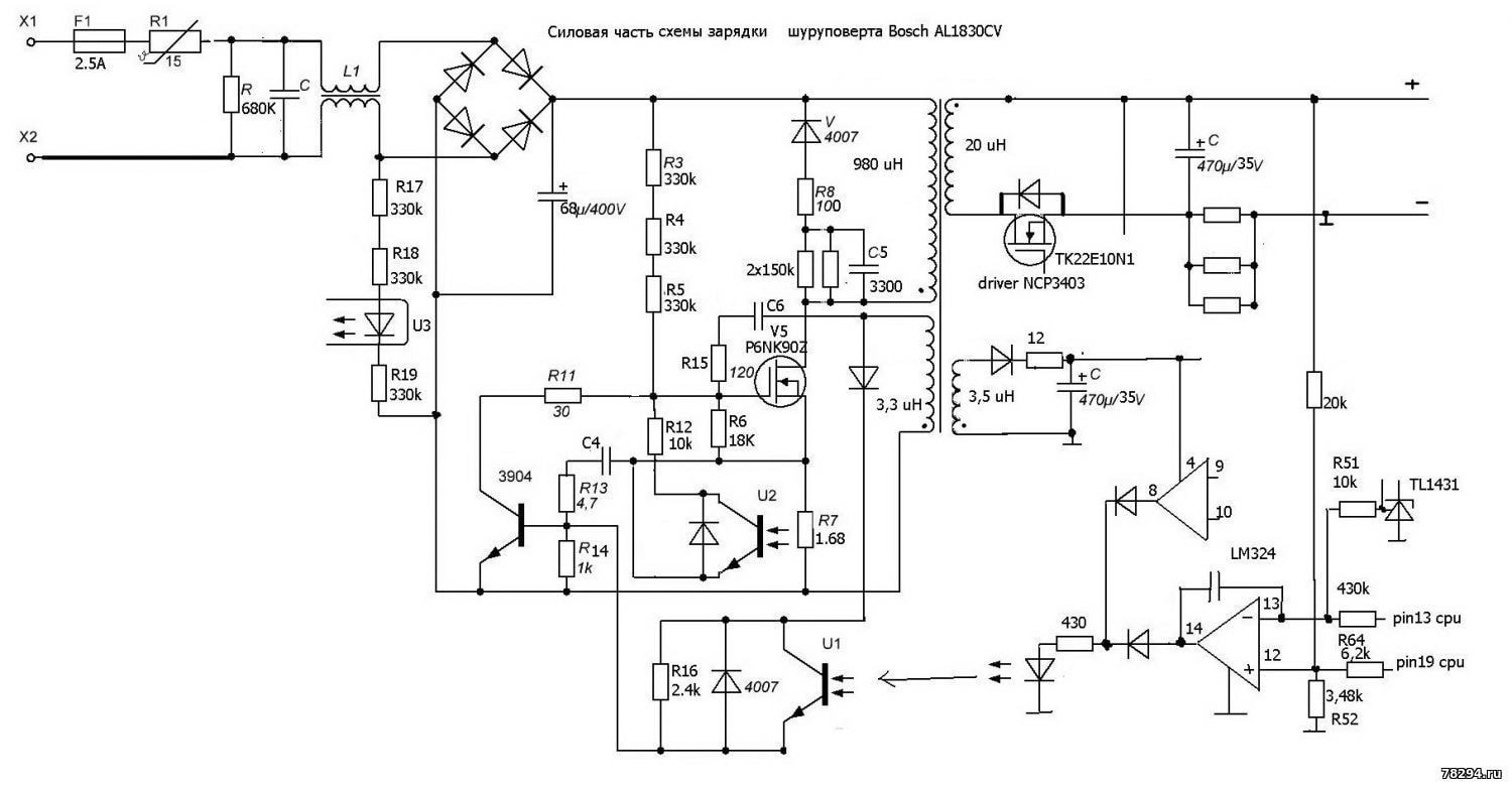

    R7 = 1.68Ω
    I only have a fragment of the diagram from Link
    • Bosch 1830 CV Charger Schematic and R7 Resistor Specifications Needed AL1830CV.jpg (102.18 KB) You must be logged in to download this attachment.

    jpclerc
    Thanks a lot
    I will try to change it
    R7 current-sense resistor and related fault checks
    #4 21571900
    George54351
    Posts: 7
