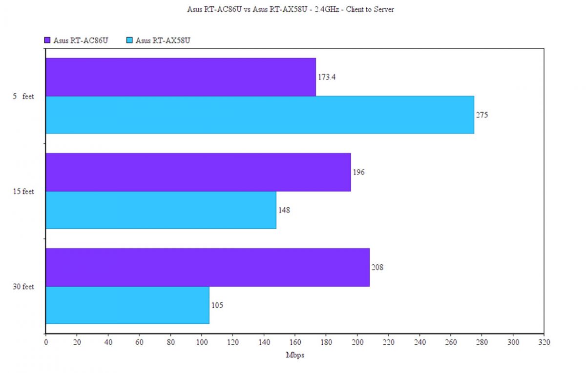

    _cheetah_ wrote:
    Looking at wifi, I would take 55 due to the number of antennas that give more freedom in creating coverage, as long as they are movable. Other than that, they look identical on wifi. However, which in reality will give greater ranges, it is impossible to predict.
    Watching the ax56u and ax55 tests, ax56 usually has better performance and range, but also ax55 was better in some, I don't know what could be the reason. The only difference is that the ax56u has 256 MB Flash, 512 MB RAM, usb ports and only two antennas, but in some tests it has better range.
    In tests, the ax55 had unstable wireless performance in the 2.4 GHz network, while others write that the ax55 has better performance than the ax56u, so I don't know what will be better for me. I am currently using an old wr340g with one antenna and have coverage throughout the house.

    _cheetah_ wrote:
    Sorry, what do you see???
    In the ax58u and ac86u tests I saw. The Asus ac86u had better wireless performance, but still the ax58u fared pretty well against it.
    In the ax58u and ac86u tests I saw. The Asus ac86u had better wireless performance, but the ax58u still fared pretty well against it.

    _cheetah_ wrote:

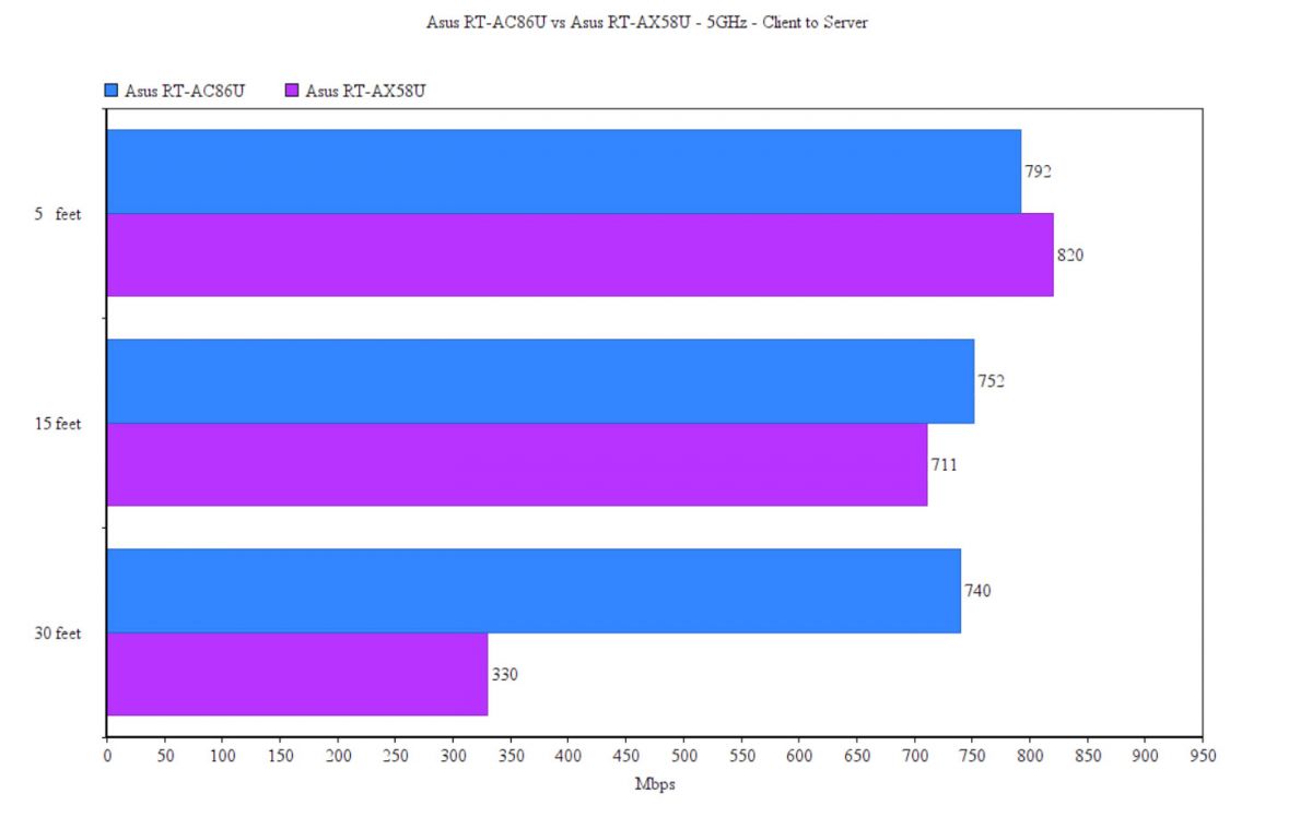

    By the way - ac86u seems to support DFS channels, which in blocks is sometimes decisive due to the crowd of neighboring networks.
    Yes, DFS has ac86u and ax58u. Ax55 and ax56u do not have.
    In the ac86u and ax58u tests of the ax58's wireless performance at 30ft, the speed dropped significantly.
    And is it true if, for example, my devices support the WiFi 802.11ac standard, even if I change the router to WiFi 6, my devices will work more stably than with the WiFi 5 router? Reading various tests, they often mention it.

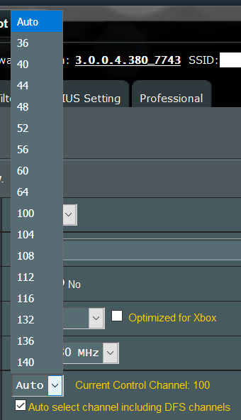

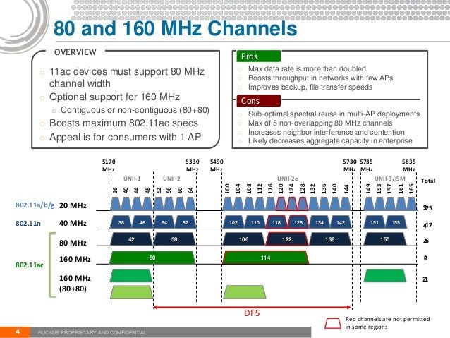

    szymonit928
    Posts: 47
    _cheetah_ wrote:
    And do you have somewhere written what channel range exactly?
    I can't find anything in detail about DFS in this model, on some forum someone added a picture of ac86u
    Which router to choose: Asus AX55 or AX56U?
    _cheetah_ wrote:
    From a practical point of view - if the router does not get satisfactory results at a given distance and obstacles, it simply indicates that an additional AP is needed.
    So it turns out that if you buy a cheaper one, e.g. ax55, you will have to buy another ax55 or ax56u for AiMesh sooner or later, or maybe it's better to buy a more expensive ac86u or ax58u right away
    And how long would ac86u be enough for me? will it not be too old, generally the router from 2017. WiFi 5 is no longer future-proof.

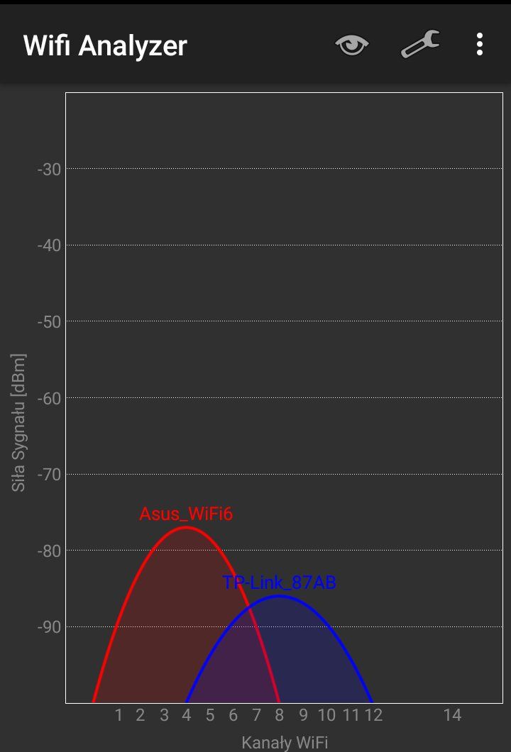

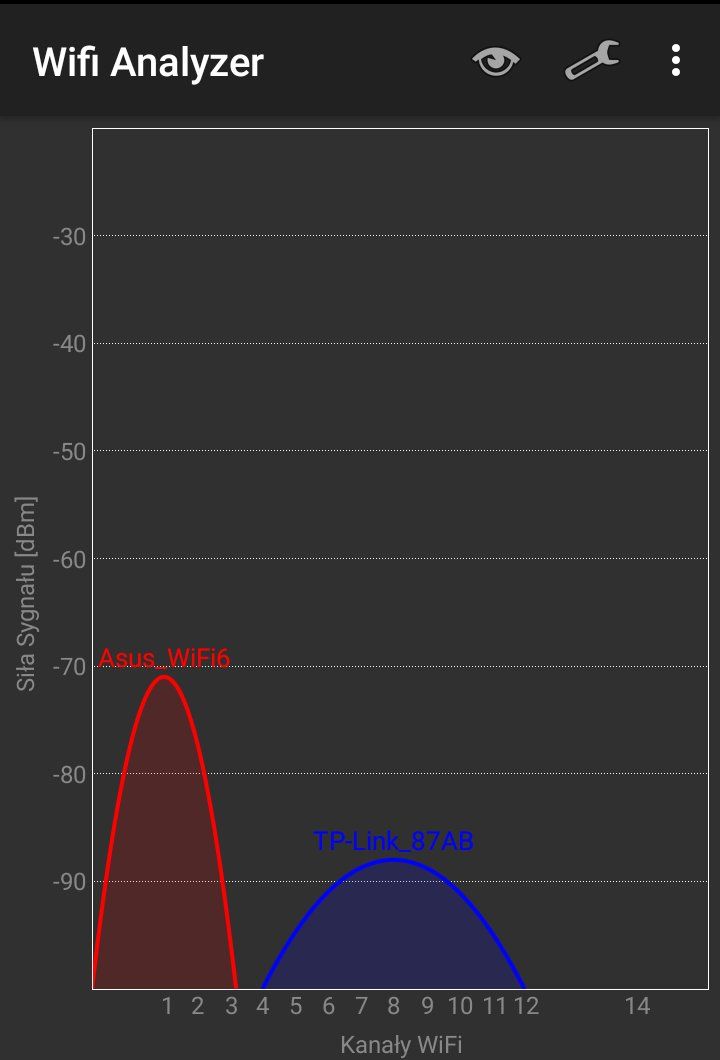

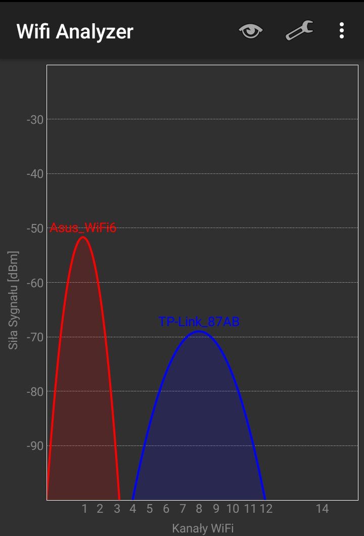

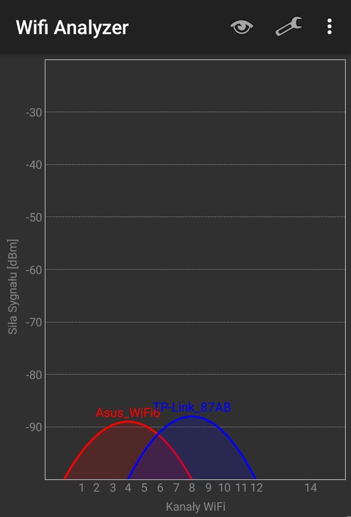

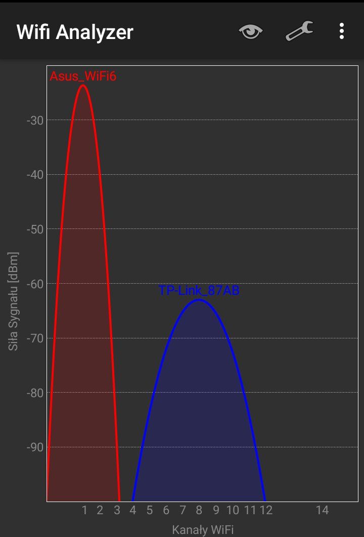

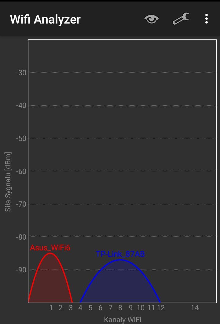

    szymonit928
    Posts: 47
    _cheetah_ wrote:
    And how about interference after wifi, i.e. with neighborhood networks?
    If you haven't done wifi diagnostics - do --> https://www.elektroda.pl/rtvforum/topic3158772.html
    Preferably InSSIDer (Win), possibly Wifi Analyzer (Android).
    One measurement DIRECTLY at the router
    Subsequent measurements in typical places where mobiles are used.
    And post the screen accordingly: https://obrazki.elektroda.pl/4257484200_1454694642.png / https://obrazki.elektroda.pl/9695492800_1454695020.png
    ATTENTION : When using a laptop or smartphone, you need to orient it spatially (rotate) at each measurement point so that you always have the maximum signal at the measurement point. This is very important, because by changing the orientation of the phone or laptop in relation to the direction of the router / AP, the differences in signal measurement can be VERY large.
    If the 5GHz band is empty - it could be ax55, and if it's clogged - ac86 with DFX could be better.

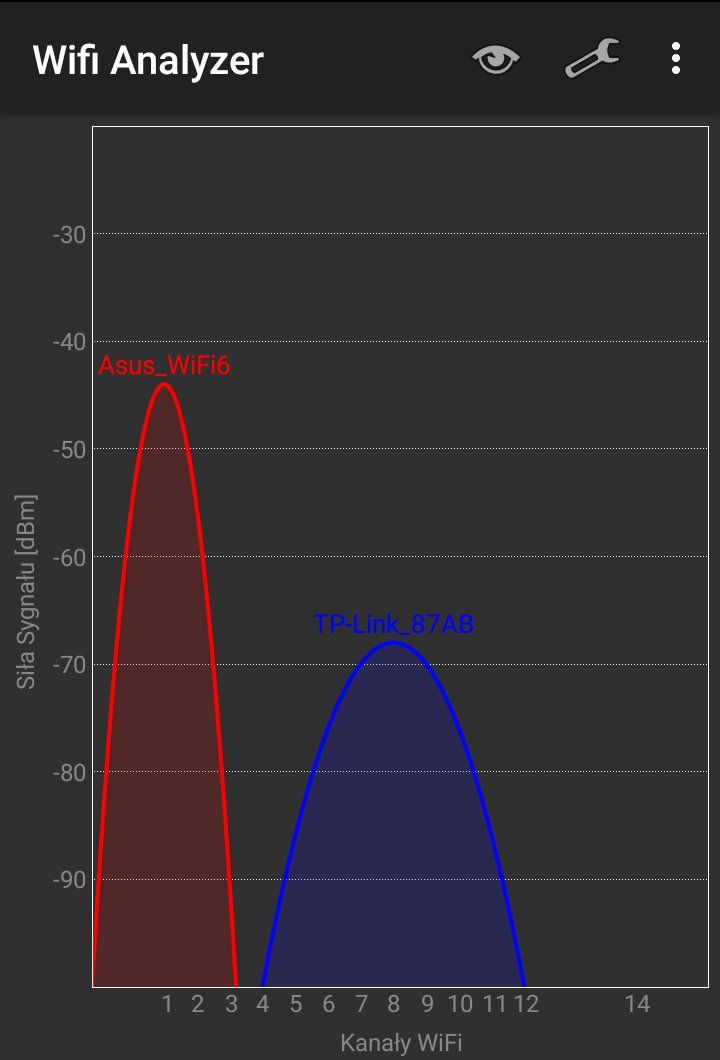

    I did the diagnostics as you wrote, only WiFi Analyzer in places where I sit most often. Behind the second wall, the signal jumps so much that it's hard to even take a screenshot with the best result. I did the diagnostics first with auto settings, and then changed the channels and channel band, so I chose the photos with the best signal.
    Directly at the router, 1 meter from the router and in a room where the router:
    Which router to choose: Asus AX55 or AX56U? Which router to choose: Asus AX55 or AX56U? Which router to choose: Asus AX55 or AX56U?

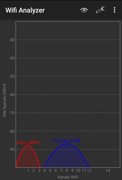

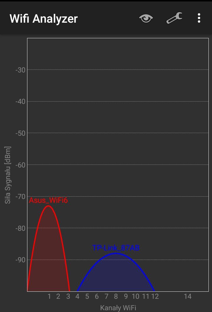

    Behind the first wall:
    Behind the second wall:
    Behind the third wall:
  • #28 19507264
    Interesant
    Posts: 2176
    Help: 204
    Rate: 249
    In the TP link, if it is yours, you have something mixed up, because in the "G" standard it sets up the connection and move it from 6+10 to 9+13 (40MHz).
    Then set Asus to channel 3.

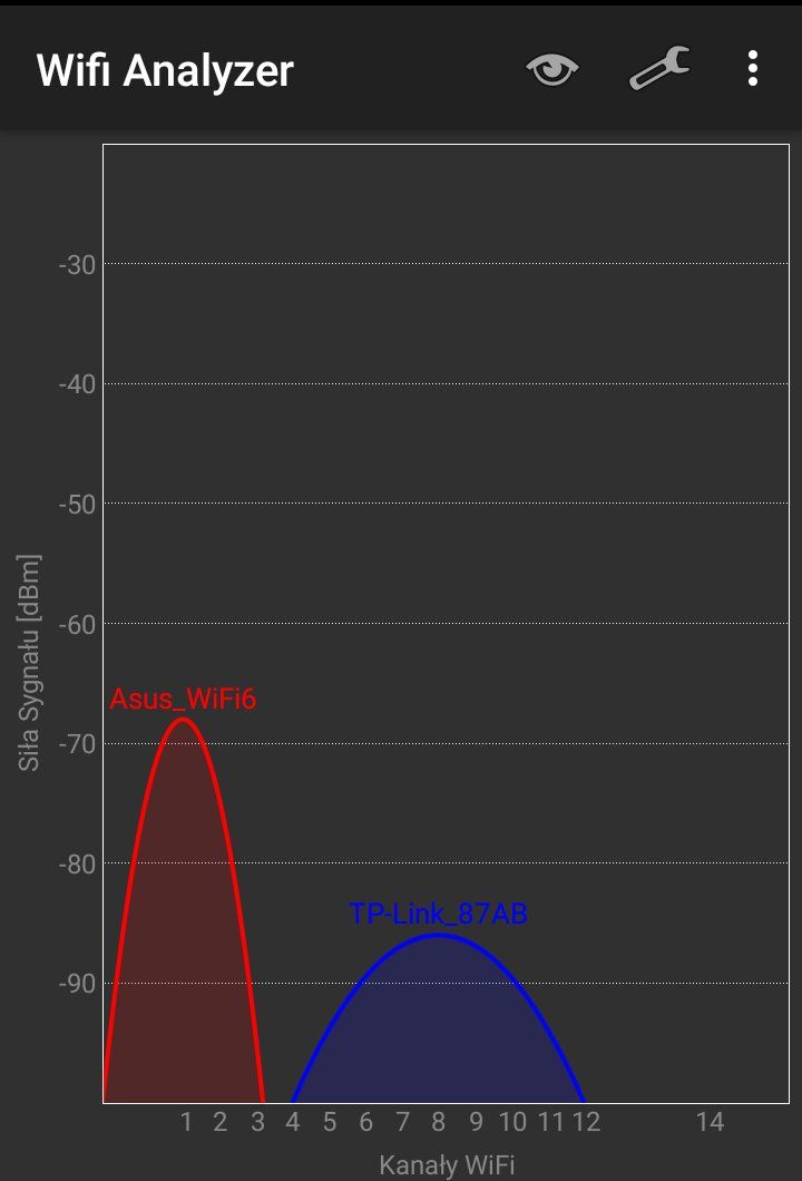

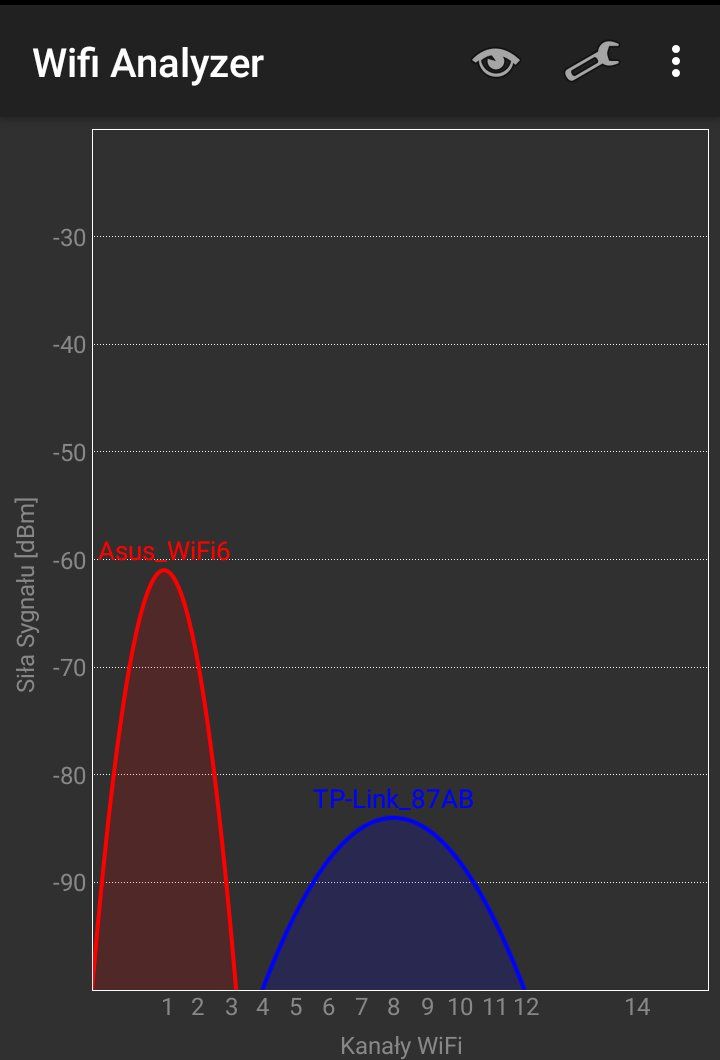

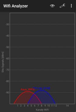

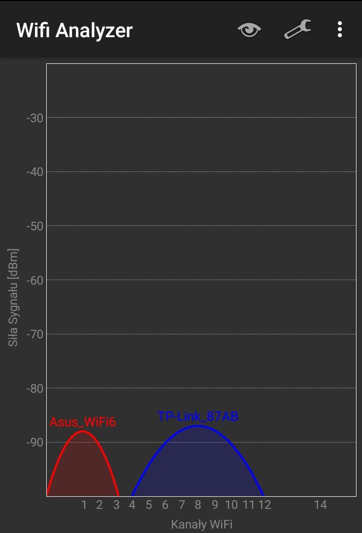

    Interesant wrote:
    In the TP link, if it is yours, you have something mixed up, because in the "G" standard it sets up the connection and move it from 6 10 to 9 13 (40MHz).
    TP-Link is not mine, but a neighbor's.
    I checked on all channels, I also changed the channel band, but I chose the photos with the best signal
  • 5 GHz measurements needed; mesh likely too weak
