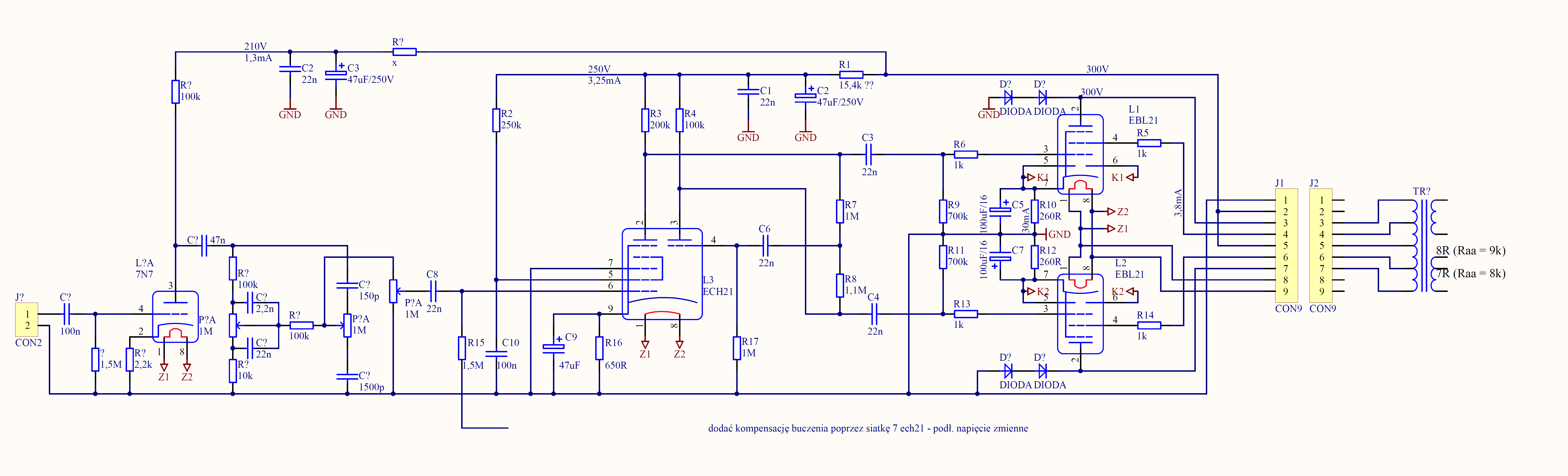

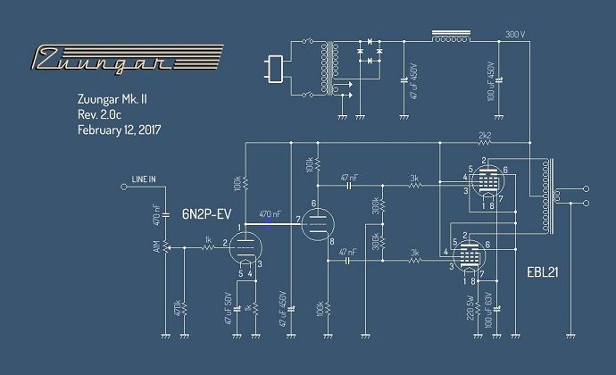

    Dear colleagues,
    I'm not Polish but I'm as passionate about electronics as you are. Because I received several EBL21 tubes, I'm looking for a schematic (or links) for a tube amplifier with EBL21 used in Push-Pull mode. I have searched on the internet but I didn't find, only SE mode.
    If you can help me with a link or information I will appreciate it.
    Thank you in advance!

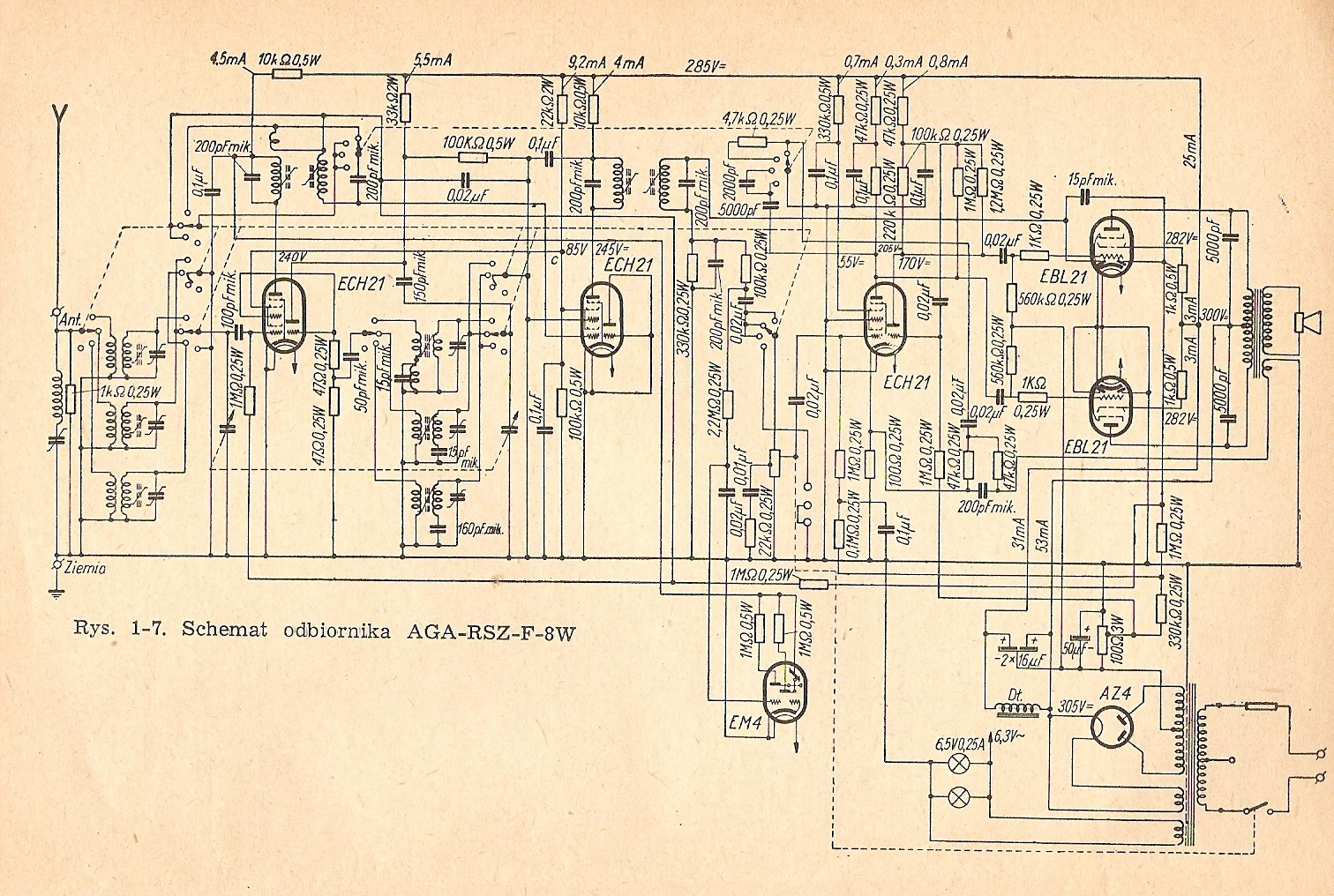

    Radio AGA Special Version for many Speakers line.
    • EBL21 Push-Pull Tube Amplifier: Schematics, Links, and Information for EBL21 Tubes AGA RSZ-F-8W.png (2.53 MB) You must be logged in to download this attachment.
  • #4 19611601
    22euu
    Thank you for the link. Do you have the specifications about output transformer? It must have been manufactured.

    22euu wrote:
    Do you have the specifications about output tranformer? I
    Unfortunately. I do not have the parameters of this transformer. And we are unlikely to find them. There were few copies of this radio receiver. One, maybe the only one, has my friend. I revived him. Works.

    The EBL21 lamp has very similar parameters to the 6V6 lamp. It can easily work with PP Ra = 9kohm and Ra = 10kohm transformers.
    For less excessive applications it seems possible to use PP transformers dedicated to EL84 / 6AQ5 with Ra = 8kohm.

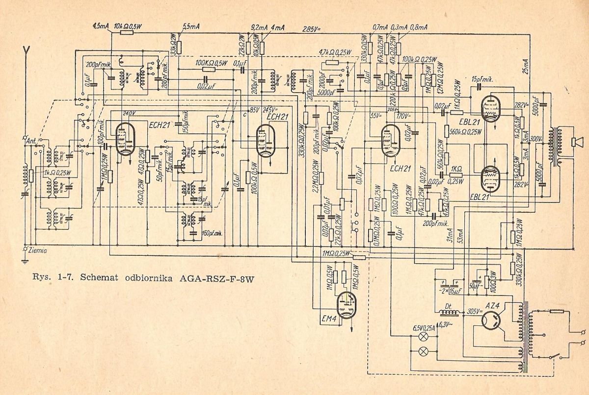

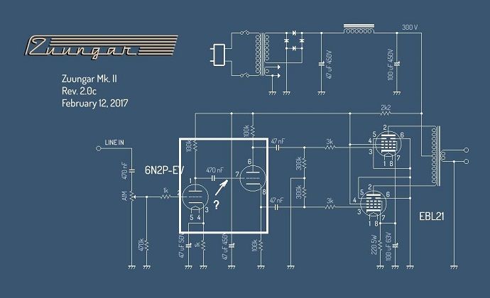

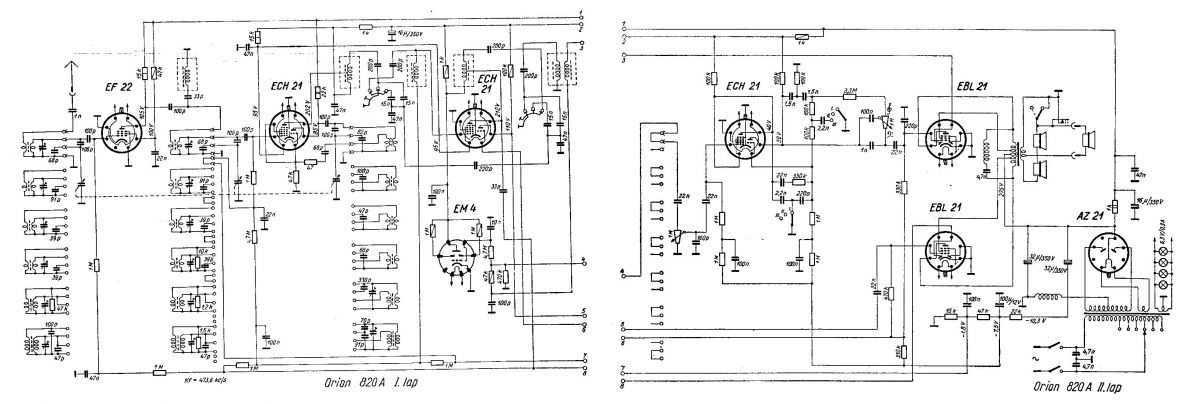

    The diagram in # 5 lacks the grid polarity in the phase inverter (pin 7).
    And you are convinced that in this system it is needed, compare a similar system https://frank.pocnet.net/sheets/046/e/ECH21.pdf, diagram on page 18. Regards.
    Well, the net cannot "hang in the air". There must be a resistor in the grid.

    jozgo wrote:
    After all, it is between the grid and the ground with a value of zero ohms. I can assure you that there is no error in the schematic, it will work as is.

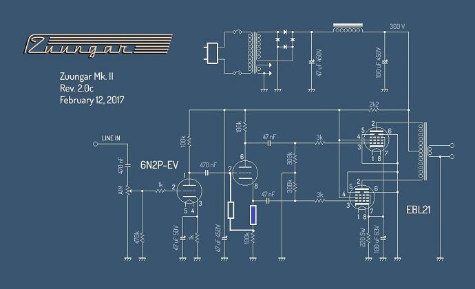

    cirrostrato wrote:
    between the grid and ground of zero ohms.
    Well, it is not. It is infinite.
    In this arrangement, the mesh should be a little (1 - 2 volts) below 1/2 ua.
    So a divisor of e.g. 1 M +10 k / 1M between Ua and mass.
    Then the grid will be approx. (-) 1.5 V to the cathode and will not 'float'.

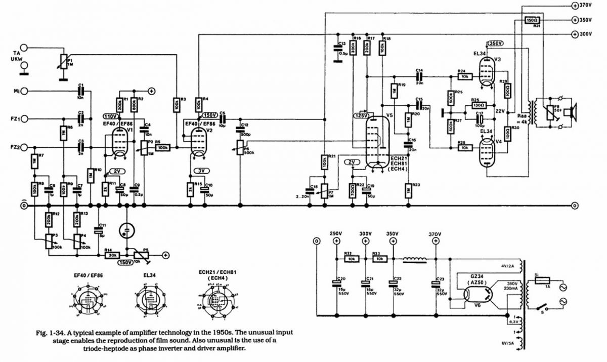

    Rate: 3002
    2 classic variants of this type of phase inverter circuit. EBL21 Push-Pull Tube Amplifier: Schematics, Links, and Information for EBL21 Tubes EBL21 Push-Pull Tube Amplifier: Schematics, Links, and Information for EBL21 Tubes EBL21 Push-Pull Tube Amplifier: Schematics, Links, and Information for EBL21 Tubes

    jozgo wrote:
    We are talking about the same mesh (pin7) of the heptode part of ECH21 in the last photo?

    jozgo wrote:
    cirrostrato wrote:
    you are convinced that it is needed in this system,
    I think you are talking about two different patterns.
    My schematic from ECH21 in which the heptode part works as a voltage amplifier is alive copied from the ECH21 documentation according to the link above.
    The negative voltage of the grid pin 6 will be used for voltage gain control (the lamp is a selectode).
