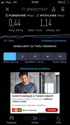

    And what does it mean that the phone works well, what speed does it reach in Orange at home? Subjective feelings are irrelevant, you need to have knowledge about it, do the tests as I wrote, show the results that need to be interpreted. Well, check first of all in games, in Orange NAT 3 is a problem. Other operators must also be tested, just in Mogilno in this location NetWorks operators are not a dream subject, ORANGE uses the station under the T-mobile license at Przemysłowa 3 from aggregation LTE2100 + 1800 + 800 bands.
    This TCL / Alcatel should aggregate these bands, but in games it is best to use one forced on the router, unfortunately this router does not have the ability to force a specific LTE band, generally it is a poor manufacturer's router, problematic equipment for a week only in the Orange offer, practically unknown and the antenna too he is not crazy.
    In Orange, the purchase of a permanent public IP for PLN 18.45 / month helped with NAT problems.
    But this is a secondary topic, first let the application do tests, as I wrote, it will show a screen from it and speedtest.

    Something like this Plus on Padniewska works poorly, because I have about 700 meters of this antenna, and 1-2 lines on my phone. As we all had in Plus, there was such poverty on all phones.

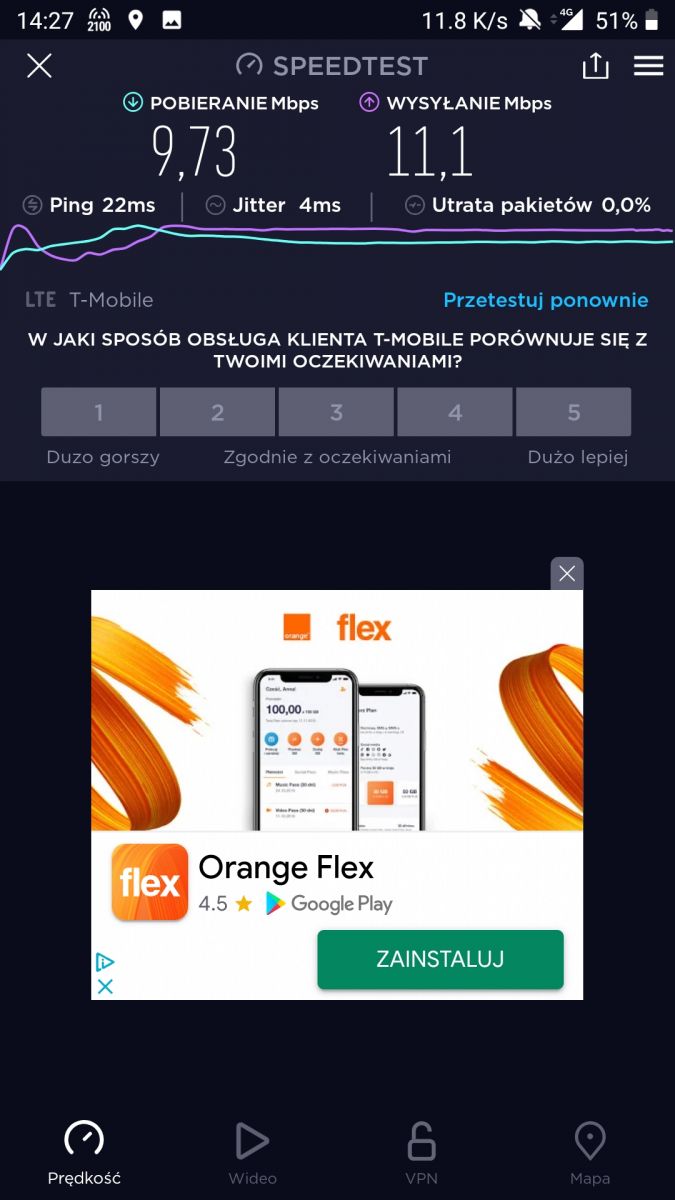

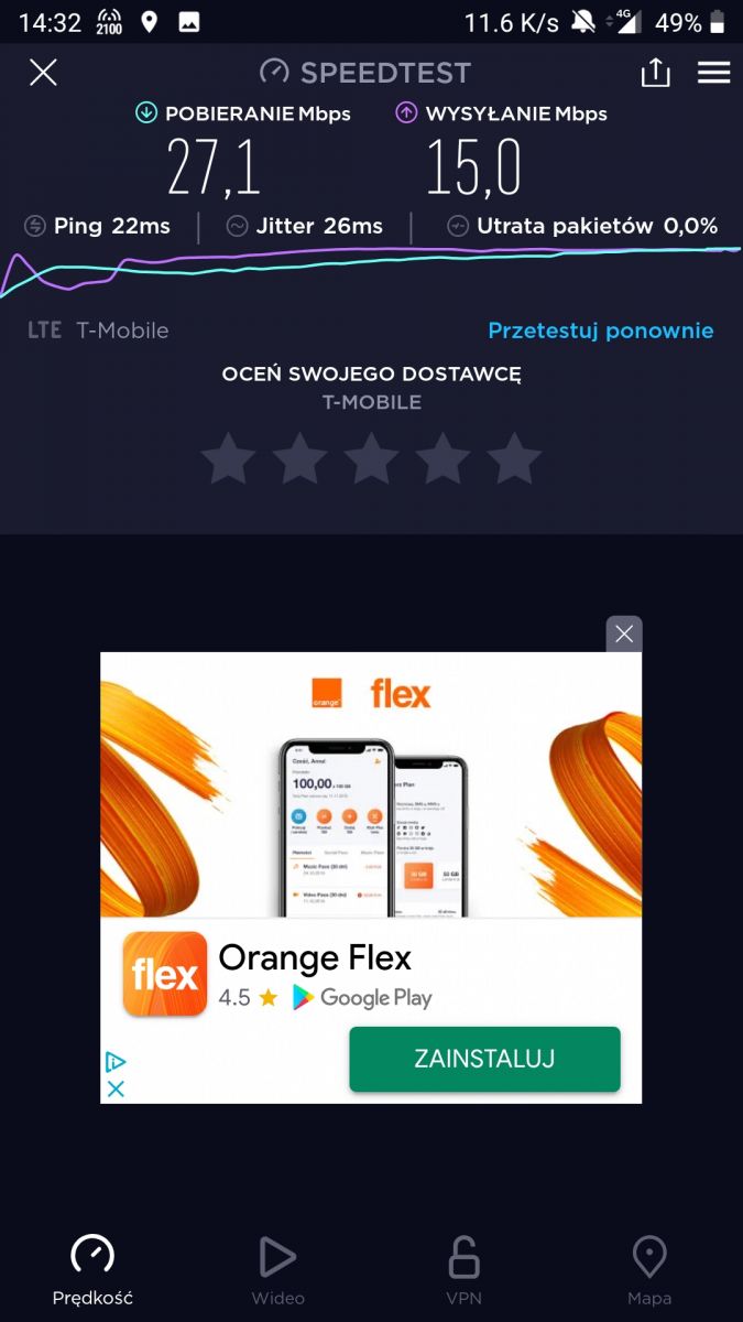

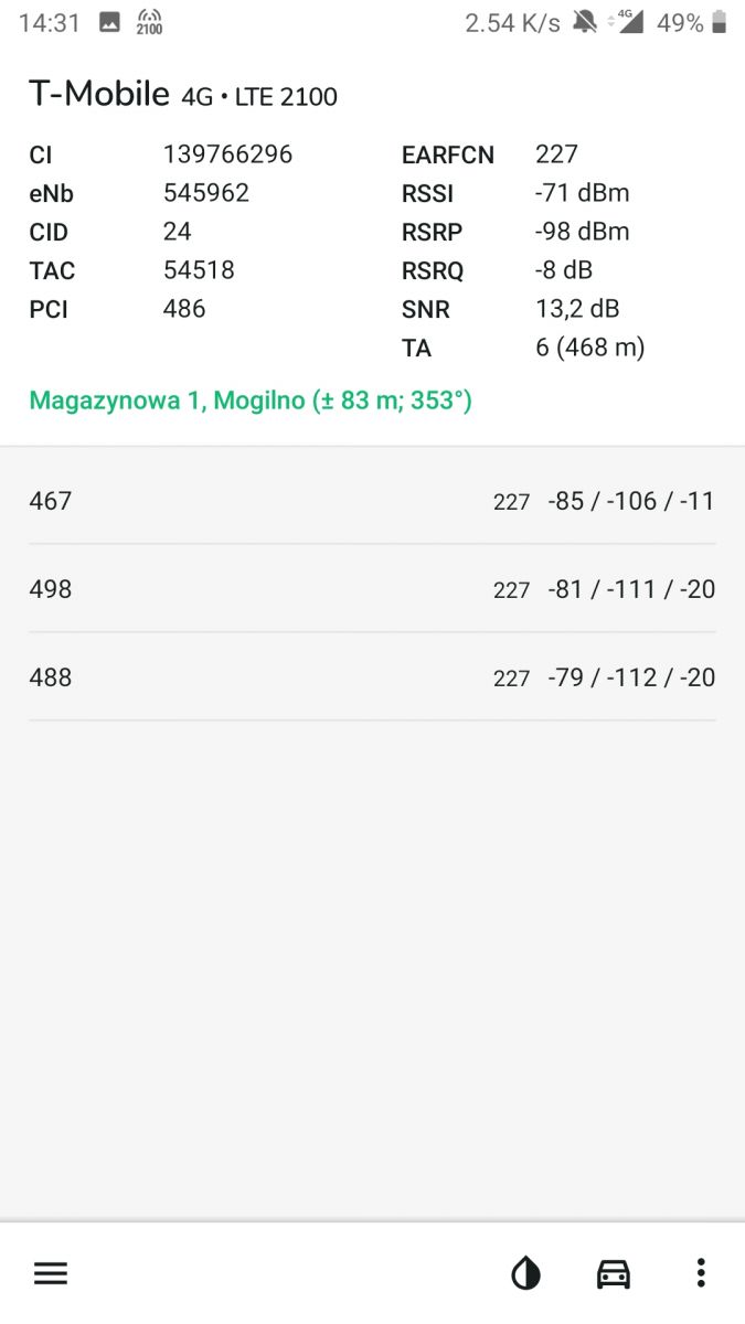

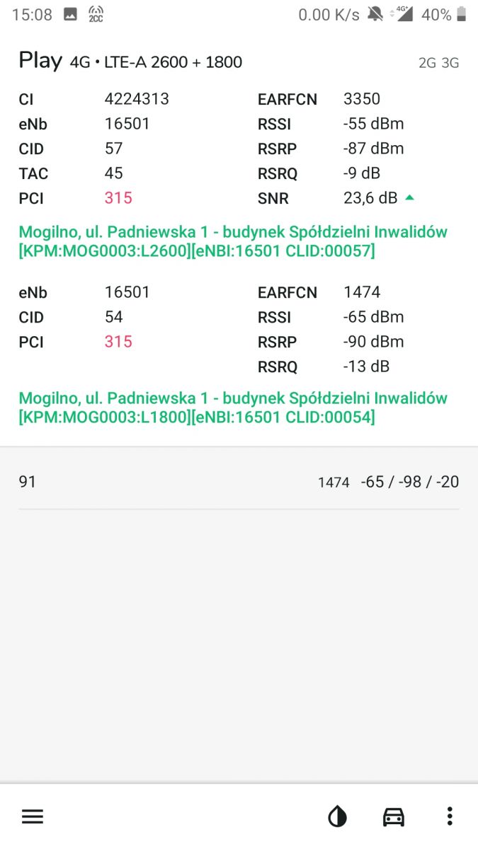

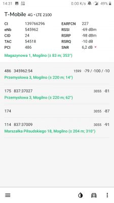

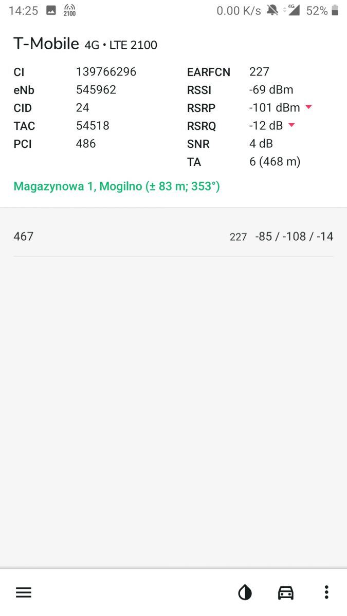

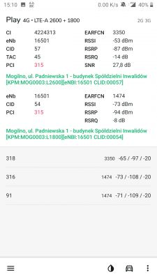

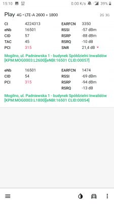

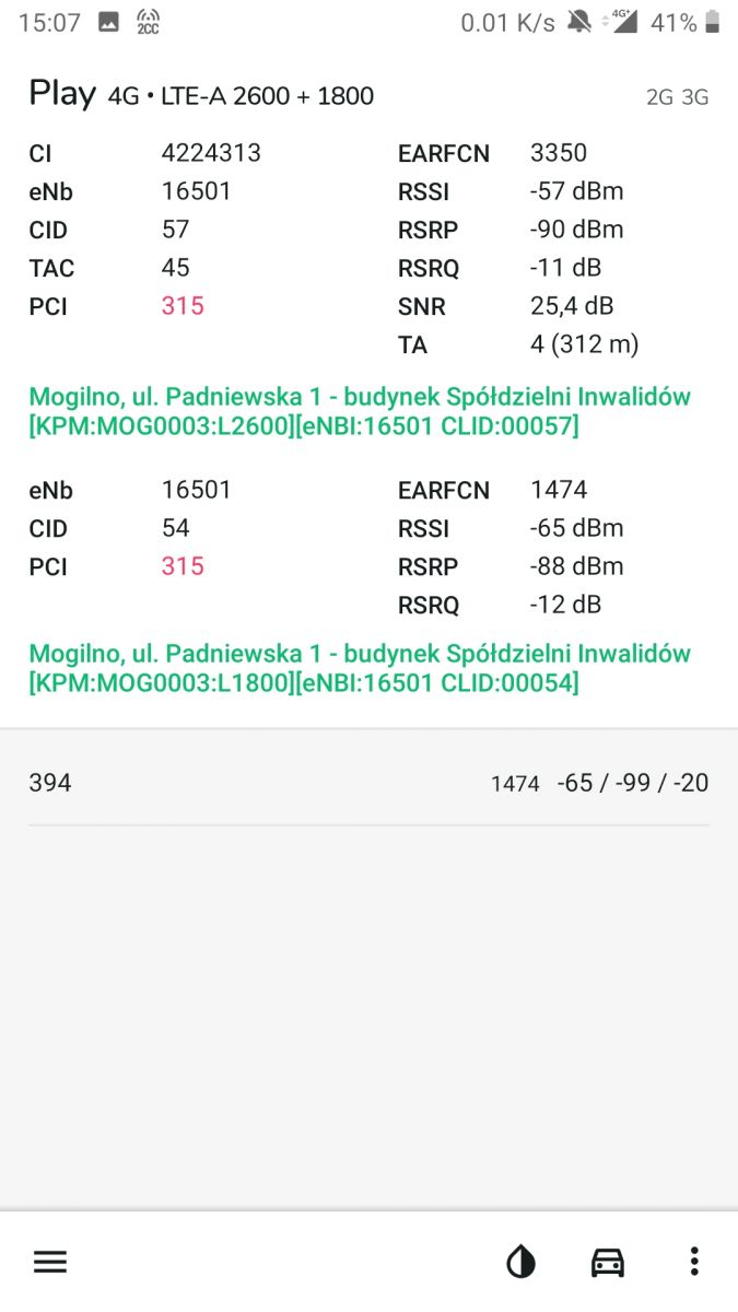

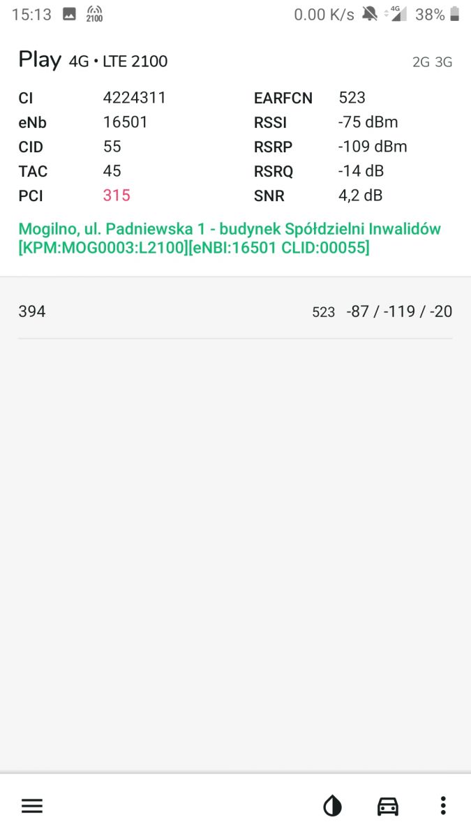

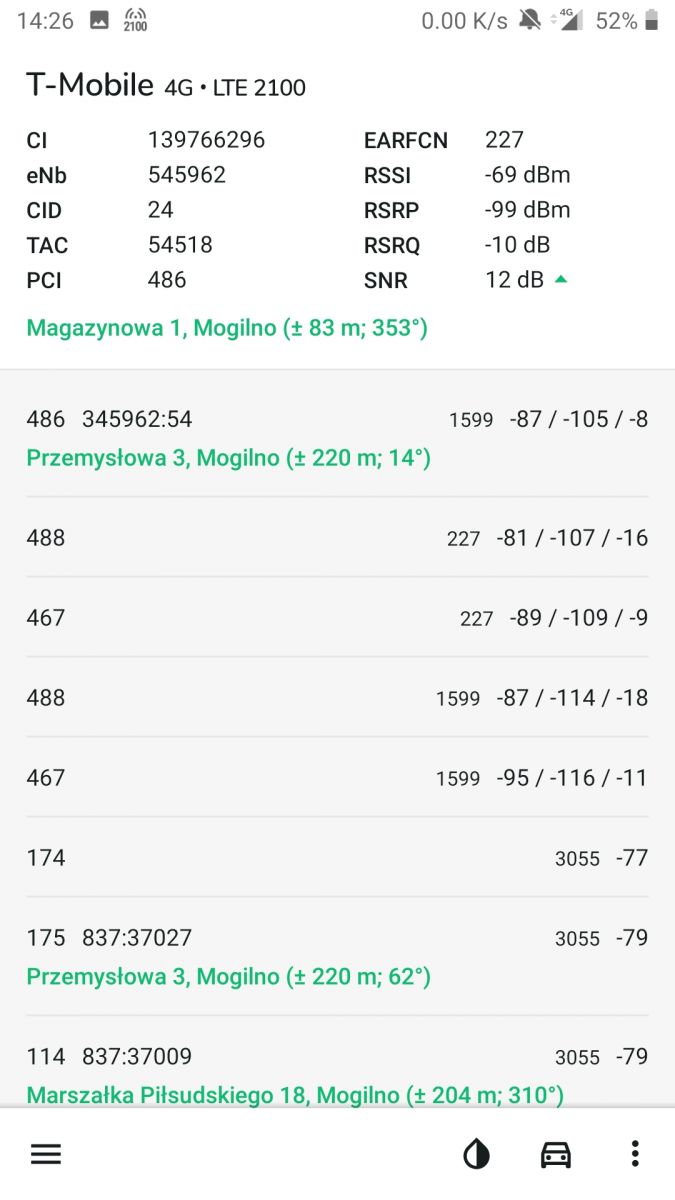

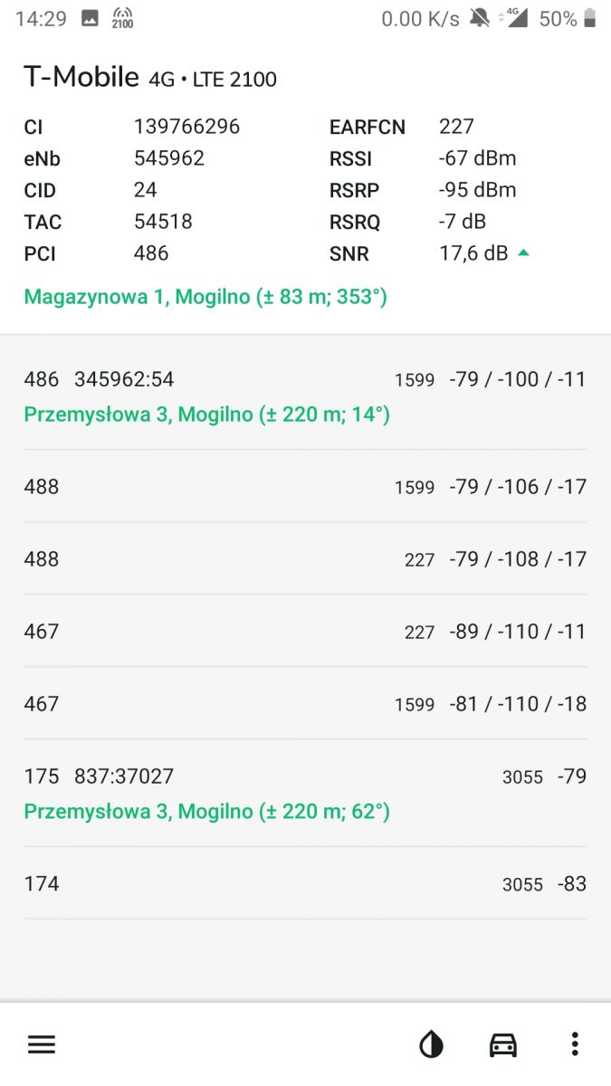

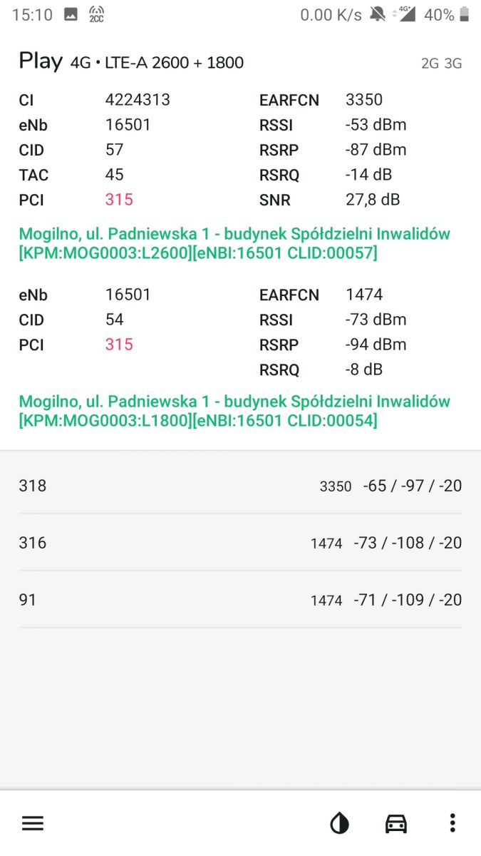

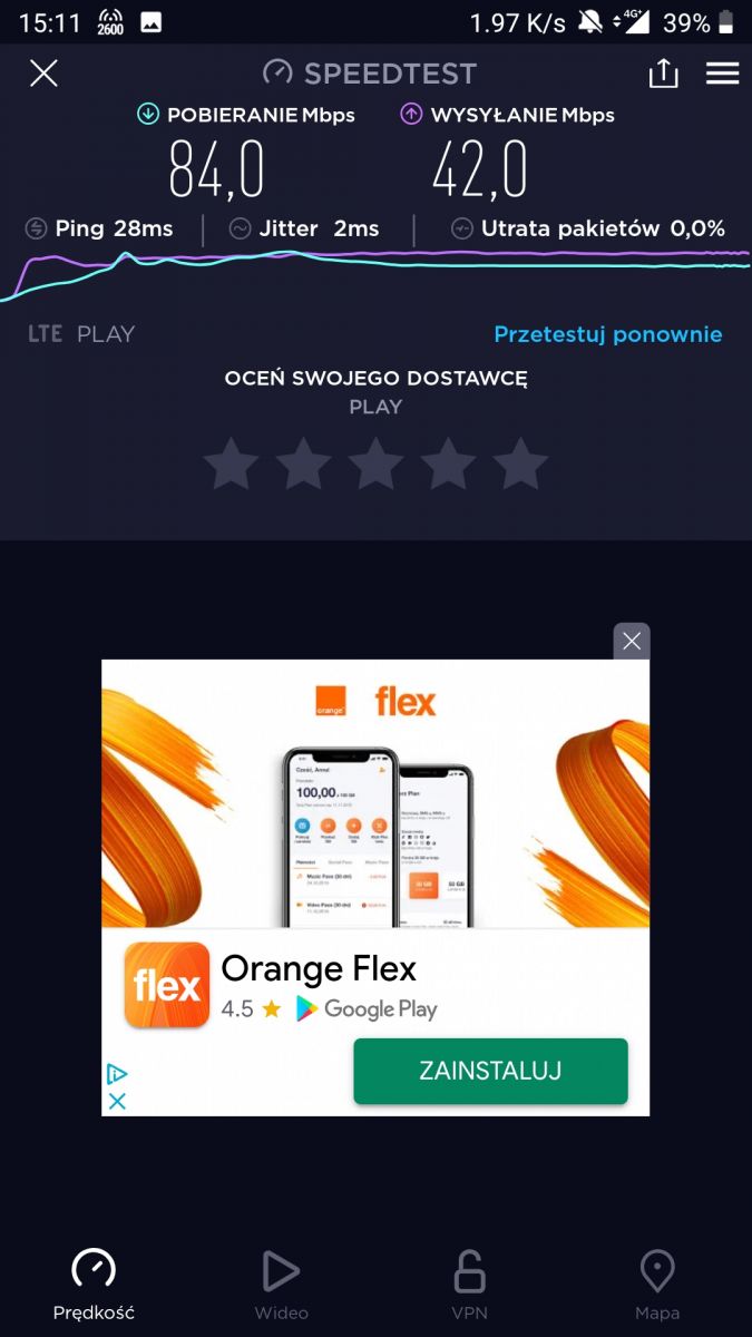

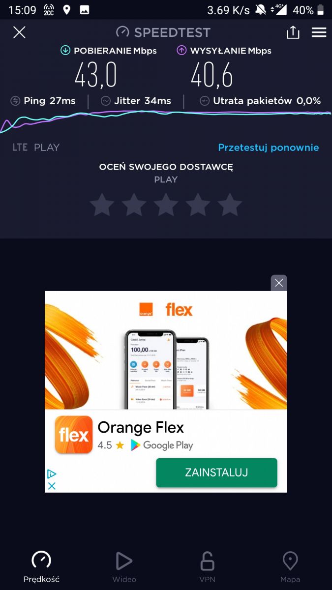

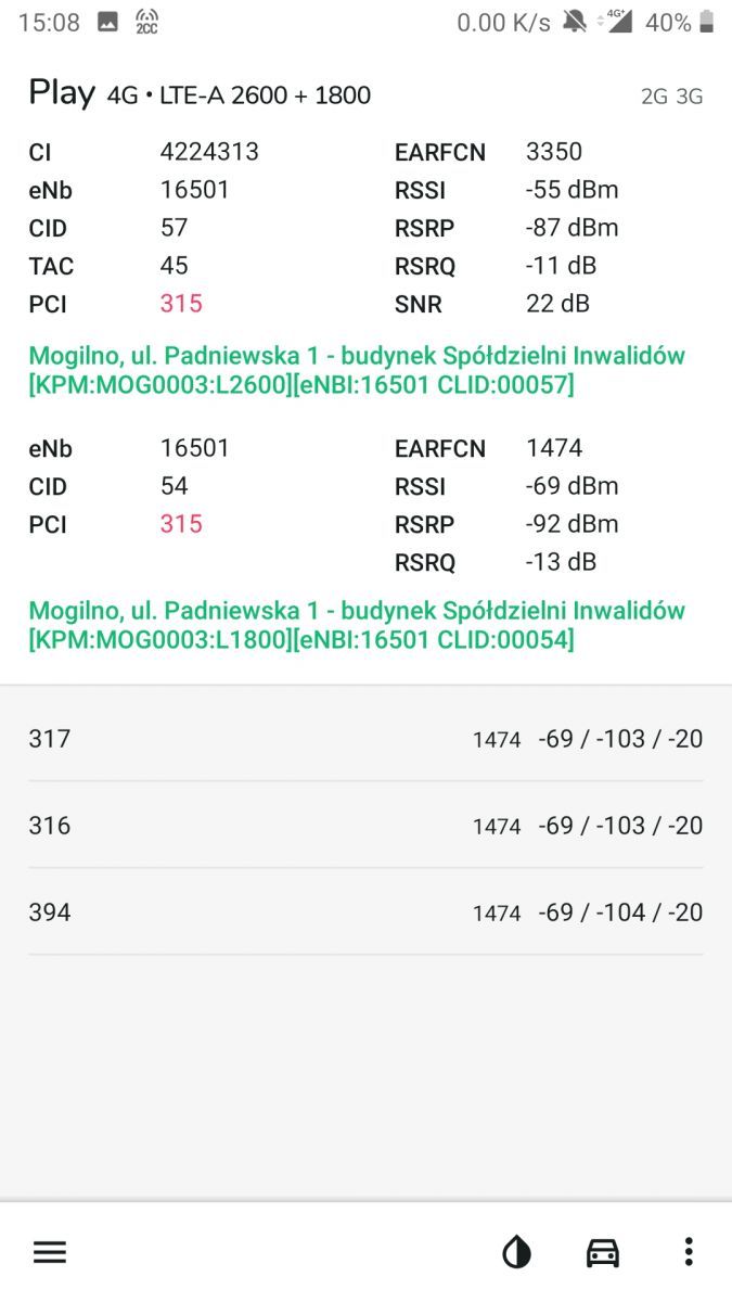

    #24 19730195
    Michelson
    Level 26  
    Posts: 792
    Help: 82
    Rate: 305

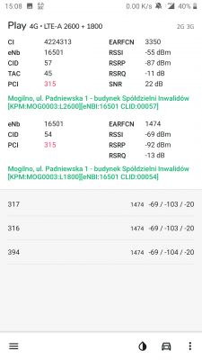

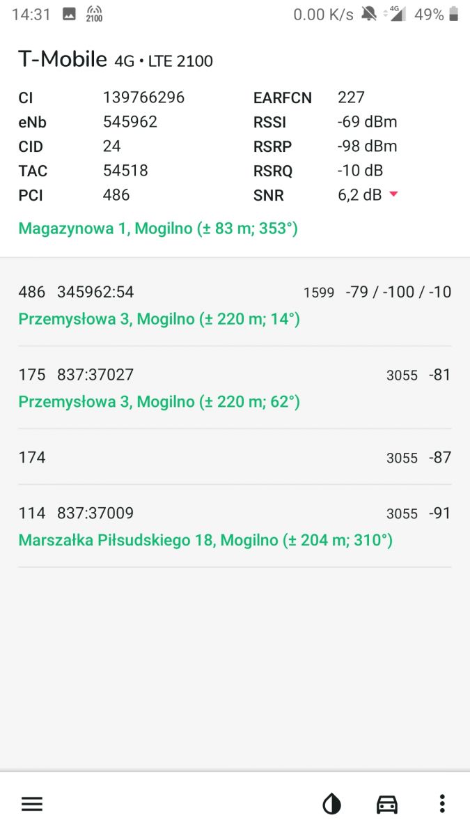

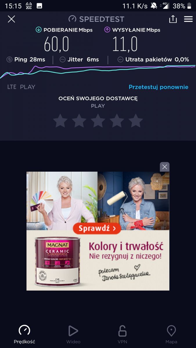

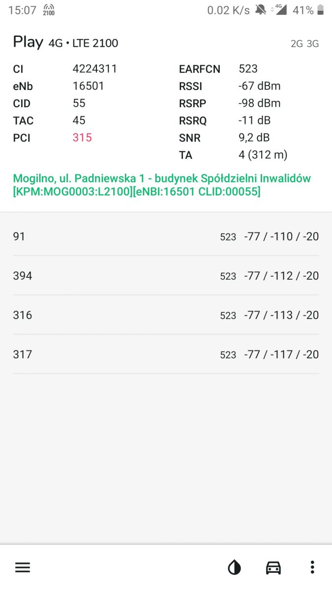

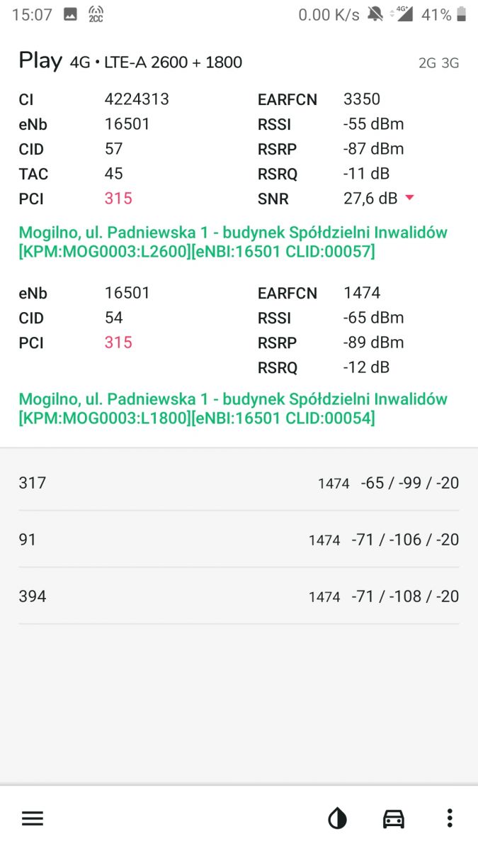

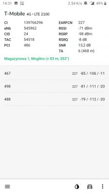

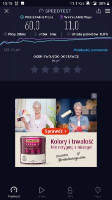

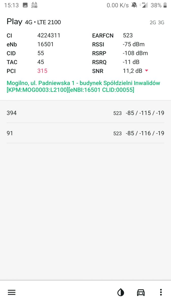

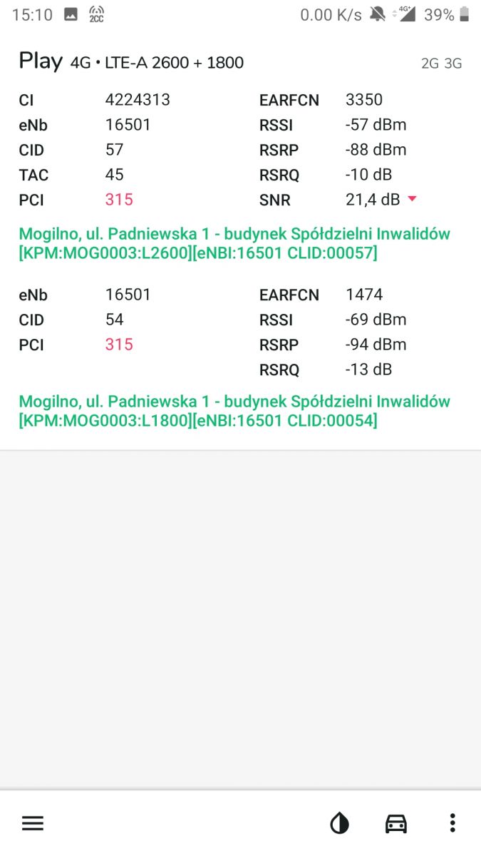

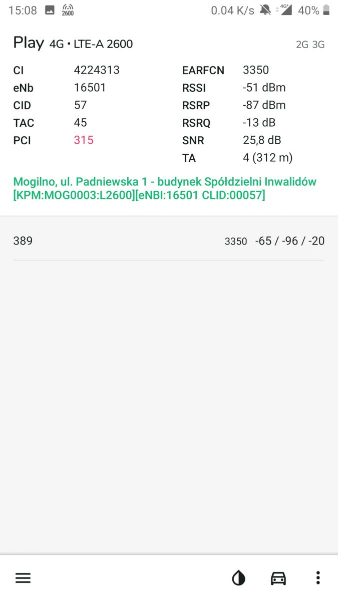

    I did the tests I was about to do. I don't know if there are too many of these pictures.
    T-Mobile on the balcony:
    Using Orange 4G Home Internet & TCL LINKHUB for PS5 Online Gaming: NAT Issues & Cancellation Policy Using Orange 4G Home Internet & TCL LINKHUB for PS5 Online Gaming: NAT Issues & Cancellation Policy Using Orange 4G Home Internet & TCL LINKHUB for PS5 Online Gaming: NAT Issues & Cancellation Policy Using Orange 4G Home Internet & TCL LINKHUB for PS5 Online Gaming: NAT Issues & Cancellation Policy Using Orange 4G Home Internet & TCL LINKHUB for PS5 Online Gaming: NAT Issues & Cancellation Policy Using Orange 4G Home Internet & TCL LINKHUB for PS5 Online Gaming: NAT Issues & Cancellation Policy Using Orange 4G Home Internet & TCL LINKHUB for PS5 Online Gaming: NAT Issues & Cancellation Policy
    Play on the balcony:
    Using Orange 4G Home Internet & TCL LINKHUB for PS5 Online Gaming: NAT Issues & Cancellation Policy Using Orange 4G Home Internet & TCL LINKHUB for PS5 Online Gaming: NAT Issues & Cancellation Policy Using Orange 4G Home Internet & TCL LINKHUB for PS5 Online Gaming: NAT Issues & Cancellation Policy Using Orange 4G Home Internet & TCL LINKHUB for PS5 Online Gaming: NAT Issues & Cancellation Policy Using Orange 4G Home Internet & TCL LINKHUB for PS5 Online Gaming: NAT Issues & Cancellation Policy Using Orange 4G Home Internet & TCL LINKHUB for PS5 Online Gaming: NAT Issues & Cancellation Policy Using Orange 4G Home Internet & TCL LINKHUB for PS5 Online Gaming: NAT Issues & Cancellation Policy Using Orange 4G Home Internet & TCL LINKHUB for PS5 Online Gaming: NAT Issues & Cancellation Policy Using Orange 4G Home Internet & TCL LINKHUB for PS5 Online Gaming: NAT Issues & Cancellation Policy Using Orange 4G Home Internet & TCL LINKHUB for PS5 Online Gaming: NAT Issues & Cancellation Policy
    I Play in the apartment, the phone on the windowsill:
    Can I have an interpretation of these results?
    Play LTE2600+1800 aggregation outperforms T-Mobile in Mogilno
    #25 19730383
    matek451
    Posts: 31253
    Help: 4352
    Rate: 5808
    It took you some time to realize that Play is the leader of LTE in Mogilno, although I knew about it from the beginning and I suggested to you, the test outside shows a connection with Padniewska 1, aggregation LTE2600 + 1800 or LTE2100, signal parameters on them are correct, much better than T-mobile from Przemysłowa to LTE2100. Speedtest shows practically everything, it only remains to test Play in games on the console.
  • #26 19730739

    Maybe someone will find this information useful, but in my case network games on PS5 do not work with Plus and Orange (NAT 3) operators, and they work with T-Mobile and Play (NAT 2), at least when the Internet is available to the console from the phone .

    That there is NAT2 with Play, I know because the son-in-law of an avid player uses the PS5, of course, the Internet in Play I provide him with speeds of 300 / 60Mb / s, on the pre-paid new 100GB starters bought in wholesale for PLN 3.5.
    For you, Play is unrivaled, specific equipment with the aggregation of 4/3 LTE QAM256 bands and the Dual LTE1800-2600MHz antenna for it should show the potential of this operator.
