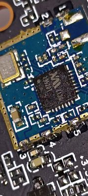

    Send a photo of the camera. In addition, the photo from the inside should be a wifi module

    Photo of the module with WiFi:
    Spoiler:
    The SMAR PTZ IP camera from aliexpress stopped responding after the reset The SMAR PTZ IP camera from aliexpress stopped responding after the reset
    From the reset, until the "switch" popped - there is now a jumper :) which I keep even longer than a minute and unfortunately the effect is not as expected. Still resets.

    Send a photo of the other side of this board, there should be SPI FLASH memory, but to be sure, I want to make sure it is really there.
    Pictures:
    Spoiler:

    Czyli pewnie reszta elektroniki siedzi głębiej przy przetworniku obrazu.
