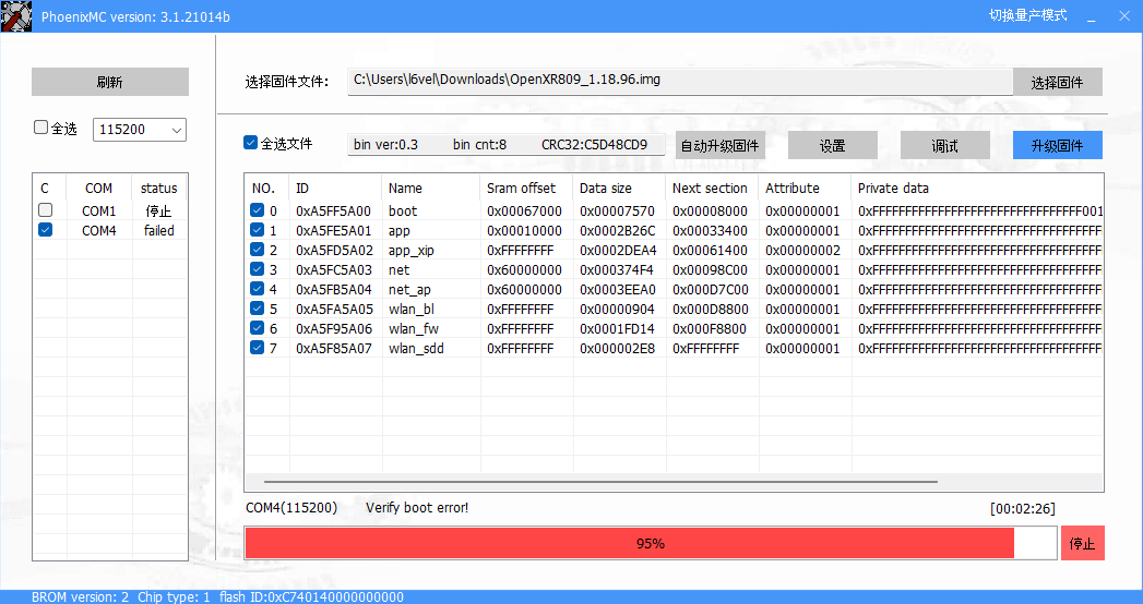

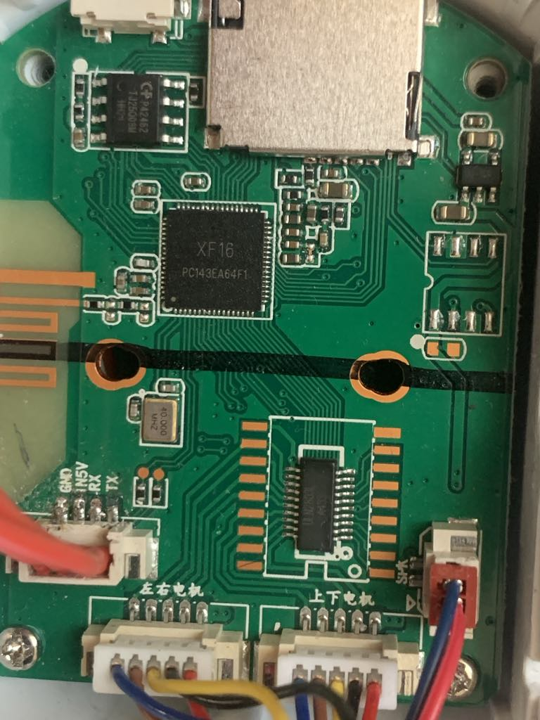

    Hello, I would like my camera to be compatible with the home assistant. It is a cheap camera from China, which has very weak software that does not allow it to transmit RTSP. I tried to upload some firmware from GitHub, which made the camera sit in recovery mode and wait for the next firmware. I didn't have a backup, so the old one was gone, but I have another device of the same kind, so if I needed it, I can try to recover the firmware from that one and upload it to this one. I performed all activities with a UART adapter and I would like to send the new software with it as well, and I used phoenixMC to send the software. I'm a beginner in this topic and I would like to ask for a detailed explanation of what I can do in this case.
    Close-up of a green printed circuit board with integrated circuits, connectors, and wires.
    PhoenixMC program window showing a Verify boot error! message during device bootloader verification on COM4.

    Do you have original 1MB flash backup?
    This is XF16, which is XR872. Our firmware can boot onto it, but don't have camera driver yet, so it won't provide image...
    ah. I see you tried to flash XR809 file

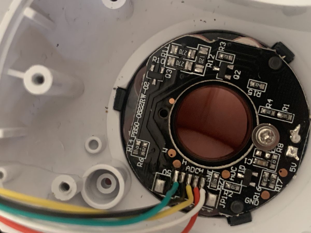

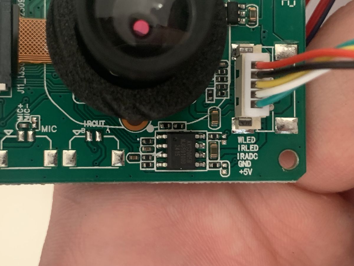

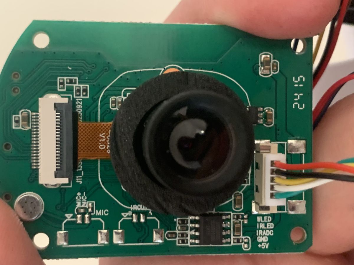

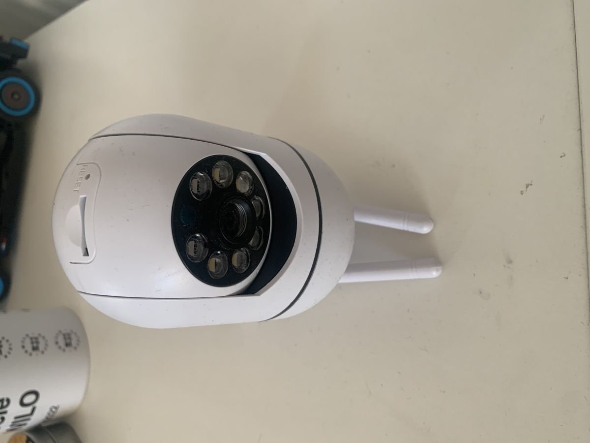

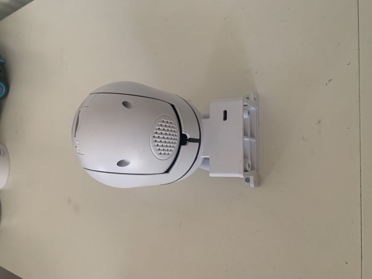

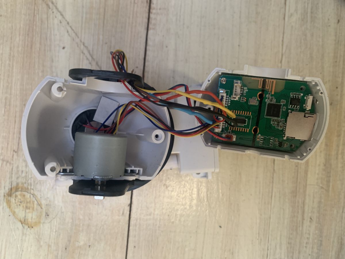

    If you have any more pics of the outside of the cam, any labels, other side of PCB, that would be cool too. thank you

    Close-up of a circuit board with wires inside a plastic casing.
    Close-up of a camera module with a lens, PCB board, and a connector with colored wires.
    Electronic camera module with a visible lens and connected wires.
    Open casing of an electronic device showing a circuit board and a small motor.
    White surveillance camera on a rectangular mount, placed on a light surface.
    A white surveillance camera with two antennas stands on a light-colored surface.

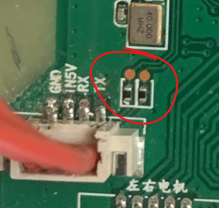

    well it looks like these two are RX/TX. Do you get text log output from TX at 115200 baud from one of them?
    Part of a PCB with a connector and a marked area for a jumper or component.

    I have access to the UART, I also got the password but half of the commands of this system and there are not many of them are deleted. I will send logs and command list tomorrow

    well if those two are definitely RX/TX and assuming the original firmware has the console stuff enabled then you should just be able to dump with PhoenixMC without grounding any PB02/PB03 type pins.
    See here for backup process, it also applies to XF16 https://www.elektroda.com/rtvforum/topic4115856.html
    Simply ignore the instructions to ground PB02/PB03 and connect up RX/TX to USB-TTL. Then run PhoenixMC and see if you get open comm port! message and are able to dump to file.
