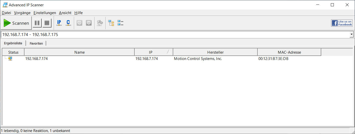

    I can't communicate with the camera. Only the LED of the Ethernet connector
    lights up, but communication does not work here either in the traditional way. It can be pinged, but the Device manager does not recognize it, the IP scanner does not identify it as IPC.
    Meanwhile I discovered a live Lan connection at 192.168.7.174.

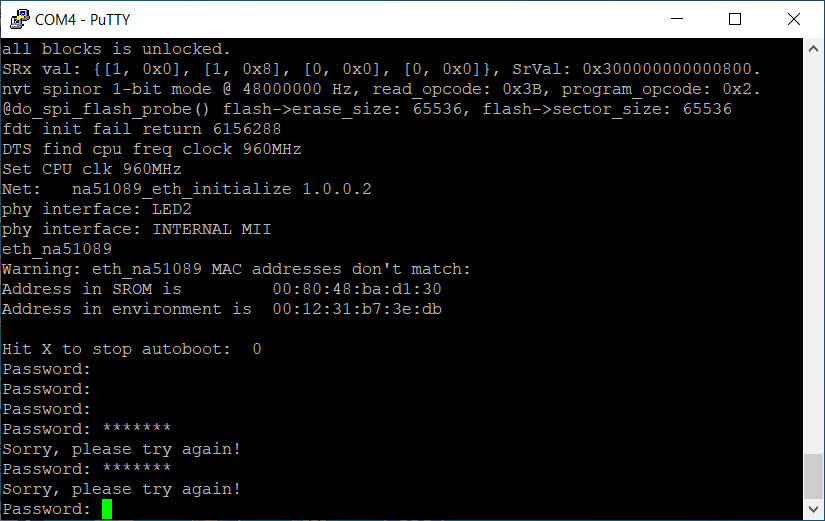

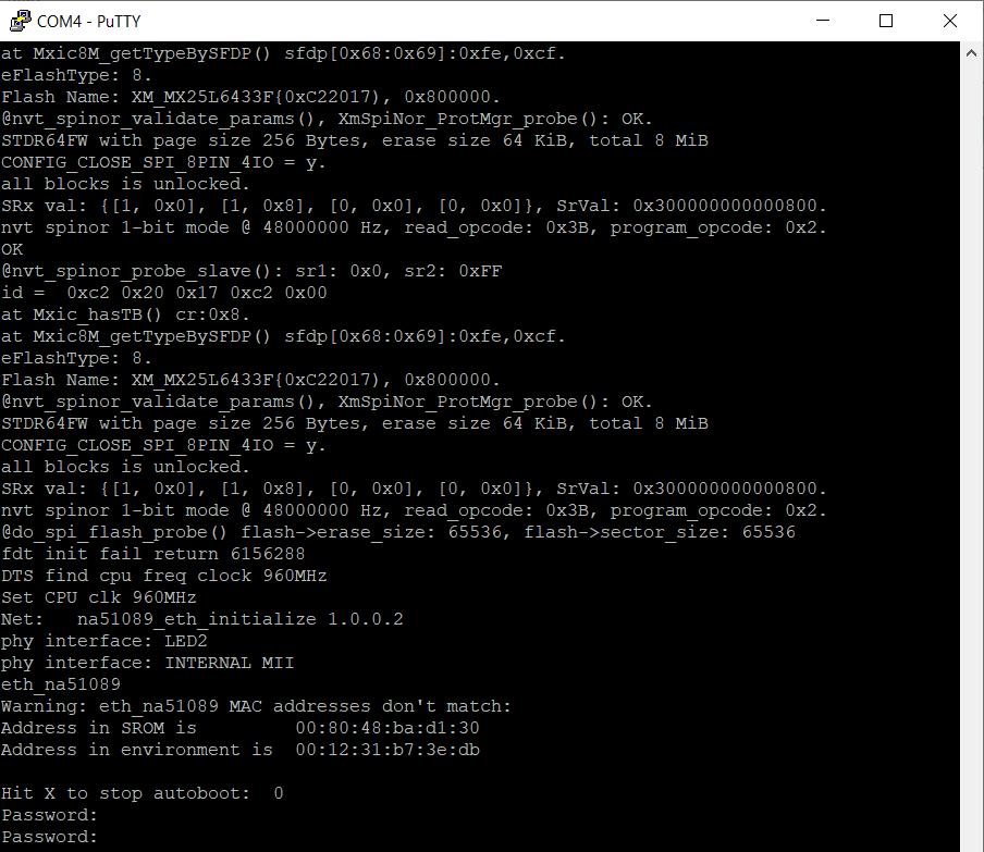

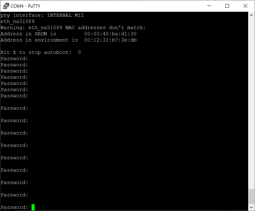

    I experienced the following on the serial port:
    - the camera regularly restarts and then stops (I am attaching the log file with SD card and without SD card)
    - as I read here, I tried to stop the startup process, which finally succeeded with the "Ctrl C" combination. However, it asks for a password here. The seller says the password is empty, but I can't go any further... (screenshot attached)

    Alexcam wrote:
    after the update. I have several such cameras, one of which has died
    Have you only updated one camera or all but only this one does not start?
    In the attachment you have the firmware should match.
    Check password:
    Spoiler:
    xmhdipc
    • 000629G3.1IPC_NT98562_80N40_S38.Nat.dss.OnvifS.HIK_V5.00.R02.zip (26.96 MB) You must be logged in to download this attachment.
  • #3 20251264
    Alexcam
    Yes, I updated several cameras, luckily only this one doesn't work.
    Unfortunately, the password is not correct.

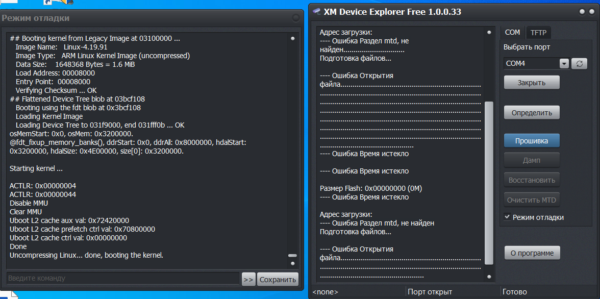

    First I wanted to reset the camera using the USB-TTL--TFTP method. Unfortunately, due to the missing password, this does not work, because I cannot enter the Console command this way (see previous comment). I thought I'd try the Russian version, as it seemed simpler based on the descriptions. However, I have a problem here as well. Although the USB-TTL connection works, it cannot identify anything and times out. I would plan to:
    - I will try to upload the new firmware with the Russian program (if it works at all)
    - Fastboot 3.1(BVT), but I'm not sure about the addresses here...
    What would you recommend?

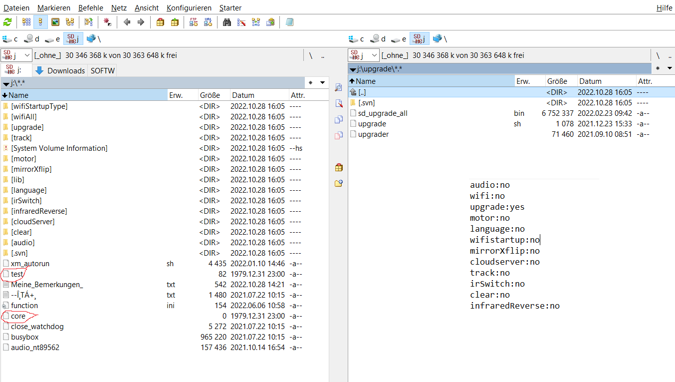

    Firmware package contains SD upgrade instructions
    #5 20254819
    gradek83
    Posts: 9107
    Help: 930
    Rate: 2103
    Rozpakuj plik 000629G3.1IPC_NT98562_80N40_S38.Nat.dss.OnvifS.HIK_V5.00.R02.zip masz tam folder Vers_4_2022-09-23 wejdź do niego jest tam plik ( chińskie krzaki) --θTÁ+¸.txt
    Spoiler:
    1. Copy all files in the current directory to the sd card
    2. Insert the device before power on
    3. There are five functions corresponding to the function.ini file. If you want to open the corresponding function, please modify its value to yes
    3. There are routing-related configurations in wifiSetup.ini in the wifiall folder. Familiar with gateway IP mask, computer IP channel number and other settings need to be configured by production test personnel
    4. Audio function description, first record after 5 seconds, then play
    5. wifi function, when connecting to the router, it will broadcast that it is connecting. If the connection is successful, it will broadcast that the connection to the router is successful. If it fails, it will broadcast and replay. If it fails, please check whether there is no antenna or whether the configuration information in wifiSetup.ini is correct.
    6. For the upgrade function, please place the network upgrade package in the upgrade directory, and rename the program to sd_upgrade_all.bin. Note: 1. The same device will only be upgraded once. If you want to upgrade repeatedly or upgrade other versions again, please delete the eth0mac.cfg file in the upgrade directory. 2. The limitation of the new flash on the old program is not supported for the time being
    7. Add the default language configuration function, which can replace the default language configuration on the CMS. The value of DefaultLanguage in the configuration file language.ini can be modified: SimpChinese or English, Chinese: SimpChinese; English: English
    8. Add the wifi default startup mode configuration, you can modify the wifiStartupType.ini file in the wifiStartupType folder, the value of StartupType means Station means routing mode, softAP means direct connection mode,softAPremain means direct connection mode and the previous mode will be saved after power off and restart, Stationremain means routing mode and the previous mode will be saved after power off and restart. Note: No special instructions, Xiongmai boutique program does not need to modify this
    9. The mirrorXflip video parameter configuration function, modify the mirrorXflip.ini file in the mirrorXflip folder to set the video parameters, MirrorSwitch:on/off corresponds to the enabling and disabling of the video mirroring parameters, and FlipSwitch:on/off corresponds to the enabling of the video flipping parameters and off.
    10. Motor function phenomenon The motor shakes the head to rotate up, down, left and right. The motor steering control function depends on this option.
    11. Add the function of deleting residual pictures, messages and videos on the server. Note that video preview is not supported after this function is turned on.
    Masz tam po Chińsku instrukcję co i jak robić i ustawić.
    W punkcie nr: 6 piszą o zmianie nazwy pliku aktualizacji na sd_upgrade_all.bin zapewne chodzi o jeden z plików w katalogu 000629G3.1IPC_NT98562_80N40_S38.Nat.dss.OnvifS.HIK_V5.00.R02. np: plik General_IPC_NT98562_80N40_S38.Nat.dss.OnvifS. HIK_V5.00.R02.20220223_all.bin skopiuj do folderu : upgrade i zmień mu nazwę na sd_upgrade_all.bin.
    Wszystkie pliki z katalogu Vers_4_2022-09-23 przekopiuj na sformatowaną fat32 kartę pamięci i tam dokonuj wszelkich konfiguracji.
    Powodzenia.
    Zainstaluj sobie program notepad++ pozwoli ci odczytać chiński plik TXT
  • Boot process stalls after SD card update starts
