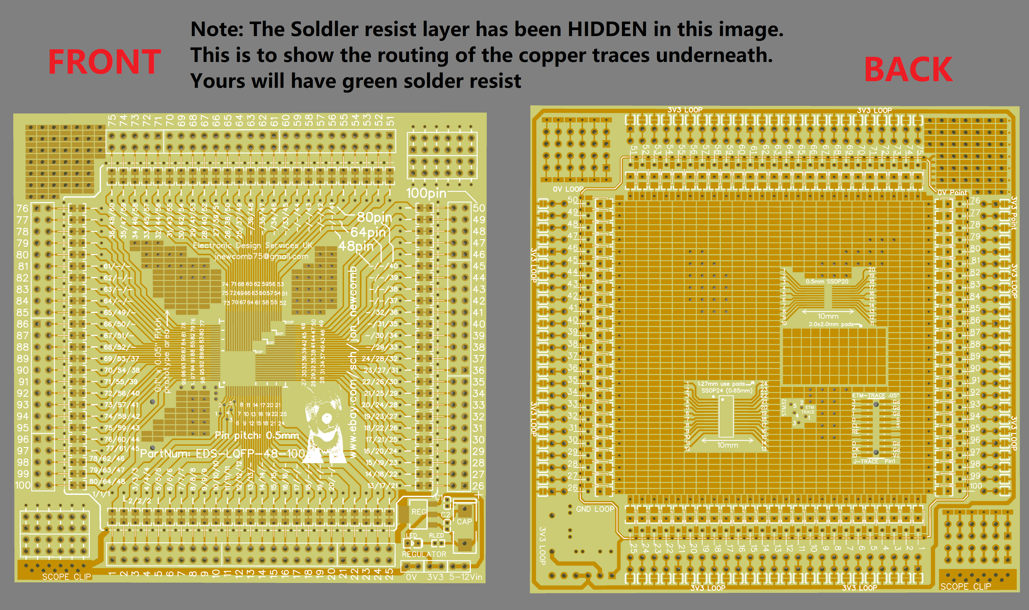

    These boards are distinguished by the fact that they have paths so that the power and ground connections to various pins are basically ready, all you need to do is put a tin jumper.
    Let's look at the TQFP 100 for example:
    Universal starter boards for various SMD microcontrollers with a prototype area
    Thanks to this, there are no problems with:
    - connecting the pin to ground
    - connecting the pin to the power supply
    - connecting a capacitor between the pin and ground or between the power supply and ground (for example VCAP from PICs)
    - connecting a filter on the pin input (e.g. analog, AVDD)
    - connecting a pull-up resistor for the pin
    - etc. etc.
    In addition, they offer ready places for the power section, programmer outputs and a large field for prototyping. The prototype fields are made in a thoughtful way, and in some boards (eg TQFP100) they also include pads for smaller chips in SOIC and SSOP. There is also room for the ETM-TRACE debugger in the TQFP.

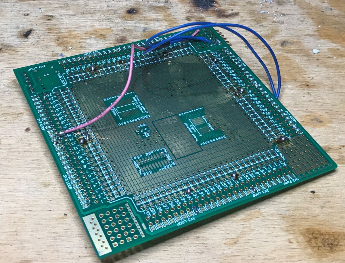

    Let's start with how the tiles look in practice. The first set I received:
    Various green universal PCB boards and two instruction sheets lying on a wooden table.
    This large TQFP100 board is the same three times in the picture, there is just a large prototype space on the bottom and descriptions of the role of the pins on the top, etc. their derivation.

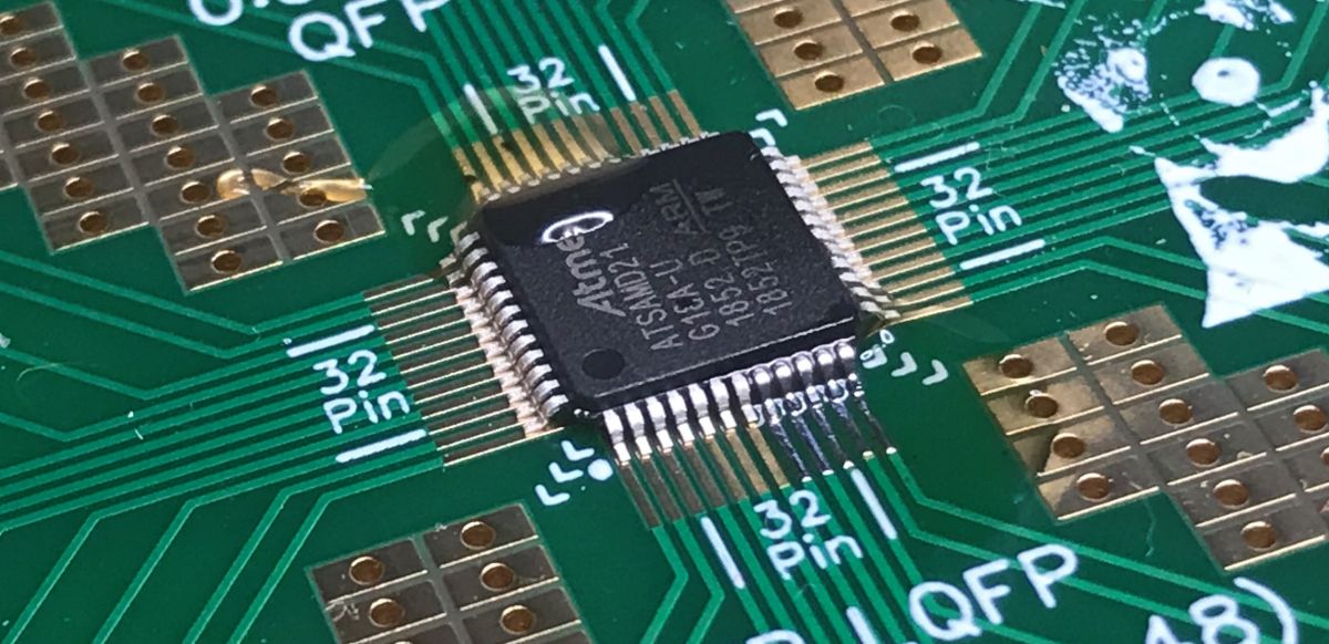

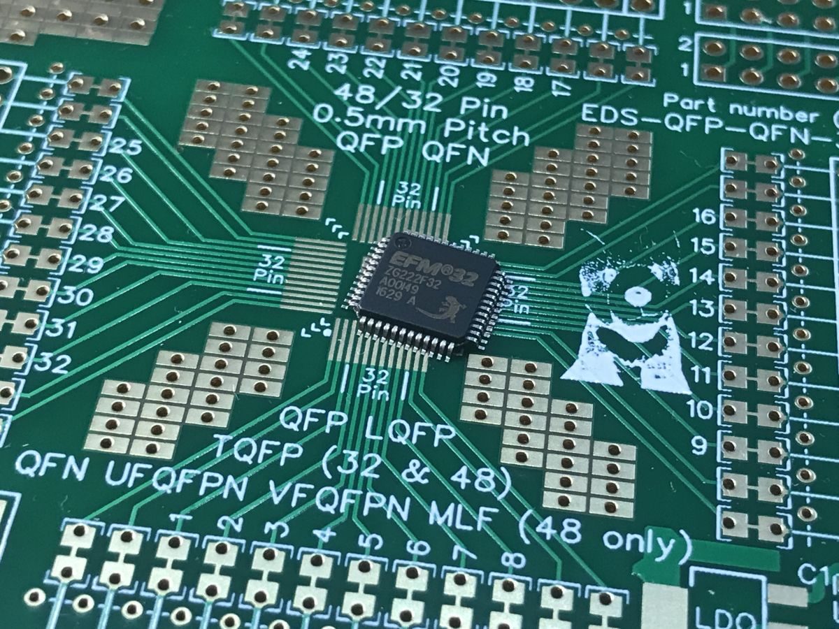

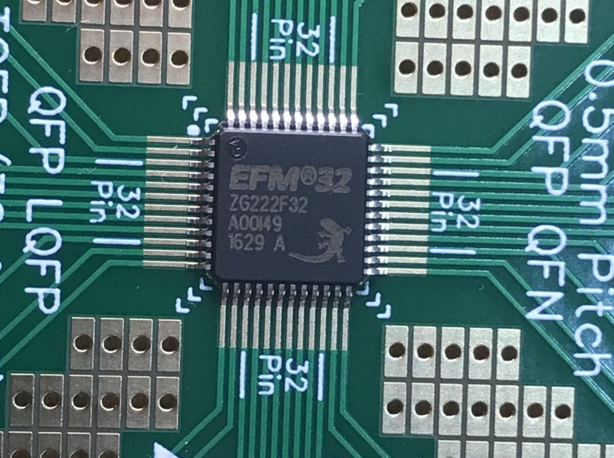

    The second set I got - 48 / 32pin 0.5mm QFP QFN:
    Universal starter boards for various SMD microcontrollers with a prototype area Universal starter boards for various SMD microcontrollers with a prototype area
    At first glance, you can see that the tiles are of very good quality, but we will test them in practice anyway.

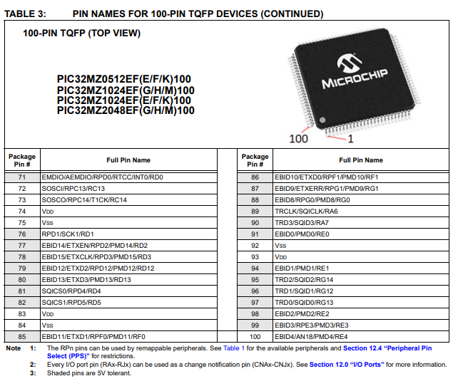

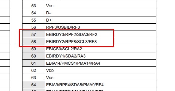

    You also need information about the findings:
    ATTENTION: Pin number 1 is the pin at the corner with a dot. The orientation of the text / graphics on the layout does not matter. It can sometimes be reversed. Adopting it may be misleading.

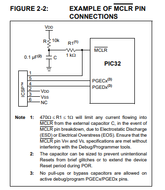

    Additionally, let's check what needs to be connected - section 2.1 Basic Connection Requirements :
    We will stretch the rules a bit here, because decoupling capacitors should be " placed as close to pins as possible "(placed as close to the pins as possible) to minimize parasitic capacitance and inductance, and here is a bit of this gap, but I think it's acceptable for a learning breadboard.
    Basically we have to do:
    - soldering the circuit to the board
    - jumpers for all VDD and GND pins (also AVDD and AGND)
    - decoupling capacitors 100nF for pins from the power supply
    - connection of the Pickit programmer via ICSP on MCLR / VDD / GND / PGD / PGC

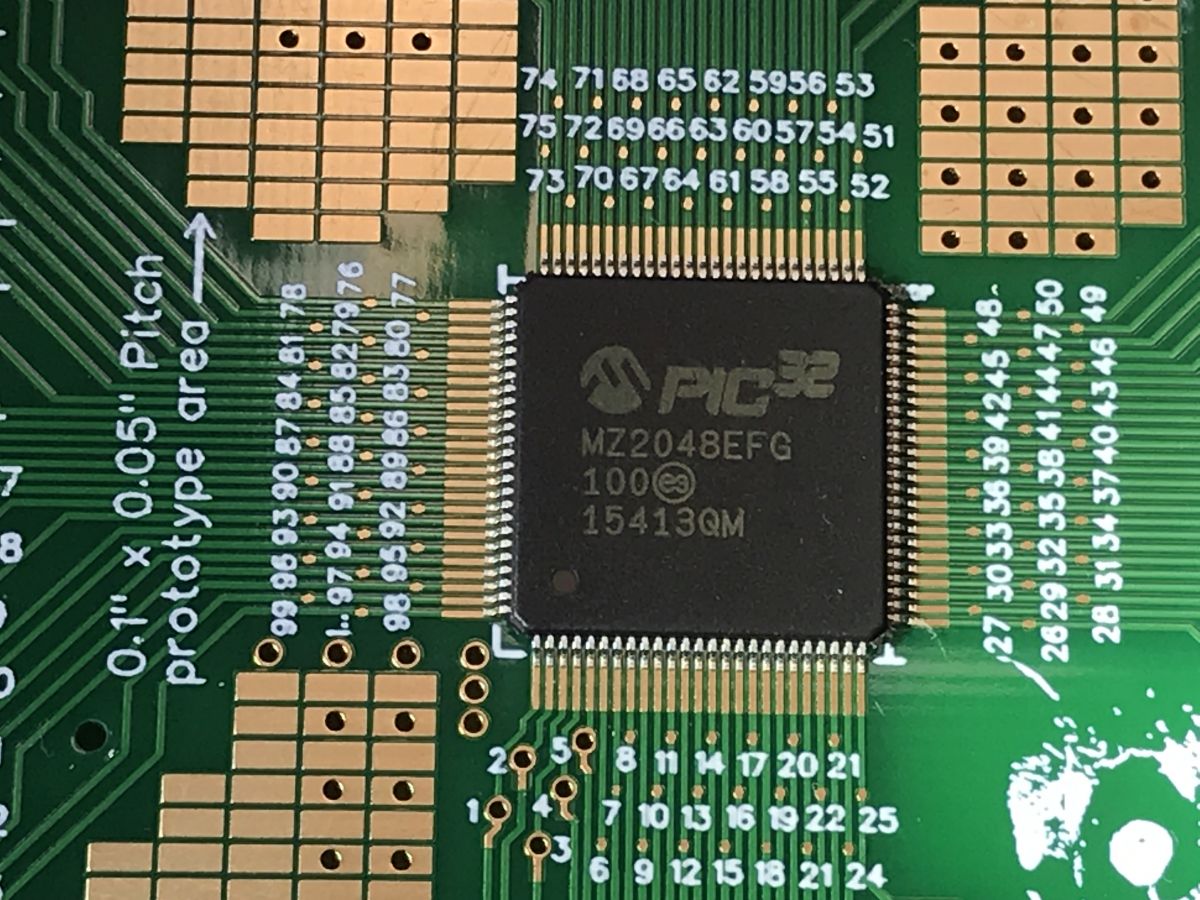

    Let's start by soldering the PIC. Positioning the system, I do it with antistatic tweezers but I do not touch its pins anyway, so as not to damage it with ESD, only the housing:
    Pin catching, I use 0.25mm lead tin, must also be flux:
    Soldering; there were practically no short-circuits on the pins (but when there is a short-circuit, first I try to remove them with the soldering iron + paste, with movements along the pins, and if it does not go with a braid):
    After soldering, each pin must be checked, both for connection and for a short circuit with neighbors:

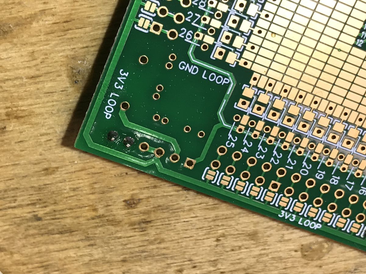

    Now all the VDD and GND pins need to be soldered.
    We have a download for this:

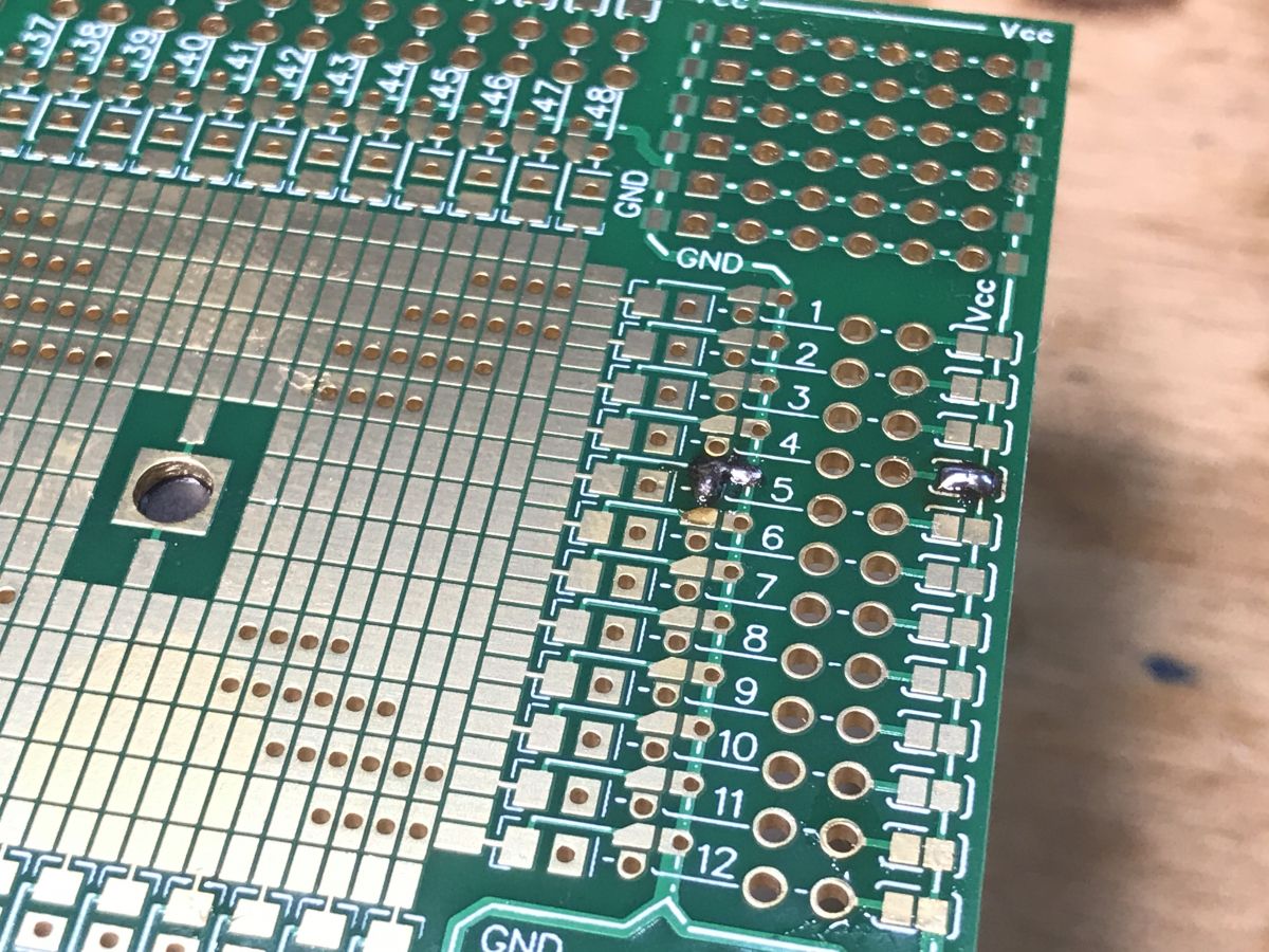

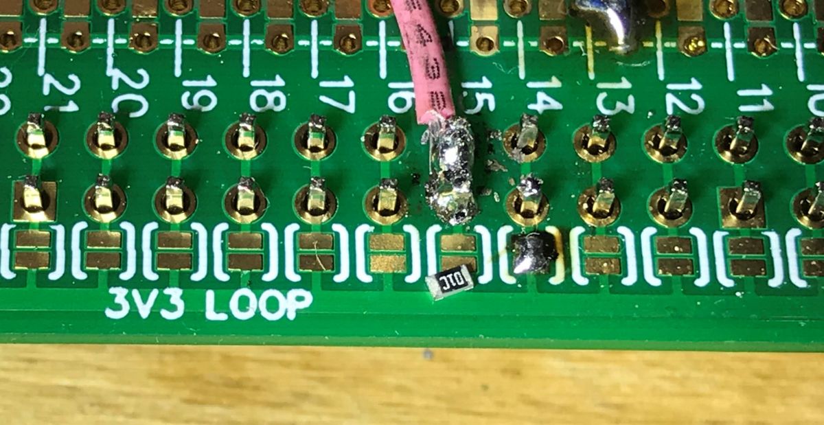

    Pin 14 is the power supply. Below is a jumper for VDD loop:
    Pin 13 is ground. Below the jumper to GND loop:
    After each jumper, we check whether we have made a short circuit to the power supply (or to the adjacent pins), because then when there is a short circuit, it will be more difficult to determine when it arose!
    Ready:

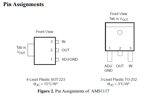

    You will need LDO - AMS 1117:
    Unfortunately I didn't have it in stock (I always use TC1264, MIC2940, etc). I had to find mine in the hatch:

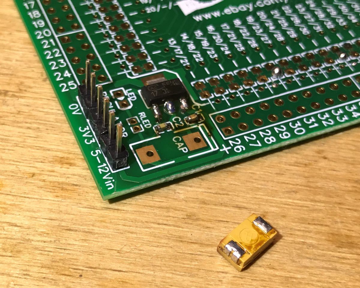

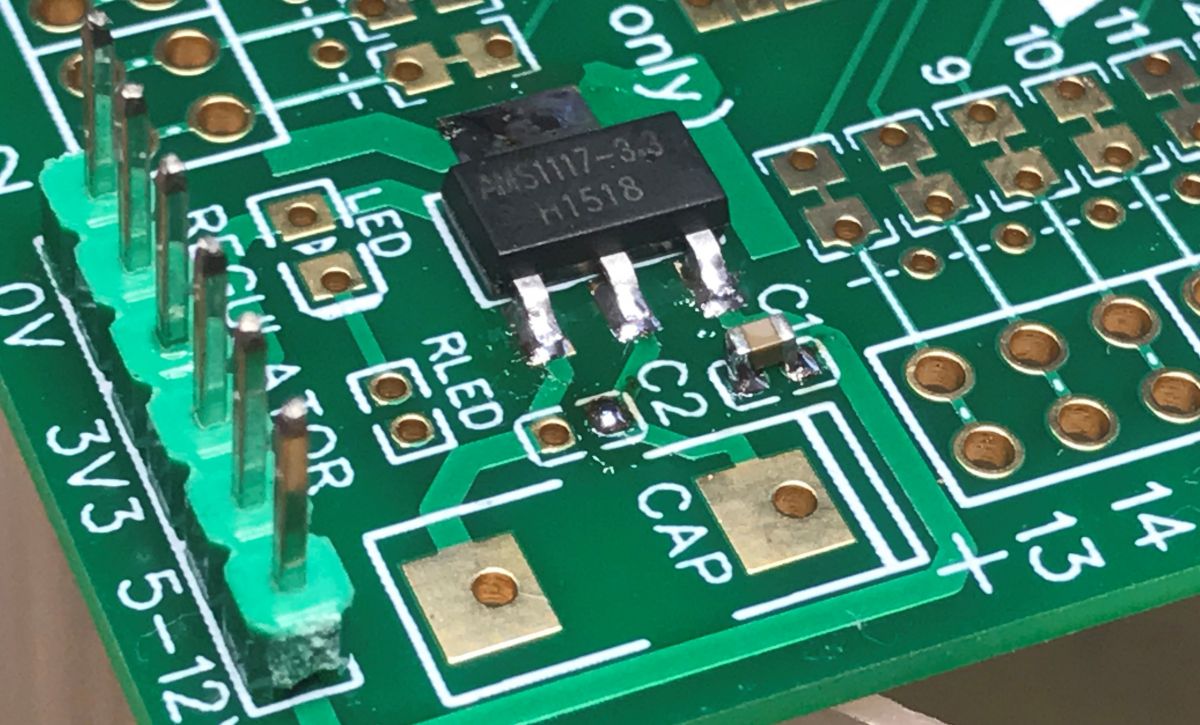

    I chose the 5EBL17-33. We can set it first and then solder it, and you can also first put the tin on one pad and then position it, while melting the tin:
    In the meantime, you can also solder goldpins from the power supply:

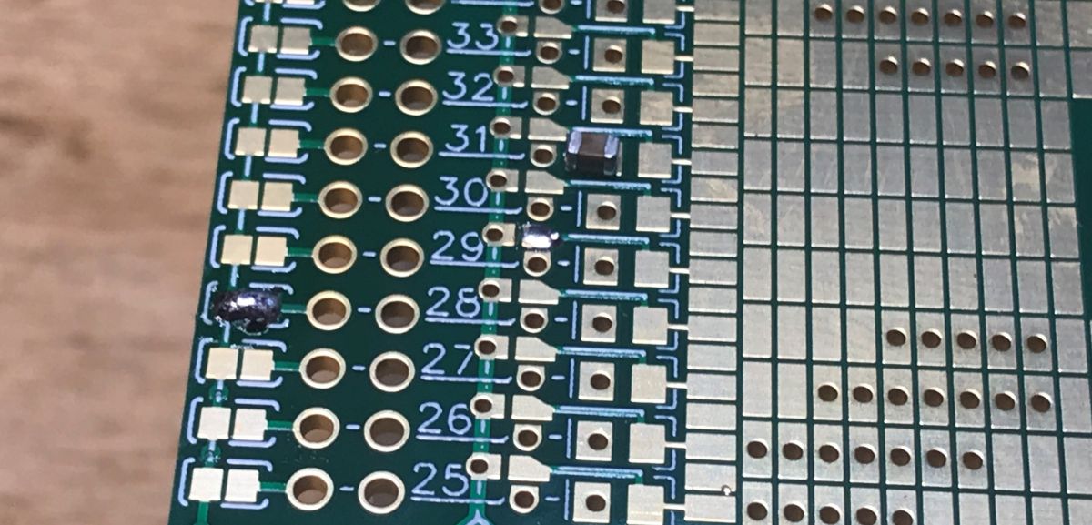

    Ready. Now let's prepare 100nF ceramic capacitors in 0603 housing. In total, one is already in the picture below - see?
    They have no polarity.
    I solder them so that I tin one pad like this:
    I position the capacitor by melting the binder on that pad, then solder the other contact:
    Now it's time for the electrolytic capacitor. Those in SMD have a line where their + is. The capacitors at LDO are not just for show, they are necessary for its proper operation. I had to find my capacitor in the outlet:
    Here, too, it may be more convenient to whiten one pad first, then warm it up, place the element, and then solder the other contact.
    Now decoupling capacitors for the VDD / GND pin pairs. Also at 100nF, such as before:
    The same for every couple.

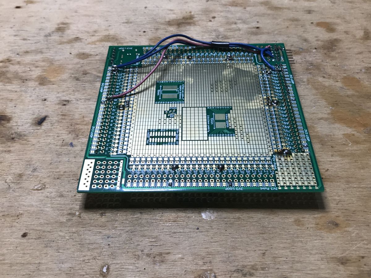

    The 10k resistor between MCLR and VDD has also been soldered (pull-up, forces the high state on the resetting pin):
    (this cable goes from the ICSP connector to the MCLR, it's not the power supply).
    Basically that's it, all that's left to do is get the rest of the pins out. I decided to add one more LED, of course, with a resistor (also in the 0603 housing), with the goldpin output, so that I could connect it to any other pin with a female-female cable.
    PICKIT3 already allows you to program the PIC:
    You can upload blink led:
    Code: C / C++
    The system works and the LED flashes, even when powered by a powerbank (flashlight):

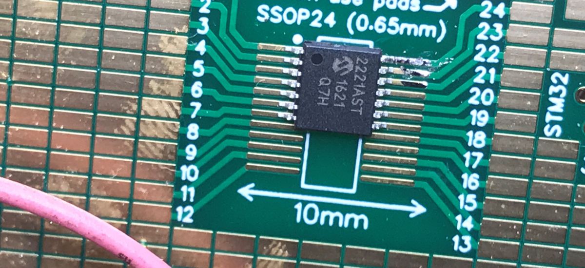

    You can also easily solder additional integrated circuits, e.g. the MCP2221 USB to UART converter:
    I chose the MCP2221 over the MCP2200 as the latter would require an external quartz resonator.
    The MCP2221 itself does not have big requirements:
    In addition, a 10k resistor on the RST pin (pull up), of course a 100nF capacitor for the power supply ...
    There is a place on the board just in time for this layout:
    We solder:
    I led RX / TX to these goldpins to be able to freely decide which PIC pins I will connect to MCP2221:
    Still need a test program ... you need to use PPS (Peripheral Pin Select) to select a pin to assign the role of TX output.
    Code: C / C++
    UART works!
    Now we solder 24AA256, which is 256KBit EEPROM memory with I2C interface:
    Pins defining the address (A0, A1, A2) I will short circuit to ground for convenience. The WP status must also be low to disable the write lock.
    PIC32MZ has no I2C on PPS (Peripheral Pin Select), only on specific pins. But we have 5 different I2C modules to choose from. I chose I2C3:
    We solder:
    Capacitor 100nF:
    SDA / SCL lines to PIC:
    More pull-up resistors for SDA / SCL lines:
    It's time to check communication (at least initially):
    Code: C / C++
    The PIC sees the I2C device with the address 160:
    Now maybe something more banal. Potentiometer, for ADC presentation. In the case of this board, there is a place for it, we solder it like we soldered the RESET button.
    These connections to pins 45/46 are of course ground and power connections. I put the potentiometer between the ground and the power supply, and its tap is the output of the voltage divider, and the ADC reads this voltage from it.
    Code:
    Code: C / C++
    Result:
    The potentiometer works, as you can see on this PCB, you can do even quite a large project, and the prototype spot on top is also useful.

    We start soldering.
    Positioning:
    Universal starter boards for various SMD microcontrollers with a prototype area Universal starter boards for various SMD microcontrollers with a prototype area Universal starter boards for various SMD microcontrollers with a prototype area
    Here I tried to catch the chip with flux:
    Soldering:
    Power block. AMS1117. A bit of binder for the first pad ...
    Jumpers from GND and VDD Loop:
    DECOUPLE pin. A capacitor with a Cdecouple capacity, i.e. 1uF.

    4.7uF capacitor, also from the outlet:
    Binder on the pad:
    Soldered:

    For example, such ATSAMD21G18. I also started a trial with it, however it is not complete as my programmer for it is still on its way.
    This time just a few pics - everything as before.
    If I manage to start it, maybe I will do an ATSAM project on this board and also publish it on the forum.

    Jumpers for ground on the bottom (no power loop here, we'll do it manually):
    VCAP capacitor (10uF, preferably tantalum, ESR
