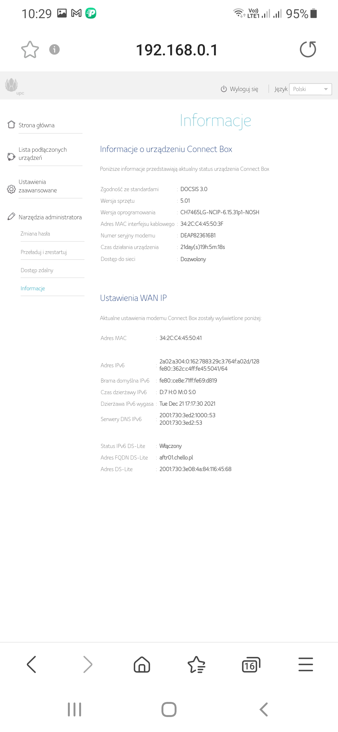

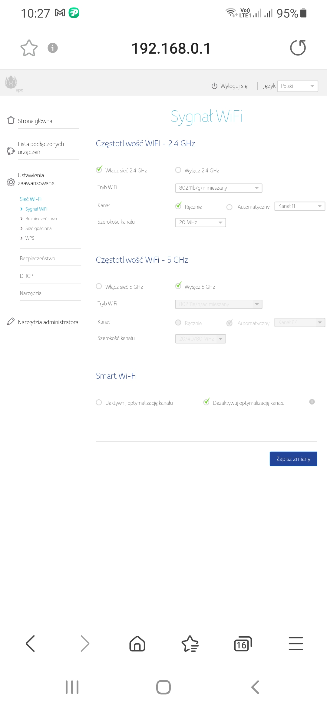

  • #8 19765564
    KOCUREK1970
    Posts: 35666
    Help: 3860
    Rate: 5488
    @mad4max
    UPC uses Smart WiFi in its modem routers - it must be turned off.
    Additionally, the 2.4GHz and 5GHz networks must have a different name and a different encryption key.
    Additional question, what software version do you have on the Connect Box?

  • Smart WiFi must be disabled for pairing
    #10 19765834
    mad4max
    Posts: 24
    emariusz wrote:
    clarify Near how many meters is the room itself?
    During pairing, I am 1-1.5 m from the router.
    Added after 7 [minutes]:
    KOCUREK1970 wrote:
    @mad4max
    I have deactivated smart wifi optimizations. The 5GHz network is disabled, so its name and key do not matter.
    Photos of settings and software versions
    • The UPC connect box router does not connect smart home devices Screenshot_20211216-102948_Samsung Internet.jpg (246.54 KB) You must be logged in to download this attachment.
    • The UPC connect box router does not connect smart home devices Screenshot_20211216-102747_Samsung Internet.jpg (207.85 KB) You must be logged in to download this attachment.
  • Smart WiFi must be disabled on Connect Box
    #11 19765860
    mad4max
    Posts: 24
    KOCUREK1970 wrote:
    @mad4max
  • #12 19765907
    emariusz
    Posts: 82
    Rate: 7
    Sorry for the question, but before trying to pair with the router, did you reset your smart device?
  • #13 19765910
    KOCUREK1970
    Posts: 35666
    Help: 3860
    Rate: 5488
    @mad4max
    You also have active IPv6 there - turn it off with the consultant on the hotline.
  • Disable IPv6 before pairing smart devices

    I did as you wrote.
    Now for some explanations.
    In fact, as you wrote and described in the manual, the smart switch creates the so-called hotspot to connect, but the problem is that before you create it, you also need to provide the name of the network you are connected to. Then in the next steps it creates a hotspot.
    So we return to the starting point.
    When going through the pairing process in AP mode, I enter the name of the UPC router network, move on, the device creates a hotspot and ...... sneezes. There is no connection.
    And now an interesting fact, the same procedure for the AP mode, but in the first step I provide the repeater network or in the second attempt the new TP-Link router and ...... everything goes smoothly and without any glitches. The connection is successful, the switch works, the app sees it.
    So the problem is still the UPC router.
    I have an option that if I cannot solve the problem, although there should be a way, I will leave the TP-LINK router turned on for these smart devices.
    However, I would prefer to connect to the UPC router so as not to crowd the WiFi network with a new router.

    I did as you wrote.

    Switch the CB to modem/bridge mode and connect TPlink - IPv6 must only be disabled on the CB (because if it is active, there is no bridge mode).
    By the way, why didn't you disable ipv6 - this is often a problem (not all servers in the world respond to ipv6).

    Hello after a long break.
    The problem of pairing smart devices with CB has still not worked.
    I solved the problem by remaining on the previously described version with a new TP-Link router added, creating a completely new network exclusively for these devices.
    It may not be what I wanted, but at least everything works.
    Thanks everyone for the tips.
