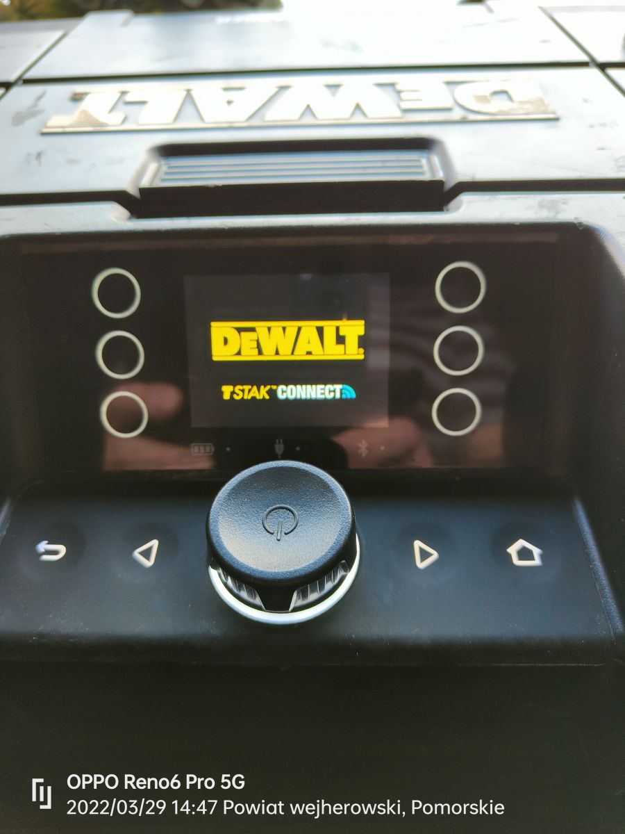

    duchnowd

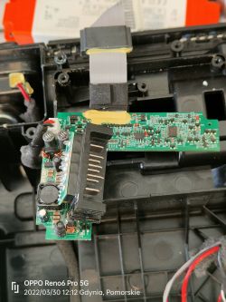

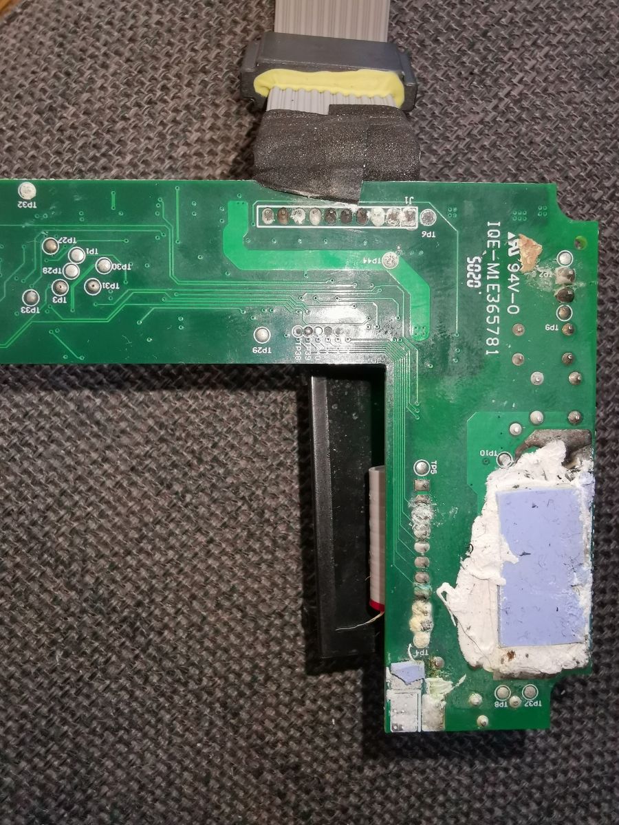

    In the DeWalt DWST1-81078 radio, the part of the power supply that identifies the battery is damaged (the radio works on the power supply - it does not charge the battery and does not want to operate from the battery). I am looking for a person who will undertake repairs, preferably in Warsaw and the surrounding area.
    From what you can see, there is corrosion after flooding.

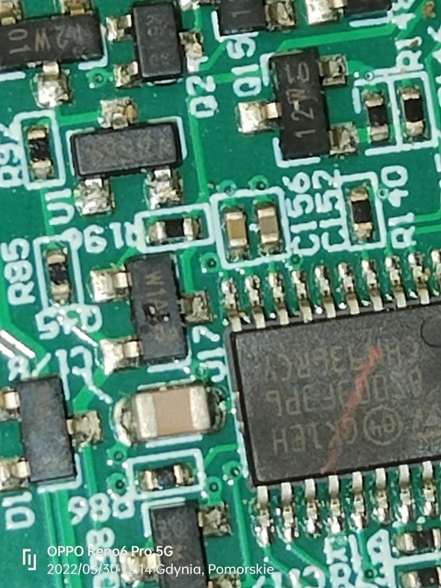

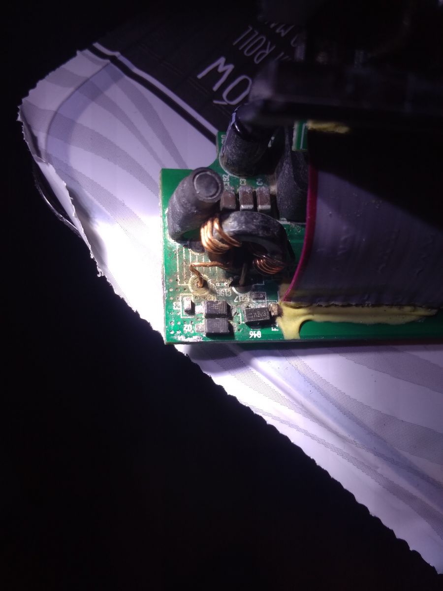

    Hello experts, in my radio, the W1A 05 transistor blew in the power module, if I replace it with a new one, will it work properly or was the cause of the firing something else? Please help. Dewalt DWST1-81078 - charging the battery after flooding - I am looking for a service
  • Identifying a burned W1A05 transistor on charging board
    #3 19957610
    AleksanderP1
    Posts: 33
    Rate: 18
    Hello, I am asking for help in determining the parameter of the transistor that fired W 1A 05. I cannot find the diagram of this 94V-0 IQE-M1E365781 2320 board anywhere. This is the power and charging system in the DeWalt DWST1-81078 construction site radio. The previous speaker has the same arrangement after flooding. Dewalt DWST1-81078 - charging the battery after flooding - I am looking for a service Dewalt DWST1-81078 - charging the battery after flooding - I am looking for a service Dewalt DWST1-81078 - charging the battery after flooding - I am looking for a service Dewalt DWST1-81078 - charging the battery after flooding - I am looking for a service

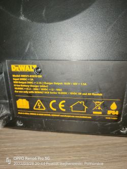

    Hello gentlemen. I have a follow-up question. How to open this radio. I unscrewed all the screws, but the halves do not want to come apart... Something is holding tightly.

    Two screws are hidden under the latches that connect this radio to another box. They are quite deep under this foam.

    They were hidden there and another one under the stickers on the back. Well, the rest is under the speakers cover.

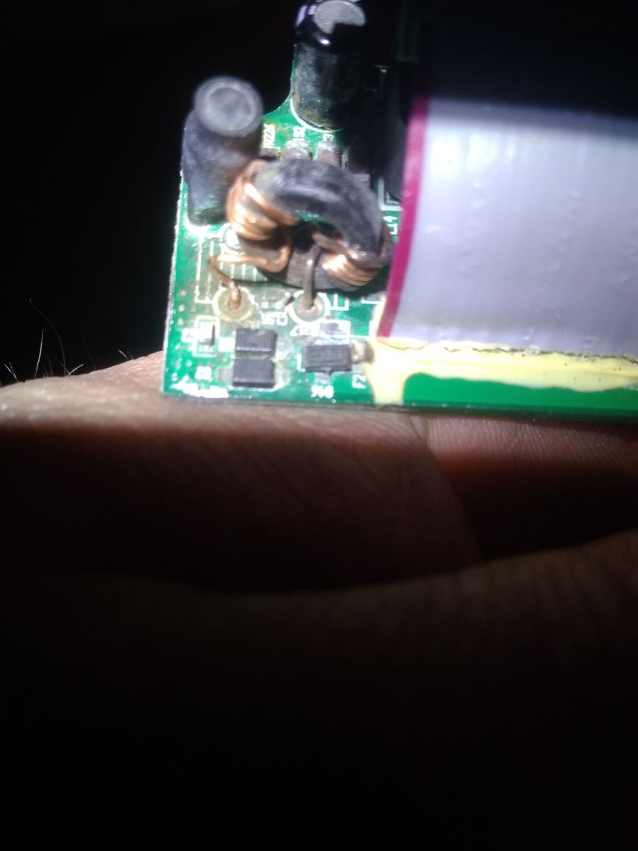

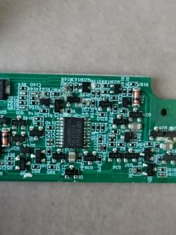

    Hello. i have an identical module after flooding i need identification of the components R17 and Q46 located at the power socket. Thank you in advance for your help.
  • Power supply module component list and markings
    #9 21932004
    Olo80
    Posts: 151
    Rate: 8
    List of components in the power supply module – might be useful to someone :)
    Q46 X7ZL OR X7NX AO3407
    Q47 X7GL
    Q49 W1A
    D2 and D3: D34 or BF Zener 7.5V sod-123
    D35, D38, D39 – marked as D34
    D40 IZ
    R61 1k 0402
    R60 1k 0402
    R15 10 Ohm 0402
    R19 4.7k Ohm
    R143 17.2 kOhm 0402
    R221 R224 224 k 0402
    R223 and R220 27 kOhm 0402
    R217 100kOhm 0402
    R218 100kOhm 0402
    R200 155kOhm 0402
    R226 R100
    C192 C3 C4 11uF 1206
    U11 FC 127 SOT23-5
    U26 4202 6-pin SOT23 TPS54202
