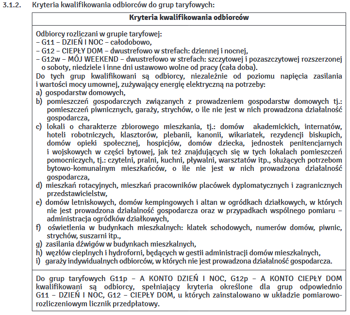

  • Domestic use qualifies for G tariff, business use for C tariff
    #2 19914136
    zbich70
    Posts: 17195
    Help: 1171
    Rate: 6666
    This has already been discussed dozens of times.
    There are two rules:
    - if electricity is/will be used only for domestic needs (specified in the operator`s tariff) - then G tariff you deserve a doghouse,
    - if a business is run in this property, then energy consumption must be accounted for tariff C (of course, only if the owner runs his own business there, and not if he hires, for example, a construction company).
    An intermediate variant - when energy is used simultaneously for household needs and (own) business, then it is necessary to separate both installations and measure them separately.

    Rate: 6666
    stomat wrote:
    URE wrote, contrary to what some people say on this forum...
    Interestingly, the same Energy Regulatory Office approved the "Electricity Tariff for customers from G tariff groups".
    And in point 3.1.2 Criteria for qualifying customers to tariff groups, the condition of not running a business is mentioned four times (subsection b, c, e, i).
    Changing the tariff from C11 to G11 or another one in the "utility building"
