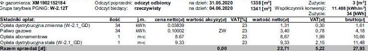

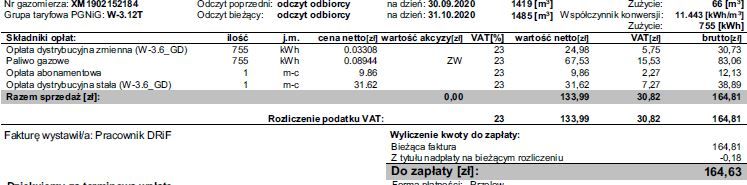

  • #17 19060272
    killer2424
    Posts: 25
    Rate: 14
    Buddy Bucks, I have the invoice in front of me, the gas rate for the W-2.12T is 0.10296 and for the W-3.12T is 0.08944. Hence, five times my eye was the same cost for 1500 kWh.
  • Need invoice tariff details to verify gas bill calculations
    #18 19060295
    BUCKS
    Posts: 3820
    Help: 536
    Rate: 1087
    killer2424 wrote:
    I have an invoice in front of me, the gas rate for W-2.12T is 0.10296 and for W-3.12T is 0.08944. Hence, five times my eye was the same cost for 1500 kWh.
    I took data from the official PGNiG price list for the distribution service:
    03.04.2020... 8_PSG.pdf (1.05 MB)You must be logged in to download this attachment.
    and the retail price list for a comprehensive agreement:
    01.07.2020...a nr 9.pdf (3.15 MB)You must be logged in to download this attachment.
    My invoice corresponds to this price list for the Poznań region where I live.
    For comparison, I have given the rates for the W-3.12T.
    Similarly, I have given the costs of W-2.12T and W-3.12T for the Gdańsk region.

    killer2424 wrote:
    I have a comprehensive agreement with PGNIG Gdańsk region.
    you gave the screenshots and now everything is clear.
    On the invoice scan for W-2.12T you have a rate of 0.10002 PLN / kWh for fuel, not 0.10296, this is your first mistake.
    Secondly, for the W-2.12T you provide an invoice from June 2020, when the rates were higher, I have given the current price list in the post above, just download and read it.
    Please note that in the comprehensive agreement, the rate for gaseous fuel is the same regardless of the tariff, so your mistake is to take different rates for gaseous fuel that are in fact the same.
    However, the rates for the remaining 3 items on the invoice are different and they affect the actual amount of costs, but you have to compare the current prices, not the old ones.
    To sum up, the costs given in my post # 16 are correct, because they are in line with the price list, so base these values on your current invoice for October, you will get how much you would pay if you still had the W-2.12T.
    I did it quickly for you:
    for 755 kWh in October in the W-2.12T tariff you would pay PLN 114.52 net, i.e. PLN 140.86 gross.
    Your invoice scan shows that in the W-3.12T tariff you have to pay PLN 164.81 gross for the same 755 kWh, i.e. you have relatively overpaid PLN 23.95 gross on this one invoice only.
    Now, please recalculate at what consumption costs in W-2.12T are equal to costs in W-3.12T in your Gdańsk region. It is certainly not the 18,000 kWh / year you are suggesting.
    Added after 33 [minutes]:
    out of inborn curiosity, I played with Excel and it turned out that in your Gdańsk region, taking into account the current price lists and assuming their invariability, only gas consumption at the average level of 4,421 kWh / mc, i.e. 53,052 kWh per year will give exactly the same costs in the W-2.12T tariff and in W-3.12T.
    Only from the threshold of 53,053 kWh per year you will start to "save" in the W-3.12T tariff.
    If we take the conversion rate of 11.443 kWh / m3, it gives a level of approx. 4636 m3 per year, which for my conditions is a cosmic value and I would probably have to break windows in order to use so much energy ;)
