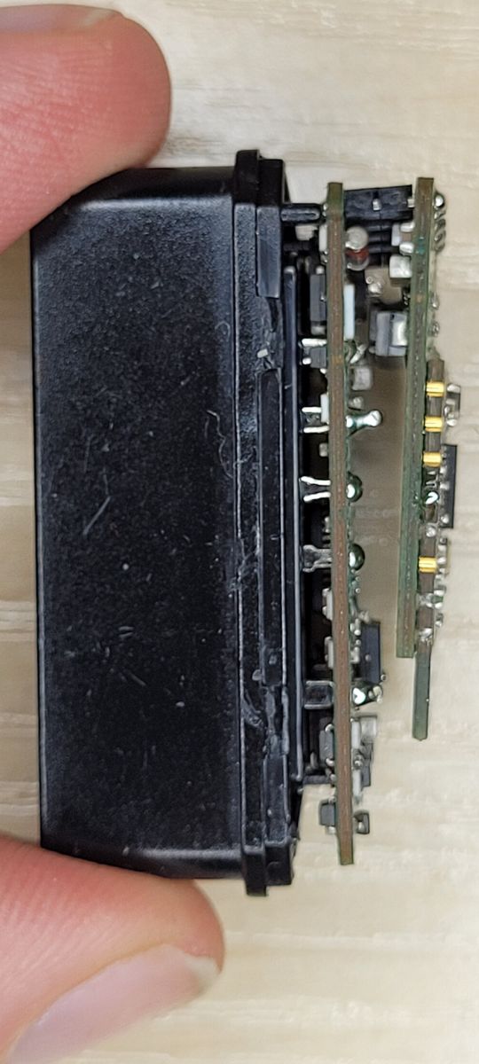

    I present a partial teardown and functional modification
    OBD2 VGATE interface with a WiFi module instead of BT. This interface
    I bought a few months ago and used in conjunction with the android
    Head Unit in the car with the hybrid assistant app.

    The module consists of 2 PCBs delicately connected for a sandwich:
    - the lower one containing a complete OBD2 interface based on PIC18f25k80
    - the upper one containing the HF LPT230 module and the 12V-> 3V3 converter. Conversion of voltages on the PIC18f25k80 line (5V supply)
    is realized by a voltage divider
    Photo of the HF LPT230 module on a PCB with visible traces and components. PCBs of an OBD2 module with WiFi module detached from its casing.
    PCBs are connected with a 5-pin 2mm pitch connector, signals
    LED ELM_RXD ELM_TXT GND 12V
