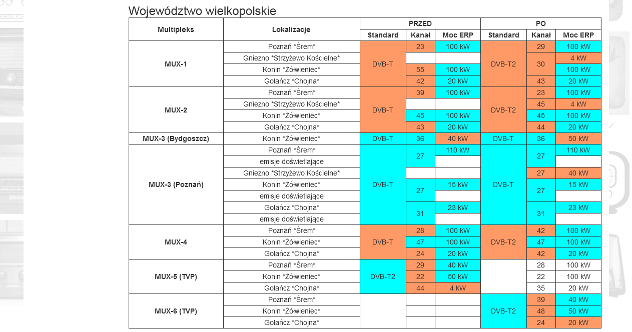

    Hello. After changing the standard to DVB T2, I do not receive MUX 1. When manually searching, the strength and quality for MUX 1 is 0. All other MUX's available in my region are available, both strength and quality 100. I live in a block of flats in Poznań, the antenna on the roof, the neighbors say that they receive all programs. What may be the problem?

    The TV was installed yesterday, the previous one had the same problem since switching to DVB T2. Could this problem be related to the cable from the TV to the antenna jack? Sorry if this is a stupid question, I'm a layman.

    You would need a gauge. presence of signal k.29. Try connecting a decoder and see if there is a good signal on this channel.

    And before changing the standard, did you receive on another MUX TVP receiver / decoder on k.29?
    From many places there are signals that building managers have not modernized collective installations properly. Neighbors may not necessarily receive from the building's antenna. In addition, MUX1 is on the "new" channel.

    make sure everyone; did you receive programs on k. 29 and 27 or only on one of them.
    MUX5 TVP was broadcast on k.29, now it is on 39.
    MUX4 was broadcast on k.28, now it is on 42, do you receive uncoded "Wydarzenia 24'" Polsat?
    The easiest way, as Col. LeDa advises; borrow an external decoder and connect to the antenna cable. Then MANUALLY scan channels.

    MUX 2, MUX 3, MUX 5, MUX 8

    MUX5 on which channel?
    MUX2 is broadcast on the "old" MUX1 channel...
    MUX3 is unchanged and so is MUX8.

    MUX 5 on 39

    It seems that the collection kit is not adapted to k.29.
    Can you connect this TV to another installation?

    I don't have any historical records now - was there ever a broadcast from Śrem on K. 39 or the neighboring ones? This would explain the presence of k.39 in the collection...
    From what I was able to find, MUX 2 was once broadcast from Śrem on k.39

    I noticed that too and edited the post. I have before my eyes descriptive plates in RTCN on diplexer sockets. It was a long time ago but I remember...
