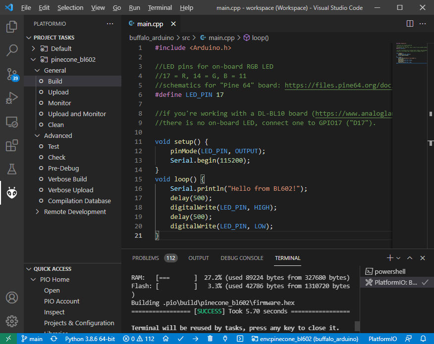

    In addition, for about 9 months, we also have a framework for PlatformIO and VSCode available:
    https://github.com/Community-BL-IOT/pio-bl602-boufallo-arduino-test
    This allows you to program this module similar to Arduino:
    The 5$ DT-BL10 board (BL602 WiFi & BT), new MCU from Bouffalo Lab
    Personally, I have not tested it, but I think that it is a great alternative for beginners and it will certainly make the adventure with this platform much easier for many people.

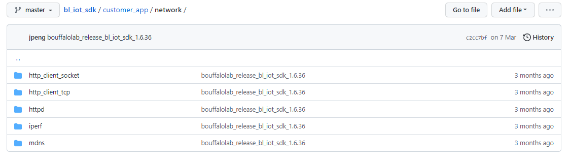

    Examples available
    SDK includes examples of peripherals and available libraries, including ADC, DAC, Flash memory access, GPIO, I2C, PWM, RNG (pseudo-random number generation), RTC, SPI, timers, UART, watchdog), OTA, sockets, HTTP, DNS and a lot more:

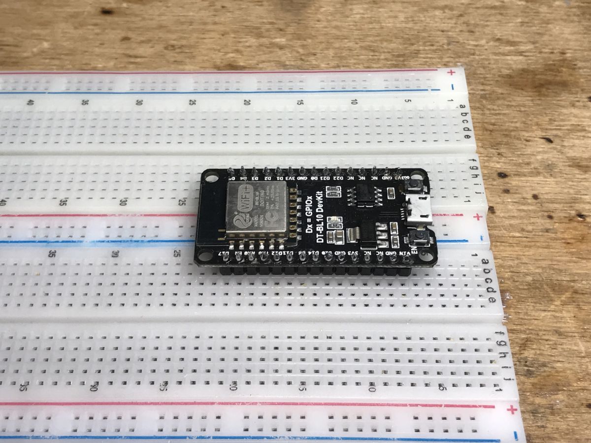

    Working environment
    The module from DT-BL10 is easiest to set on two prototyping boards from one of them we have to disconnect one of the power / ground rails. It is very easy to do with standard prototyping boards:
    The 5$ DT-BL10 board (BL602 WiFi & BT), new MCU from Bouffalo Lab The 5$ DT-BL10 board (BL602 WiFi & BT), new MCU from Bouffalo Lab
    It simply will not fit on one contact plate. Therefore, it is worth remembering to buy two when we are just starting our adventure.
