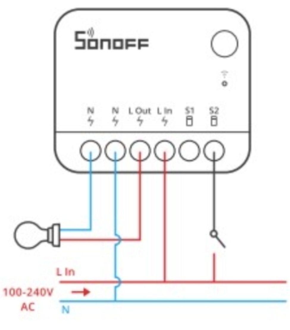

    Hello, I have an Ospel Sonata Touch switch controlling the LEDs in the recess, to this I want to add a Sonoff R4 Mini Wi-Fi relay. The problem arises with the operation, because with a normal switch everything works, but with the touch switch it's like it doesn't detect the change of state of the S2 terminal. I would add that the switch does not work without the KS-2 bypass
    Wiring diagram for Sonoff R4 Mini relay with a lamp. .
