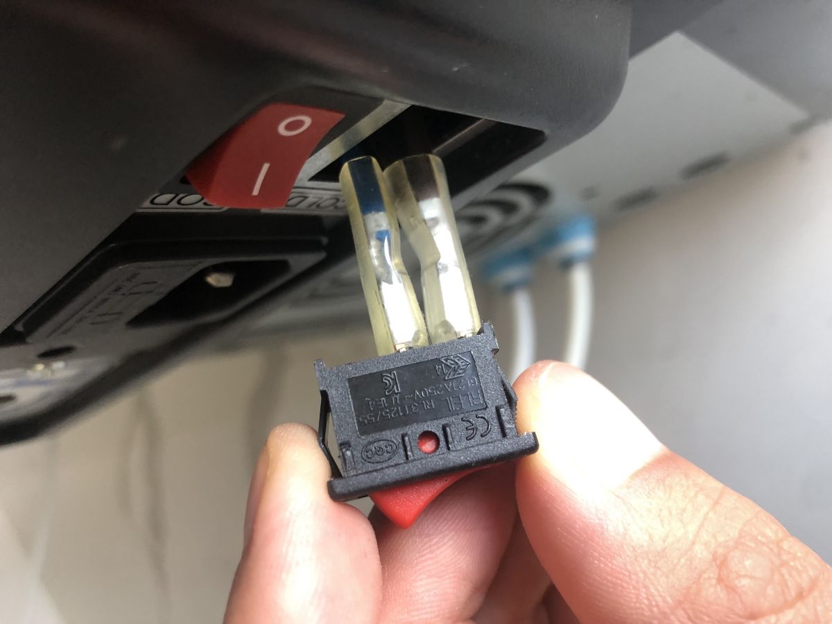

    I would like to replace the rocker switch which in my water dispenser is responsible for switching on the water cooling mode with something smart to make it dependent on the temperature outside. I am starting to remove the switch - can you give me a hint as to which sonoff module would be best for this? Selection of a Sonoff module to control water cooling in the dispenser .
    Should it be a voltage or voltage free switch? Can you recommend anything?

    Can't you give a sonofauge on the power supply to that distributor and that switch permanently on?

    The power supply to the distributor is independent, this switch just activates the cooling function (i.e. if it's on 1, if the water reaches a higher temperature the compressor will turn on). Unless you are talking about fitting a sonoff on the brown cable that goes to this switch?

    A relay circuit connected in parallel to this switch can be sonofem closed.

    Then a voltage-free controller just to simply close the circuit, am I understanding correctly?

    On off, to close the circuit, but it carries current in the circuit, this must be taken into account.
