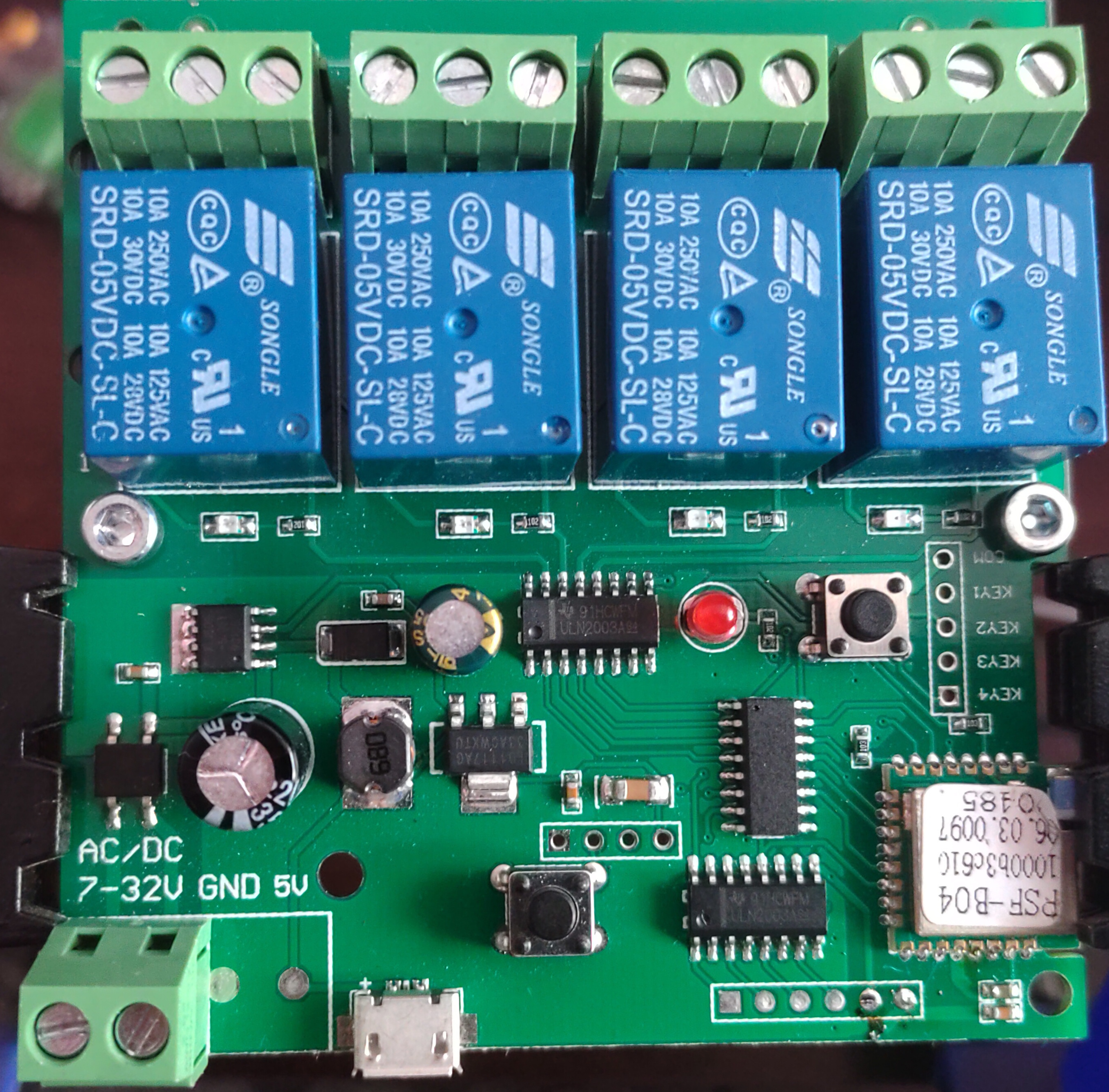

    I've dug up a few modules that go by different names Sonoff 4ch or Geek Creit but that's about it.
    On this module, one of the buttons is responsible for changing the operation of the relays.
    The problem is that if I set it to monostable on/off, the module clicks 3 (out of 4) relays when powering up and when entering programming mode it also switches 3 out of 4 relays and only switches them off after exiting programming and restarting.
    How to eliminate this problem ? In general, is it possible to eliminate this change of operating modes ? It is a pity because I have a few of them and they could be used.

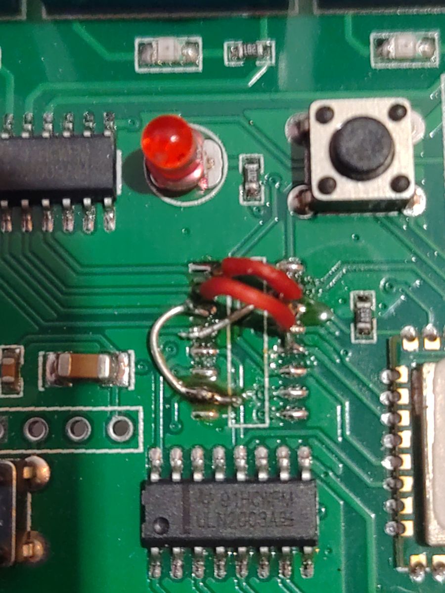

    Circuit desoldered:
    Sonoff 4CH, Geek Creit - Unwanted relay activation during start-up and programming .

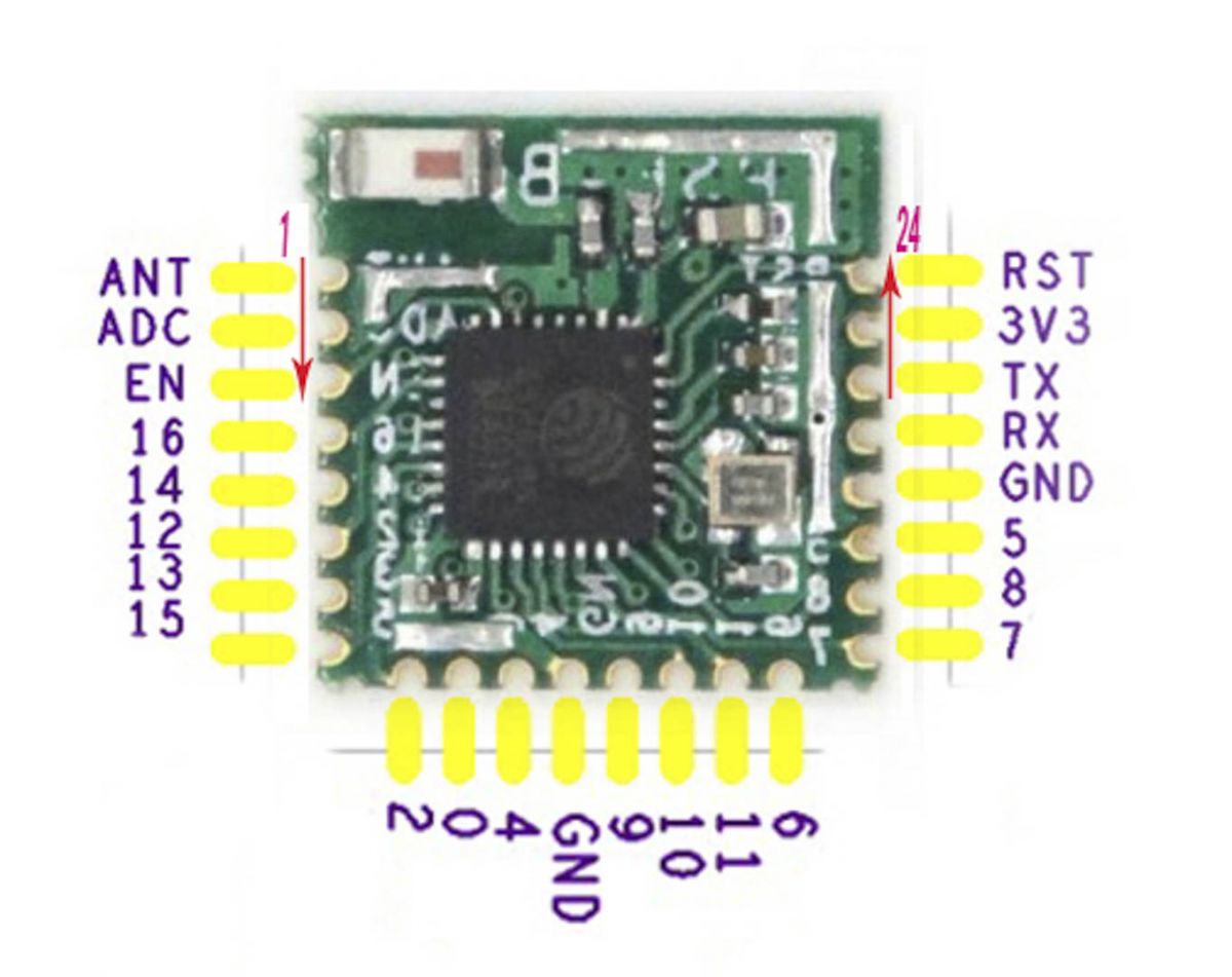

    Now just to pick out the relay control:
    GPIO 12 => relay 1
    GPIO 5 => relay 2
    GPIO 4 => relay 3
    GPIO 15 => relay 4
    So according to this schedule:
    Solder test.
    Effect:
    Initial tests show that it works as expected.
    Maybe it will be of use to someone.

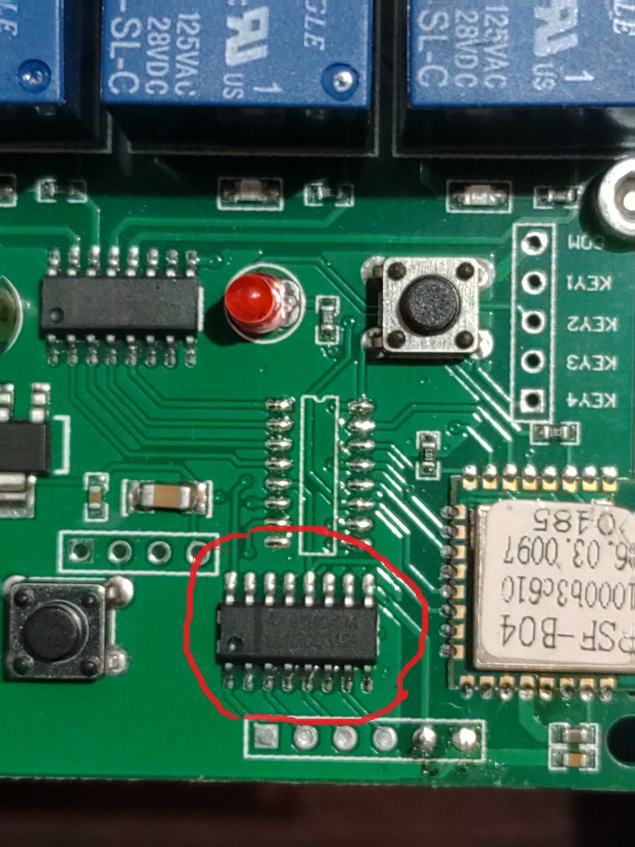

    I also have a question about what the circuit at the ESP at the bottom of the board is responsible for ?
  • #7 19853686
    starob
    Posts: 1088
    Help: 128
    Rate: 137
    It looks as if additional e.g. relays could be connected ?

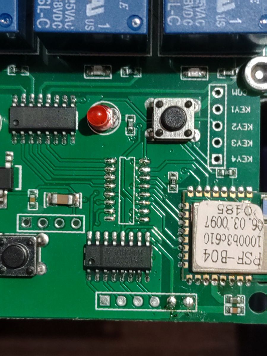

  • Adding remote control via the board’s solder points
    #8 20040759
    Daro1003
    Posts: 2716
    Help: 295
    Rate: 608
    The circuit at the bottom of the board gives you the possibility to control from the remote control when soldered to the below solder points of the radio controller. They are even dedicated to this board and fit in the solder points. The module after the small modification above works nicely as a sonoff 4ch additionally has remote control after soldering the radio controller.
    Thanks gents for your help and non-directional problem.
