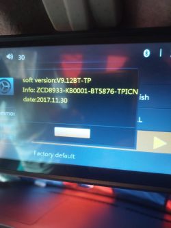

    Unable to connect rear view mirror camera into phone bluetooth, The device name(CARKIT) is listed in phone bluetooth available devices when I tried to pair with the following codes "0000", "1234", "9999" is not pairing. Please check the details below and attached screenshot
    soft version: V9.12BT-TP
    info : ZCD8933-KB0001-BT5876-TPICN
    DATE:2017.11.30
    it could be a great help to rectify this problem
    thanks

    Try bluetooth password 8888
