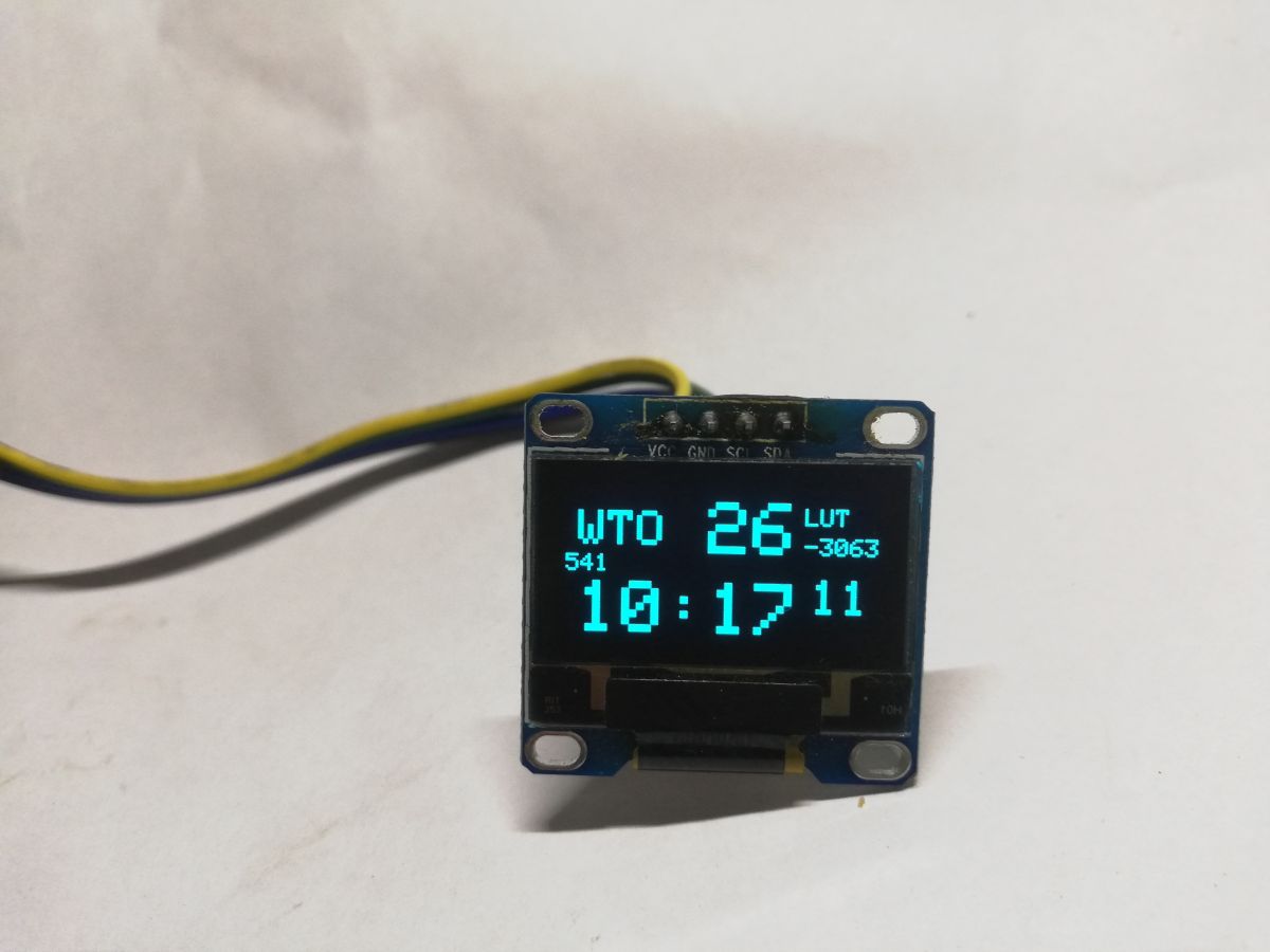

    I found the clock code on the internet. What is wrong? Synchronises correctly only the minutes, and the day of the week:

  • #5 20220335
    qwazi8977
    Posts: 22
    Not working. After changing "int year = ptm->tm_year 3069641;" , it now shows the correct year, previously it showed a space with the value -
    ESP8266 OLED clock code - wrong sync of hour, minute, day of week - help?
  • #6 20220341
    qwazi8977
    Posts: 22
    ESP8266 OLED clock code - wrong sync of hour, minute, day of week - help? Change "int monthNum = ptm->tm_mon 4;", "int date = ptm->tm_mday - 6;". Correct month and day. The hour is still left. :-) .

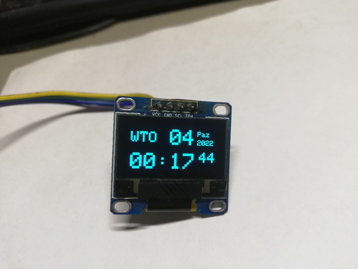

  • Incorrect NTPClient setup keeps time at zero
    #8 20220352
    qwazi8977
    Posts: 22
    None of the above. Date different, to be corrected. Time still 0
    At the moment the code looks like this"
    Code: C / C++
    #9 20221554
    qwazi8977
    Posts: 22
    I got help on the Forbot forum:
    Changing inline: "display.print(hour);" to "display.print(hours);" and removing "if(hour < 10) display.print(1);".
    I consider the topic closed.
    Working code:
