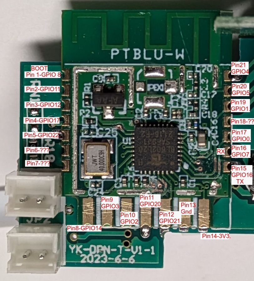

  • The EARU EAKCB-EWE-M circuit breaker uses a PTBLU-W WiFi module based on the BL602 alongside a BL0942 energy-monitoring chip.
  • Tracing the module’s GPIOs exposed 21 pins plus 3 extra pins, and the main board uses 10 of them for LEDs, the button, bistable relay control, and BL0942 UART.
  • The breaker is rated up to 63A, while the relay itself is marked for 60A maximum.
  • OpenBK on BL602 starts at 192.168.169.1 in AP mode, and versions >=1.18.95 may need a 10-second delay before UART activation.
  • Here's details and pinouts for the EARU model EAKCB-EWE-M circuit breaker, purchased from AliExpress in Jun 2025:

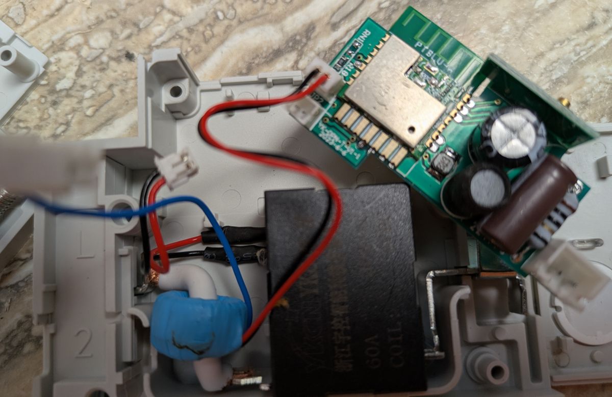

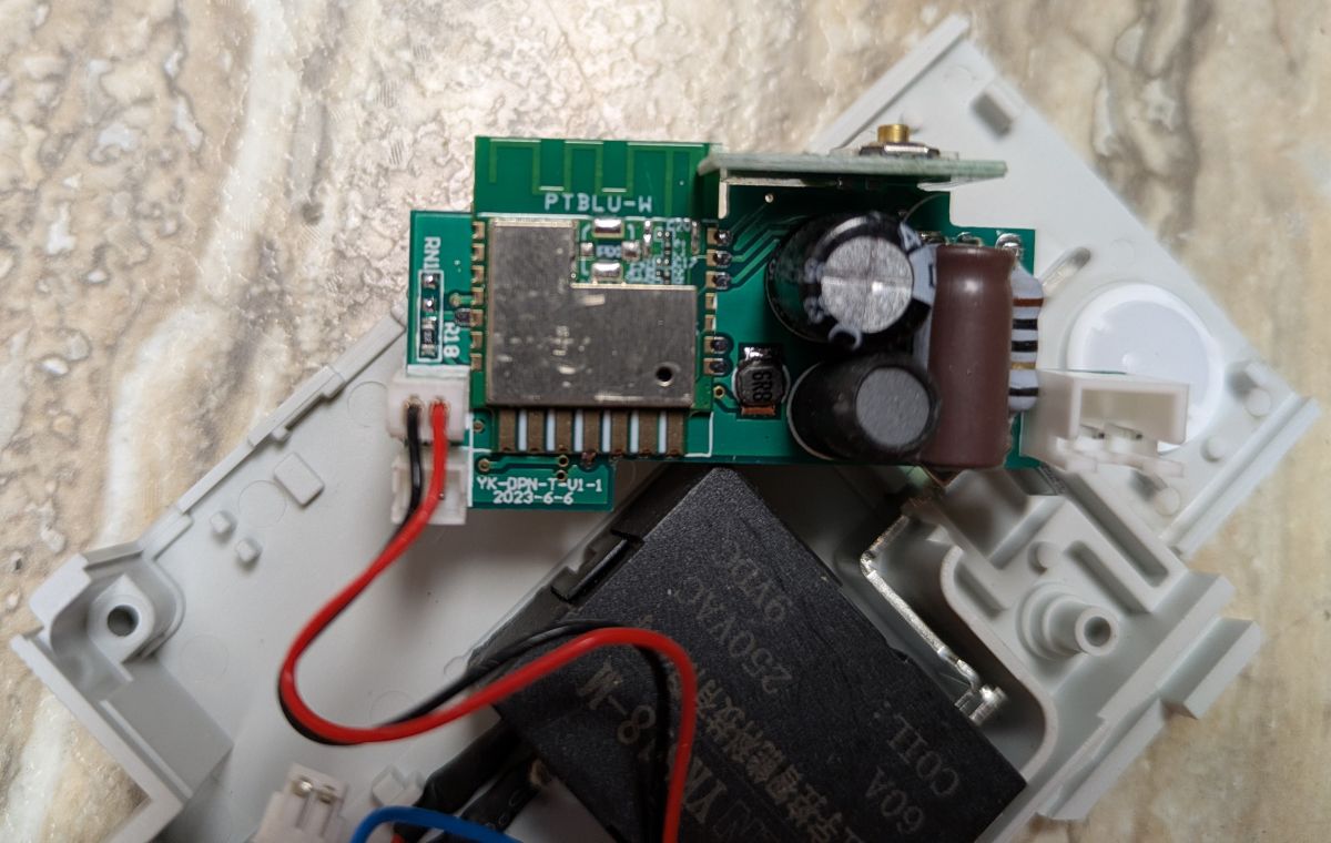

    There's 6 rivets holding the case; you can just drill them out and then the case opens easily. The circuit breaker is rated up to 63A; the relay is marked at 60A maximum.
    [BL602] BL602 PTBLU-W WiFi Module Pinout and Specs in EARU EAKCB-EWE-M Circuit Breaker
    The rest of the construction looks very solid and easily capable of handling 60 amps.

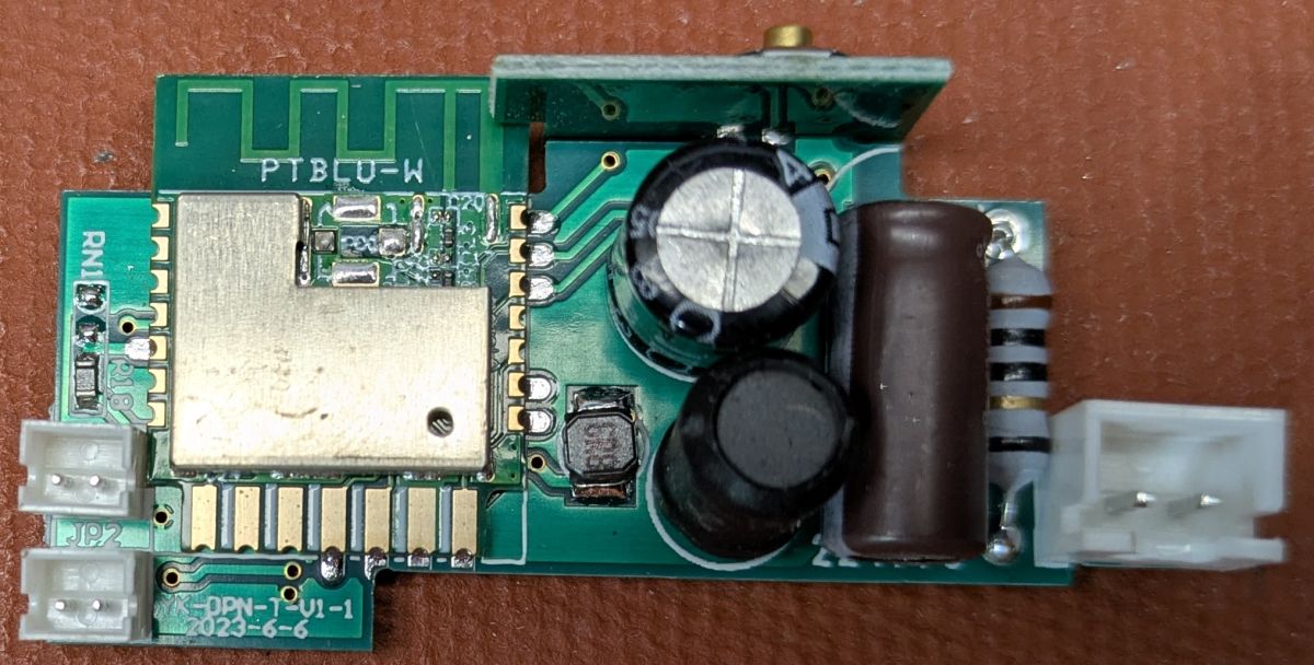

    Apparently these devices previously used a PSF-B wifi module. This one has a wifi module PTBLU-W based on the BL602. The module is mounted on a circuit board labelled YK-DPN-T-V1-1 which is dated 2023-6-6. I could not find any specs on the internet for the wifi module.

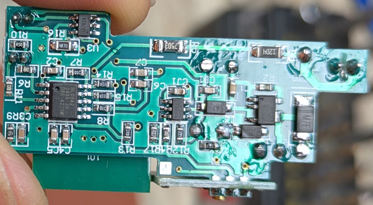

    The power supply has no transformer, so the module should never be powered by mains voltage while testing and measuring signals and voltages on the circuit board.

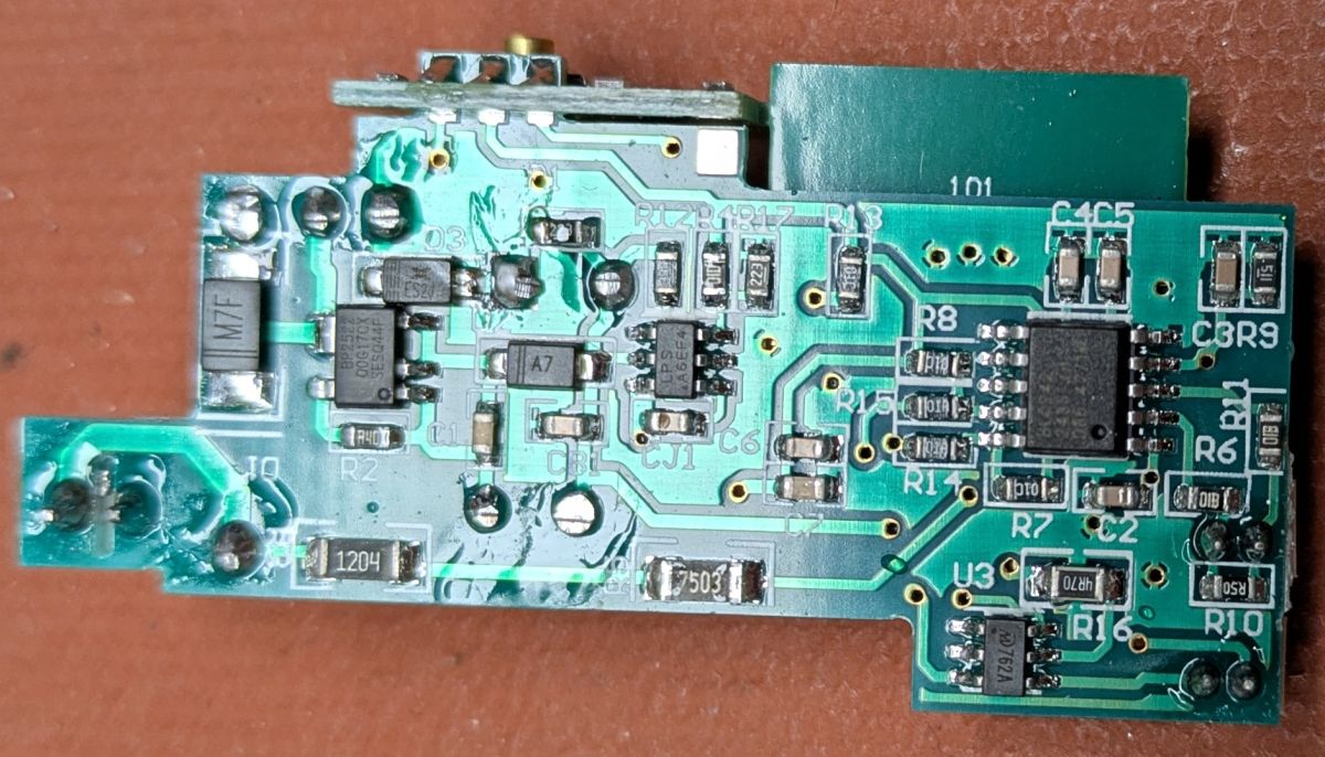

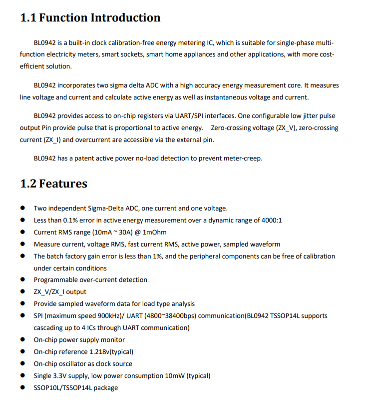

    The EAKCB-EWE-M provides a BL0942 chip for energy monitoring. Here's pictures of the other chips on the back side of the main circuit board. You can read the markings for just about every chip in one photo or the other.

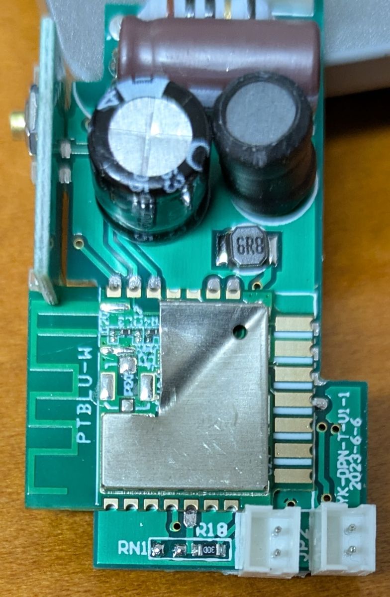

    To inspect the PTBLU-W wifi module, you can bend one corner of the metal shield, but the only thing to see is the BL602 chip marking (but barely visible). To do more investigation, it is necessary to remove the metal shield. If you don't have a hot air gun, you can (permanently) remove the metal shielding with a pair of pliers.
    With some work, it was possible to trace the connection for every GPIO pin for the BL602. The photo below shows the GPIOs for the 21 pins of the wifi module. There seem to be 3 extra module pins. I don't have a hot-air tool to remove the wifi module so I wasn't able to inspect or test the backside of the module.
    The main circuit board only uses 10 of the wifi module pins 5, 11, 12, 13, 14, 15, 16, 19, 20, 21. These are enough to control all the functions of the EAKCB-EWE-M, plus one extra pin that I don't know the function (pin 5 - GPIO 22). The wifi pin mapping is:
    Pin 14 = 3V3
    Pin 13 = Gnd
    Pin 19 = Red LED, relay On/Off (active low) = GPIO 1
    Pin 20 = Blue LED, wifi status (active low) = GPIO 5
    Pin 21 = Push button switch (On/Off, active low ) = GPIO 4
    Pin 11, 12 = Bi-stable relay control = GPIO 20 (Set pulse) and GPIO 21 (Reset pulse)
    Pin 15, 16 = UART TX/RX connecting to BL0942 energy monitoring (GPIO 16, GPIO 7)
    Pin 5 = ??? 200K ohm resistor to 3V3 ??? (GPIO 22)

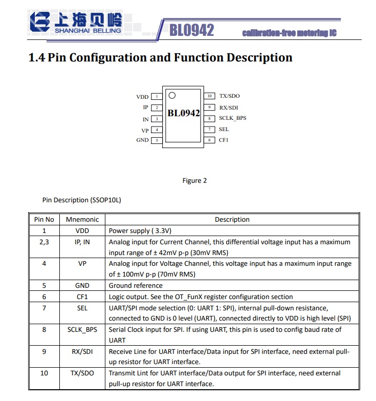

    What in this module acts as a current measurement?
  • #3 21598597
    Posts: 14770
    Rate: 12913
    This information is already included in the description - BL0942 connected via UART. Classic. I have also seen it connected via SPI to the CBU a few times, but much less often. In addition to the BL0942, I also encounter the BL0937 frequently.

    In the picture I see two two-pin connectors, probably one is from the relay and the other is from the current transformer.
  • #11 21603398
    ProfAnderson
    Level 4  
    Posts: 18
    Rate: 10
    I've added another picture in the original description (just after "The rest of the construction looks very solid and easily capable of handling 60 amps.")
    It shows two 2-pin connectors on the left side, for the current transformer and for the relay. There's also a 2-pin connector on the right for the mains voltage (e.g. 240V).
    I hope this helps.

  • The enclosure is held by 6 rivets, and the breaker is sold as 63A, while the relay itself is marked 60A max. [#21598413]
  • The PTBLU-W sits on a board marked YK-DPN-T-V1-1 dated 2023-6-6, and the traced module exposes 21 pins, with 10 pins used by the main board. [#21598413]
  • OpenBK on this BL602 starts in AP mode at 192.168.169.1, not the more common 192.168.4.1 used on other chips. [#21598413]
  • Energy metering uses a BL0942 linked by UART to the BL602 through module pins 15 and 16. [#21598413]
  • The power path uses a current transformer, not a shunt, and the right-side connector carries mains such as 240V. [#21602862]
How do I safely open the EARU EAKCB-EWE-M smart circuit breaker and inspect the PTBLU-W WiFi module without damaging the case or shield?
Open it by removing the 6 rivets, then inspect the shield carefully. 1. Drill out the rivets and lift the case. 2. Bend one shield corner first if you only need to confirm the BL602 marking. 3. Remove the shield fully with hot air, or permanently with pliers if needed. Do not power the board from mains while probing, because the supply has no transformer. [#21598413]
What is the PTBLU-W module in the EARU EAKCB-EWE-M, and how is it related to the BL602 chip?
The PTBLU-W is the breaker's Wi-Fi module, and it is built around a BL602 chip. The module is mounted on a carrier marked YK-DPN-T-V1-1 with date 2023-6-6. The shield can be bent back enough to barely see the BL602 marking, which confirmed the chip family used in this EAKCB-EWE-M unit. [#21598413]
Which pins on the PTBLU-W module are actually used in the EAKCB-EWE-M, and what does each GPIO control?
The main board uses 10 module pins: 5, 11, 12, 13, 14, 15, 16, 19, 20, and 21. Pin 14 is 3V3, pin 13 is GND, pin 19 drives the red LED and relay state on GPIO1, pin 20 drives the blue Wi-Fi LED on GPIO5, pin 21 reads the push button on GPIO4, pins 11 and 12 pulse the relay on GPIO20 and GPIO21, pins 15 and 16 carry UART for BL0942, and pin 5 is GPIO22 through a 200K ohm pull-up to 3V3. [#21598413]

How is current measured in the 63A EARU EAKCB-EWE-M breaker—through a current transformer or a shunt resistor?
Current is measured through a current transformer, not a shunt resistor. The clarification came later in the thread when the 63A path was discussed directly. That makes sense for a higher-current breaker, because the current path can stay heavy while the measurement circuit remains isolated from the full load conductor. [#21602862]
Where are the current transformer, relay, and mains voltage connections located on the EAKCB-EWE-M main board?
The board has two 2-pin connectors on the left and one 2-pin connector on the right. The left-side pair serves the current transformer and the relay. The right-side connector carries mains voltage, for example 240V. An additional photo was added to the original post specifically to make these three connectors easier to identify. [#21603398]
What is the BL0942 energy metering chip, and how does it communicate with the BL602 in this device?
The BL0942 is the device's energy-monitoring chip, and it talks to the BL602 over UART. The traced wiring assigns module pins 15 and 16 to UART TX/RX on GPIO16 and GPIO7. A later reply also confirms that BL0942-over-UART is the expected arrangement in this breaker family. [#21598413]

How does the PTBLU-W BL602 module compare with the older PSF-B module used in similar smart breakers?
This unit uses PTBLU-W with a BL602, while earlier breakers were said to use a PSF-B module. The thread does not provide a full electrical comparison, but it does show one practical difference: the BL602 OpenBK AP page starts at 192.168.169.1. It also notes that internet specs for PTBLU-W were not found, so the pinout had to be traced manually. [#21598413]
What does the unknown PTBLU-W pin 5 connected through a 200K resistor to 3V3 likely do in the EAKCB-EWE-M design?
Its exact function is still unknown in this breaker. The traced fact is clear: module pin 5 is GPIO22 and connects through a 200K ohm resistor to 3V3. Because the thread found no assigned feature for it, treat it as reserved or board-specific until you verify behavior with measurements off mains power. [#21598413]
