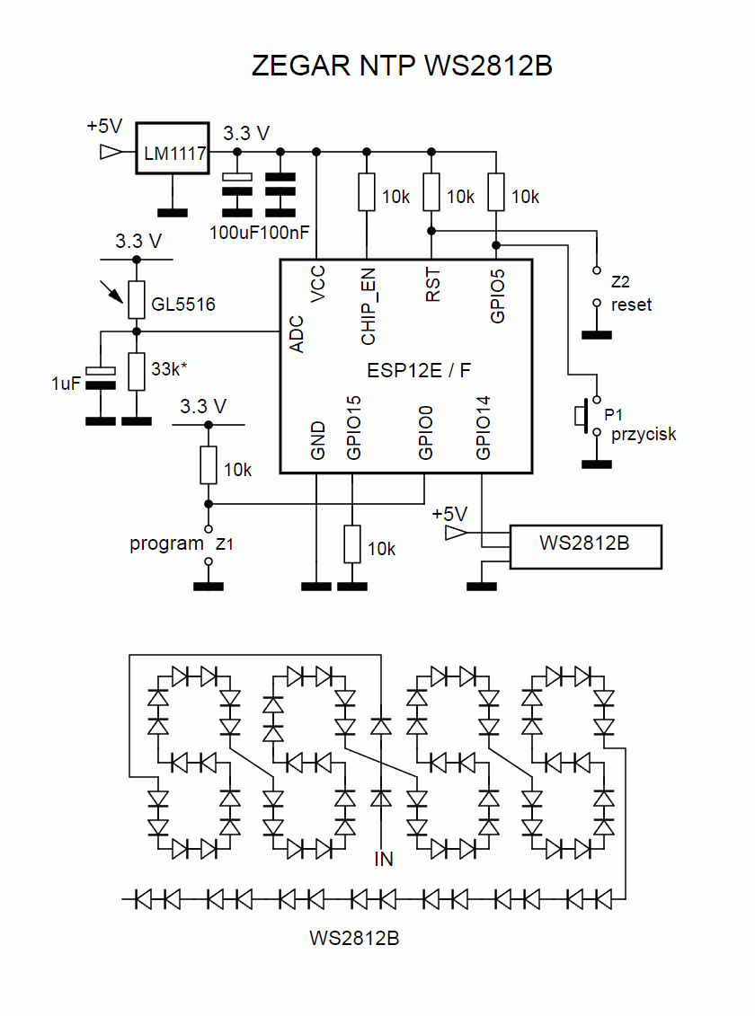

    Electronics:
    Rear view of LED clock with visible electronics.
    I still have to think about the GUI. I am attaching the development code in the Arduino IDE.
    device diagram
    Electronic schematic of an NTP clock with WS2812B LEDs.
    Well, that`s it in a nutshell :)

    Very nice design, but the diagram looks interesting - only a few elements!
  • #3 20854324
    efi222
    Level 22  
    Posts: 779
    Help: 12
    Rate: 1221
    With the exception of the ADC circuit for auto-adjusting the display brightness, these are the basic elements needed for the proper operation of the ESP8266.

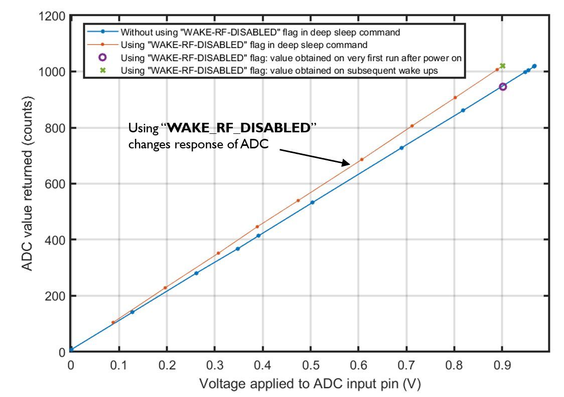

  • ESP8266 ADC divider exceeds 1 V limit
    #13 20855115
  • ADC input limited to 1V on ESP8266
    #14 20855139
    krzbor
    Posts: 1787
    Help: 43
    Rate: 1073
    You are right - the author did not notice that the ADC is up to 1V. Here is my solution for photoresistor-controlled backlighting Link . I used a large resistor to ground (1M) to achieve high resolution in low light, because this is when dimming is necessary.
    It is very easy to make a mistake when connecting the ADC. Such a NodeMCU has a divider at the input and the module pin actually works in the range of 0-3.3V, but this does not apply to the ESP8266 itself, which works in the range of 0-1V

  • 1 MΩ pull-down for better low-light ADC resolution
    #16 20855310
    efi222
    Level 22  
    Posts: 779
    Help: 12
    Rate: 1221
    Mr. @Jarząbek and @krzbor, you are 100% right. You can get confused sometimes with ADC. I remembered this 1V range. But somewhere after that it went into the bushes :D
    The photoresistor is behind a dark glass, so it does not work very well in the bright resistance range.
    I selected the resistor at the ADC input to the ADC value. In a bright room it was about 800. So with some room. In the dark it was down to a dozen or so.
    The fact is that this range worked strangely in very bright rooms.
    So, after your comments, I measured... And now, in bright surroundings, I have 1.9 V, which is almost twice the range.
    But see for yourself in the video how it works. I only sped up the ADC reading interval from 300 to 100ms. Nothing suspicious :D
    I turn the lights on and off in the workshop.
    Thank you for your attention and perceptiveness :)
    In this system, the PWM changes exponentially. (in the code "curve_w[]") . At low values there is greater precision (less changes). This is due to our eyesight, which sees light logarithmically.
  • Logarithmic PWM curve matches human vision
    #17 20855376
    krzbor
    Posts: 1787
    Help: 43
    Rate: 1073
    That`s the point - vision works logarithmically and the ADC doesn`t (it`s linear). Using a large resistor gives reasonable results in low light conditions. Of course, in higher lighting there is almost a maximum ADC reading, but it does not matter. When it`s not dark, the LEDs can work at maximum anyway. Basically, what you have done (overdriving the ADC) is just using the lower voltage range (when it is dark).

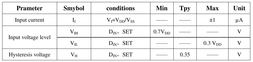

  • WS2812B works directly from 3.3 V GPIO
    #22 20855734
    efi222
    Level 22  
    Posts: 779
    Help: 12
    Rate: 1221
    In earlier designs, I used CD4050 as the driver between ESP and WS2812B. Here I tried without a driver. and It works without any problems.
    I read somewhere that earlier versions of WS2812, without the letter "B", had problems with 3.3V control. But now I won`t answer how reliable a source it was...
    The oscillogram shows the GPIO14 output with the WS2812B connected. 3.52V at peak
    Oscilloscope waveform from GPIO14 connected to WS2812B, showing peak voltage of 3.52V.
    @Andrzej42 I was interested in my friend`s information. Can you take a photo, at least for reference?

    You can also measure the voltage at the tape input in a static state. Only when power is connected.
    Added after 4 [minutes]:
    khoam wrote:
    What is the actual supply voltage to the ESP?
    3.29. On an oscilloscope, this is a software measurement. Well, it shows... Maybe it needs to be calibrated :) (oscilloscope)
    Well, there is no 5V there.
  • WS2812B DIN needs 3.5 V high at 5 V supply
    #25 20855763
  • #26 20855767
    efi222
    Level 22  
    Posts: 779
    Help: 12
    Rate: 1221
    I even had space on the board for this driver. I`ll leave it as it is for now. The watches work for about a month.
    Added after 22 [minutes]:
    I also measured the static voltage at the input of the WS tape powered by 5V.
    Not counting individual millivolts, it is 0V.
    Unfortunately, this may be the effect of the "clamping diode" in ESP (3.52-3.29) = 0.23V, it looks like a Schottky protection diode. The problem is that there is no resistor between the ESP and the WS2812B. If there are feedback signals (of course 5V), some current may flow through this diode. I haven`t found what the max is in ESP8266 for these diodes. But it is safe to assume 1mA or less, so you would need a resistor of at least 2.2k. As @khoam mentioned, the WS2812B chip is slightly outside the high input voltage range. I also had such a problem once and I powered the system with 5V through a rectifier diode. A lower supply voltage will bring us within the range of 0.7VDD

How do you build a large NTP clock from a WS2812B LED strip and an ESP8266?
Build it as a segmented enclosure around a WS2812B strip and let the ESP8266 fetch time from NTP. 1. Print the PLA frame, separators, and diffuser parts, then glue the frame from two pieces. 2. Cut and join the LED strip into seven-segment digits and weekday bars, then mount everything inside. 3. Drive it from ESP8266 code, sync time every hour, and close the housing with a front cover and HDF back. The finished clock uses 79 mm digits and supports multiple colors and animations. [#20853923]

How is automatic brightness control implemented on an ESP8266 clock using a GL5516 photoresistor and the ADC?
It uses a photoresistor feeding the ESP8266 ADC, then maps the reading to PWM with an exponential brightness curve. The author states that the only non-basic part of the circuit is the ADC section for auto-brightness, and later explains that the code uses a curve_w[] table so low brightness levels change more gently. In practice, the sensor sits behind dark glass, which weakens its response in bright conditions. [#20855310]
Why does the ESP8266 ADC input range cause problems in auto-brightness circuits, and how should the voltage divider be chosen?
The problem is that the ESP8266 ADC itself expects up to 1 V, so an ordinary divider can overdrive it in bright light. One commenter calculated about 2.9 V at the ADC with a GL5516 and 33 kΩ to ground, and the author later measured 1.9 V in bright surroundings. A safer approach is to size the divider so bright light stays within 1 V, or bias the divider for better low-light resolution instead of full-range daylight tracking. [#20855139]

ESP8266 to WS2812B at 3.3V vs using a 3.3V-to-5V level shifter — which is more reliable for long-term use?
A 3.3 V-to-5 V level shifter is the more reliable choice. The author’s clock ran for about a month with direct 3.3 V drive, but later admits the design sits at the edge of the WS2812B specification. The thread’s practical conclusion is clear: direct drive may work, yet a proper driver makes the system robust and repeatable. [#20856198]
Why does a WS2812B strip sometimes appear to work directly from a 3.3V ESP8266 data pin even though the datasheet suggests a higher logic-high level?
It appears to work because some real setups tolerate borderline logic thresholds even when the design is outside the stated margin. The author reports stable operation without a driver, and another commenter says 3.3 V control worked flawlessly even at -20°C. The failure fact is that the thread still treats this as out-of-spec behavior, so success on one build does not guarantee long-term reliability on another. [#20857256]
