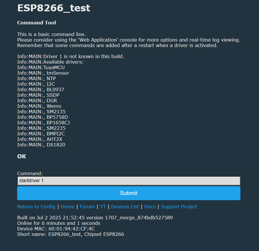

    2mb version to 4mb board. not tested anything
    https://github.com/openshwprojects/OpenBK7231T_App/pull/1707
    Added after 15 [minutes]:
    boot to AP looks like:

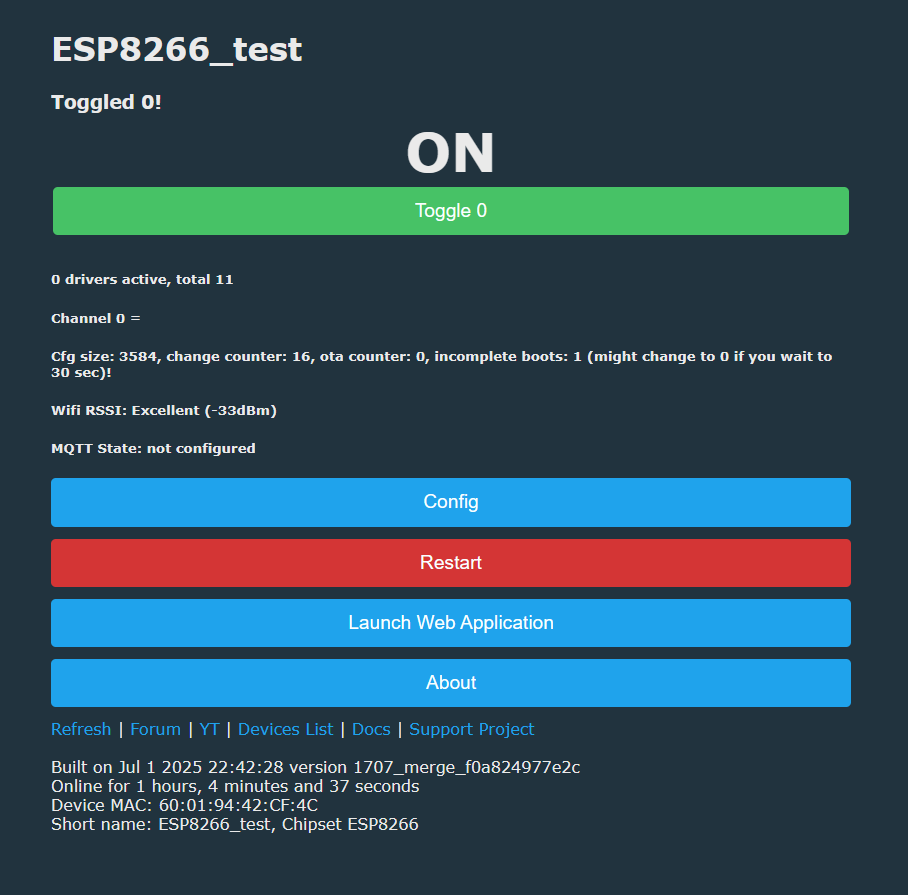

  • 8MB ESP-01S flashed with 2MB OBK image

    2mb version flash and initial boot of that 8mb ESP-01S:
    OTA attempt - fatal exception on reboot

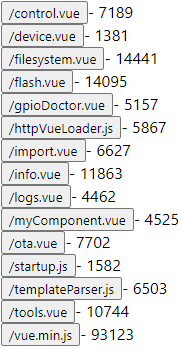

    Well, web app needs about 300kb for a full dist (287278 bytes in my example, after i cut startup.js a little to remove all folders, as i'm not sure if they work in OBK).
    That means that it could be loaded on all bekens, LN882H, RTL8710A, 8mb or more RTL8720D, barely on BL602 (with new partitions, on old it fits fine) and almost on RTL8710B (it has only 274432b).
    I tried it in my WBRG1 and it works.
    Of course if it was minified, it would probably fit on every device (at least minus ~11kb just by minifying templateParser.js and httpVueLoader.js).

    Completely minified web app weigh 195261 bytes. Older vue.min.js allows for additional ~7-8kb size reduction.
    On what it wouldn't fit: ECR6600, ESP8266, 2mb ESP-IDF, all XRs, RTL8710C, W800, W600

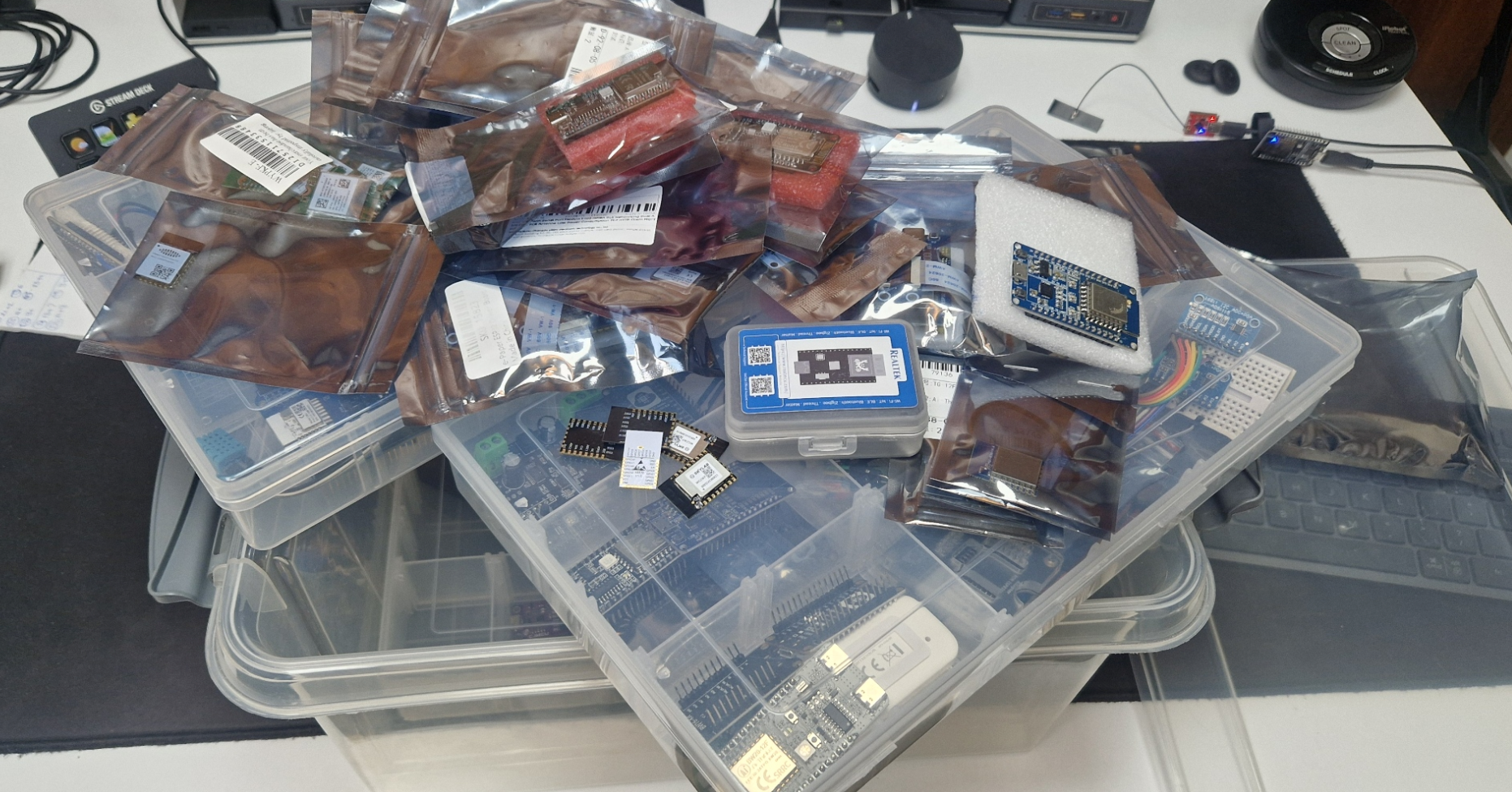

    At this point I have no idea what I have in the box of modules, yesterday I found a W600 module that I forgot I ever ordered, so... maybe 😁
    But as every good alpha tester I'll order some more of course 🙂 pair of each because science!

    insmod wrote:
    You did have BW20, i remember you posted an ali order screenshot with it.
    You made me look!! And yes, you are 100% right, I have them all... even some exotic ones..

    Yeap, all of them...
    Remember I was absent for more than 6 months... because life, and work, and shit... completely forgot about it all. I've been playing catchup for last couple of days, maybe weeks - not even close to get the hang of things....

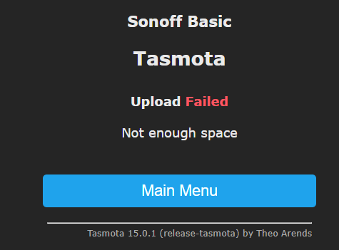

  • OTA from Tasmota requires manually built firmware
    #25 21597261
    Posts: 5215
    Help: 448
    Rate: 917
    insmod wrote:
    There is a possibility to OTA from Tasmota, but firmware must be built manually with this guide
    tried anyway to see what it would do. same with Tasmota and Tasmota-4M

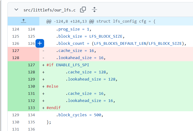

    I like current UI as well. Maybe we could try to flash WebApp automatically with BK7231 Easy UART Flasher, but auto-download button/mechanism seems easier.
    We may also consider adding this change to all platforms:

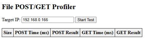

    Flashing OpenBeken/OBK firmware to ESP8266/ESP8285 devices
    This seems to make LFS faster with no real drawbacks at all

    And another idea for device-hosted web app:
    If we could somehow enable Content-Encoding gzip specifically for web app page/scripts, then they could be stored precompressed.

    #30 21597813
    Posts: 14763
    Rate: 12896
    Gzip may be a good idea. The header is not compressed, and it still plain text, it looks like somewhat like that:
    HTTP/1.1 200 OK
    Content-Type: text/html
    Content-Encoding: gzip
    Content-Length: 1234
    Then compressed payload follows.
    Maybe we could add some kind of internal mechanism to LFS access, for example, when MyScript.vue is requested, LFS checks first for MyScript.vue.gzip and if present, returns it as a compressed stream, otherwise fallbacks to default behaviour.
    We would just need an "Upload GZIpped" button on LFS page.
    PS: Here is a little LFS profiller, I will add it to web app soon:
    Code: HTML, XML
