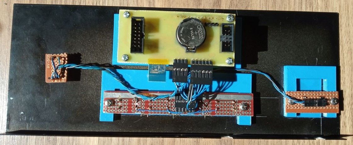

    Preamplifier
    The board with the input selector, digital potentiometer and radio modules allows switching between four signal sources, AUX 1, AUX 2, Bluetooth and radio. Bluetooth implemented on the XS3868 module is turned on only after selecting it as the source, you can jump between songs with the right / left buttons. I tried to change the name and password with uC, unfortunately to no avail. OVC3860 is a nice and cheap module, which can be used as a standalone module or with AT commands to change songs, volume, etc. but changing such a basic thing as the name requires a lot of effort, I do not understand why it could not be done from AT commands. Out of curiosity, I checked how much I gave the external antenna, without the RSSI -90 antenna, with the RSSI -55 antenna at a distance of 1m. FM radio on the TEA5767 module, the frequency is changed with the right / left buttons. The CS3310 digital potentiometer with a preamplifier and a set of filters is taken from the project of my colleague Katakrow, I only changed the amplifier to NE5532. The program does not use the chip amplifier section.
    The common ground for the digital and analog parts is the spout on the top PCB layer; I was not sure if it was a good idea, especially since the lack of space did not allow me to arrange the individual modules in an optimal way, but the whole thing works very well, I can not hear any interference from the digital part.

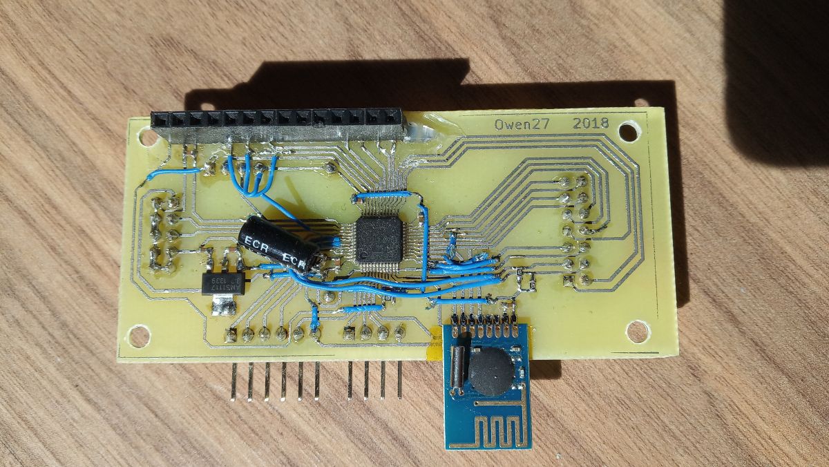

    Controller
    The driver is based on the STM32F100C8T6B microcontroller, of course there is no need to use a 32 bit processor, I chose it to gain experience with STMs. There were plans for a remote control on NRF24L01 modules, which never happened. The blue OLED 16x2 display looks very nice, after two years I did not notice any burned-in pixels, so also a plus. The volume and I / O selector settings are stored in the built-in volatile memory with a 2032 battery, which eliminated the need to detect a power failure. There is terrible tinkering on the tile, it works but it looks disgusting, next time I would outsource it to a tile mill.

  • Long control lines and relay pulses cause hangs
    #6 19206048
    katakrowa
    Posts: 902
    Help: 9
    Rate: 855
    Owen27 wrote:
    sometimes the program hangs and this is where the switch on the back comes in handy
    Congratulations on your persistence. As for the above, long signal / control connections between the boards make the circuit susceptible to hanging, e.g. during the operation of relays.
    High voltage pulses directed directly to the CPU pins are problematic. A good direction is the use of optocouplers. I understand well how much you do not want to do it when we are close to the goal, because although I already know this problem well, I have not equipped another board that I recently designed with these protections :-) Well, you see, laziness is stronger than reason and experience.

    Hmm, 120 VA and soft start? You can, why not, but in this case an unnecessary circuit for such a low power.

    - From what I associate, the XS3868 has the output ground at a different potential than the power ground; and I have the impression that you have them connected together. How is it?
    - Why such a "powerful" processor? This arrangement didn't need one.

    Buddy MUGOL 2, the author seems to have made the tiles according to the description from the link provided by him, so he is not the direct culprit of connecting these masses. And it seems his experience is too little to grasp it.
    I think that you could possibly try to make a signal ground point, connect R604, C604, C606 to it, and the ground of the preamplifier. And then connect this point to the power ground through a 10 ? resistor.

    Why did you make the board for TO220 transistors? This limits the room for maneuver, because most good transistors are offered in housings with a larger lead spacing - TO3P, TO247.

    Will the author praise how he mounted the buttons for this housing?
    Copy amplifier Rotel RA-820
    You can't see anything from the front, i.e. the screws don't pass through. Is the electronics mount on screws to the blue printed plastics that are stuck to the sheet metal? If so, what glue? Well, unless some soldering.
    I would appreciate some tips as DIY faceplates are always a difficult matter.

    Thank you for your comments, if I find time, I will test it.
    pawel_aa who designed the board, claims that the amplifier can work on TO220, I changed the board a bit so as not to bend the legs of the transistors, changing to TO247 will be a problem.
    Exactly, stuck with a droplet.

    pawel_aa, who designed the board, claims that the amplifier can work on TO220, I changed the board a bit so as not to bend the legs of the transistors, when switching to TO247 it will be a problem.
    Just because it "can work" doesn't mean it's the best option. You had to make a PCB for both spacings, you would have a universal one and it would be easy to change the transistors.
