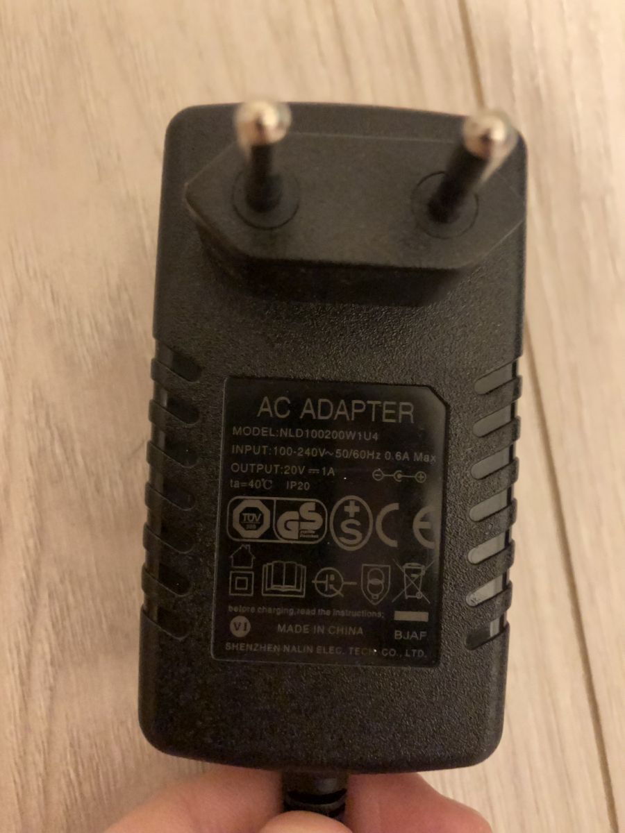

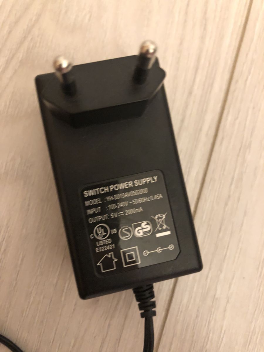

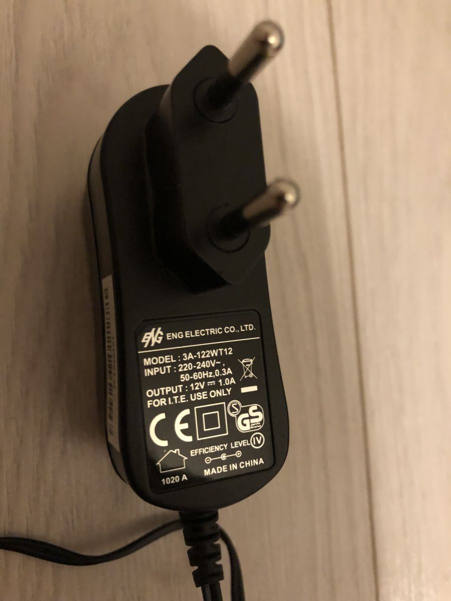

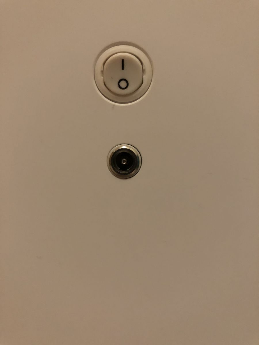

    Lost charger/cable for Townew T1 smart trash: which power supply to use? Lost charger/cable for Townew T1 smart trash: which power supply to use? Lost charger/cable for Townew T1 smart trash: which power supply to use? Lost charger/cable for Townew T1 smart trash: which power supply to use? Hello, I am new to the forum and I apologize in advance if I have put my question under the wrong category. I think only you electrode users can advise me :) I have a problem because I have lost the charger/cable for the Townew T1 smart waste bin. I really can't remember if I had a power supply for it (the kind that goes straight to the socket) or just a cable to plug into the charging cube like a smartphone. 🙂 Some power supplies I found at home (with matching plug) but with different voltage parameters and I would not like to connect them blindly so as not to burn anything in the device. Can I connect one of these power supplies to the device ?
    Thank you very much in advance for your help 🙂

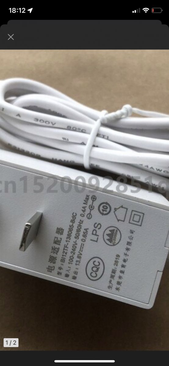

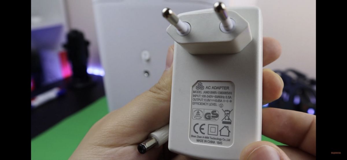

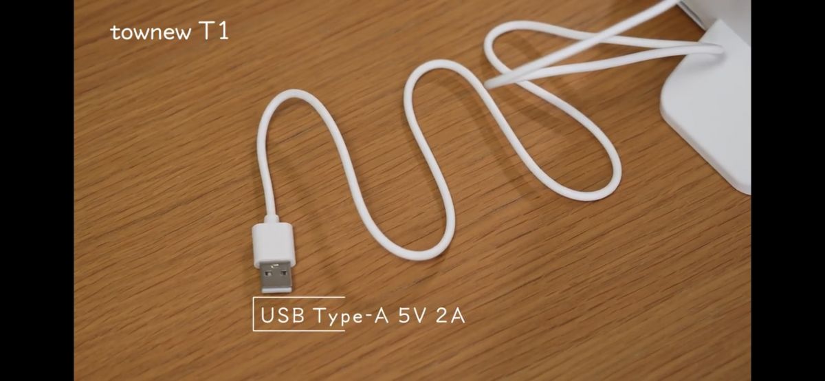

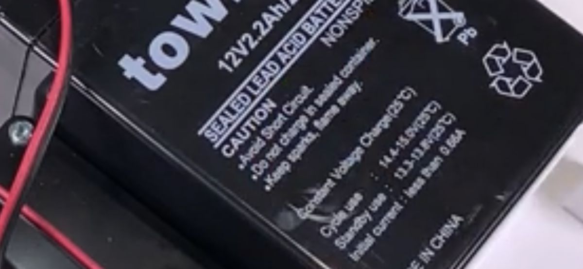

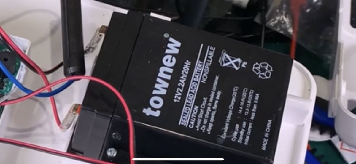

    Here I send you screenshots from a yt video where a guy was fixing something in the same model of dumpster as mine and you can see the battery parameters inside, maybe this will help something :)

    You need a 13.8V 0.65A power supply, unless you have a different version for the USB cable show what inputs you have in the dumpster.

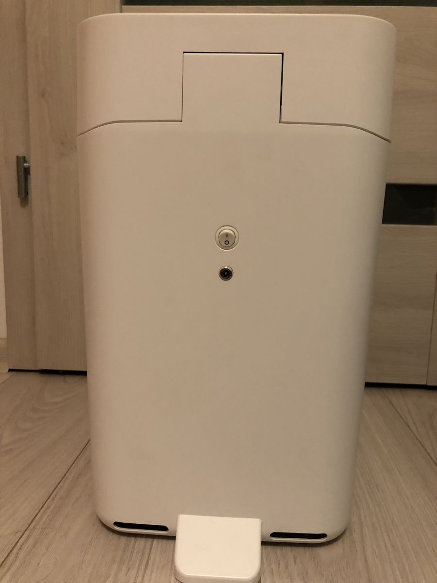

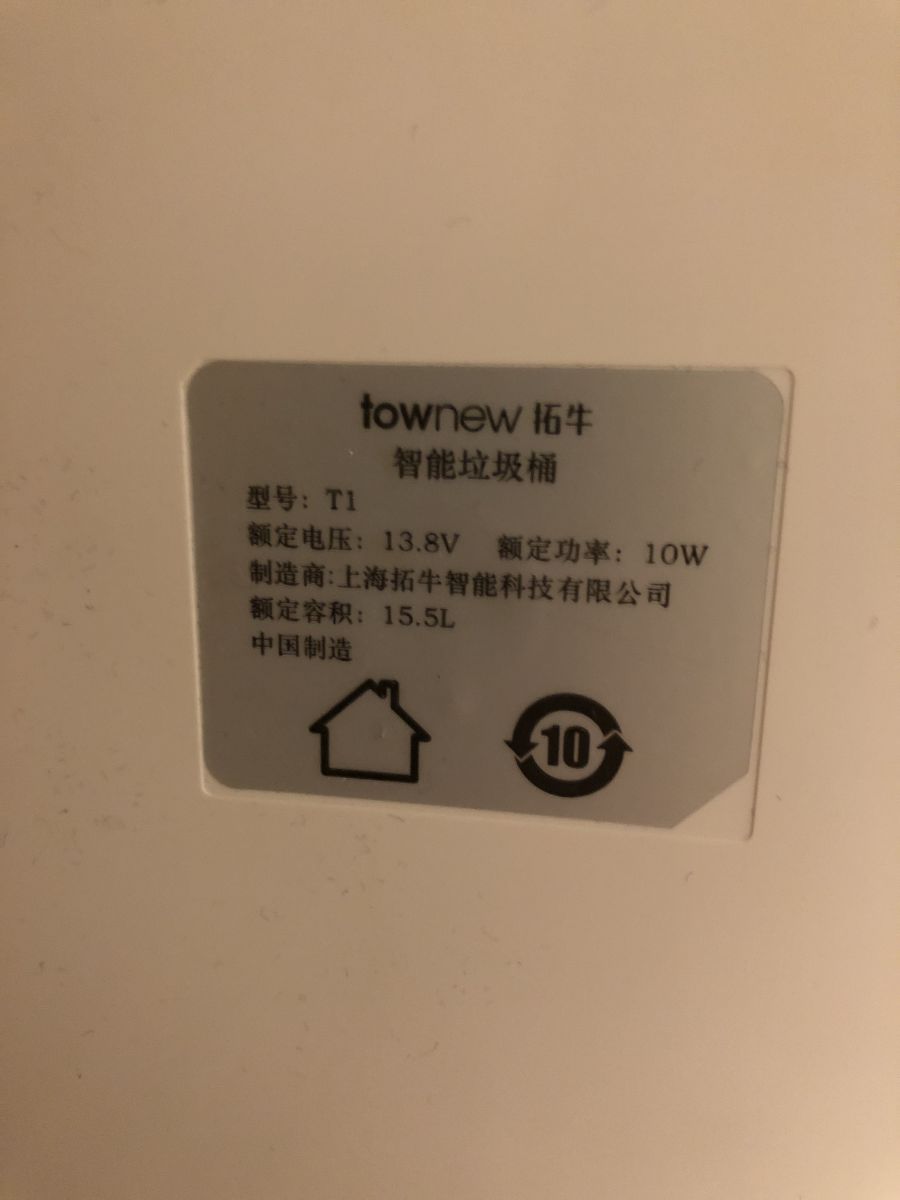

    Lost charger/cable for Townew T1 smart trash: which power supply to use? Lost charger/cable for Townew T1 smart trash: which power supply to use? Lost charger/cable for Townew T1 smart trash: which power supply to use? Lost charger/cable for Townew T1 smart trash: which power supply to use? . Lost charger/cable for Townew T1 smart trash: which power supply to use? Lost charger/cable for Townew T1 smart trash: which power supply to use?
    2 first photos are of my dumpster from the back.
    3 last pics are screen shots from yt how people unpacked their dumpsters (from different parts of the world like Germany, China, Russia). I wonder if I can simply connect one of my power supplies without damaging the hardware, but for example it will charge slower. Or am I left with only alieexpress and buying a charger from 70 zł upwards :( because on allegro are prices cosmos (almost 150 zł) for a power supply model for this particular trash.

    You can buy a 13.8V power pack from Allegro, but you will need to insert a different plug. The ones you have do not fit, or the plug itself may fit.

    Closing the topic, I purchased a dedicated power supply on AliExpress.
