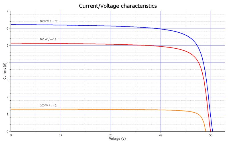

    Figure 1 shows the graph of the current on the characteristic voltage. These values can also be deduced from practical measurements, with certain resistive loads applied to the solar panel itself. As shown in the figure, there are three separate graphs for three conditions under which the device is illuminated by the sun:
    • 1,000 W/m2
    • 800 W/m2
    • 200 W/m2
    The three curves can be summarized in as many mathematical models, which accurately express the course of current values as the voltage varies. The three simple models describing the current-voltage values of the solar panel, at the three lighting conditions, are as follows:

    Figure 1: The graph of current on the characteristic voltage of the solar panel under observation
    Obviously, the solar panel performs at a higher solar illumination, as can be seen from the power graph shown in Figure 2. The user should refer to this graph to assess the actual performance of their solar panel. Remember that power curves are always different, from solar panel to solar panel. By manually collecting the voltage and current values, using different resistive loads, one obtains more or less the same curves, even under the same lighting conditions. The graphs demonstrate, as mentioned above, the presence of a strong non-linearity.

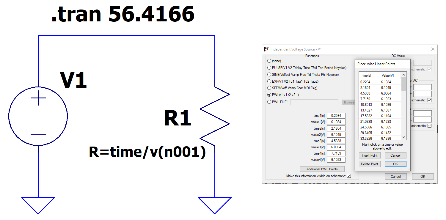

    Once we have obtained the current-to-voltage characteristic of the solar panel, supplied with a light power of 1,000 W/m2, we can create an electrical diagram with LTspice that involves a voltage generator programmed with a sequence of data, corresponding precisely to the different voltage and current points of the device. To achieve this, the simulator’s functionality must be altered a little. In the circuit diagram, shown in Figure 4, a voltage generator in PWL mode is used with the following voltage and current value pairs:
    PWL(0.2264,6.1084,2.1804,6.1045,4.5388,6.0964,7.7159,6.1023,10.6013,6.1086,13.4327,6.1087,17.5832,6.1194,21.0339,6.1298,24.5366,6.1365,29.6405,6.1432,33.3326,6.1386,36.791,6.1235,38.3397,6.1151,39.8958,6.0897,40.962,6.0762,42.0465,6.0442,42.9503,6.0192,43.9702,5.9791,44.7935,5.9482,45.8311,5.8931,47.6347,5.7612,49.3722,5.5612,51.0007,5.2754,51.8803,5.0397,52.5825,4.7801,53.3036,4.4215,53.5758,4.2184,53.8886,4.0168,54.245,3.6588,54.4233,3.4628,54.6171,3.2451,54.9128,2.8736,55.1341,2.483,55.2463,2.2524,55.3904,1.9954,55.5254,1.7288,55.7126,1.4244,55.9848,0.9462,56.1897,0.5251,56.2896,0.3061,56.4166,0.0502)
    The value string is very long but can be entered very quickly in text form. As mentioned before, the value pair represents, respectively:
    • The voltage value of the solar panel (as the first value)
    • The solar panel current value (as the second value)
    SPICE Models for Solar Panels: I-V Modeling, Light Intensity & Temperature Effects
    Figure 4: A solar panel can be simulated with a voltage generator by means of programmed behavior.
    Although this is a simulation in the transient range (i.e., in the time domain), the following should be noted:
    • The value of the abscissas does not represent time but is the voltage of the solar panel.
    • The value of the ordinates does not represent voltage but is the current generated by the solar panel.
