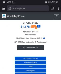

    31.xx is you sure external IP?
    At UPC, external starts at 89
  • #14 19729774
    trivial1
    Level 20  
    Posts: 274
    Help: 36
    Rate: 61
    UPC as a router has IP 89 ...
    And as bridge 31 ..
    So the IPs match up

    There is no such IP anywhere: 31,178,123,456
    There is no such option that when switching from a modem to a modem it will spoil the IP.
    @ aramis93
    So where did it get there: 31,178,123,456?
    Because if this IP is from the No-IP domain, then maybe this redirection does not work yet, because this IP has not spread to DNS servers and nobody knows that it exists (the time can be up to 48 hours).
    Aramis93 wrote:
    In addition, I connected to the No-IP service
    And where, what do you have active No IP?
    It should be active on the modemorouter.

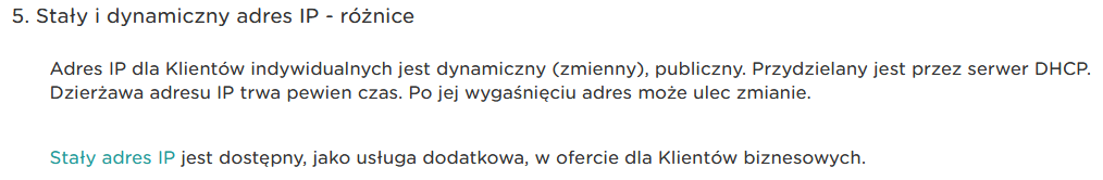

    He changed the ending, as mentioned in 1 post.
    Second, believe me it is done. I don't know why UPC does this, but it does.

    Trigger this IP from DMZ, give it to static IP / DHCP reservation (assign other hardware as well) and only then redirect the ports (first trigger all, save and reenter them).
    Additionally, if possible, reduce (select a specific port number on the server) and enter only this one in Arris for redirection.

    I changed the ending myself, instead of XX123.456, my correct address is displayed to me, but I do not want to enter it on the forum.

  • Public IP should allow direct port forwarding
    #24 19730349
    Aramis93
    Posts: 101
    tomxx wrote:
    if it is like @ aramis93 ... you can use hamachi VPN app - only everyone must have it installed then to play with you ...
    I can, but I don't want to, since the IP is public and the hotline stated that it should work without such solutions, I want it to be "God's way". If I plug in my router, it will also work, but that's not the point. Since they declare that it is possible, I will either do it as it is possible or I will play a complaint battle with them :)

  • #28 19730453
    Aramis93
    Posts: 101
    trivial1 wrote:
    And arris has no WAN input, I think, only a built-in switch
    This is exactly what it is. But I say - by of the official position of UPC, there should be no such problems and everything should work.
