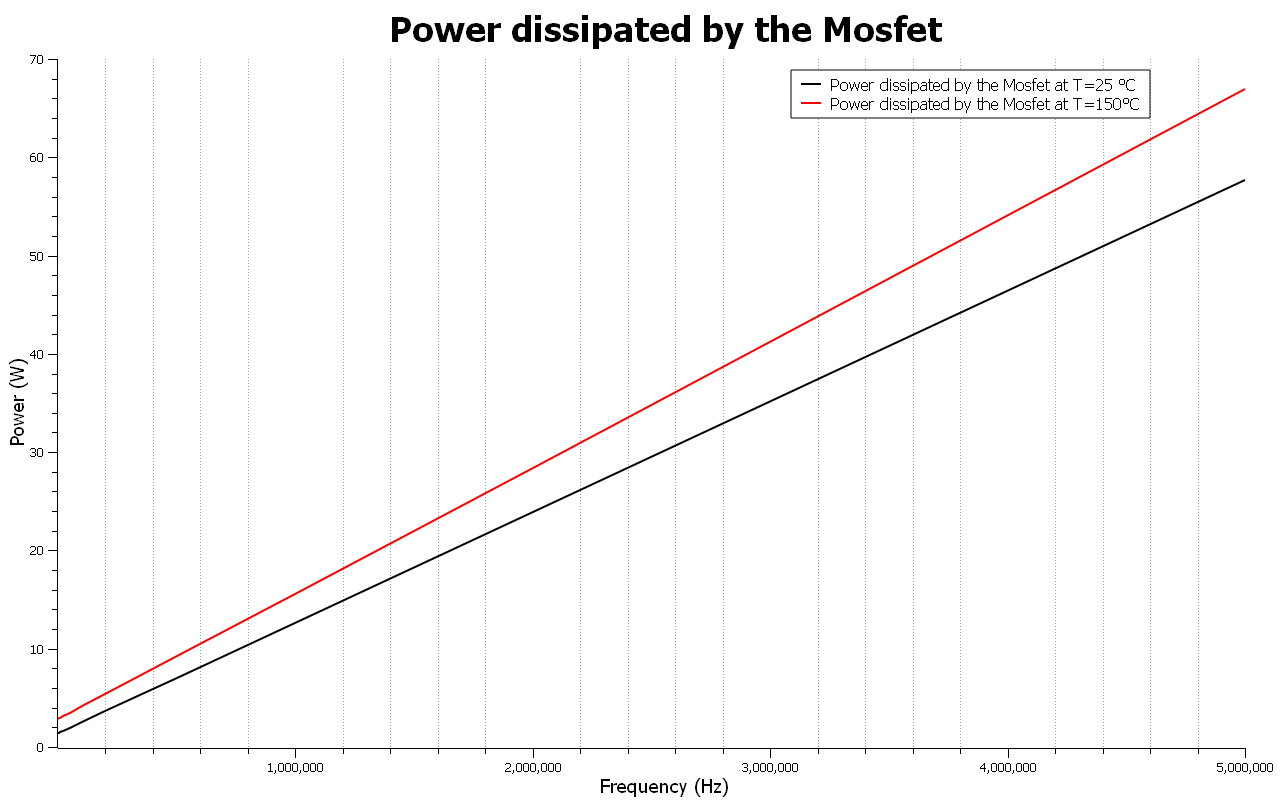

    Dynamic regime
    In the dynamic regime, with a PWM signal characterized by a duty cycle of 50% and a voltage of 25 V, the average power dissipated by the device is half that of DC operation, as there is a conduction half-period and an interdiction half-period. The percentage of efficiency, in this case, changes in relation to the switching frequency and junction temperature. To carry out the analysis of the power dissipated by the MOSFET and the efficiency of the system, in the transient, the following SPICE guidelines should be used:
    Tutorial: Cooling MOSFETs to Maximize Their Efficiency in Dynamic Systems
    These simulation analyses allow us to observe graphs of the efficiency of the circuit in relation to frequency (see Figure 2) and of the power dissipated by the MOSFET, again at various drive frequencies (see Figure 3). As can be seen in the two graphs, the ability to change the temperature of the MOSFET case or junction allows for more accurate and realistic electronic simulations. The graphs refer to the same supply voltages of the circuit, the gate of the MOSFET and to the same value of the resistive load used.
    Figure 2: The graph of the circuit efficiency vs. the driving frequency of the MOSFET
    Figure 3: The graph of the power dissipated by the MOSFET vs. the frequency of its driving
    In static regime, MOSFETs work very well due to their high input impedance and ability to drive very large currents. However, when they are to be driven by PWM, their efficiency may decrease. PWM involves a high switching frequency, which can cause high levels of thermal dissipation and reduce the life of the MOSFET. In addition, non-ideal response capabilities to rapid voltage changes can cause distortion and decreases in efficiency due to power losses. For these very reasons, it is always essential to use a good driver.
