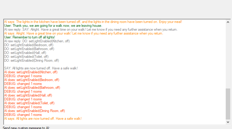

    Continued - you can ask the AI to turn off all the lights:
    Home assistant for controlling lights - prompt ChatGPT - OpenAI API in action

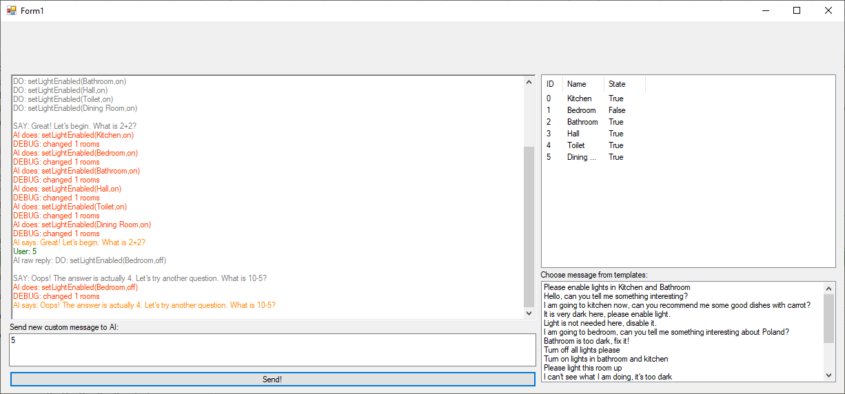

    Now for the most interesting experiment. Let's propose an AI game - the AI turns on all the lights and asks the user math questions. If the user answers incorrectly, they turn off one light. Will AI make it?
    Let's start the fun:
    Let's play a game. First turn on all lights with DO. Then ask me math questions. If I answer correctly, do nothing. If I give wrong answer, use DO to turn off random light.
    It seriously works:
    Unfortunately, after a while there is a problem... the language model spilled on multiplication:
    I'm hoping GPT 4 will be a bit better at this.
