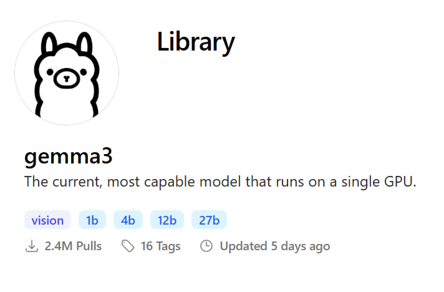

  • Profile screen of the gemma3 library with an illustration of a llama.
    Are you trying to run latest Gemma3 multimodal AI models, but keep getting error 500 in Ollama WebUI?
    Here's a solution, but first few words about Gemma 3. Gemma 3 is collection of lightweight, open models built from the same research and technology that powers Gemini 2.0 models. Gemma 3 models are designed to run fast, directly on devices and come in a range of sizes (1B, 4B, 12B and 27B), allowing you to choose the best model for your specific hardware and performance needs.
    These models are very easy to download from Ollama Library and run, but Ollama Docker Package comes with obsolete Ollama version 0.6.1, so you can't run new them directly, at least until the Docker package is updated. I'll show a simple work-around here.

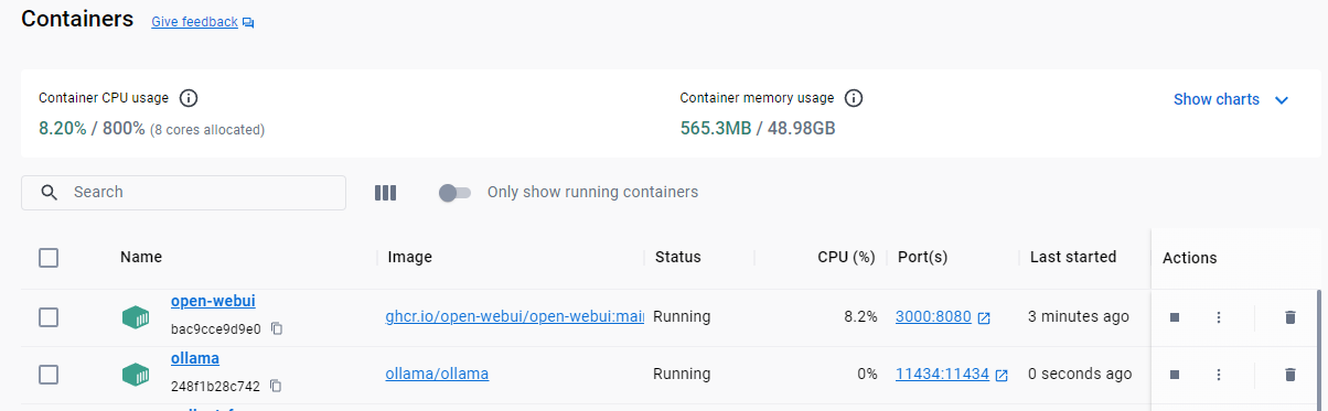

    So, I'm assuming you already have a Docker setup like that:
    Screenshot of container management panel with CPU and memory usage data.
    You have Ollama core and Ollama Web interface both running in docker.

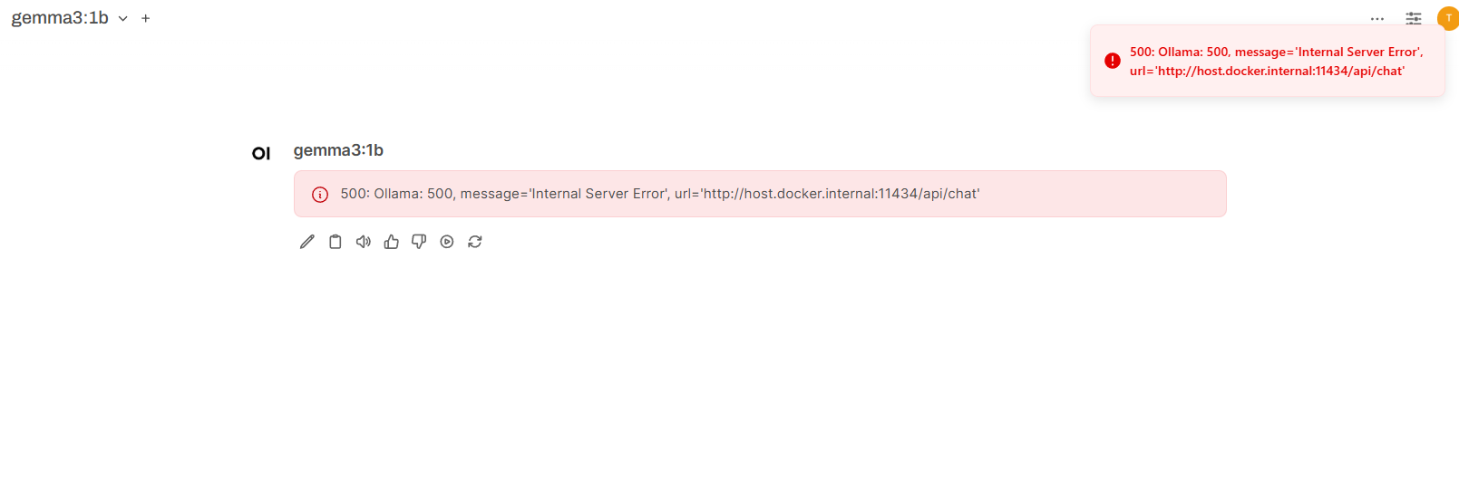

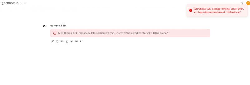

    You have also probably already downloaded Gemma3 in your Ollama Web UI, but when you try to run it, you'll getting:
    500: Ollama: 500, message='Internal Server Error', url='http://host.docker.internal:11434/api/chat'
    Just as on the screenshot.
    Screenshot showing an internal server error with the message 500: Ollama: 500, message'Internal Server Error'.
    The cause of the problem
    This is caused by Docker using obsolete Ollama core, namely version 0.6.1, at least in my case. You can check it by running:
    C:\Users\user>docker run --rm ghcr.io/open-webui/open-webui:ollama ollama --version
    Warning: could not connect to a running Ollama instance
    Warning: client version is 0.6.1
    I've tried to update it, but found no way to do so. Luckily, there is a workaround...

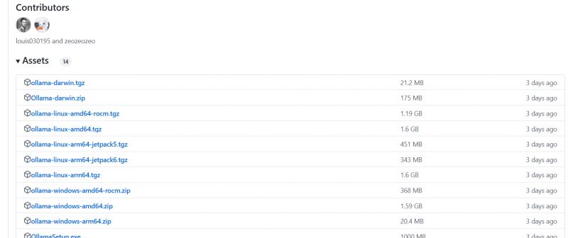

    Download Ollama directly from the Releases tab:
    https://github.com/ollama/ollama/releases/tag/v0.6.2
    Choose package for your OS, in my case it was ollama-windows-amd64.zip.
    Screenshot of a webpage showing a list of downloadable assets with file size and update date information.

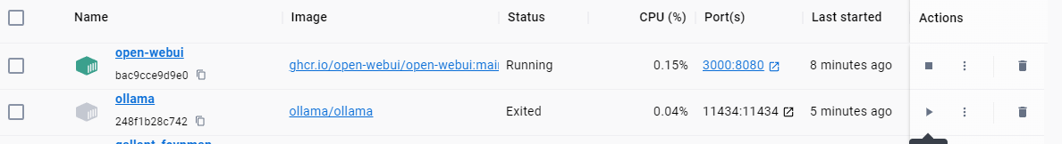

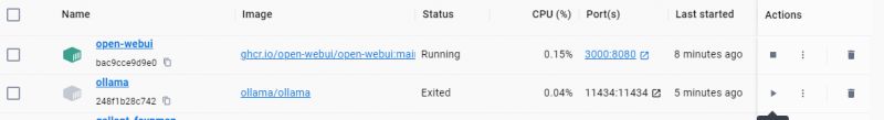

    Shutdown ollama in Docker first:
    Screenshot showing a list of containers with their details, including names, images, status, CPU usage, ports, and last started time.
    Extract it and run, as in:
    ollama.exe serve
    Now, as long as port settings are matching, your Ollama WebUI from docker should be able to reach the new ollama core. You can also check it's version:

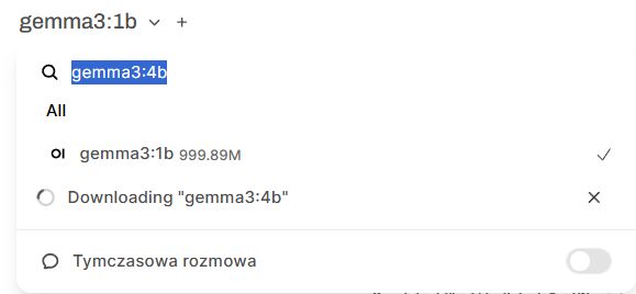

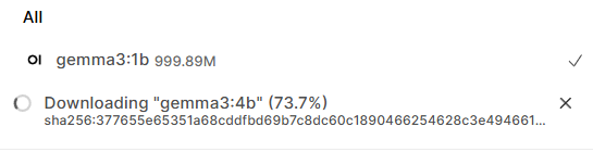

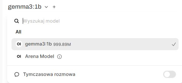

    This will mean that you'll have to redownload AI models. I've downloaded only smallest Gemma so far.
    Screenshot of AI model selection menu with the gemma3:1b 999.89M option selected.
    You can also download a bigger model:
    Interface of a program with a search and download of gemma3 file.
    File download interface showing progress for the file gemma3:4b.

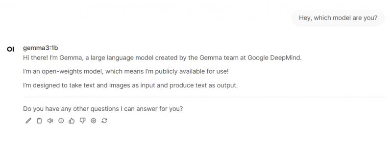

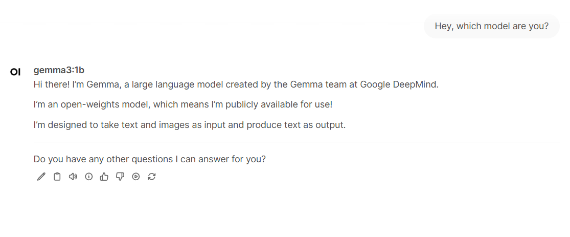

    Let's check if it works
    Screenshot of a conversation with the Gemma language model.
    Now, a word of warning - smallest 1b model with not work with images, so I suggest starting with 4b.

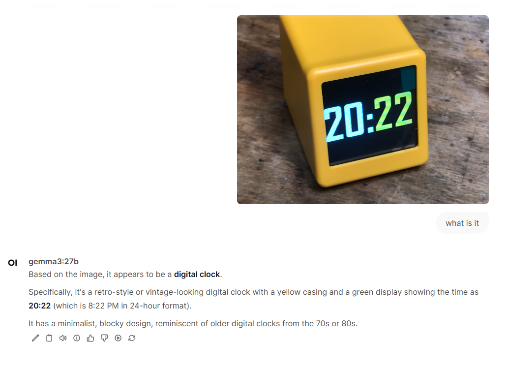

    It's time for some little Gemma 3 testing. I've played around with it a bit and decided to showcase 27b model, as it seems more reliable than smaller ones, obviously. Yet I can still run it on my 7 years old ROG gaming notebook.
    Digital clock in a yellow casing showing the time 20:22.
    Nice, it can read the time correctly.

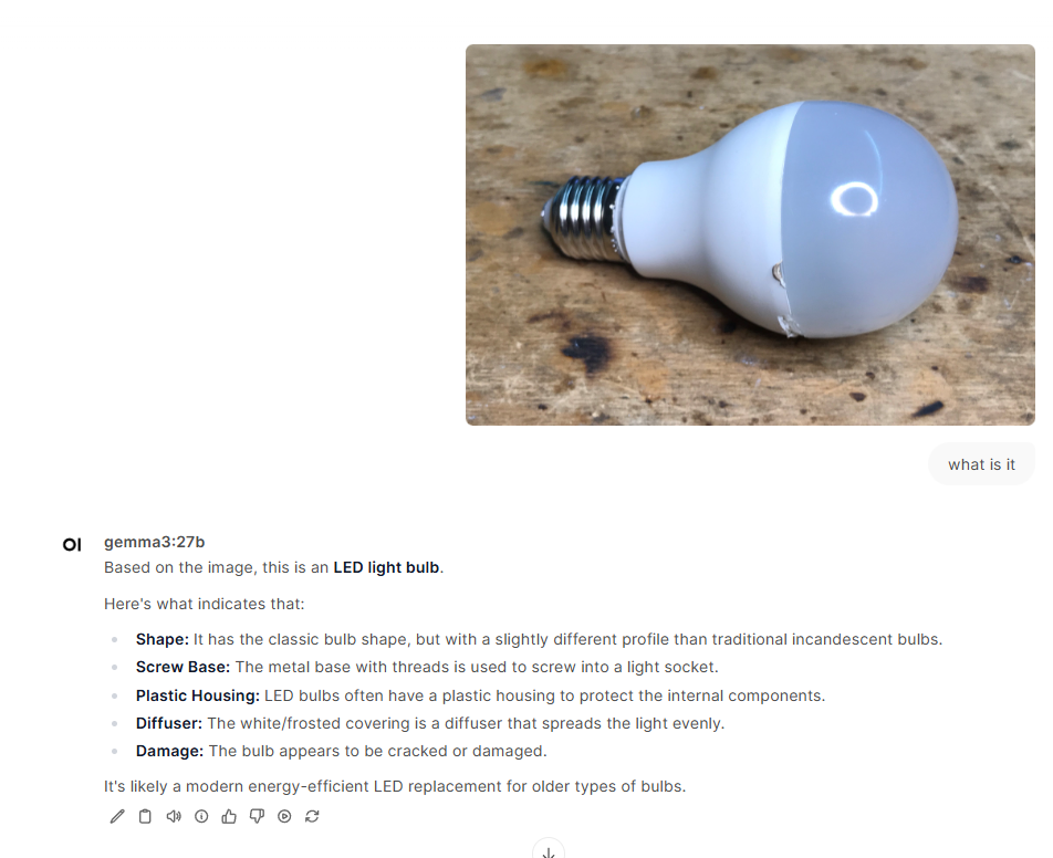

    A broken LED light bulb lies on a wooden surface.
    Not bad, it has even noticed the slight damage of the bulb.

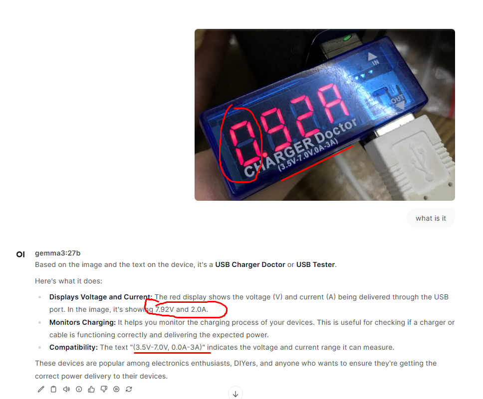

    USB Tester displaying voltage and current on screen
    Well, unfortunatelly it still makes mistakes and can give confusing results, but it's still better than LLaVA which I tested in the past...
