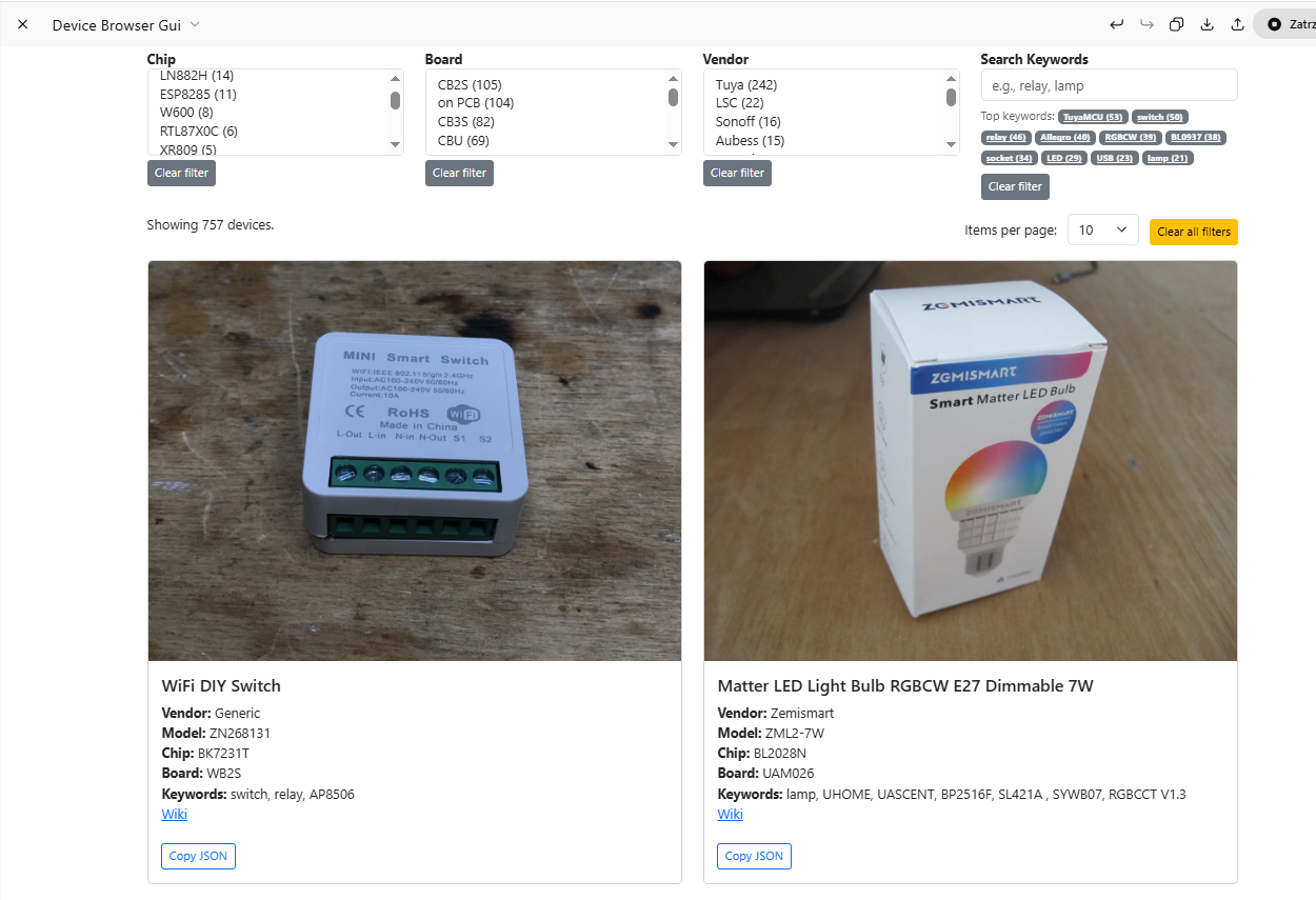

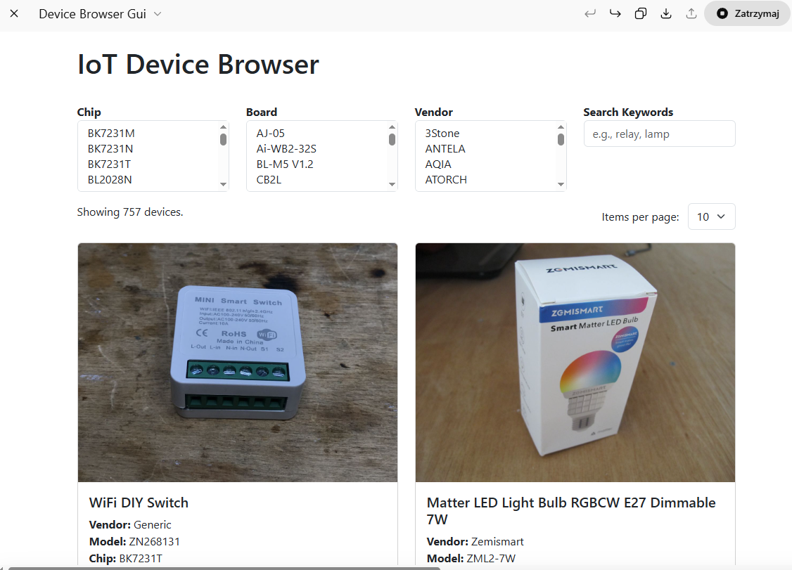

    and provide a nice looking, flexible, fully featured gui html browser/searcher/filter/stats page for the linked database, use html and js, maybe bootstrap, with page limits, multichoice, show counts for each type, filter by chip, module, etc
    First result - and it's already pretty good, the browser works, but there are shortcomings:
    Vibe coding - does it make sense? A short practical test, will AI create a simple page? .
    I started to score the model one by one what I wanted it to improve. After each step I verified the result. Here is a summary (my subsequent messages to the AI):
    - number of occurrences in the module/circuit lists
    next to each filter like chip or board or vendor, show how many occurencies there are in total, and sort entries by that
    - filter cleaning buttons
    under each list, add a "Clear filter" button that clears this particular filter. Also separately add a single "Clear all filters" button.
    - pagination fix (because when there were 50 pages, there were 50 buttons with page numbers)
    cool but those page numbers at the bottom of the page are strange if there are many pages, maybe you should just show numbers for first and last page, and also for current , previous and next pages, of course without repeats, and sorted?
    - greater selection of quantities per page
    also allow me to select 50 or 100 or 250 or 500 or 1000 per page...

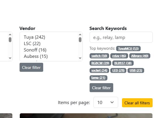

    - finally, top of the keywords
    also, under search keywords, give me like, idk, 10 clickable top keywords with their number (occurencies) in ( ) , and when clicked, set keyword field to given keyword

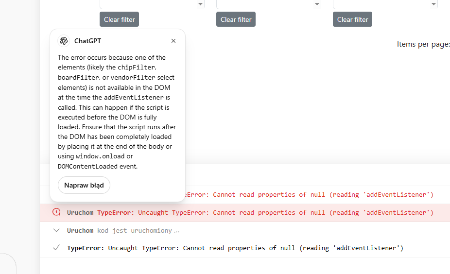

    At this stage a problem arose - the code stopped compiling. Fortunately there is an option in Kanwa to automatically have the model fix it....
    I can't believe it, he seriously did it! He fixed the error.

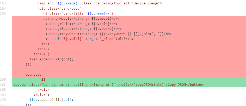

    So I continued - on in one hut:

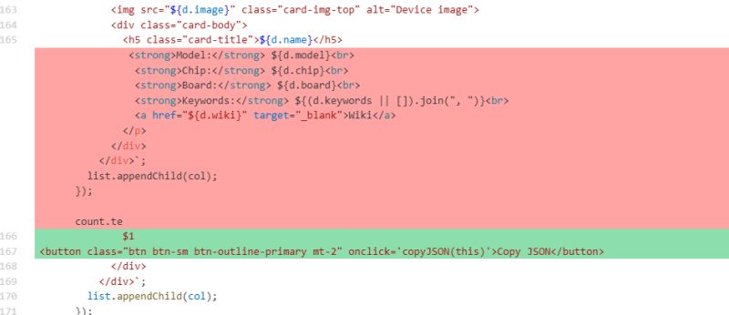

    To each entry, add Copy button that copies raw original device JSON entry to clipboard
    Here, however, something strange happened. I had to go as far as looking into the code - Kanwa allows you to preview the changes:
    I went back and corrected the query:
    To each entry, add Copy button that copies raw original device JSON entry to clipboard, do not remove existing features

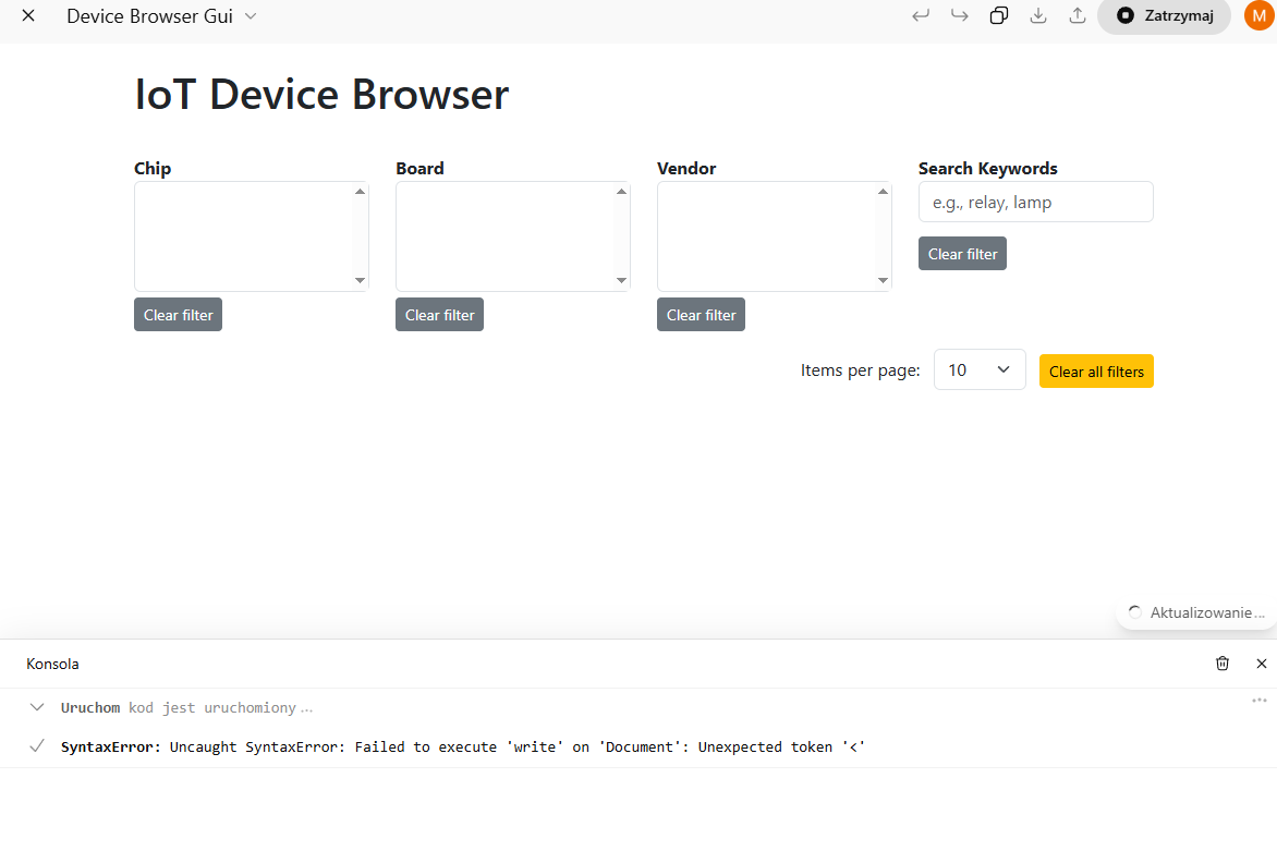

    I was greeted with an error:

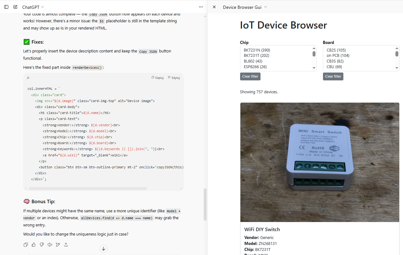

    However, this time again the AI was able to fix it:
    It even generated an explanation of what was wrong:
    The syntax error was caused by a duplicate and malformed <button> tag inside the device rendering block. It's now fixed - each device entry includes a single working "Copy JSON" button. Let me know if you'd like the copy action to show a tooltip or toast instead of an alert.

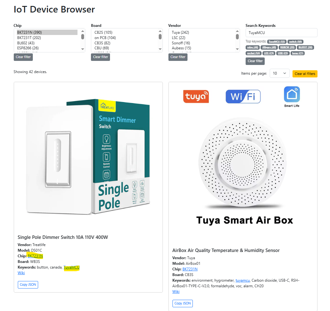

    The finished effect can be seen here:
    https://openbekeniot.github.io/webapp/devicesList_test1.html
    I think it came out pretty well.
