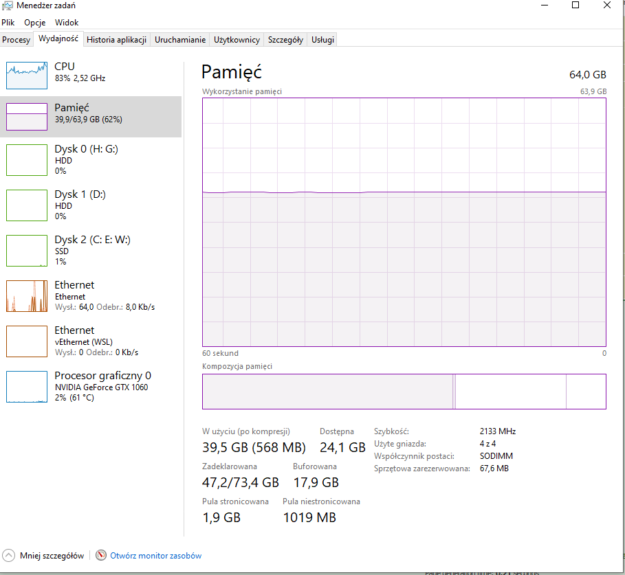

    The hardware requirements won't be high, I'm running the whole thing on a laptop with an Intel(R) Core(TM) i7-6700HQ CPU @ 2.60GHz, 64GB RAM, GeForce GTX 1060.

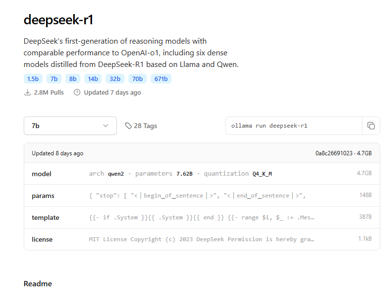

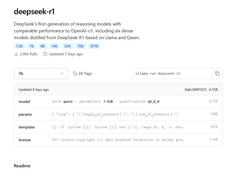

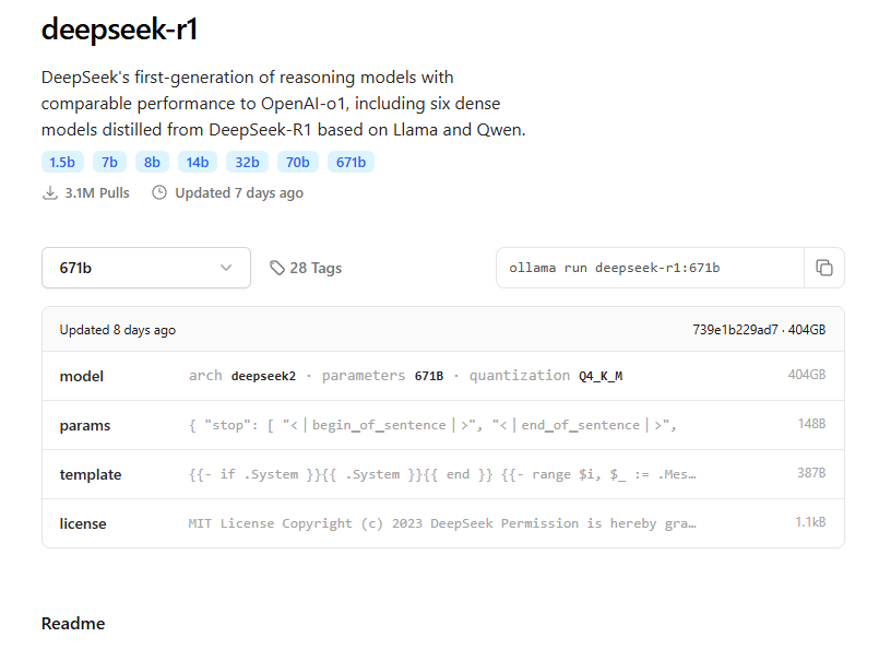

    https://ollama.com/library
    Screenshot of the DeepSeek-r1 page with information on models based on Qwen and Llama. .

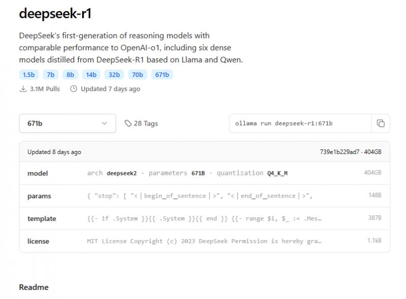

    The full DeepSeek here has 671 trillion weights and is in q4 format, so each weight is 4 bits. You would need about 400GB of RAM to run it:
    Screenshot of the DeepSeek repository on the Ollama website, displaying the deepseek-r1 model with details about parameters and licensing. .

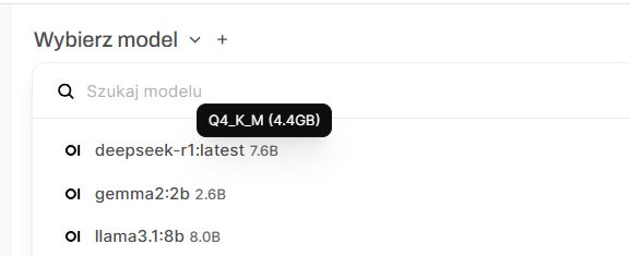

    Fortunately for us, suitably slimmed-down models have been prepared, based on Llama and Qwen with 1.5b, 7b, 8b, 14b, 32b and 70b parameters respectively.

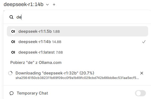

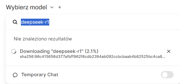

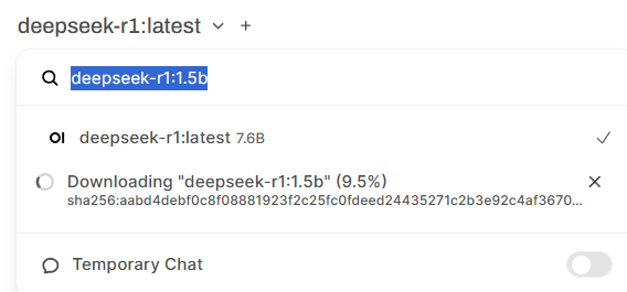

    These can be downloaded in the WebUI itself by appropriately entering the name of the respective model (number of parameters after the colon) and clicking "Download":
    Screenshot of selecting the DeepSeek model in the WebUI interface .
    DeepSeek download interface: deepseek-r1:1.5b .
    Screenshot of the interface downloading the deepseek-r1 model. .
    In this way I downloaded the models up to the 32b version:

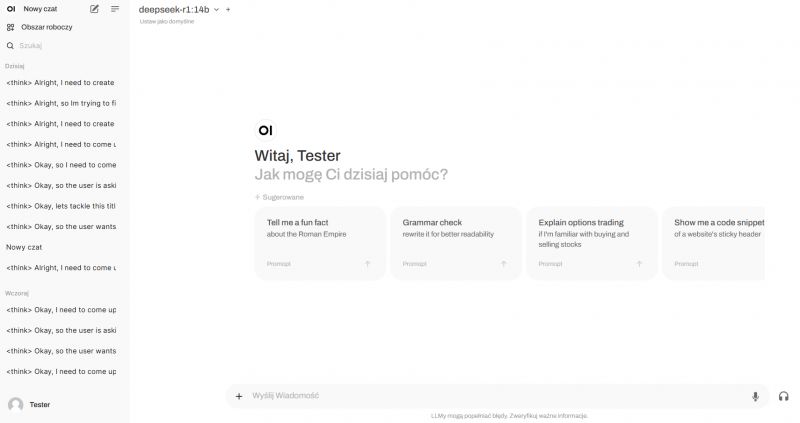

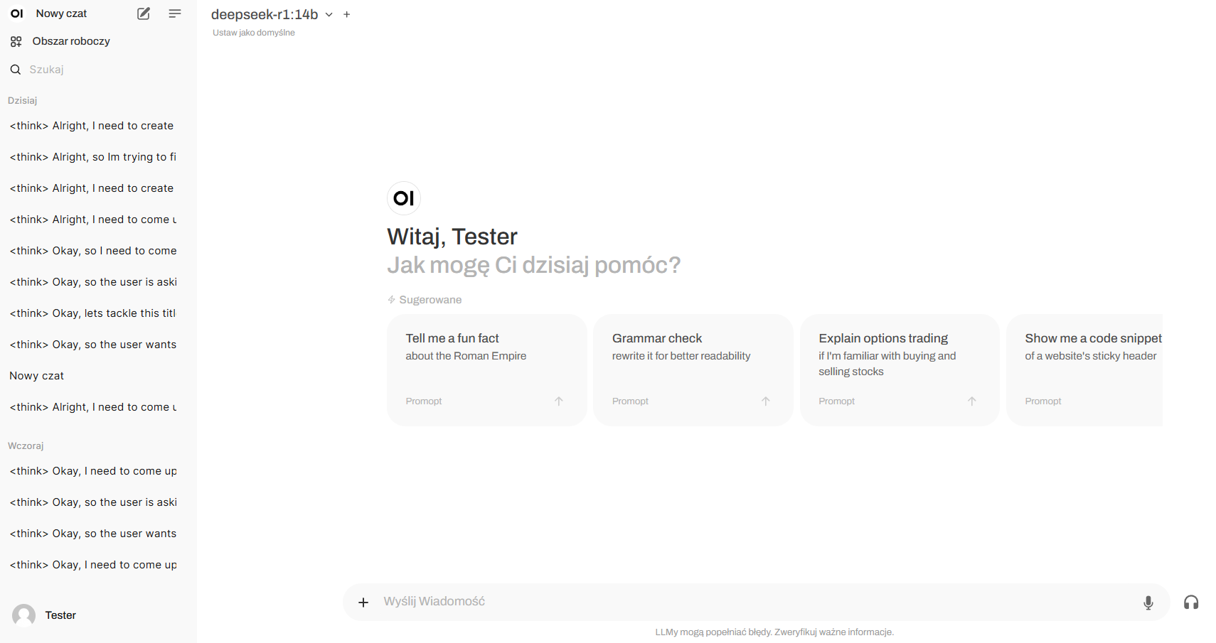

    The WebUI discussed earlier offers an interface similar to the famous ChatGPT. Here we have a history of conversations, the possibility to attach a picture (if the model supports it) and also the possibility to select the model with which we "talk".
    WebUI interface with DeepSeek conversations .
    Additionally, it is worth mentioning here that the presented Deepseek works in a slightly less typical way - following the recent models from OpenAI, this model first "thinks", and its "thoughts" are stored in a block marked with the tag <think>.

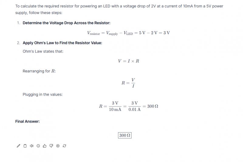

    Ok, so we type the prompt/query, for example:

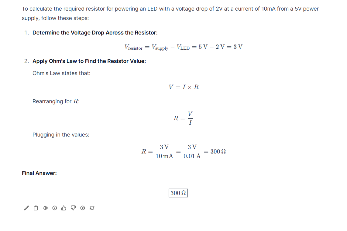

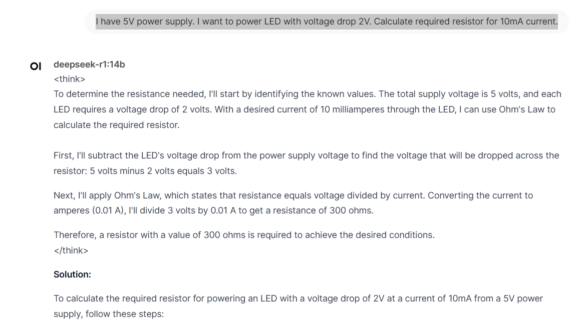

    I have 5V power supply. I want to power LED with voltage drop 2V. Calculate required resistor for 10mA current.
    After a while the answer starts to form before our eyes, in the case of the 14b it is even quite fast:
    Text discussing the calculation of resistor value for an LED. .
    You can see the 'think' tag mentioned here, these are the 'thoughts' of the model. You can also see that DeepSeek knows how to produce nice formulas and calculations, which moreover in this case are probably correct!
    Calculations of required resistor for powering an LED using Ohm's Law. .
    That's right, 300 ohms is that resistance, online calculators also confirm it. So there is something there that this DeepSeek can do....

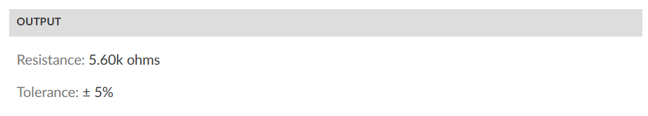

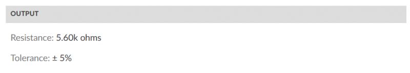

    Long thought, but came up with one - according to the calculator from Elektroda:
    Output showing the resistance and tolerance of a resistor. .

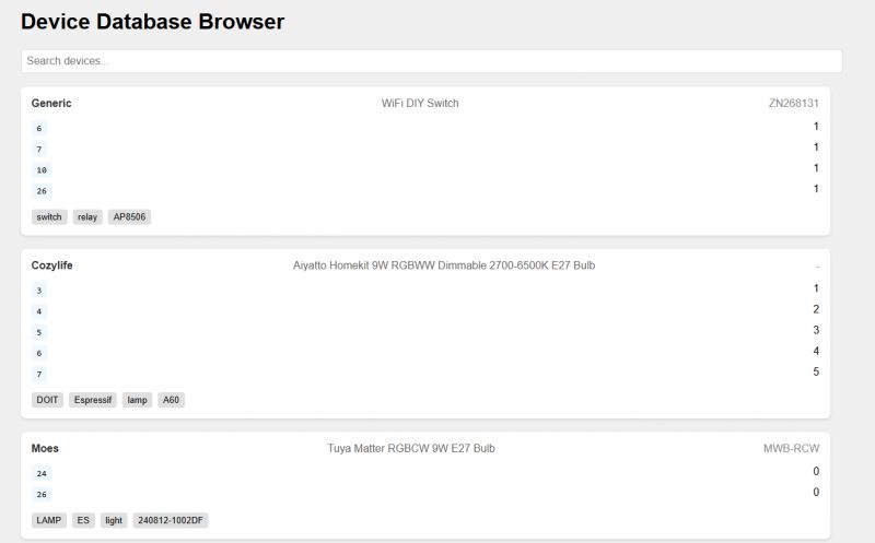

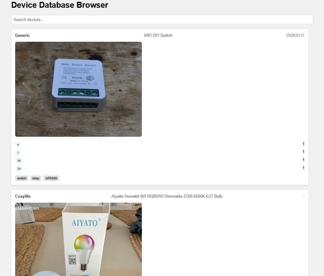

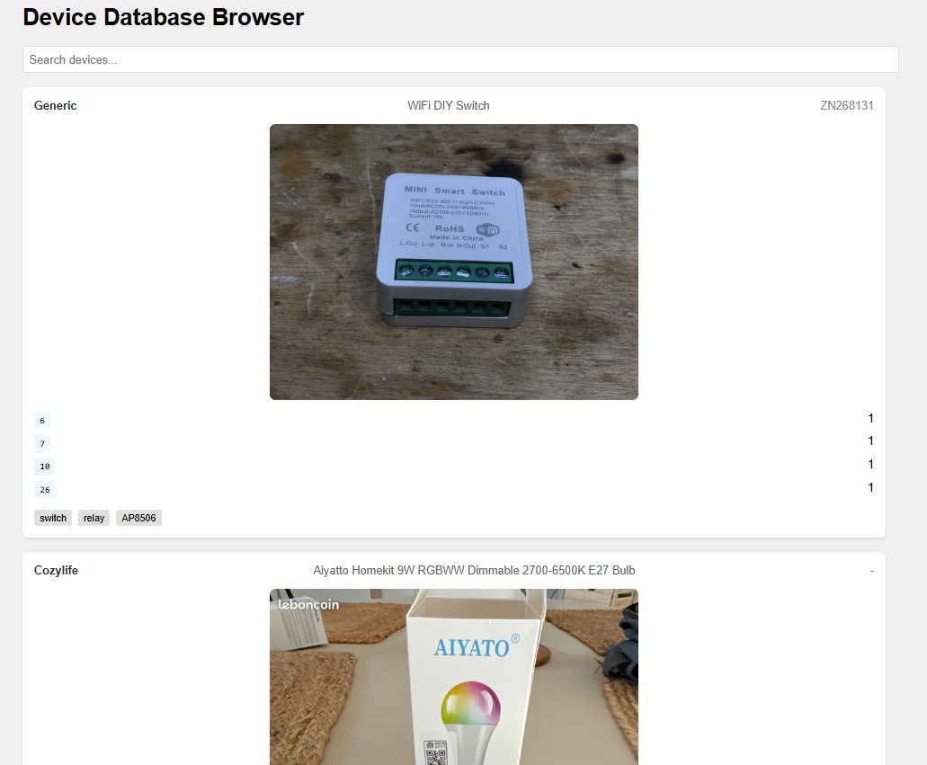

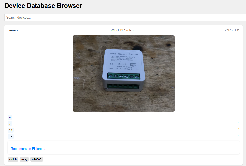

    Pretty good, just forgot the images:
    Application interface displaying a list of IoT devices. .
    I can also see that the search is breaking, but that's just my fault - I didn't write him that the keywords array may not be present in the JSON structure, so we get an exception when it's NULL....
    Maybe we should ask for images first:

    Not bad, but it seems to have forgotten one thing - adding the created div with the image:
    Code: Javascript
    Additionally, I took the liberty of making the images smaller:
    Code: CSS
    After my corrections:
    Device database browser interface displaying information on two devices. .
    It would be useful to centre the image....
    Please centre horizontally the image
    deepseek-r1:14b wrote:
    <think>
    Alright, the user wants to center the image horizontally in their device cards. I need to figure out how to adjust the CSS or HTML to achieve this without disrupting other parts of the layout.
    Looking at the previous code, each device card has an image container within it. The images are inside a div with class 'device-image'. Currently, they use width: 100% which makes them take full width, but not centered.
    To centre the image horizontally, I can set margin-left and margin-right to auto. Alternatively, using flexbox properties on the parent container might be more efficient.
    I should modify the CSS for .device-image to display: flex and justify-content: center. This will push the image to the center without affecting its width.
    I also need to ensure that this change doesn't affect other elements in the layout. Testing is important here to see how it looks on different screen sizes.
    Finally, I'll update the CSS section in the answer and explain the changes clearly so the user can implement them easily.
    </think>
    To horizontally centre the image within its container, you can modify the CSS for the .device-image class. Here's how you can do it:
    Updated CSS (Modify your existing CSS):
    Code: CSS
    Explanation:
    display: flex : This makes the container a flexible box, allowing you to easily center its contents.
    justify-content: center : This aligns the content (in this case, the image) along the horizontal axis.
    With these changes, the image will be centered horizontally within its container while maintaining its current width and other styling.
    Will centering work? I have added my image size limit to the code. It works:
    Device database browser interface with images of WiFi DIY Switch and Aiyatto bulb .
    Not bad, I would have taken longer to figure out how to centre. I don't know these commands by heart and this DeepSeek is faster than Google.
    How about links now? Make them clickable.
    Now also add a clickable wiki link to end of each entry, call it "Read more on Elektroda"
    <think>
    Alright, the user wants to add a clickable "Read more on Elektroda" link at the end of each device entry. I'll need to modify both the HTML structure and the JavaScript function that generates these entries.
    First, I should create an anchor element in the HTML for each device card. This anchor will point to the device's wiki page, likely using a URL pattern based on the device name or another identifier.
    I'll add this link inside each device card so it appears at the end. Styling is important here too-maybe adding some margin and padding to make it look neat.
    In the JavaScript function, I'll modify the template string to include this new anchor element. The href attribute will be constructed using a placeholder URL since I don't know the exact structure of their wiki pages.
    Testing each part is crucial: ensuring the link appears correctly and that clicking it navigates to the intended page or at least shows the correct URL in the browser.
    Finally, I'll update the code snippets accordingly and explain the changes so the user can implement them without issues.
    </think>
    Here's how you can add a clickable "Read more on Elektroda" link to each device entry:
    Updated JavaScript (Add this before closing the device card div):
    Code: Javascript
    Updated CSS (Add these styles to your existing CSS):
    Code: CSS
    Updated CSS (Add these styles to your existing CSS).
    Explanation:
    HTML Structure :
    Added an <a> element at the bottom of each device card.
    The link uses the device name to construct the URL dynamically using encodeURIComponent().
    CSS Styling :
    Added styles for the link, including colour and hover effects.
    The link is styled to appear as a clickable button with some margin above it.
    Notes:
    Make sure Elektroda's wiki URLs are structured correctly for your devices.
    Replace "https://elektroda.com/wiki/index.php/${encodeURIComponent(device.name)}" with the actual URL pattern used by Elektroda's wiki pages if different.
    This modification adds a clickable link at the bottom of each device card, making it easy for users to learn more about the device on Elektroda's wiki.
    Well, unfortunately, he's made up his mind a bit here - why did he add the device name again for me, and why didn't he take the link to the "wiki" from the "wiki" field in the JSON examples given to him at the beginning? I had to manually correct this, in the end it came out like this:
    Device Database Browser interface displaying information about the WiFi DIY Switch. .
    I can improve it a bit now, and all in all some page will come out of it.... I still need to improve these pin and channel indexes, because I can see that AI forgot to specify the role of the pins and it looks quite strange.

    - the simple things deepseek-r1:7b/14b/32b can do, with the calculation of the resistor for the LED managed, the code of the resistors decoded
    - for HTML and Javascript, let's say, those "more popular" topics, the model coped quite well, initially even very well, basically gave me what I expected and genuinely saved me time. If it wasn't for LLMs, I would have had to write such a skeleton of a page myself, and it would have been a bit cumbersome for me, and this way I have a ready-made....

    except that this deepseek only has in common the name ;) with the rest there is even some argument about why someone even allowed it to be called that. It should be more LLama_Qwen_DS.
  • Need benchmarks to gauge DeepSeek distillation quality
    #3 21417182
    Posts: 14765
    Rate: 12899
    Well, I don't know what the motivation behind this naming was, but I wonder to what extent these base Qwen/Llama models actually 'imbibed' the original DeepSeek in this 'distillation' process. It would be useful to look for some specific benchmarks here. Undoubtedly, at first glance they resemble the original, there is that whole 'train of thought'. It is unlikely that anyone expects the 7b model to be as good as the 671b.
