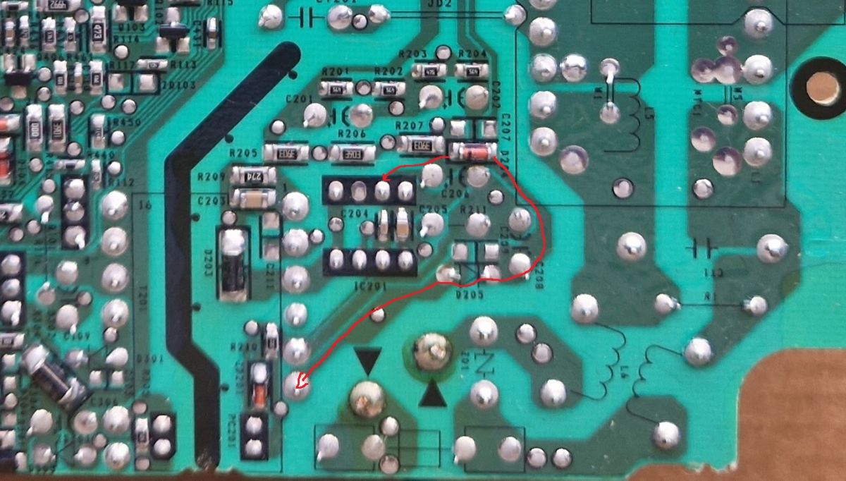

    Hi!
    I'm repairing a Hilti charger, and I've found out that the diode marked "D204" is shorted. However, there's no info about it, I can't tell what type it is (is it a Zener diode, or a fast switching diode or what)? See the attached image.
    D204 Diode Specifications Inquiry for Hilti C4/36 ACS Charger Repair with ICE2A180Z
    What I know is, that the cathode of this diode goes to the VCC pin of the SMPS controller, which is an ICE2A180Z, see specs here:
    https://www.infineon.com/cms/en/product/power...ge-coolset/fixed-frequency-coolset/ice2a180z/
    Does anyone know the specs of "D204"?
    Thanks in advance
    Gábor

    Whether the diode was desoldered for the measurements, if not, the measurements are uncertain.

    passenger001 wrote:
    All I know is that the cathode of this diode goes to the VCC pin of the SMPS controller
    And the anode?
  • #4 20635469
    passenger001
    The anode goes to the cathode of another diode, which is then connected to one of the pins of the small transformer that feeds the processor part (the "brain") of the whole charger. See picture.
