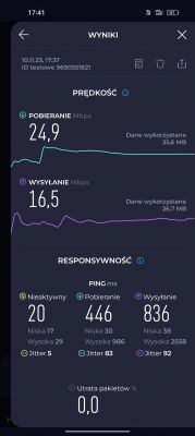

    #10 20807204
    matek451
    Posts: 31254
    Help: 4352
    Rate: 5808
    I asked a question about the location, Plus for 5g on TDD2600, i.e. N41, now in cities it launches a few base stations with 5g2100 on N1 for N78 + N1 aggregation, but n78 is still important.
    Added after 2 [hours] 12 [minutes]:
    As for PLUS, the Kadzidło station definitely operates on 5G2600, it has sector 1 at an azimuth of 50 degrees, but generally it does not work at high power, the last EMF measurement was performed yesterday, the station received 5G2100 and now works in the 5G2600+2100+ LTE1800 aggregation, there is also LTE800 .
    NetWORKS has LTE2600+2100+1800+800+900 on the BTS in Kadzidło, and also has 5G2100 in DSS with LTE2100, the last PEM measurement was 2 months ago after modernization, sector one is yours.
    Play has a BTS nearby with LTE2100+1800+800 on sectors 1 and 2, the first one on azimuth 30 to you, sector 3 also has LTE2600, the one on azimuth 270 on Kadzidło, it also has 5g2100 in DSS with LTE2100.
    Have you tested T-Mobile at home?

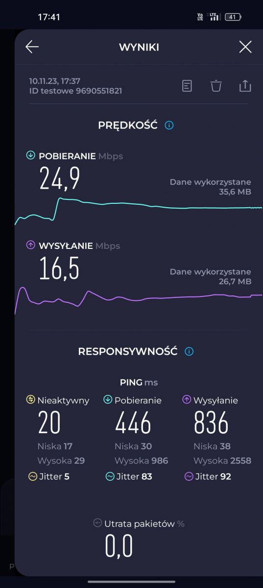

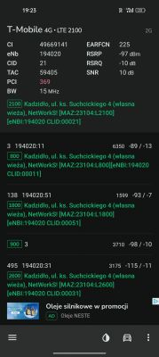

  • #11 20808504
    Fifjdjdjd
    Posts: 7
    Screenshot of internet speed test results showing download and upload speeds.

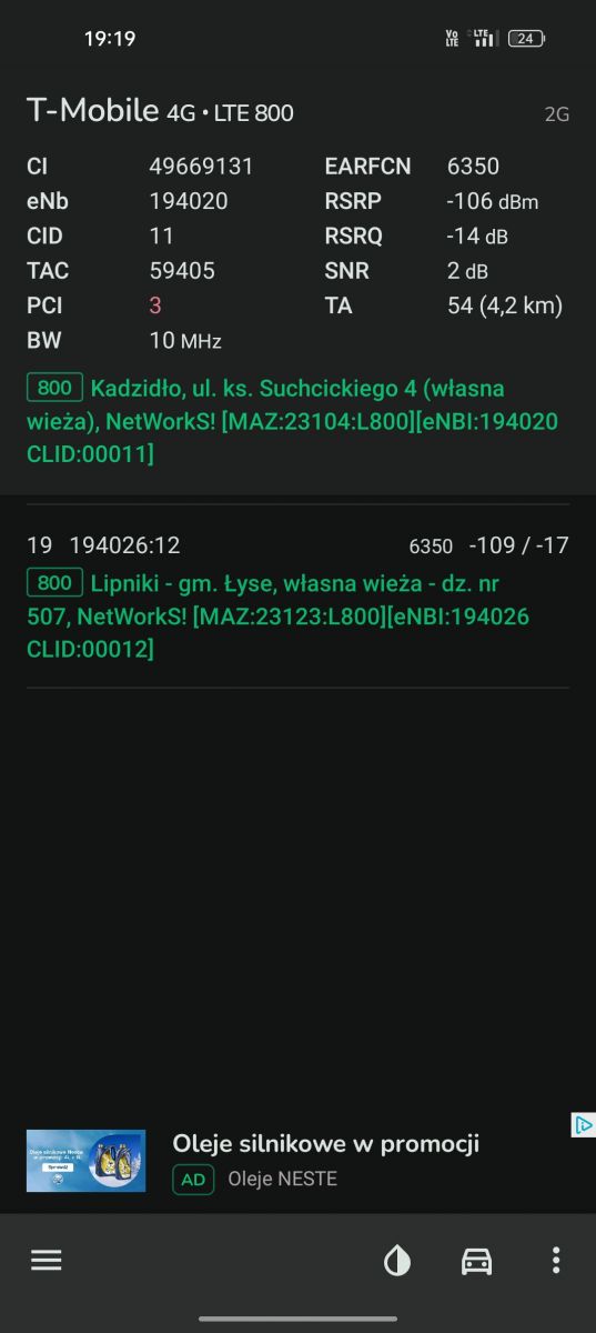

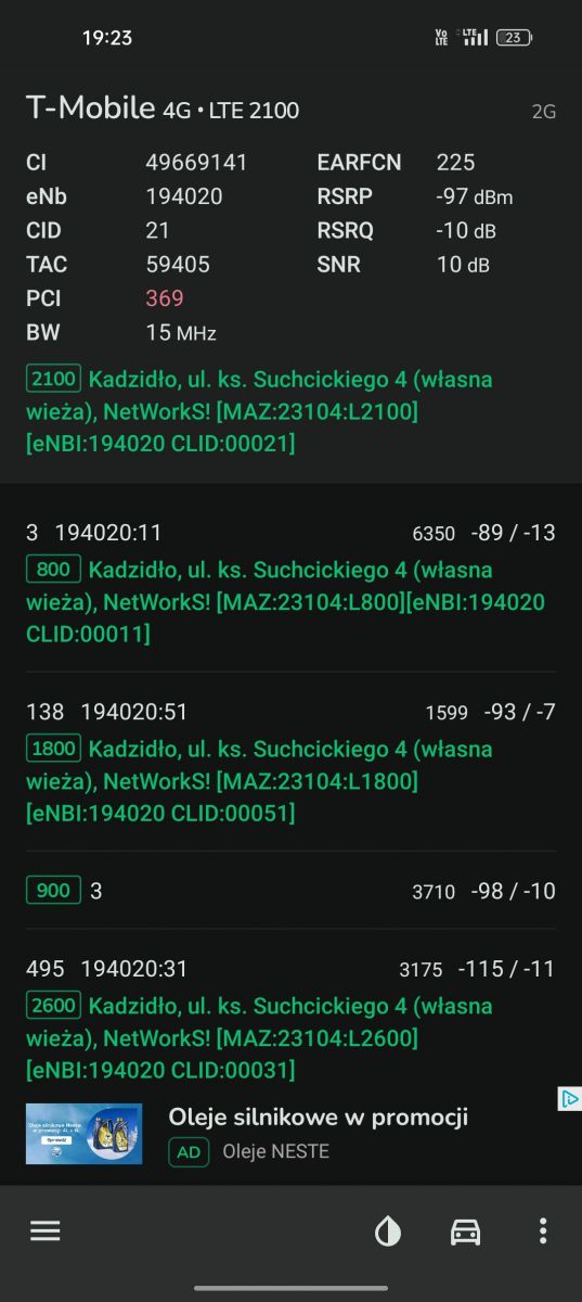

  • #13 20808669
    Fifjdjdjd
    Posts: 7
    The card is T-Mobile LTE.
    At home:
    Screenshot showing T-Mobile LTE 800 network parameters from a monitoring app.
    Outside:
    Screenshot of an application monitoring T-Mobile LTE signal.

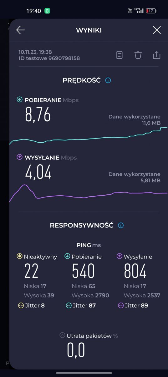

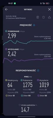

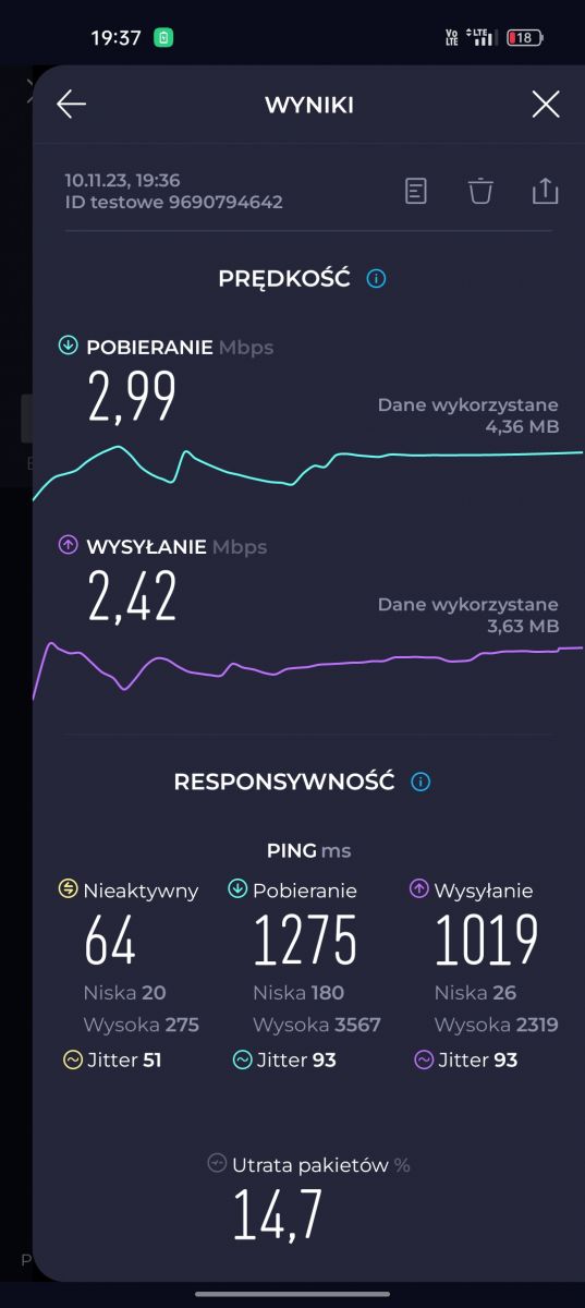

  • #15 20808681
    Fifjdjdjd
    Posts: 7
    And where is this in this application
    As for the Ookla speedtest application, I can send them immediately
    Added after 7 [minutes]:
    >>20808675
    Test at home
    Screenshot of the speedtest Ookla app showing internet speed test results.
    Test away from home Internet speed test results in an application.
  • #17 20810982
    Fifjdjdjd
    Posts: 7
    >>20808681
    @matek451 so what's next with these results?
