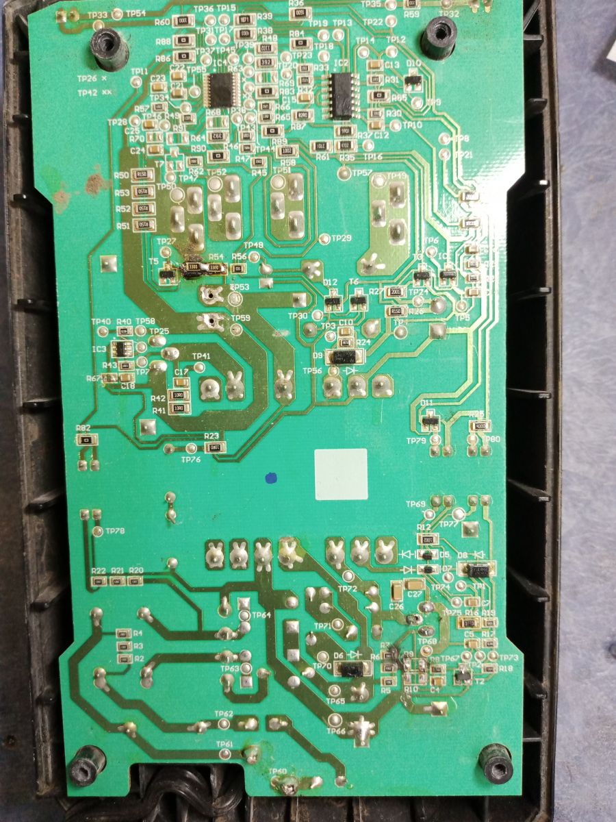

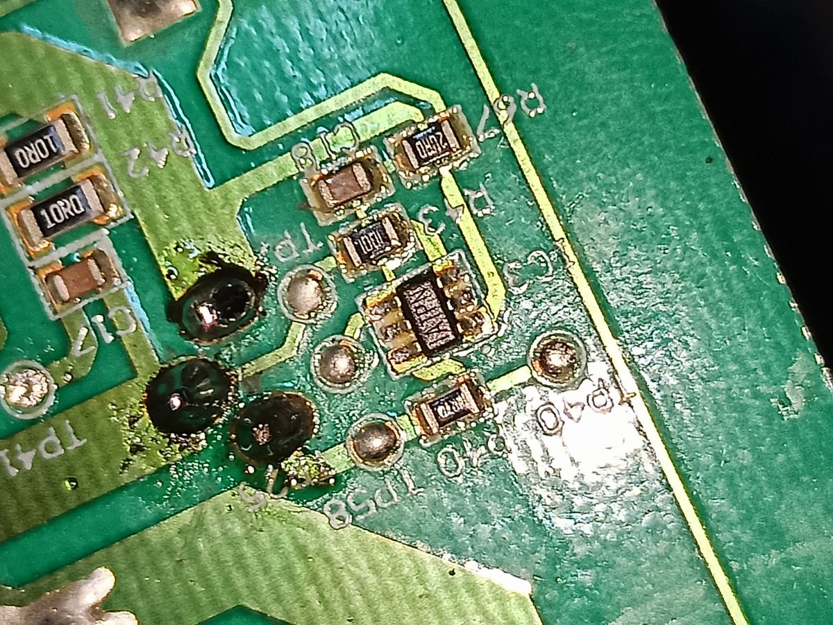

    Identifying IC3 SOT23-6 IC Number in Bosch GAL 18V-40 Model
    I want to know IC number of IC3 SOT23-6?

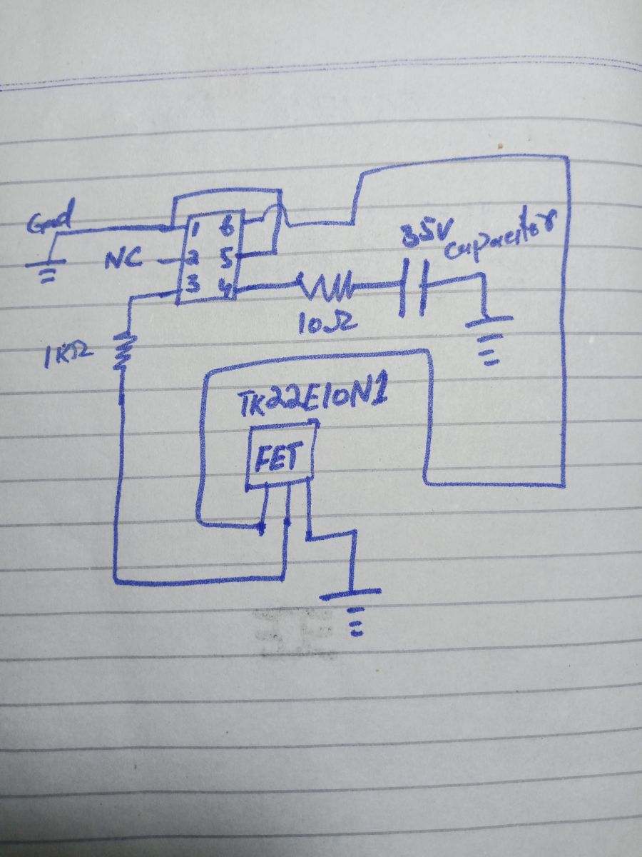

    Can you sketch the nearby circuitry? Is it the power supply section with optocoupler?
  • #3 20648113
    azeltahmed083

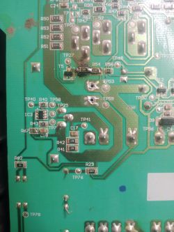

    This IC is on the secondary side of the power supply and connected with the voltage regulator MOSFET. Identifying IC3 SOT23-6 IC Number in Bosch GAL 18V-40 Model

    Circuit diagram featuring an integrated circuit with components like a 35V capacitor and a FET transistor.
