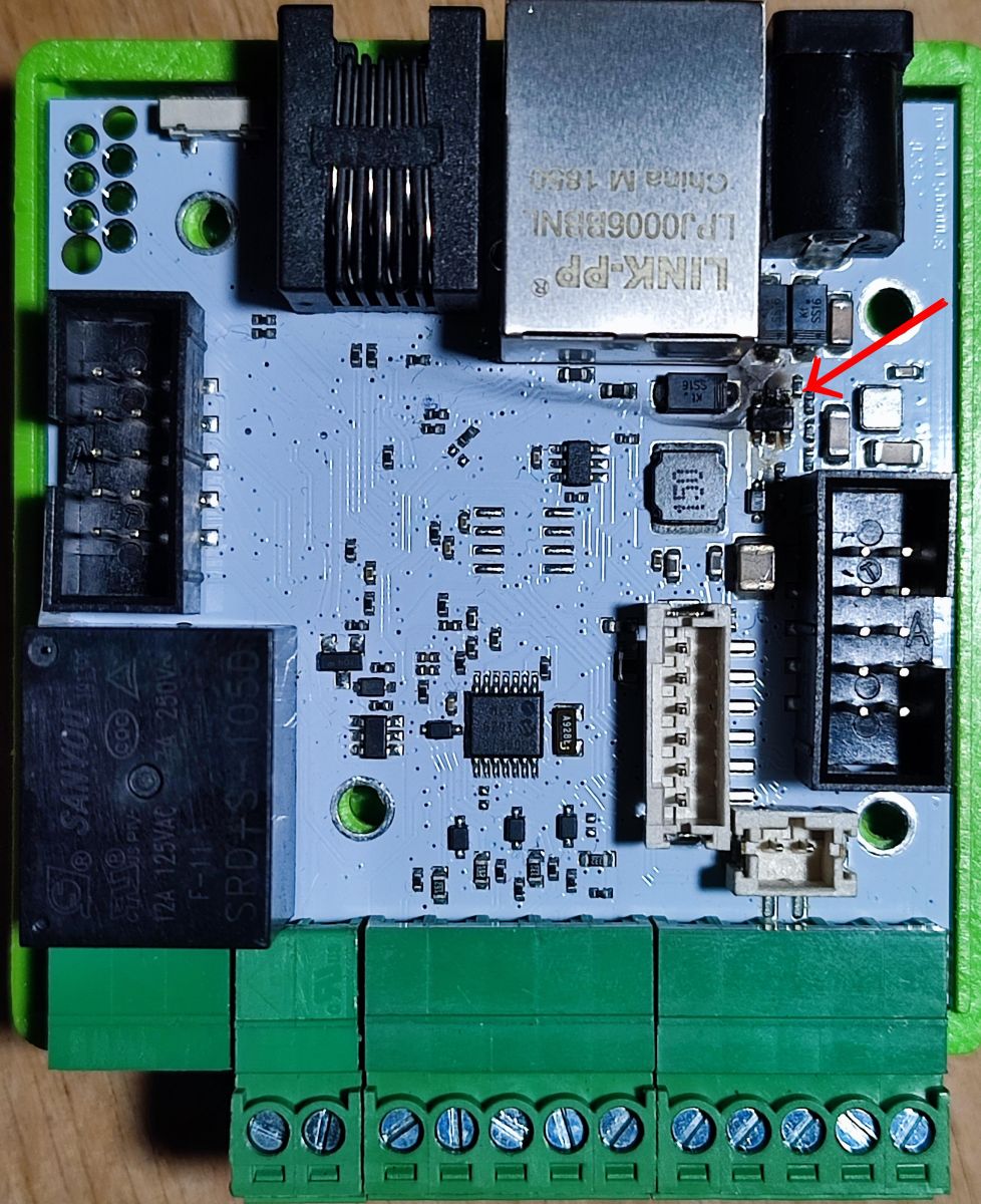

    I have a request for LAN Controller users (mine is HW v3.7), if someone could read and provide the designation of the component in the SOT23-6 housing, marked with an arrow in the picture (inverter driver).
    LAN Controller HW v3.7 - identification of SOT23-6 element in the inverter circuit (driver) .

    Wash the system with a swab of IPA and check the marking.

    Thank you for your advice, but this is where I started. The circuit is after an overvoltage, the housing melted and delaminated - hence the question.

    A circuit so burnt it and probably further overvoltage (by eye it's the dc-dc converter driver).
    Solder and power the circuit from an external power supply as it may not be worth resuscitating the whole board.

    I do not want to replace a faulty circuit. I need its specifications.

    Draw out the layout surroundings and try here Link , Link .

    I managed to find, as if anyone ever had a similar problem - the 5V inverter is on the MP2459 chip.
