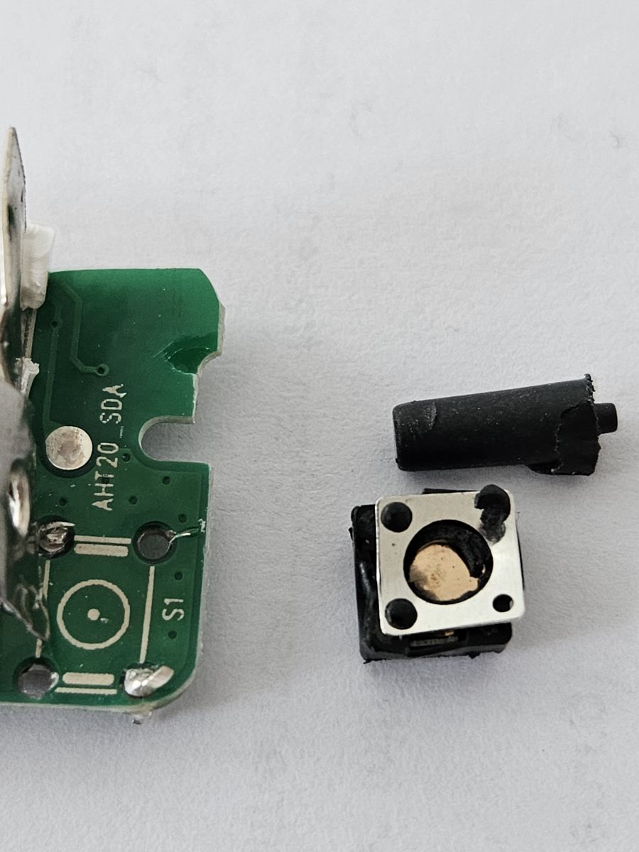

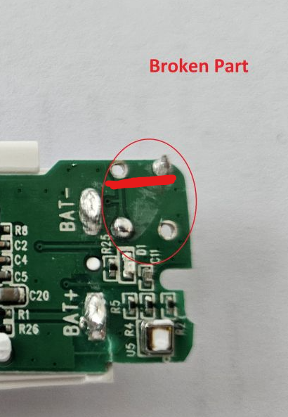

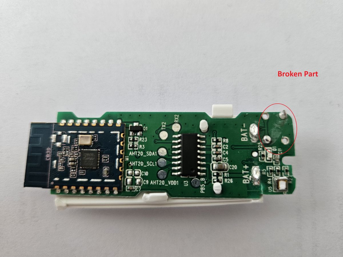

    Hi. I need some help for this sensor as well since I broke the reset button.
    What pins do I have to connect to just get it into simple pairing mode? Right now all I get is a steady red LED light when powering it on.

    Can you post a picture of your device? There are a lot of them with different configurations and we may be able to identify yours and help you out.

    Sure. Are those good enough?

    You can use tweezers to connect left to right pins on your first picture to get into the pairing mode.
    Are you trying to replace the firmware on your device or?

    Use a paperclip and connect and hold those pins for 5 or 10 seconds (maybe longer). The LED should start flashing, I believe.

    Holding those pins for 5 seconds turns the LED off and on. Same on the opposite side.

    you can simulate button press by shorting the button contacts. Please consult the manual to check how to enter this device into pairing mode, but most likely one long press should be enough.
