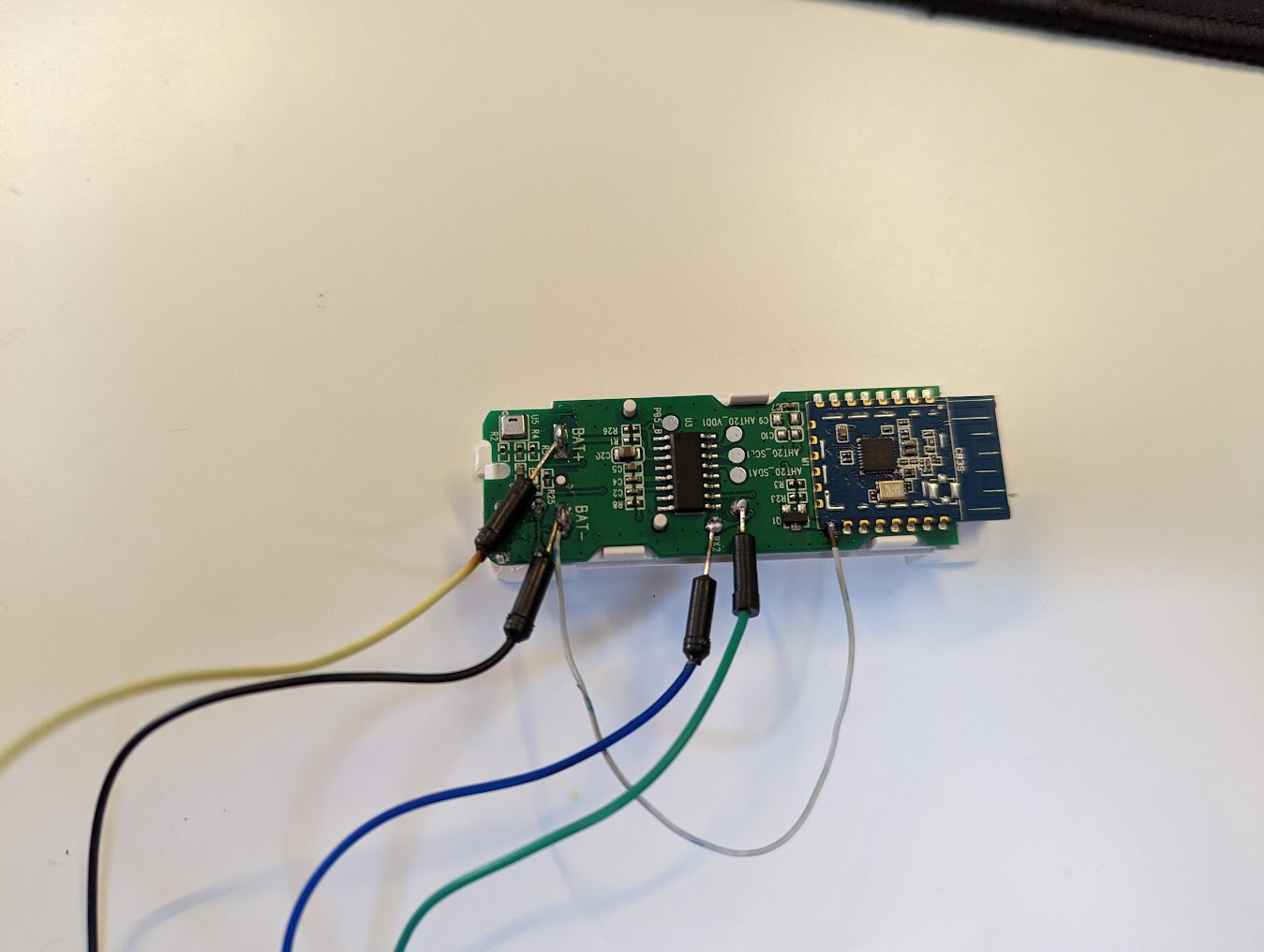

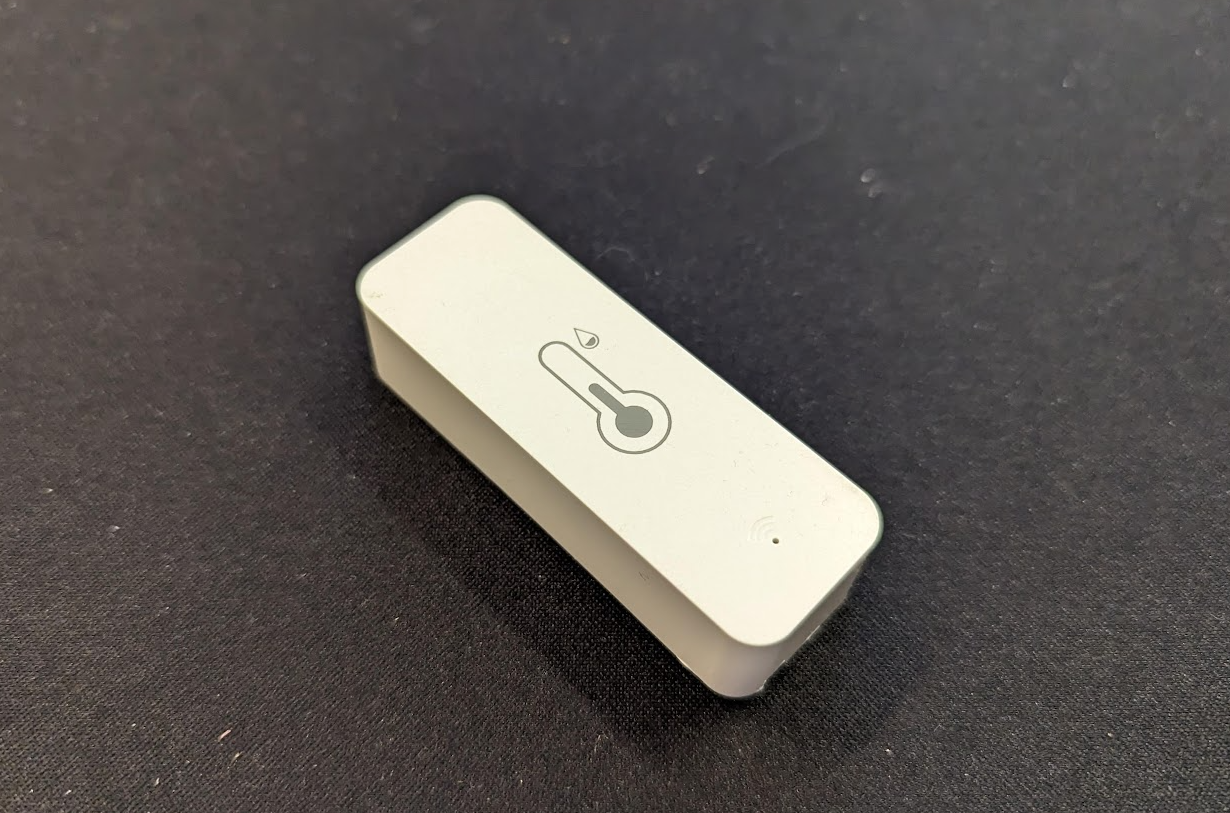

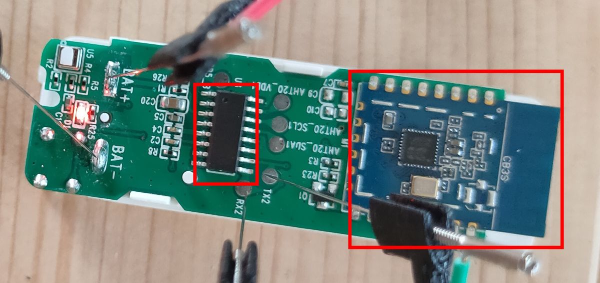

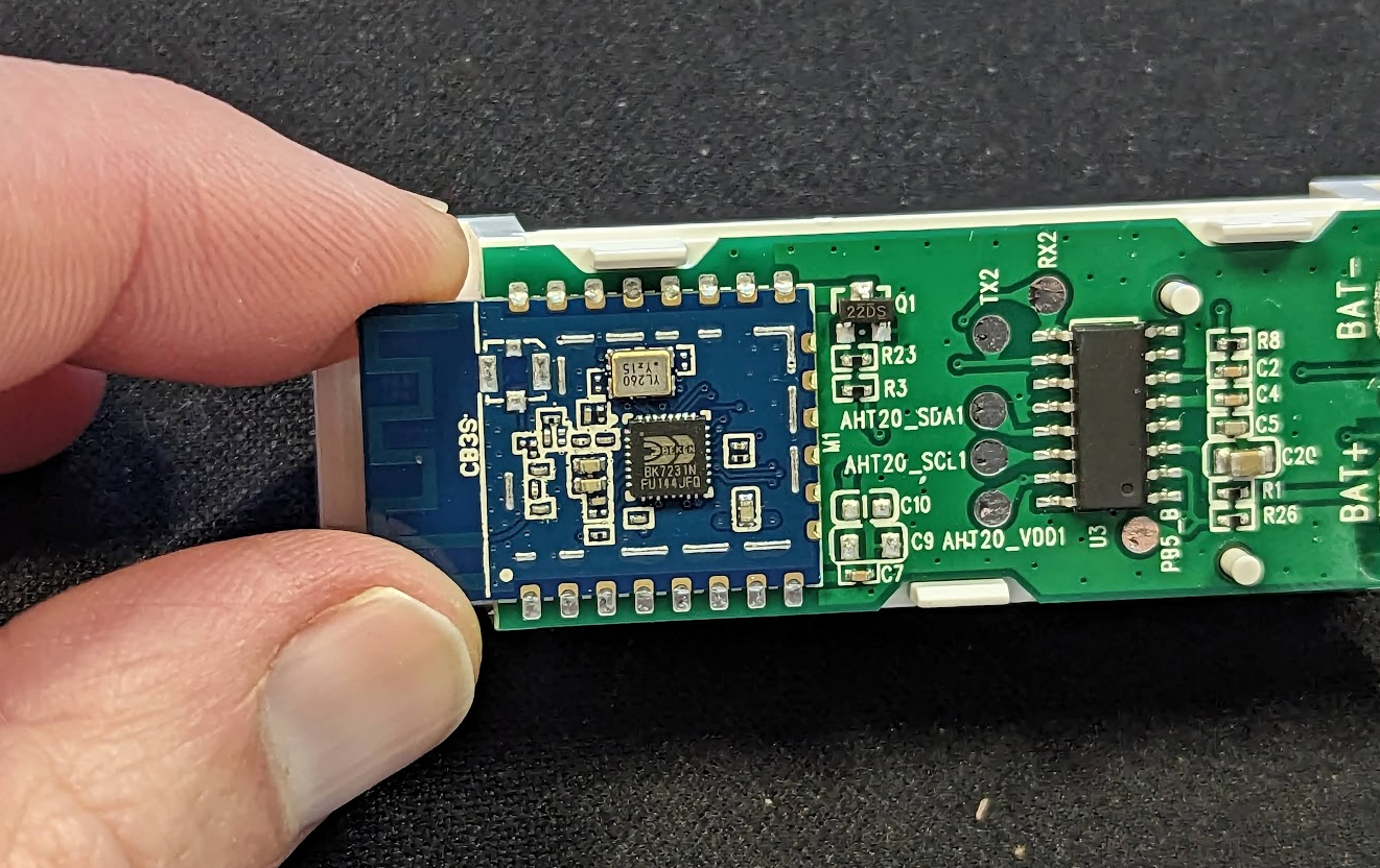

    Teardown of TH01 Generic Temperature and Humidity Sensor
    Firmware dump attached.
    Managed to flash OpenBK7231N firmware but I'm now stuck.
    WiFi settings set. Running off 3V3 and bypassing the ground transistor I can access the WebUI to be able to setup.
    Any ideas what needs adding to autoexec.bat other than?
    startDriver TuyaMCU
    startDriver tmSensor
    Happy to try and dump other info if needed.

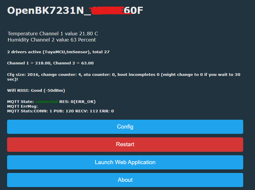

    I have them mapped
    Just need to figure out the MQTT part
    startDriver TuyaMCU
    setChannelType 1 temperature_div10
    setChannelType 2 Humidity
    [BK7231N] [CB3S] [AHT20] TH01 Generic Temperature and Humidity Sensor Teardown

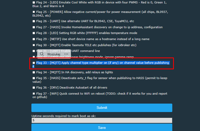

    You might also want to select this flag:
    Then check in readme to see how are channel values published.
    Also check "publish all mcu channels" flag and maybe "publish self state on connect".

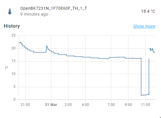

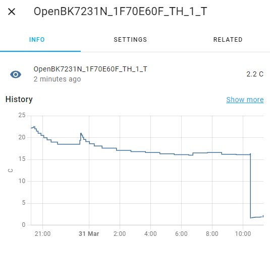

    I can see something strange on this graph, but what do you mean by "calculated down"? Is it just a "0" value sent or something else?
    Btw you don't need thaT:
         value_template: "{{ (value | float * 0.1 | round(1)) }}"
    if you set this flag:
    You can use either one of this options, but not two at them together.
  • Flag 33 caused MQTT graph drop; dpID 3 likely battery state
    #10 20517669
    anthonythomas
    Posts: 40
    Rate: 16
    The drop in the graph looks to be when I enabled Flag 33 - so that makes sense.
    MQTT was working fine before that when I didn't realise.
    I've removed the calculation from the MQTT template and it's correct again.

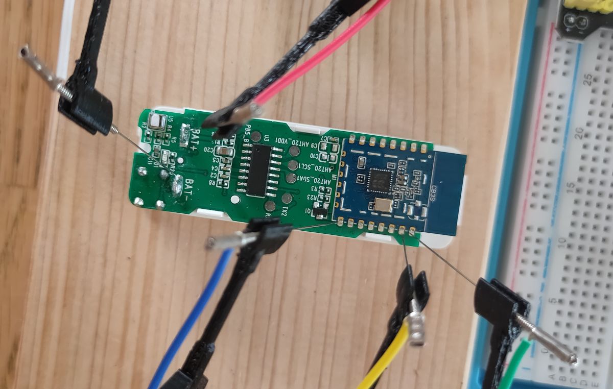

  • Temporary RX/TX trace cuts needed for flashing

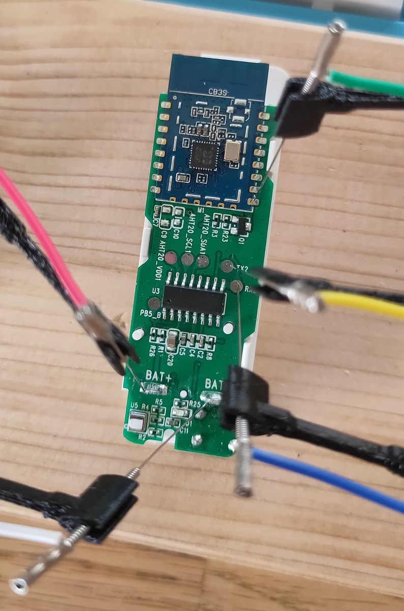

  • Need boot-mode bridge for TH01 flashing
    #19 20626300
    grericht
    Posts: 13
    Hi,

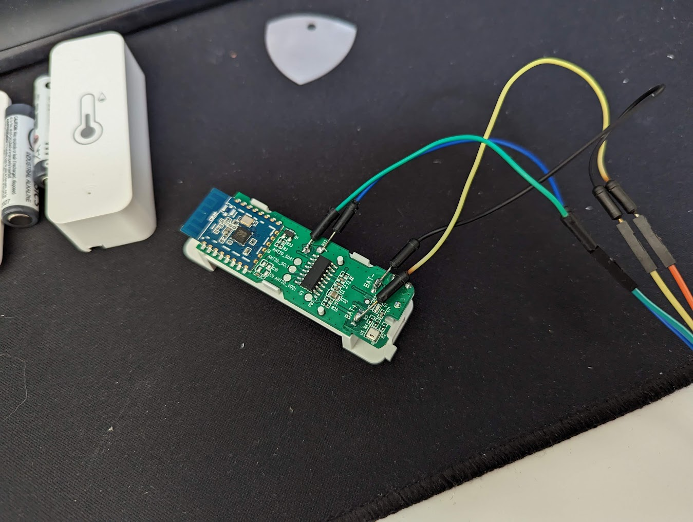

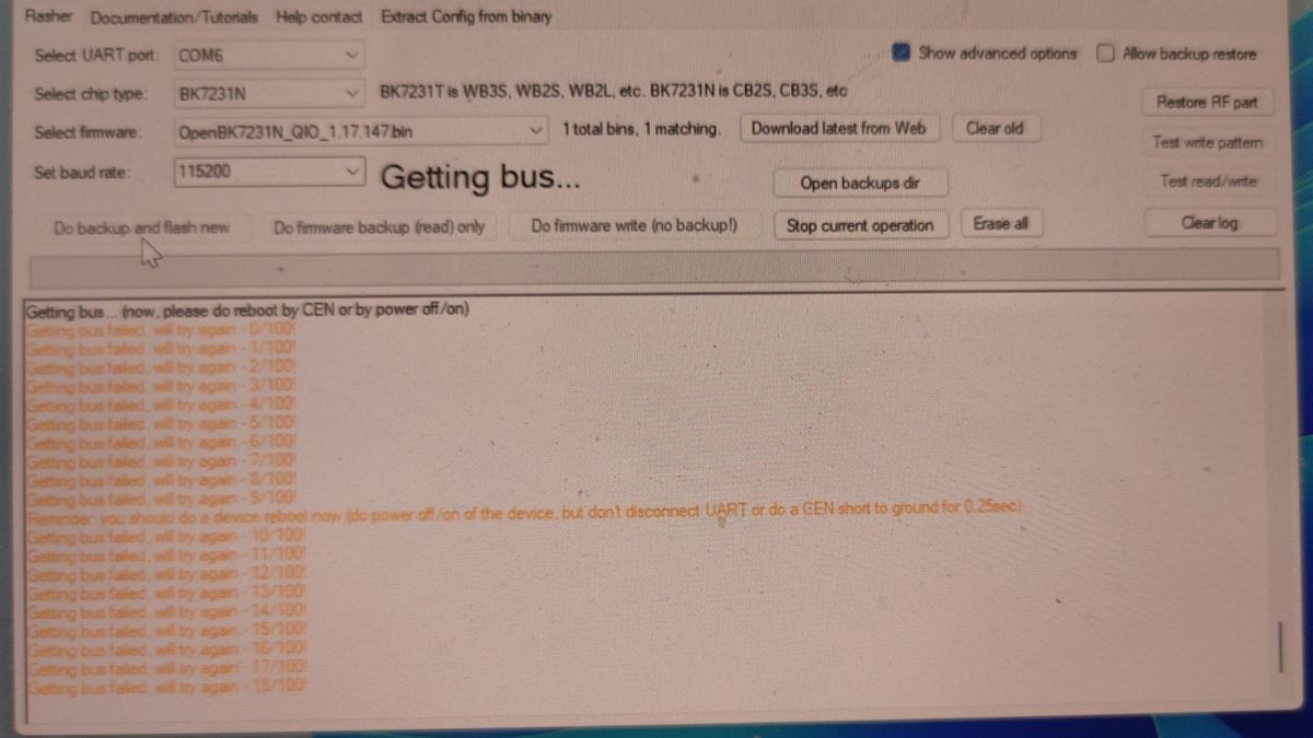

    I try some options to flash the TH01. But nothing works. I don't get a connection for flashing with BK7231 GUI Flash Tool.
    Do I have to desolder or to bridge something?
    I try rx2 tx2 bat+ and - and bridged ground from chip
    and I try to connect tx rx + and - directly from the chip
    the th01 every time goes in slow blinking mode.
    for tasmota I had to bridge pin g01 and reset for boot mode. I can't find something to do for boot mode. only switch power off and on during flash. I have a separate 3.3v power supply. I also try to get in flash mode by bridging cen pin. but never get it work.

  • TuyaMCU requires severing BK7231 serial link to flash
    #20 20626343
    Posts: 14750
    Rate: 12865
    @gerricht, this is TuyaMCU device, the BK7231 module is connected on TX1 and RX1 to the microcontroller on the board. It's not possible to flash it in this configuration. You have to sever the connection. You have about 3 options:
    - cut the traces and reconstruct them
    - desolder BK7231 module for the time of flashing
    - desolder microcontroller in SOIC case for the time of flashing.
    Then you have to flash, reconnect them again, and configure tmSensor driver, but take care - that MCU has transistor and it controls power of WiFi module!
    Read more: https://www.elektroda.com/rtvforum/topic3914412.html

    grericht
    Posts: 13
    Thank you. I don't understand everything.
    1. Can I desolder the CB3's plate, flash it, and then reconnect it?
    2. Do I need to desolder the marked microcontroller in SOIC case for the time of flashing and then reconnect it? [BK7231N] [CB3S] [AHT20] TH01 Generic Temperature and Humidity Sensor Teardown
    3. Can you tell me which traces to cut and then reconnect after flashing?
    Anthonythomas did none of these options?! He only connected +, -, RX2, TX2, and GND pins: https://obrazki.elektroda.pl/4823984400_1680177825.png. Why does this work for him and not for me? What is the difference?
  • Cut the TuyaMCU UART traces before flashing
    #22 20626419
    Posts: 14750
    Rate: 12865
    I don't know this particular device, but usually TuyaMCU devices need to be disconnected from the MCU before flashing. I don't know what exactly the thread author did.
    First of all, I would suggest you check if the TX2 and RX2 pads on the board are connected to RX1 and TX1 of the WiFi module. If so, then they are the UART port used for both flashing and TuyaMCU communication.
    I am asking because there is also a UART2 port, also called TX2/RX2, on the WiFi module, but that's a separate thing. So the naming is confusing here.
    Which traces to cut in option three, you ask? Well, the TuyaMCU traces. The UART port connection between the SOIC microcontroller and the TX1/RX1 of the WiFi module.
  • #23 20626502
    grericht
    Posts: 13
    Thank you.
    Red and green are connected. I think it is possible for me to cut and then reconnect at the yellow traces.
    Maybe it would be easier to desolder, for example, the orange part and do power supply at the pins of CB3's plate. But is this not possible? [BK7231N] [CB3S] [AHT20] TH01 Generic Temperature and Humidity Sensor Teardown
  • Connect 3.3 V directly to CB3S VDD for flashing
    #24 20626759
    Posts: 14750
    Rate: 12865
    Why do you want to desolder the part in the orange circle, the Q1, the MOSFET that is controlled via MCU to turn on and off the CB3S power? It is not the problem.
    Now I think that maybe your issue is that you didn't connect 3.3V directly to CB3S. I can see that in your picture. Maybe no desoldering is needed.
    Please try connecting 3.3V directly to CB3S VDD pin. And then attempt flashing again. MAYBE it will work when the microcontroller in SOIC is sleeping. I am not sure. Attempt several times. If flashing still fails, you have to sever the UART connection.
  • Ground loop between USB-serial and power supply suspected
    #25 20627237
    grericht
    Posts: 13
    I also tried to connect 3.3V directly to CB3S, but same problem.

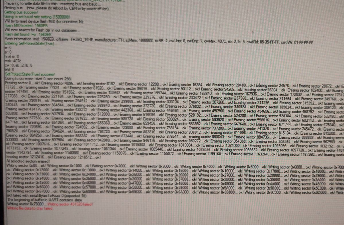

    Now I cut the RX and TX traces and got connection, but it stops. Why? Not same time every try but nearly, and with all baud rates. [BK7231N] [CB3S] [AHT20] TH01 Generic Temperature and Humidity Sensor Teardown
    I tried 2 serial-USB adapters and 2 types of power supply. Every time same error.
    Added after 3 [minutes]:
    Now it goes to 100%.
    "CRC matches 0xA4183270!
    Writing file data to chip success."
    Change was to unbridge GRD from USB-serial to ground from power supply. Or luck.
    EDIT02: And now flashing stops again. Don't know what the problem is.
  • #26 20627443
    Posts: 14750
    Rate: 12865
    Hmm, strange, just to be sure, can you also check with hid_download_py Python tool? Please see this video for a guide and console command:
    https://www.youtube.com/watch?v=PKkiqDNFIx8
    I am asking because there have been some rare reports regarding GUI flasher issues on certain environments.
  • #27 20627454
    grericht
    Posts: 13
    I also have a thermo-hygrometer with a cbu chip. I tested flashing this chip and got the same problem: "The beginning of buffer in UART contains ... data."
    I will test with Python maybe next week. Actually, I have no Linux.
  • #28 20627616
    Posts: 14750
    Rate: 12865
    It can work on Windows. I have used it on Windows.
  • OpenBeken AP disconnects on Tuya thermo-hygrometers
    #29 20628035
    grericht
    Posts: 13
    Ok. Will try this next.
    I now have reached 2 different Tuya thermo/hygrometers with Open Beken flashed.
    1 I have resoldered the cut traces and on the other I didn't up to now.
    When I power the devices there is the Open Beken net, but on both I only get a short connection and can't reach 192.168.4.1. Connection will be lost very shortly.
    Is this because of the energy-saving mode of these devices?
    Did I have to resolder both?
    How can I get the configuration on the devices?
  • MCU powers WiFi module via transistor switch
    #30 20628047
    Posts: 14750
    Rate: 12865
    Well, @grericht, I think you would benefit a lot from reading related topics.
    Btw, in this topic, isn't it your device?
    https://www.elektroda.pl/rtvforum/topic3975583.html
    I was working on it remotely, with @DeDaMrAz
    But again, yes, you are right, as I said, the MCU (in SOIC case) controls power of WiFi module via that tiny transistor on the board. You have to either connect power to CB3S directly for the time of the configuration or you can do a serious circuit modification, remove MCU permanently and connect AHT20 directly to WiFi module... and use our deep sleep feature.
    Now I would recommend you to consult both topics linked above and then we can try to help you more, maybe @DeDaMrAz can also say something as he has this device, I never had it so far, I only helped him to get it running.
