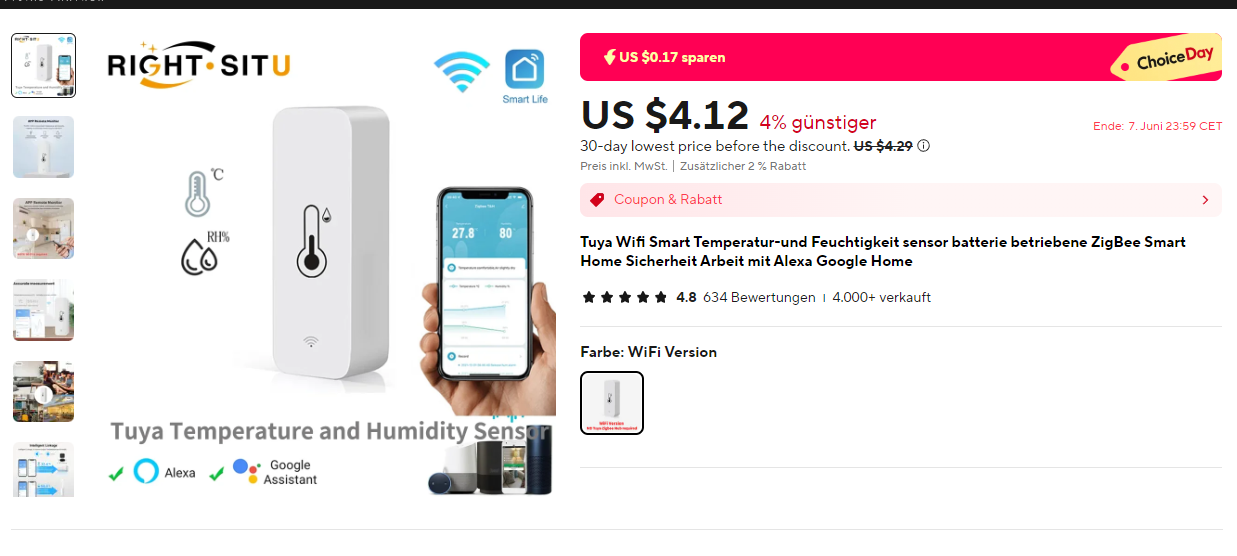

    Display of product listing for Tuya Smart Temperature and Humidity Sensor on an online store.
    https://de.aliexpress.com/item/1005006628378458.html
    Was available for 1.59€

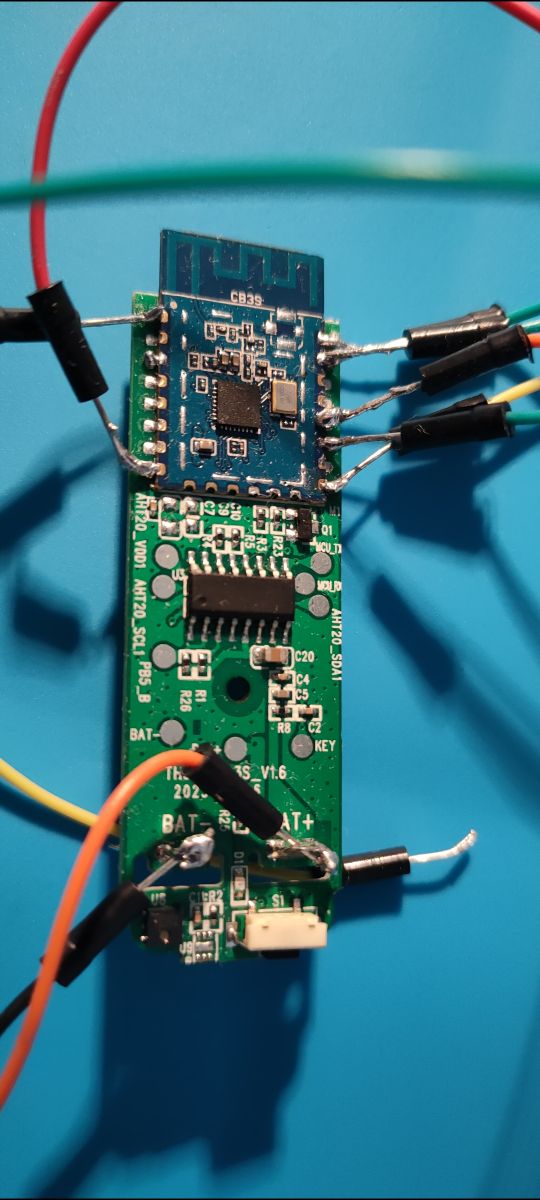

    dismounted the second MCU for flashing and connected the CB3S Module directly to GND.

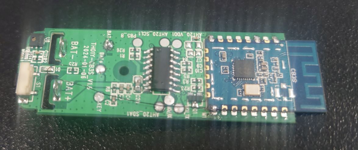

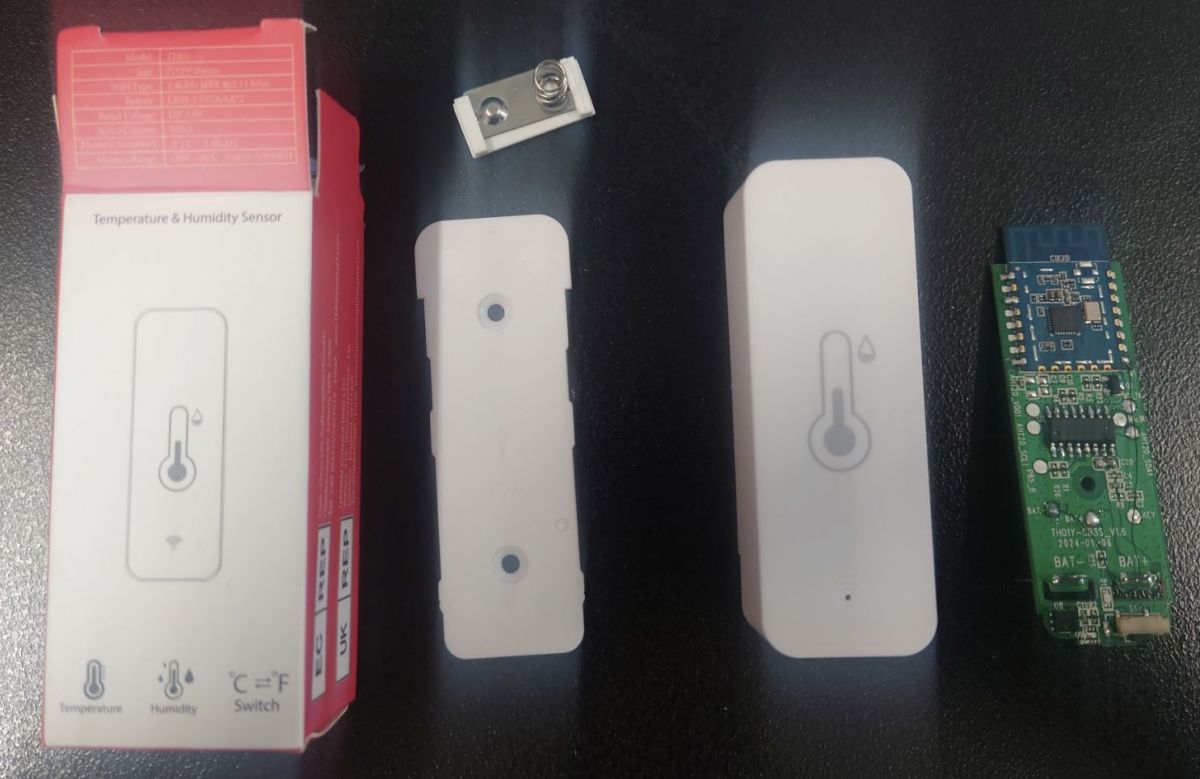

    Temperature and humidity sensor with cardboard packaging, detachable panel, and electronic module. Close-up of TH01Y-CB3S electronic module.
    Device Data:

    What do you mean by connecting the CB3S module to ground? What is the need?
    CB3S module connected to a PCB using colored wires.
    When you power the device via the battery holder, the mosfet between the CB3S and GND has to be bridged.
    You powerd the module directly. So it was not nessesary.
