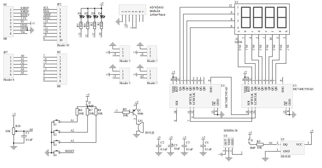

    Diagram:
    Electrical schematic of MultiFunctionShield for Arduino

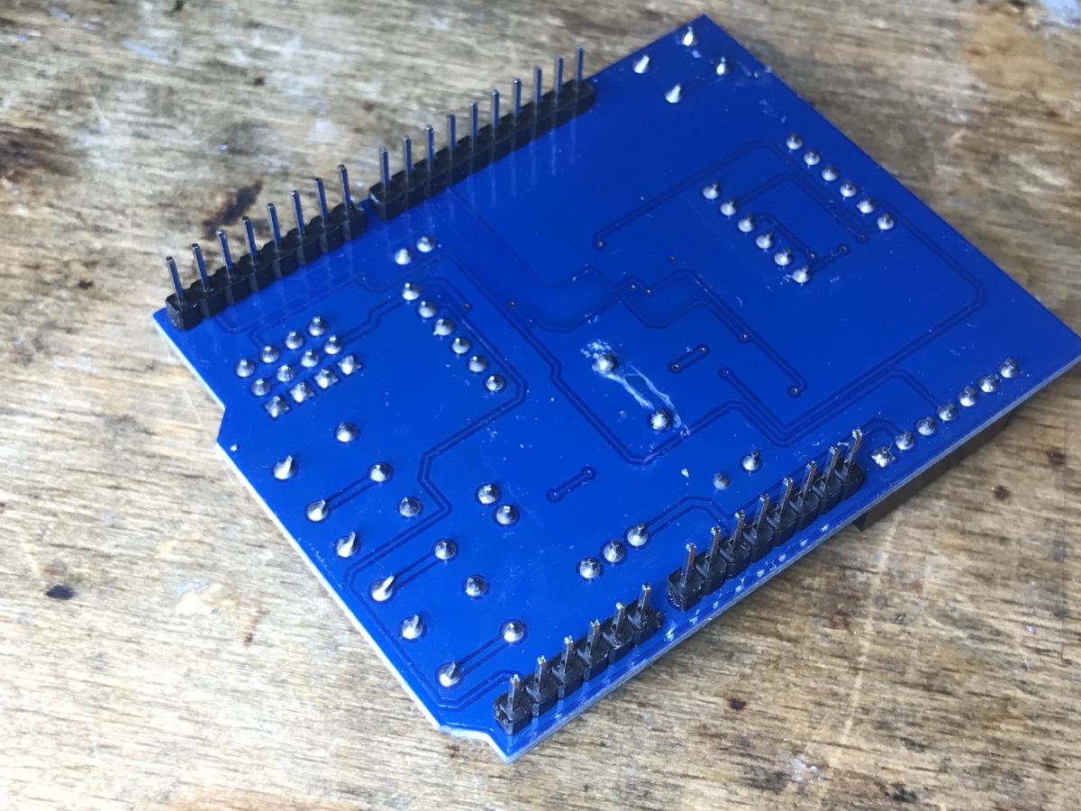

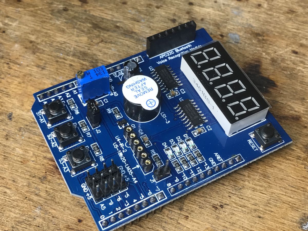

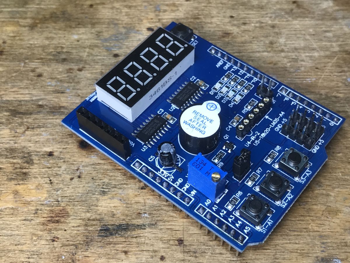

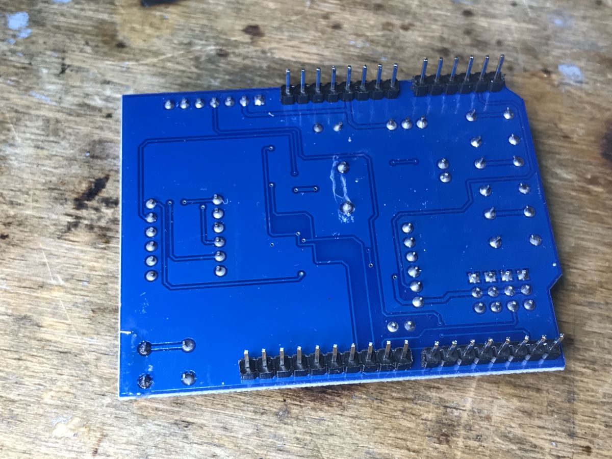

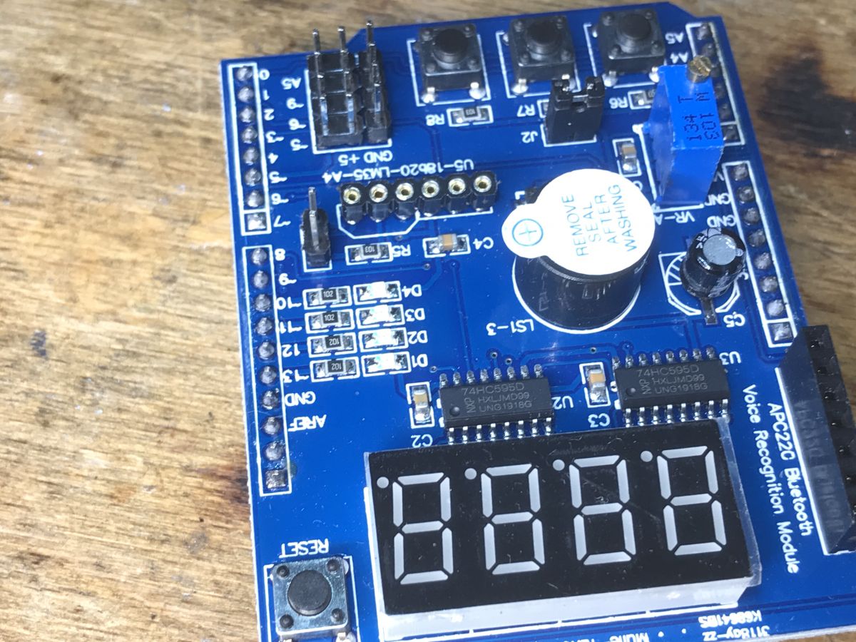

    Actual look, some pics from me:
    MultiFunctionShield add-on for Arduino with a 7-segment display Multi-function shield for Arduino with 7-segment display MultiFunctionShield board with a four-digit display, buttons, and a buzzer on a wooden table. PCB with visible traces and pins. MultiFunctionShield PCB from the soldering side
    So you might wonder what it offers - basically not much:
    Image of the MultiFunctionShield for Arduino with labeled components.
    We have here:
    - 7-segment display with 4 digits, controlled by two 74HC595D shift registers connected in cascade (so 3 GPIOs are needed for control)
    - three buttons
    - buzzer
    - several LEDs
    - potentiometer
    - derived RESET button
    - additional slots for various peripherals, IR receiver, DS18B20 temperature sensor, some other extensions
    Some basic projects can be done on it. That's what we're going to try to do right now.

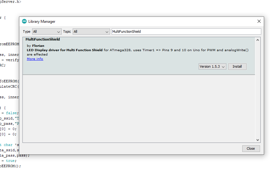

    On Arduino Uno R3, the one based on Atmeda, the whole process is very simple. Just install the library with the same name as shield, it is available in Library Manager:
    Screenshot of Arduino library management for MultiFunctionShield.

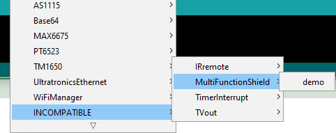

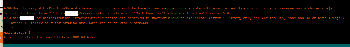

    Unfortunately, it is not supported on R4. Even the Arduino IDE hides it specifically from us, because in the library settings (library.properties) is marked to work only on AVR:
    Screenshot of the Arduino IDE interface showing library selection options, with MultiFunctionShield highlighted.
    Even if we force it open, it won't compile.
    Compilation warning during an Arduino project regarding libraries.
    We'll need to port it to a new platform, but let's get to the code first.

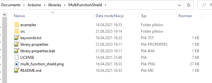

    The downloaded libraries reside in the Arduino folder, for me it is:
    C:\Users\Admin\Documents\Arduino\libraries\MultiFunctionShield\src
    We have there e.g. library.properties file:
    Screenshot showing the contents of the MultiFunctionShield library folder.
    Let's see its contents:
    name=MultiFunctionShield
    version=1.5.3
    author=Florian
    maintainer=Florian
    sentence=LED Display driver for Multi Function Shield
    paragraph=for ATmega328, uses Timer1 => Pins 9 and 10 on Uno for PWM and analogWrite() are effected
    category=Display
    url=https://github.com/coderfls/Arduino_MultiFunctionShield
    architectures=avr
    includes=avr/interrupt.h
    You will need to modify the architectures entry. Now let's go through the folders. There is only an example sketch in examples:

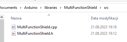

    Ok, back to the porting issue. Let's check the source code of this library first:
    Screenshot of folder with MultiFunctionShield.cpp and MultiFunctionShield.h files
