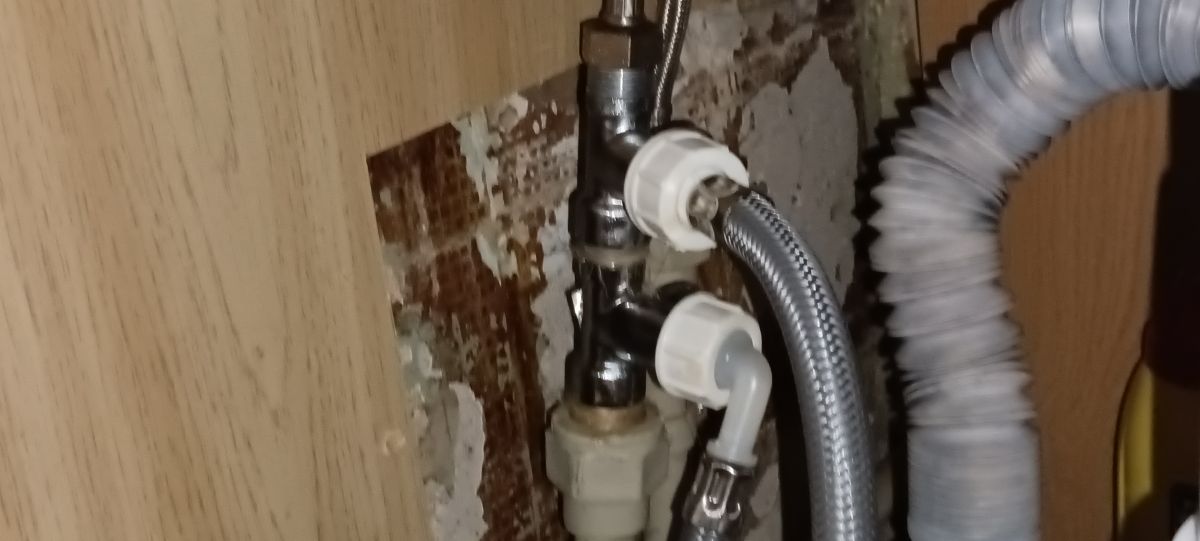

    Hello, I am trying to solve the mystery of the bad smell. My washer is a Beko WTE 5511 B0. The rotten egg smell only comes when the washing machine starts drawing water. When you start it, it draws about 1 liter or something of water which stinks. After drawing the water, it is fine. I had this problem and decided to replace the intake hose because the smell was coming only from the hose itself, not in the pipes which are under the sink in the kitchen (kitchen faucet water does not smell bad at all and the pipe which supplies the water is the same pipe for the faucet and washing machine and dishwasher). So replacing the hose helped only for about 3 months or something. After replacing the inlet hose, I was so happy because the rotten egg smell was finally gone and it made sense, neither the main cold water pipe smells nor faucet water. Today, the smell has returned. It doesn't make any sense. I checked everything under the sink again. I unscrewed the 3/4 hoses for both the dishwasher and washing machine, and nothing stinks, neither from the hose nor from the tee valves. I ran a little bit of water from the unscrewed 3/4 part from the tee valve and the water is fine, which makes sense as I said the water from the faucet is good. So I'm sure the problem is not under the sink. Also, today I tried to check not the part under the sink where the dishwasher in this case connects, but I checked the part where the dishwasher connects in the machine itself. I ran some water there with the unscrewed hose and it doesn't have a rotten egg smell. But when I started the washing machine, the rotten smell instantly appeared when it started to draw the water. You can open the drawer where you put powder, it stinks so much, but only for 30-60 seconds after it draws that rotten water. There is no issue with the drain hoses, I literally disconnected them, and they actually smell nice like washed clothes. It's not an issue with the draining system at all, neither the filter that is on the bottom of the washing machine smells. The smell only generates in the hose overnight. So, in a simple way, the smell only occurs when you don't use the washing machine for a day, then it rots, I guess, in the intake hose itself. And then when it draws water, it stinks, but when it draws the water out of the hose, the fresh water comes in and it doesn't smell anymore. I literally read like 50 posts everywhere on the internet. I CAN'T FIND THE SOLUTION. WHAT KIND OF NONSENSE IS THIS? Can somebody help? There was a similar topic created, I wrote about my problem there but I haven't received any answer: https://www.elektroda.com/rtvforum/topic3364268.html
    I'll add the picture of how the setup is under the kitchen. The top 3/4 connection is for the dishwasher, the bottom is for the washing machine. It's a single pipe coming under and 2 tee valves are connected to it, and the top of the tee valve the faucet connects to it.
    Plumbing connections under the sink with visible hoses and fittings.

    But how does the hose itself create that smell? If the connections under the faucet do not smell at all? I am only thinking right now that the washing machine itself infects the end of the hose connected to it, so is it the washing machine's fault? But when I removed the top of the washing machine, the mechanism for intake seems so simple. Just two 6cm little hoses coming into the drawer (or whatever it is named where you put powder). I still don't understand how 40% of the hose closer to the washing machine smells like rotten eggs, and 60% of the hose connected to the under faucet does not smell like rotten eggs?
    Added after 8 [minutes]:
    The connections for intake water for the dishwasher/washing machine are two identical tee valves. How on earth does the dishwasher not smell, and the washing machine stinks like rotten eggs when you turn it on and it draws water from the same source for 30 seconds? I think we are still missing something, these washing machines are ****. :( .. Bruh. One cold water pipe supplies cold water to the faucet, washing machine, dishwasher, and only the washing machine gets infected with this sulfur/rotten egg smell. Like how on earth? I replaced the hose today but I doubt if it will help since I did that previously, it only lasted 3 months before the smell came back. It's either the water source is super bad or the washing machine is literally so bad, or the combination of the two. Although that model received good comments from customers.. What on earth is this ****.. :9 5 Sources, bathroom, toilet, shower, faucet, kitchen faucet, dishwasher do not smell like this and the washing machine does smell when it literally comes from the same source.. and it's not drain hoses because they actually smell like washing powder, a pleasant smell. Something in between the connection of the inlet hose and the 5cm hoses and drawer causes the smell. This is my only theory. Or the water itself has a lot of sulfur but it only manifests in the washing machine (edited post, a lot of typos)

    Replace the hose and the problem is solved.
    I had the same thing and even rinsing it with heavy chemicals only helped for a while.

    Yeah, that's what I did previously and it only lasted for 3 months or something and it came back. I purchased a different hose a couple of days ago, although they are like $3 everywhere, this one is a little bit different. I installed it on Thursday (the new hose). Today, I will check if the water smells or not. But I'm not hopeful even if it won't smell because previously I replaced the hose as you said, but it only lasted 3~ months until the smell came back again. But who knows what will happen. We will see. We need some scientists to explain what the hell is going on :D Maybe the water has sulfur in it? And the rubber hoses somehow react to it and create the smell? Ahh, I don't even know, no point to speculate. Or as I said in a similar post where a person had the same problem, they said that replacing the machine fixed the problem. 1 guy had a corroded tee valve and he replaced it and it fixed the problem, but he didn't respond (2020 post) after that. It would be interesting to know if the smell didn't come back after replacing the tee valve and hose.

    I came to the conclusion that it may be the water source. I live in an old construction building, maybe the water has not necessary the bacteria but components to make that sulfur smell. I changed the intake hose 3 times and it stops smelling for a month or less, so that didn't help. Probably something builds up over time and you can't do anything about it. My brand new dishwasher intake hose also has the smell when I checked it out of curiosity, but of course, the dishwasher sprays a lot of water so the smelly water washes away quickly and does not affect the dishes. However, with the washing machine, the clothes kinda marinate in that and smell pretty bad after washing, lol. What I do now is just start a rinse program so the smelly water gets drawn and then I drain the water away with another program, and then I start my normal washing. Pretty annoying, but what can one do? One guy who was fixing my tee valve also said that he has the same problem and he's a plumber. He also said that he doesn't have an idea why the egg smell occurs... mystery, huh? Especially when my faucet is literally connected to the same water intake hose and the faucet never smells overnight or ever. At this point, I just blame the old building and the bad quality water they provide.

    Hi. Its been a rollercoaster with this sulfur smell. Didn't find any solutions so I decided just to DIY everything myself with quick connector's so I don't need to solder PPR pipes (the water supply pipes) because I don't know how to.
    So I built a new branch under my sink with them, changed all hoses obviously, then changed the faucet too which was old, changed washing machine to new, but kept the dishwasher cuz it still pretty new but couldn't change the aquastop hose because in that model it is integrated in the machine itself you can't just unscrew it from bottom like on the front load washing machine <why all of this?: because the point is to remove all hoses pipes, basically everything thats old under my kitchen sink.
    So I built the whole thing everything brand new new pipes/connectors etc and it first 3 months=no smell, i thought i finally solved it by myself. Thought it was the old pipes and connections, but then after 7 months the small sulfur smell started to build again in the WM drawer when you turn on the washer when it draws water... at 8 months the sulfur smell became even more stronger which was the obvious.. the same shitty problem came back because the smell is exactly the same.
    I investigated the pipes that I built, everything was clean but the endings like branch endings for machine hose connection threads, and the faucet, (3 points where the PPR pipe/QC's end with 1/2male threaded connection) all of them were covered in orange gunk/biofilm. Now.. this means its Iron and the specific bacteria feeding itself from the Iron which is in the water source(some houses even brand new ones have higher iron or sulfur amount in it), it explains why only endings were covered because this is where the water usually stops before entering hoses, it's kinda stopping point for the bacteria I guess idk.. So I researched and the only solution I found is water filters. Since I'm on budget I bought standard 10' housings and 10' cartridges. In my local shop I found iron/manganese removal filters, bought 2 and KDF/Sulfur smell removal filter(atleast it says on the packaging that it helps with sulfur smell), SO I had to redo all the piping again under sink since the 8month old branch got contaminated(which is not normal because pipes last 10, 15 years without problems and smells, > this means I have high iron/bacteria problem in this flat I live in. Its the last floor for me maybe more trash/minerals build up at top flats idk.. So yeah, I installed everything now which was around 2~ days ago. Current setup is: is just 4 housings: sediment>iron>iron again for more efficiency>kdf(probably kdf55 not the kdf 85 which is expensive, because it doesnt say on the label what kind of KDF is in that cartridge i bought) and just hooked up everything with braided hoses from incoming water from the building into the first filter which is connected to the last 3 (4 in total) and from 4th one a braided hose to the manifold which has all the connections I need with shutoff valves for both washers and faucet.
    TLDR: atleast in my flat the problem is that water has high iron or old pipes with bacteria, for example the pipe which goes into my kitchen (the only place where sulfur smell appears) is coming from walls from bathroom and bathroom doesnt have the smell even though everything shares the same pipe.. so that pipe in walls I obviously cant change that would cost thousands cuz I would need to destroy tiles, change bathtub in bathroom etc its just no-no work for me. The only solution is filters, water treatment solutions. Since the filters and housings are cheap , everything costed like 180$ 4housings,4filters,hoses
    Well.. since the smell keeps coming back like a curse well I atleast hope that somehow the filters will reduce the smell or may completely remove it (obviously you have to change those filters every 4-6 months because thats the standard practise cuz they get clogged up with iron/bacteria etc they work as a shield and you need to change them in time).
    The other solution which is very strong and most effective is those 1k$ or 2k$ water filtration/treatment systems. Now In my flat there is no space even for them cuz they are big af there is simply nowhere to put them lol, and I dont imagine how much it would cost for plumbers to install it probably 3k in total for everything maybe 2.5k idk.. But thank god there are solutions but they are just expensive..
    I picked the cheapest route as I said before. with those housings and filters which claim to remove iron/manganese and help with sulfide smell (it explicitly says on the label that it helps with sulfide). So thats it.. No other way around if its not your washer or anything else because I keep my things clean/maintenance always done in time, the drain hoses smell like soup so its not drain issue like you would encounter while googling this problem people say its your drain system maybe drain is backfloowing into the washer etc or you just need to "shock it with peroxide" "run a hot cycle" .. I wish it was the case.. but its not. Its the water supply problem which is only treated by filters. Less expensive or more expensive = it all depends how bad is your water, because if has too much iron/sulfur then cheap filters wont work only expensive ones will.
