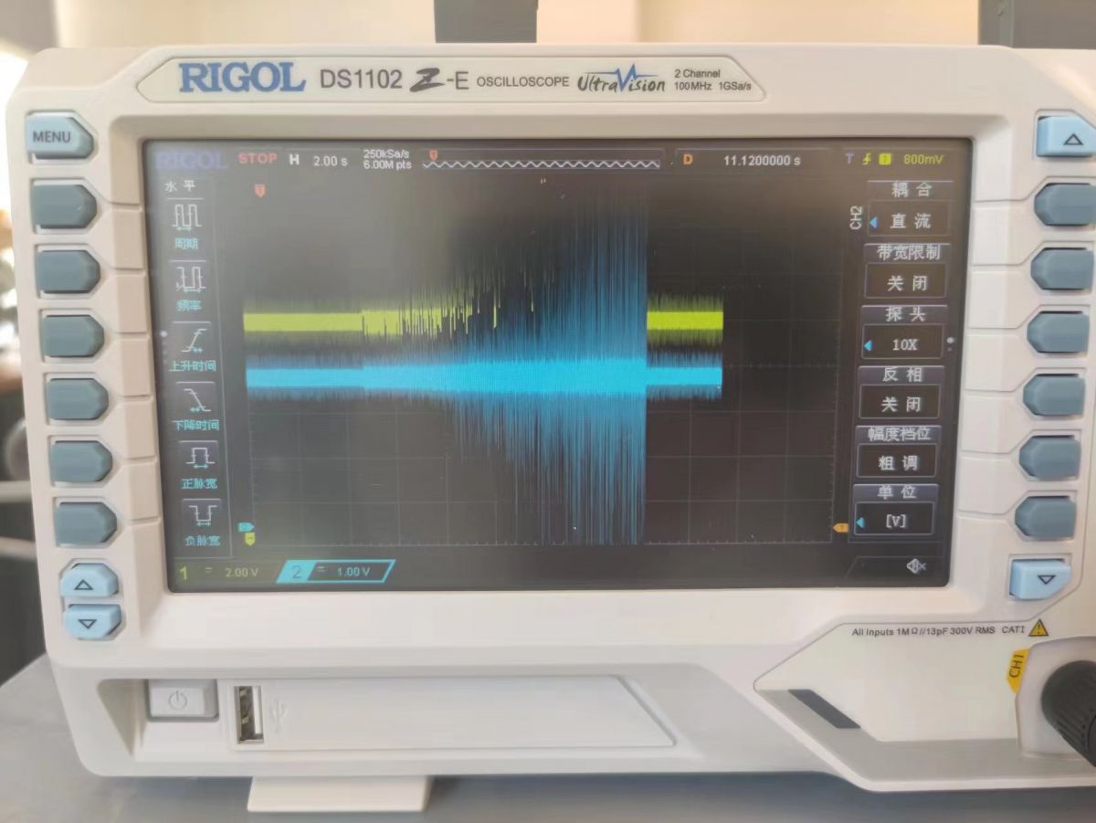

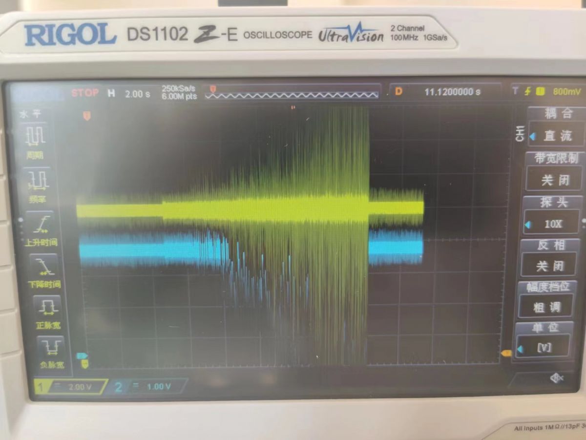

    We discovered a problem when building an inverter from DC to AC. When the IGBT module was working at 15 kW and the voltage of the DC power supply was 650V to 700V, the 5V and 3.3V power supply for the control chips fluctuated significantly, causing the chip to restart. We suspected that it might be caused by electromagnetic interference. We tried grounding, adding filters, and other measures but it didn't work. What is the possible cause and how to solve this problem? Digital oscilloscope displaying signal interference in waveforms. Oscilloscope displaying power supply interference.

    I don't know anything about IGBT, so I'll give you some common potential problems and questions
    potential problems:
    - poor separation of the mass of the control part from the power part (I do not mean galvanic separation)
    questions:
    - How long are the wires in the control circuit?
    - What gate resistors?
    - what was the load?
    - how, how and in what places was the measurement made?
    - the magic ball has a malfunction, without a diagram I will seal blindly

    #3 20739438
    mfac
    Posts: 246
    Help: 18
