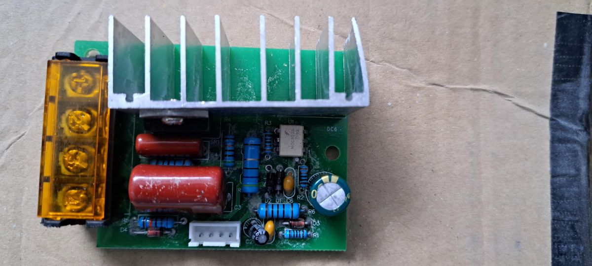

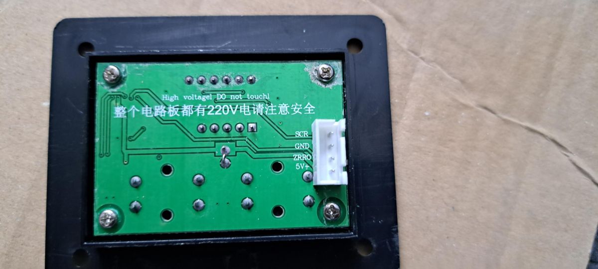

    I have found in the "shpejas" a power controller for a fan or heaters.
    Pictures below.
    Has anyone perhaps tried to control via ESP this system without a control panel.
    Power regulation panel with display and buttons. 220V power controller with labels and connections. Power controller with large heatsink and yellow terminal.
    I currently have the control together with the panel.
    https://www.youtube.com/watch?v=Q18ZgSy1YH0&t=2s
    A script for ESP32 is attached.
    Currently I would like to apply this to Home Assistant and the panel would then be redundant.

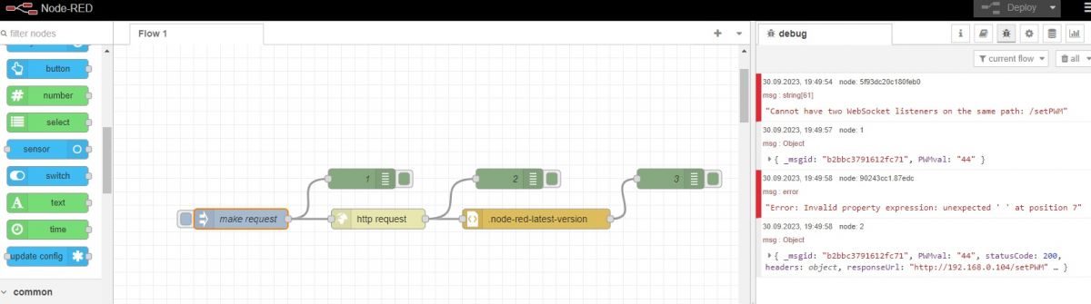

    I'm trying to figure it out in Node-RED, but I'm getting around it poorly.
    It sends me something, but accepts an empty value on the ESP32.
    Attached is a dump and export from Node RED - I'm probably setting something wrong.
    Screenshot showing the Node-RED interface with a flow diagram and debug messages.
    [code]
