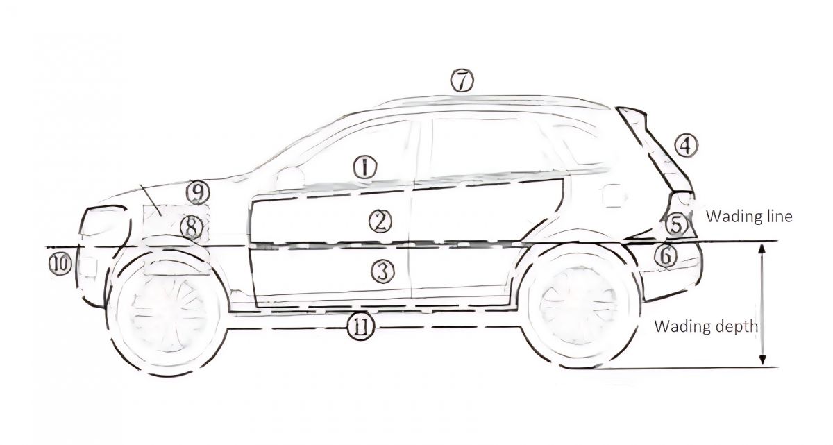

    Ⅰ.Wading depth
    The maximum wading depth of a car refers to the height of the "wading line" from the ground. The "wading line" refers to the height/H of the deepest water that the car can pass when traveling at a speed of 10Km. When designing the electrical system, refer to the vehicle's wading depth, so that key electrical components are arranged above the "wading line" and electrical components are arranged above the "wading line". Waterproofing treatment can be effectively implemented. According to the vehicle's water wading depth and the layout of the vehicle's electrical components and vehicle wiring harness, the layout area of the vehicle wiring harness is divided into the following figure 1
    Diagram of a vehicle showing the wading line and wading depth.
    1. The cab and the passenger cabin; 2. The wading line of the four-door line is above the wading line; 3. The section below the wading line of the four-door line; The part of the security rod involved in the wading line; 7. The roof; 8. The inner frame beam of the cabin;
    Ⅱ. Wet and Wet Area and Wiring Waterproof Area
    According to Figure 1, analyze the waterproof requirements of each region in the analysis line beam.
    Wet area. The area below the wading line is called a wet area.
    Figures 3, 6, 10, 11 and front and rear protection areas 10, 5, 6, cabin area 8, 9, and the roof area 7, and 4 in the back door areas are wet areas.
    The wiring bundle in this part includes the front bumper beam, cable bundle (driving room side), power cord (such as engine wiring), rear bumper cable beam, battery positive and negative polar beam, door wire bundle (below area) wading line) And all high-pressure wire beams. The joints on these wires (except the door line) need to be waterproof design, and the parts that are punching to the internal seal should be sealed with rubber parts to prevent water from entering the cab. In addition, the punching point on the wiring beam must be protected by a thermal reduction tube, and all locations must be protected with glue with the heat shrinkage tube. For the door line, the plug-in below the water line is only a low-voltage speaker, and the plug-in is recommended to be waterproof.

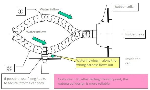

    3.1 Setting dripping points on the layout of the vehicle
    Diagram of water flow in a wiring harness with waterproofing description
