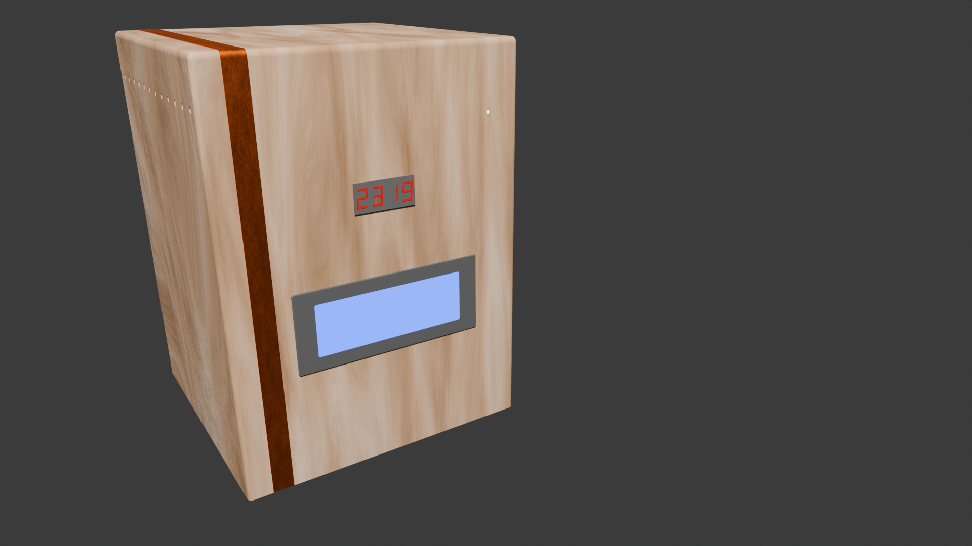

    Hi, listening I am starting my fun with electronics. My first project is a clock along with a thermometer, barometer and hygrometer. The whole thing will be based on ESP32. A visualization is attached. Wood construction and now I have a question. On the left side I would like to make a copper strip that when touched would light up the LED display. I did something like this on a touch sensor ( Link ). Nevertheless, I don't know what to use to make this copper strip act as such a touch sensor? Should I use an operational amplifier, a transistor? Can you suggest how to do this?
    Visualization of an electronic device in a wooden case with an LED display and a copper strip on the left side. .

    Look at the TTP223 chip.
