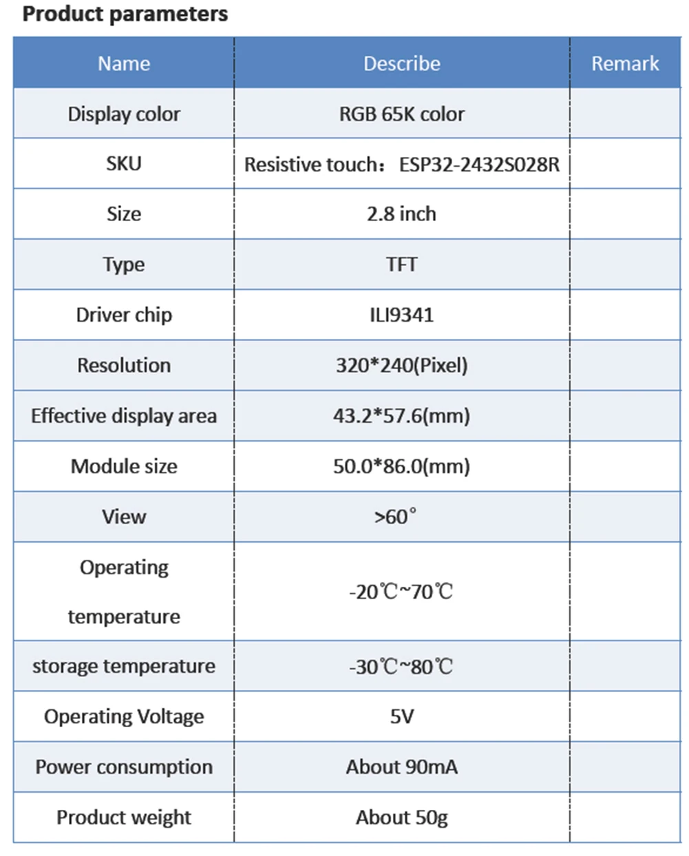

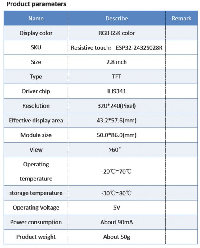

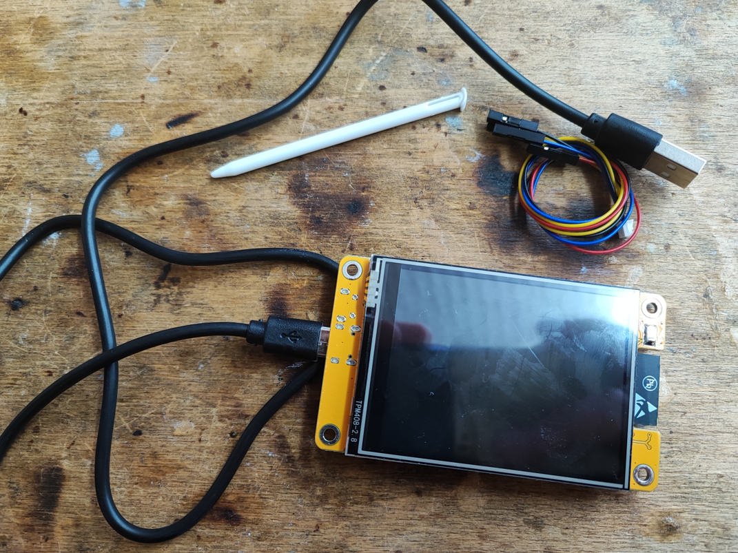

    We also get a stylus and USB cable and expansion cables in the kit. Specifications from the vendor:
    Technical specifications table for ESP32-2432S028R board .

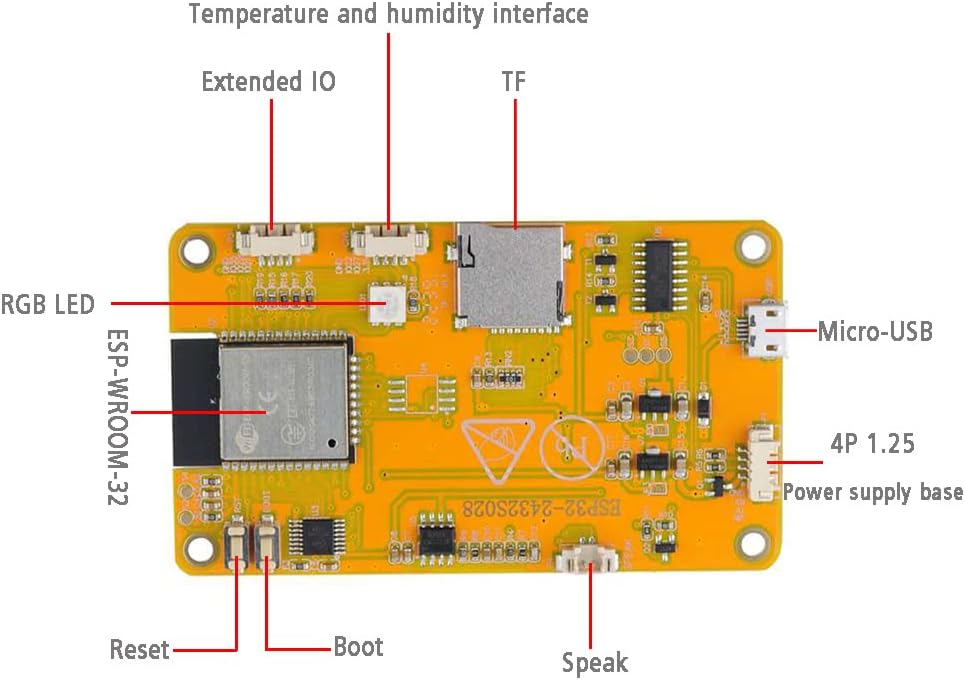

    Board (my version already had USB type C):
    ESP32-2432S028R board with visible components and ports. .
    ESP32-2432S028R board with labeled components

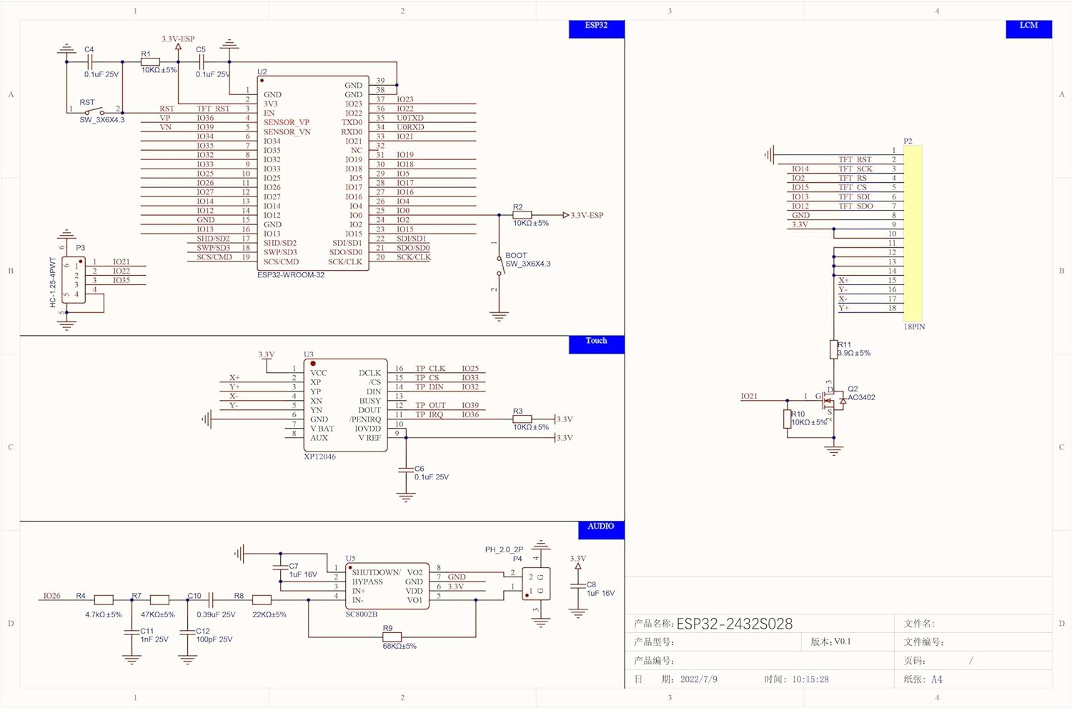

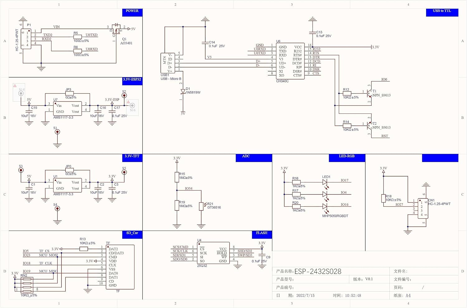

    Scheme:
    Schematic of the ESP32-2432S028R board with TFT display connections .
    Connection diagram of the ESP32-2432S028R board with display and touch panel .

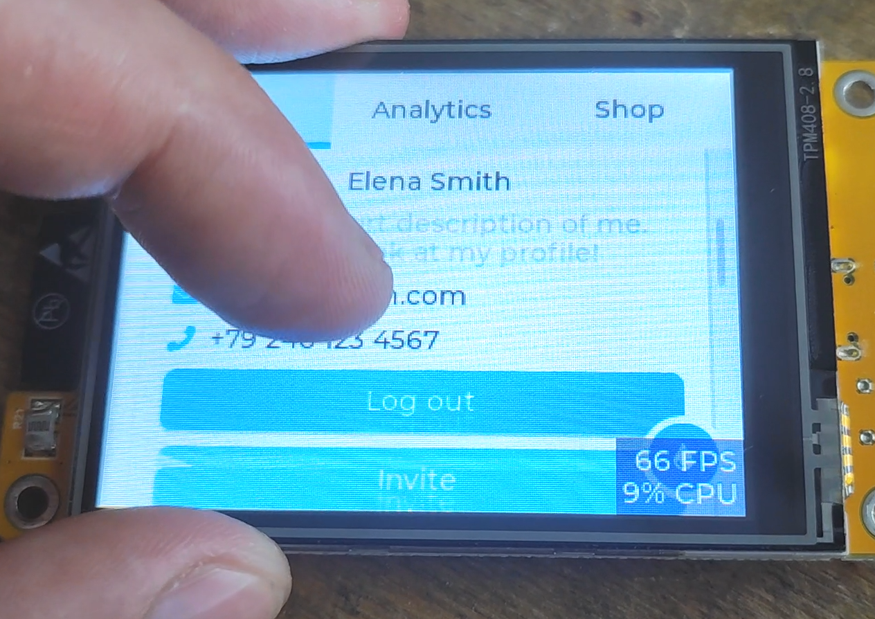

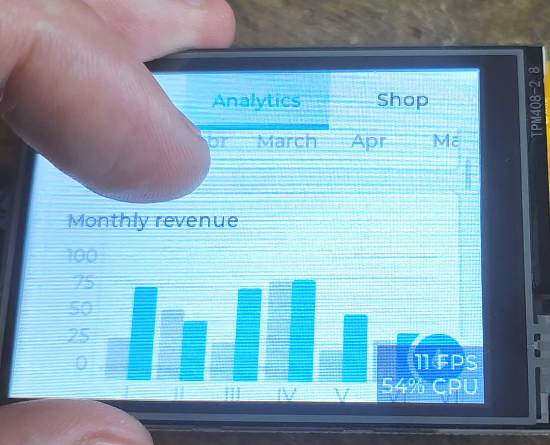

    Factory demo

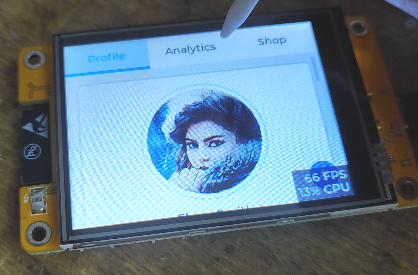

    The display is received with a demo program uploaded. This program is available for download on my flash dumps repository:
    https://github.com/openshwprojects/FlashDumps/tree/main/IoT/ESP32

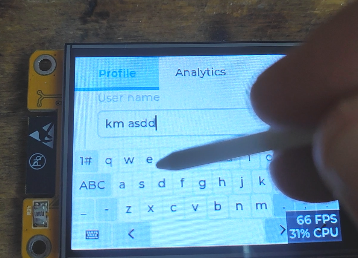

    The program itself is impressive, it shows not only graphics but also interactive elements, of course scrolling works, and you can even type text in the fields (a touch keyboard appears, just like on today's smartphones):
    ESP32-2432S028R board with TFT display and stylus Hand touching the LCD display showing user information segment. ESP32-2432S028R board with a 2.8 TFT LCD displaying a bar chart. Color LCD TFT 2.8 display with a chart. ESP32-2432S028R touchscreen with stylus Person using a stylus to enter text on the ESP32-2432S028R touchscreen. ESP32-2432S028R board with LCD TFT display and onscreen keyboard .
    Videos showing the demo. General interaction with the demo:
    Text entry looks like this:

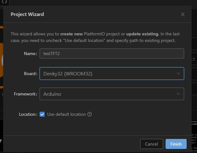

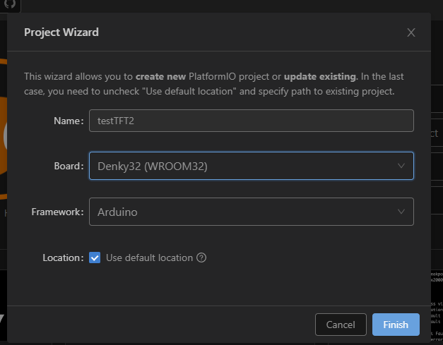

    I'm assuming the reader knows some of the basics of this environment, but I'll still try to show a lot.
    I started by choosing a platform for the project. There wasn't this particular board what I have, so I chose another one on WROOM32:
    Screenshot of the PlatformIO project wizard showing settings for the Denky32 (WROOM32) board with the Arduino framework selected. .
    Ok, we have the project ready. What do we want to do now?

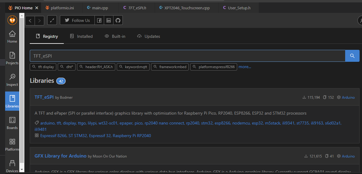

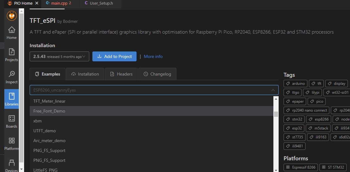

    Let's perhaps start with the character display. We search for the TFT_eSPI library
    Screenshot of searching for the TFT_eSPI library in the PlatformIO environment. .
    The TFT_eSPI library by Bodmer operates on platforms such as the ESP8266, ESP32, STM32 and even the RP2040. It supports displays such as GC9A01, ILI9163, ILI9225, ILI9341, ILI9342, etc.
    Of course, it is available with examples:
    View of PlatformIO screen with TFT_eSPI library added to a project. .
    However, I have not been able to get it to work immediately - I will save you the trouble.
    One file needs to be modified as the pin/communication definition doesn't match. Fortunately this same module has been run by someone before, Github user RuiSantosdotme provided a ready-made one:
    https://r aw.githubuse rconte nt.co m/RuiSantosdotme/ESP32-TFT-Touchscreen/main/configs/User_Setup.h
    So, we find in PlatformIO (or in our project folder) and replace the indicated file. Now it's time to display something. To do this:

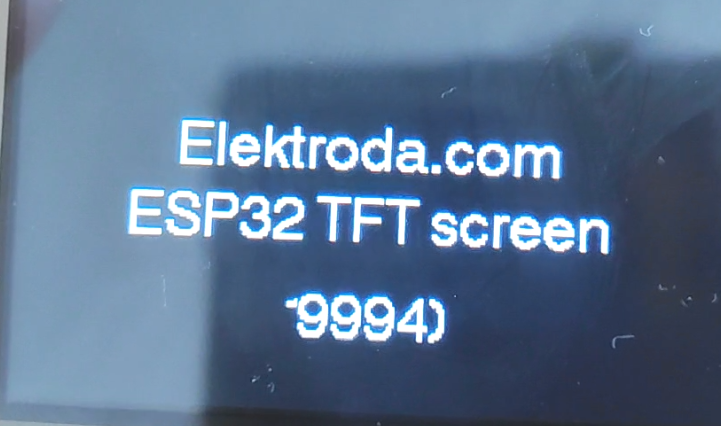

    - we include the SPI and then the TFT_eSPI headers
    - create an object of the TFT_eSPI class
    - in setup we initialise it and perform sample graphics operations
    Here is the code:
    Code: C / C++
    First we call init to start the display. Then we can set its rotation (rotation), clear the screen with one colour and display text on it.
    The result:
    Colorful 2.8 TFT display with text Elektroda.com ESP32 TFT screen .

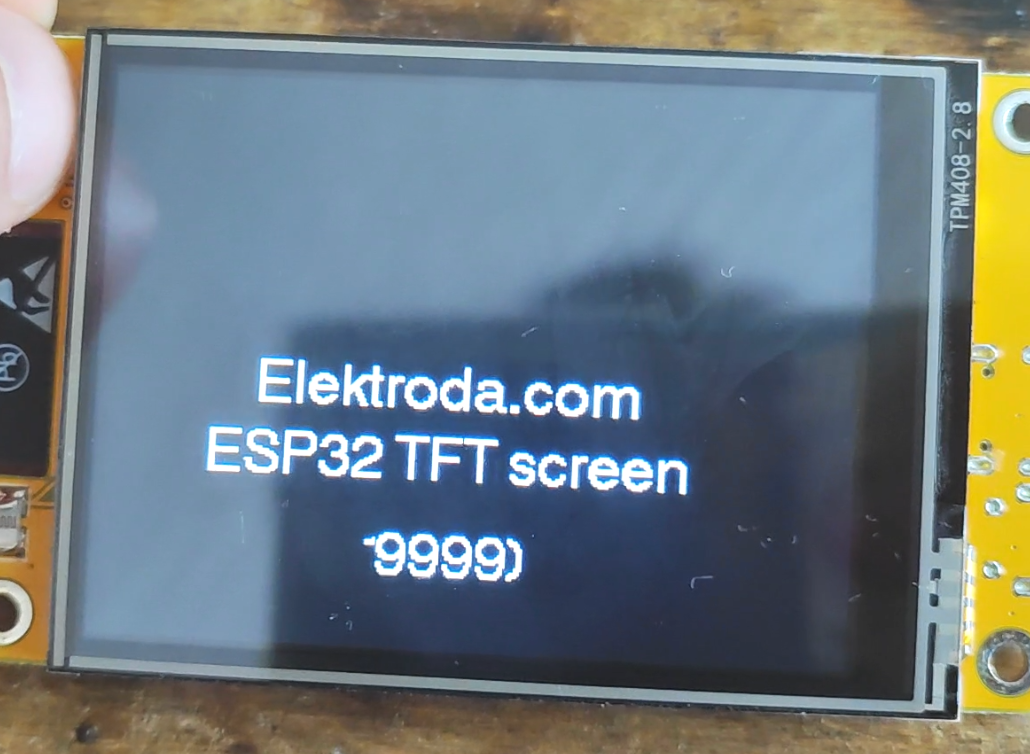

    The same can be done for example with a countdown. One would just like to add another drawing of text in the loop, but is that enough?
    Code: C / C++
    However, it's not perfect. I've specifically done a countdown to highlight a problem - our new text appears on top of the old text:
    ESP32 2.8 TFT display showing text Elektroda.com ESP32 TFT screen Close-up of a TFT display with text and number .
    It looks like we have done something wrong. For this to work properly, we should either at least obscure the old pixels every time new text is applied, or fully refresh the entire screen. So far we've done a full refresh, so after this fix the whole display goes into a loop. Here's the result:
    Code: C / C++
    I took the easier route, which is to clean the whole screen and then redraw everything. Now there are no leftover characters from previous texts on the display. However, this is not an efficient way to do it, because if we displayed more things on the screen, it would force us to redraw everything.... in part two I will show how this problem can be solved.

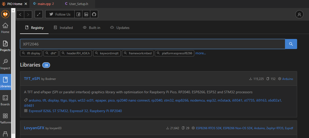

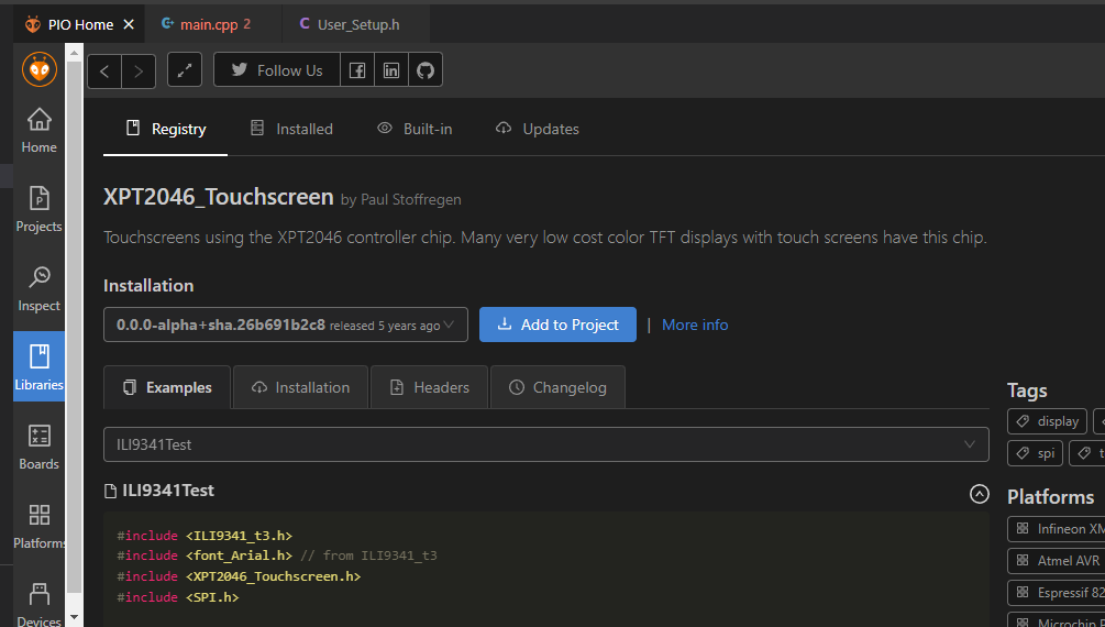

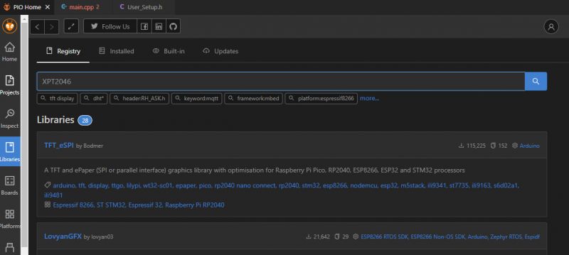

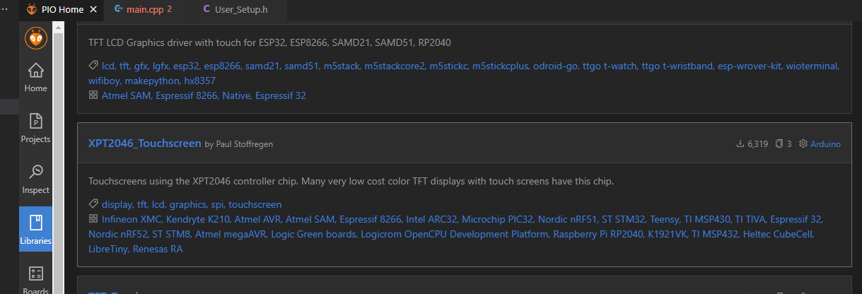

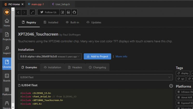

    The display is already there, but that's only half the story. We still need to handle the touchscreen, i.e. the inputs from the user. The touchscreen is able to give us location and pressure.
    We are looking for a library that can handle XPT2046. I have chosen XPT2046_Touchscreen.
    PlatformIO interface with XPT2046 library search .
    Screenshot of PlatformIO showing the libraries section. .
    I have added it to my project:
    Screenshot of the PlatformIO environment featuring the XPT2046_Touchscreen library. .

    The XPT2046_Touchscreen class object provides us with access to touch events from the screen. We can check if the screen is touched and the position and strength of the touch. First, however, we need to determine what pins the XPT2046 is on:
    Code: C / C++

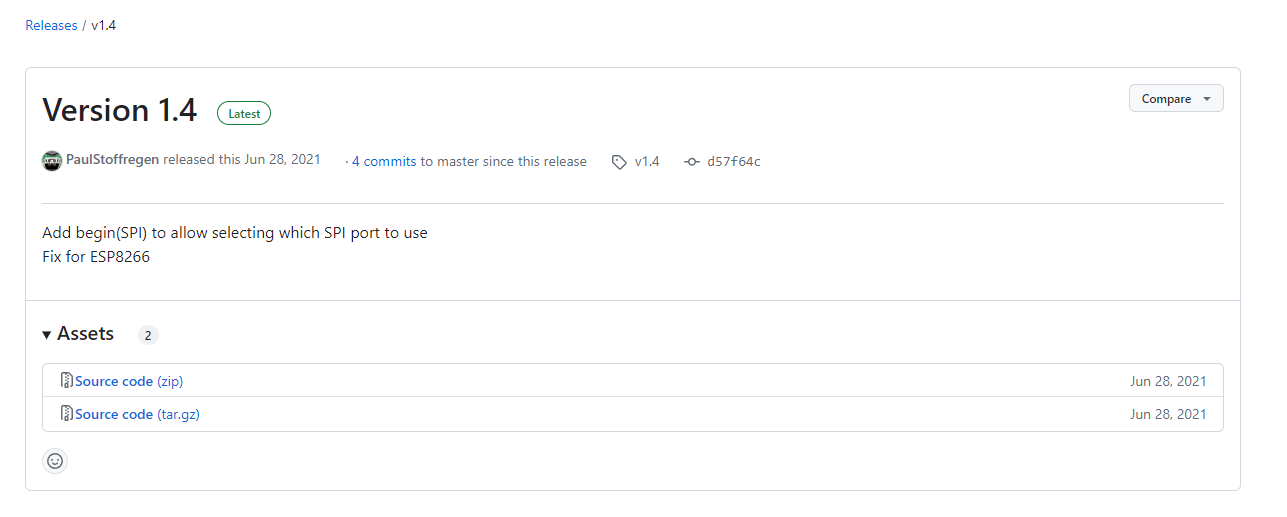

    We save, compile... and surprise - something doesn't work. How is this possible? An example from the web doesn't work?
    Screenshot of a compilation error in PlatformIO during the compilation of an ESP32 project. .
    The problem is:
    src/main.cpp:79:35: error: no matching function for call to 'XPT2046_Touchscreen::begin(SPIClass&)'
    A brief web search shows us the solution:
    Screenshot of GitHub page with information about version 1.4 .
    It was not until version 1.4 that the SPI port selection was introduced. We need to update.
    You have to manually download the newer version from Github:
    https://github.com/PaulStoffregen/XPT2046_Touchscreen
    And probably in some form the one on PlatformIO is older.
    By default, someone changed something in the library and the rest was not updated.

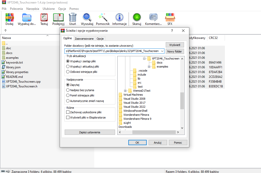

    So, I downloaded the newer version from Github and extracted it to where PlatformIO keeps what I downloaded via Visual Code, which is to libdeps:
    ZIP file extraction program window displaying folder structure. .
    After that my code should work, but I was impatient and added something else right away....

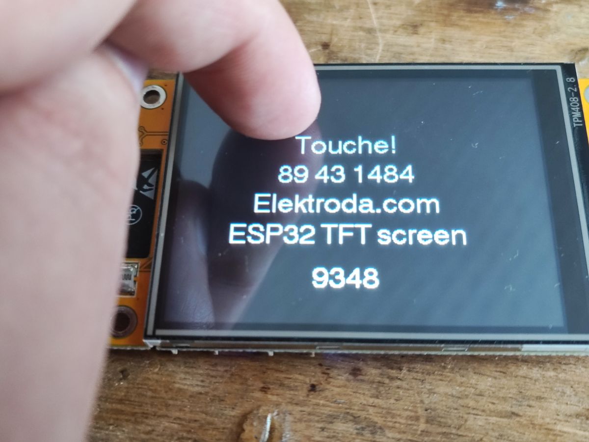

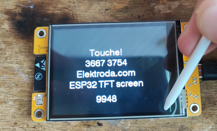

    Location and pressure

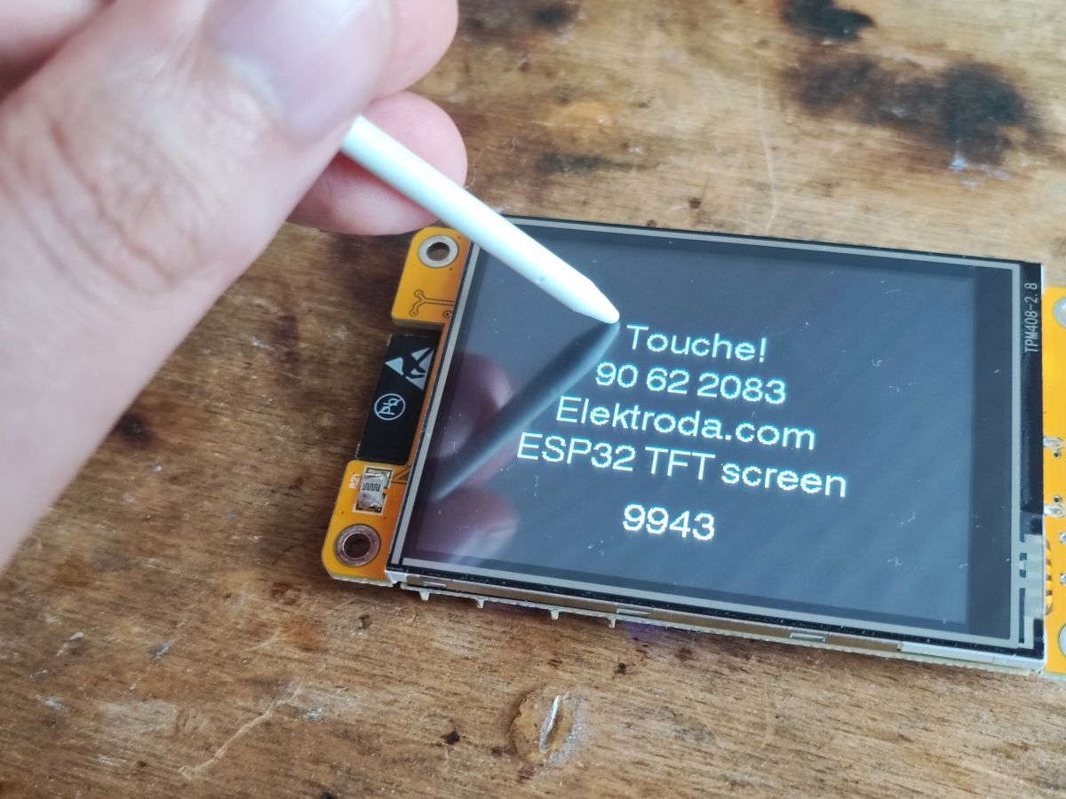

    The previous code just checked for pressure, and here I've added retrieving the pressure point from an object representing the touchscreen. When there is a touch, I display the text and the location of the touch to the screen:
    Code: C / C++

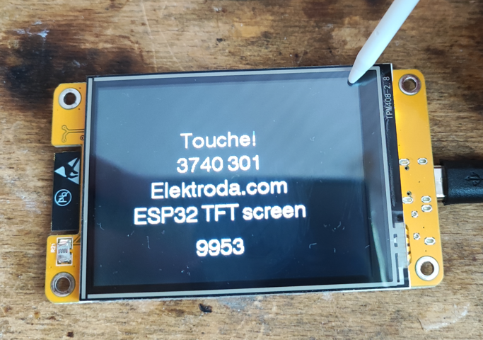

    Testing, here are the results:
    ESP32-2432S028R board with a 2.8 TFT display and stylus. ESP32-2432S028R with a 2.8 TFT touch display and stylus ESP32-2432S028R board with touchscreen display. .
    Something else seems to have gone wrong. These coordinates are weird. Well, yes, they are in TFT virtual space, not in pixels.... a simple mapping needs to be done:
    Code: C / C++
    Now the position displayed corresponds to the positions used when drawing on the screen.
    You can also add the pressure force, this is stored in the Z-coordinate of the point already taken:
    Code: C / C++
    We test:
    ESP32-2432S028R board with a TFT touch display and stylus. ESP32 TFT touch screen displaying texts with a stylus. ESP32-2432S028R with 2.8 TFT touchscreen display <spanclass="notranslate">Finger touching a touchscreen display with ESP32 TFT. .
    It seems to work, but either I have poor touch control in my hands or it's not very authoritative.
    It's more correct now, but I think it could be presented a bit nicer....

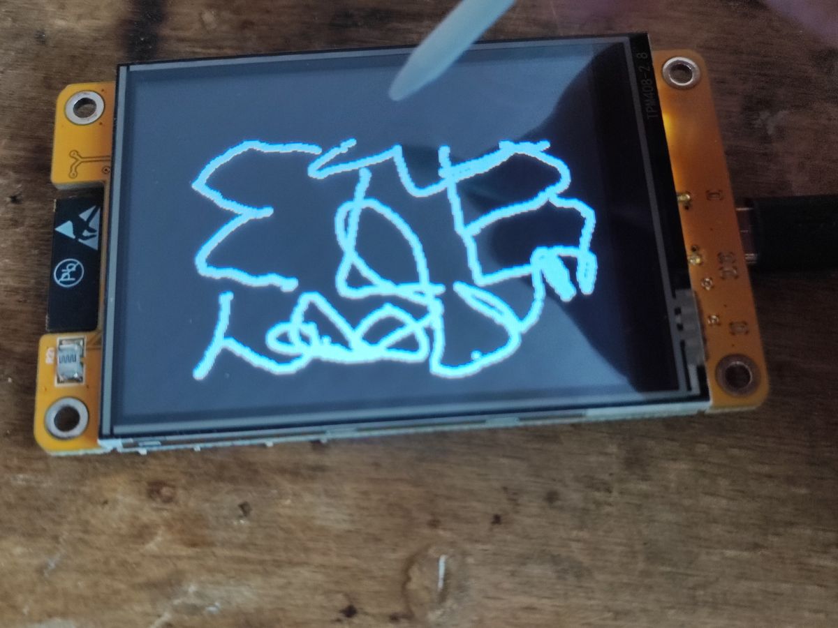

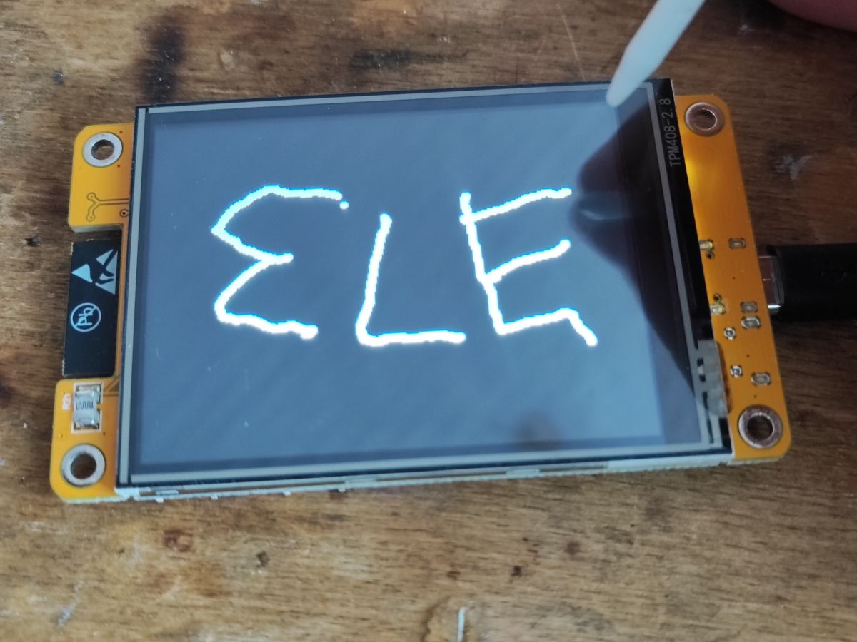

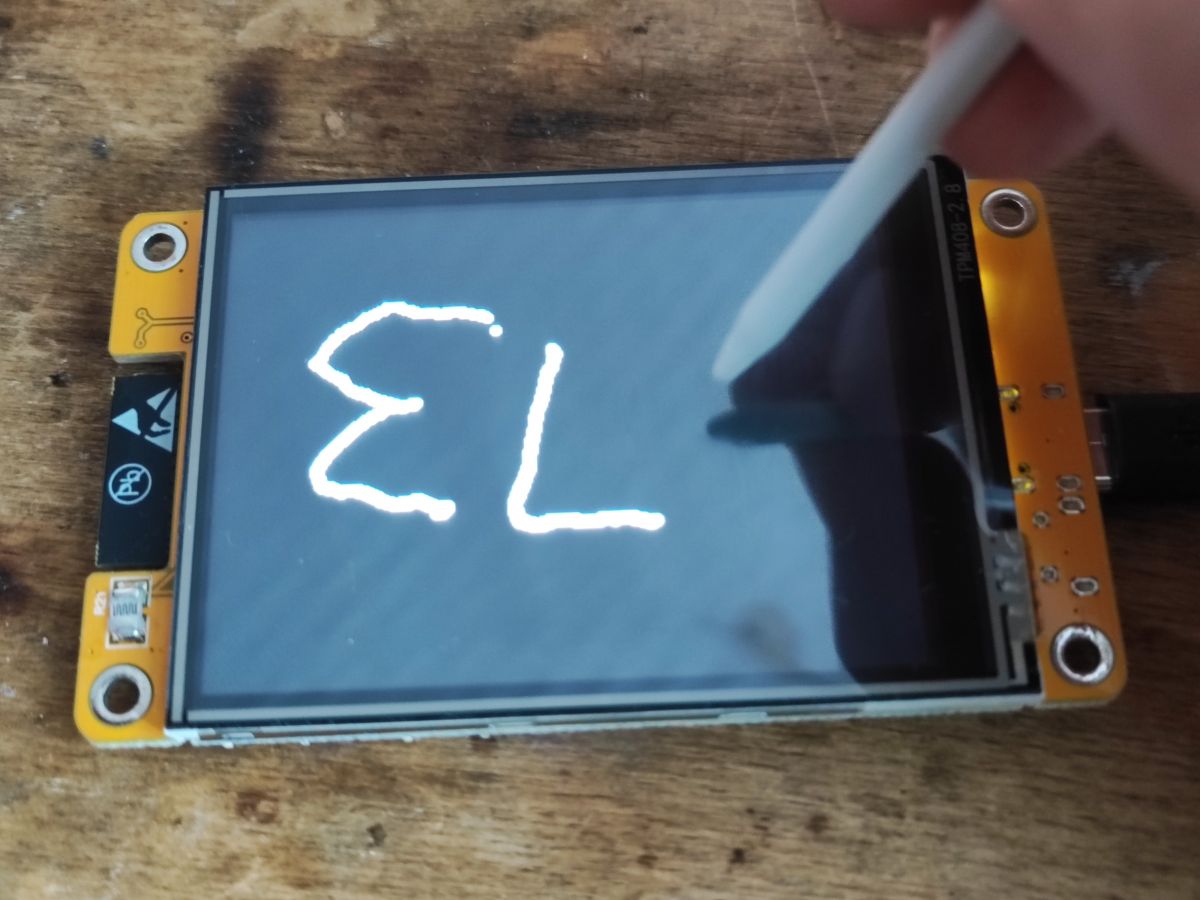

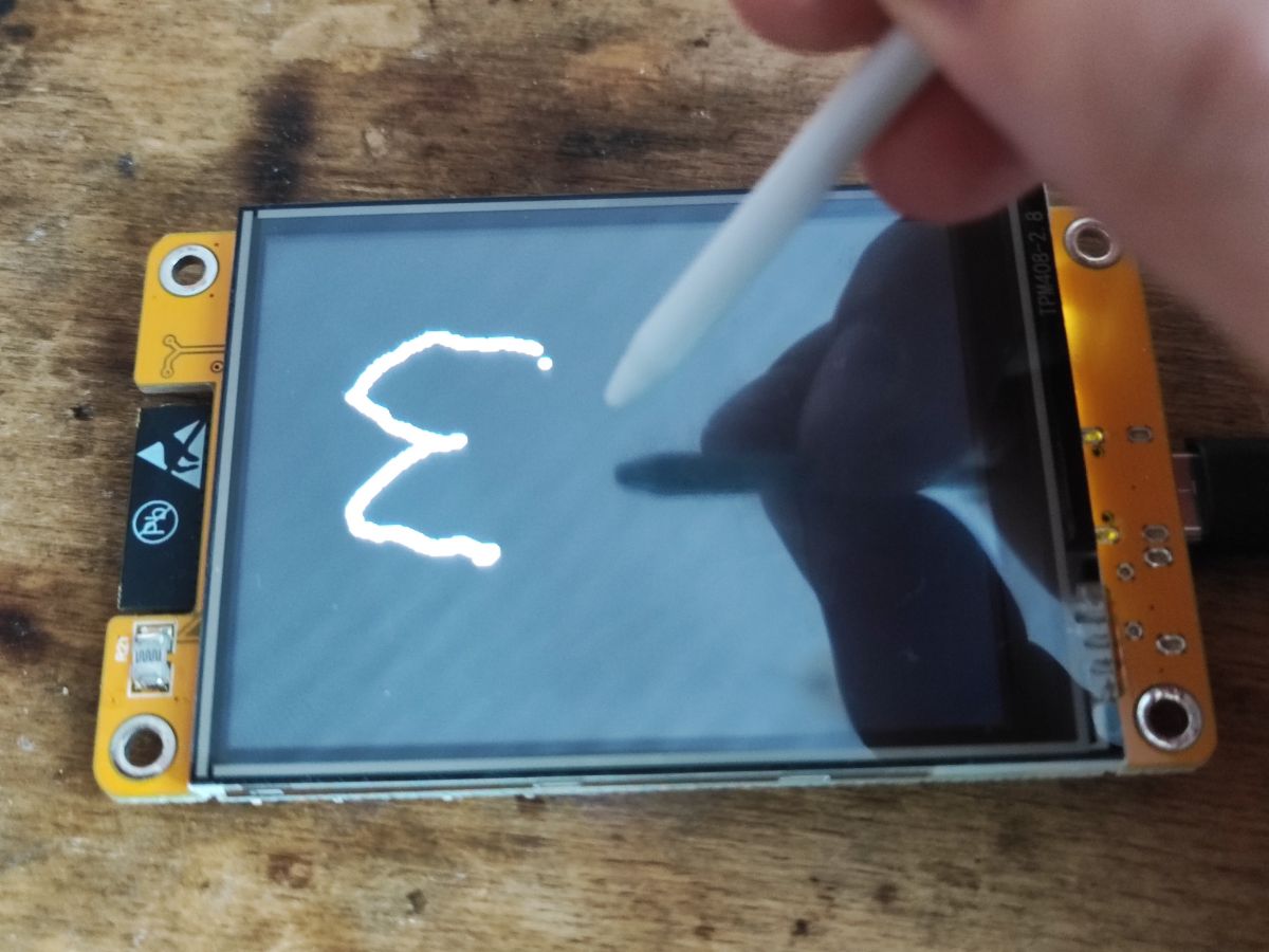

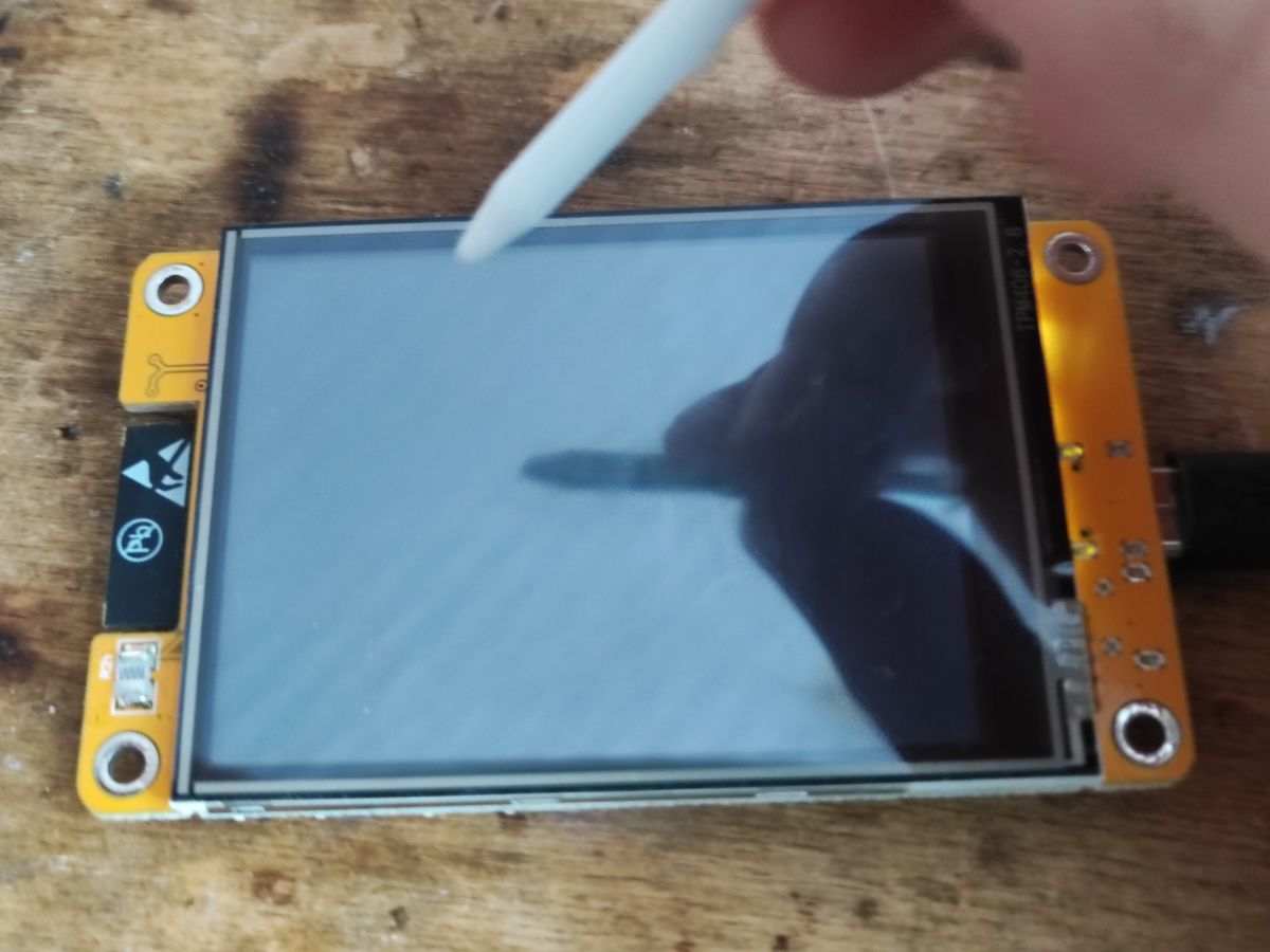

    Draw! .
    Now that we know the basics of the display and touchscreen we can do something more interesting. I suggest a simple drawing activity. Here the plus is that we don't have to refresh the whole screen, because we just add more pixels to it. Then we just have to draw, say, a circle in the pressure event, where the pressure is detected:
    Code: C / C++
    I also removed the wait from the loop to make everything more responsive. I use fillCircle to have a filled circle. Testing:
    ESP32-2432S028R board with a 2.8 TFT LCD color display ESP32-2432S028R board with a large 2.8 TFT touch screen being drawn on with a stylus. ESP32-2432S028R touch TFT LCD screen with stylus ESP32-2432S028R board with a touchscreen ESP32 board with LCD TFT display and drawing on screen ESP32 board with LCD TFT display and drawing on screen .
    Very cool fun! You could go further and add a toolbox on the side, colours and have a drawing toy.

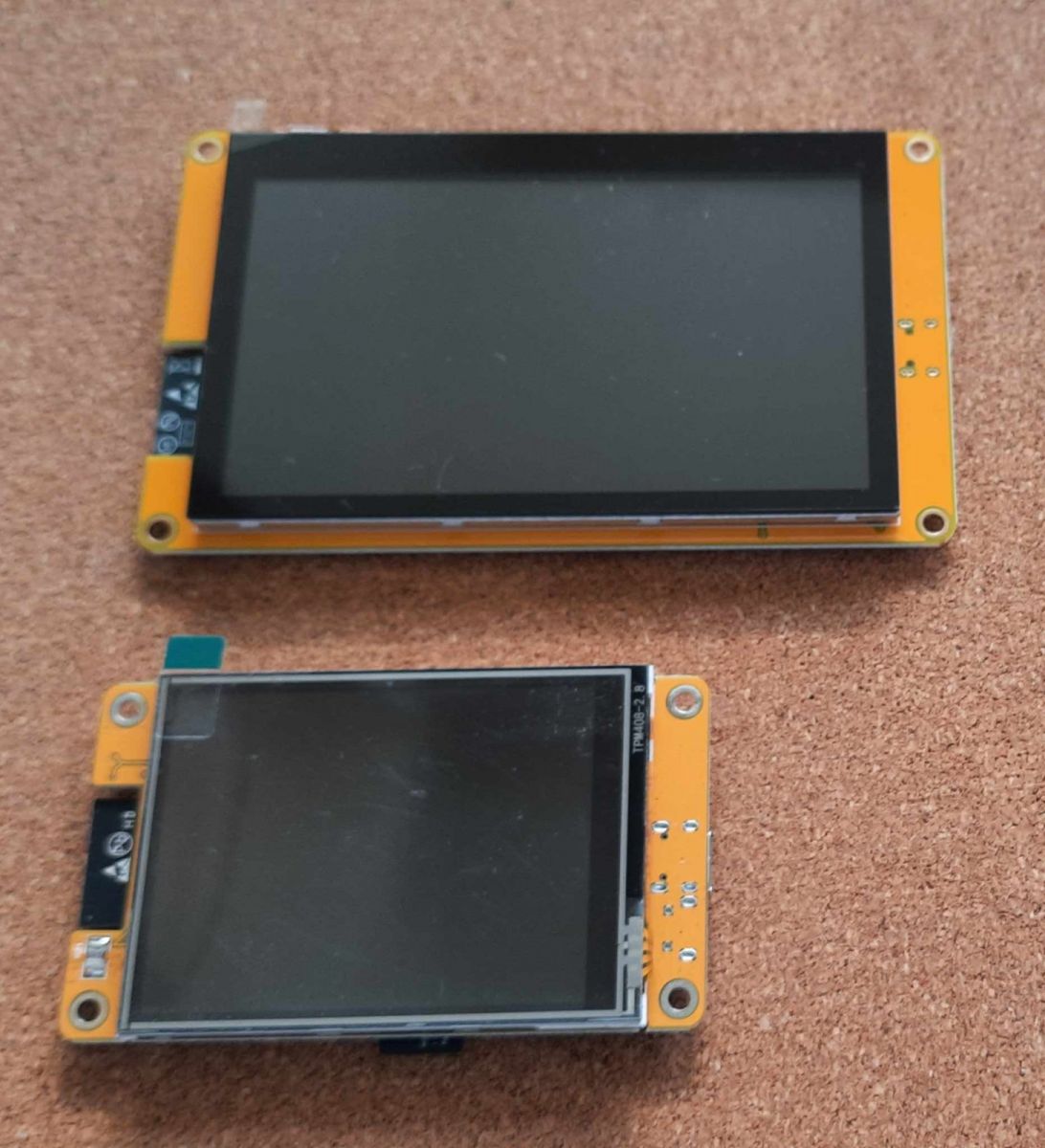

    krzbor wrote:
    This is a very interesting device, but would benefit from a 3.5" or larger screen.
    Modules are also manufactured with larger displays. I bought a 2.8" and when it turned out to be a bit too small I bought a 4.3".
    The Chinese have so much of this that they sell :D .
    Two display modules of different sizes, 2.8 and 4.3, placed on a cork surface. Two electronic modules with yellow circuit boards, a larger one on top and a smaller one at the bottom.

    @gemiel do you also get the impression that this display sometimes doesn't respond very well to touch?
    Added after 18 [seconds]:
    I should add that I'm even talking about the program preloaded here, this LVGL demo

    I didn't try to draw. I only tapped the icons with the stylus and scrolled the page. For me it works reasonably well, a bit clumsy, i.e. like old smartphones.
    This larger panel has capacitive touch. With this screen size, it's easier to operate your fingers and the quality of operation is much better. The 4.3" LCD panels come with resistive and capacitive touch. So there is a choice.
    The 2.8" screen, on the other hand, is small enough that I only use it with a stylus.... and glasses :D .
