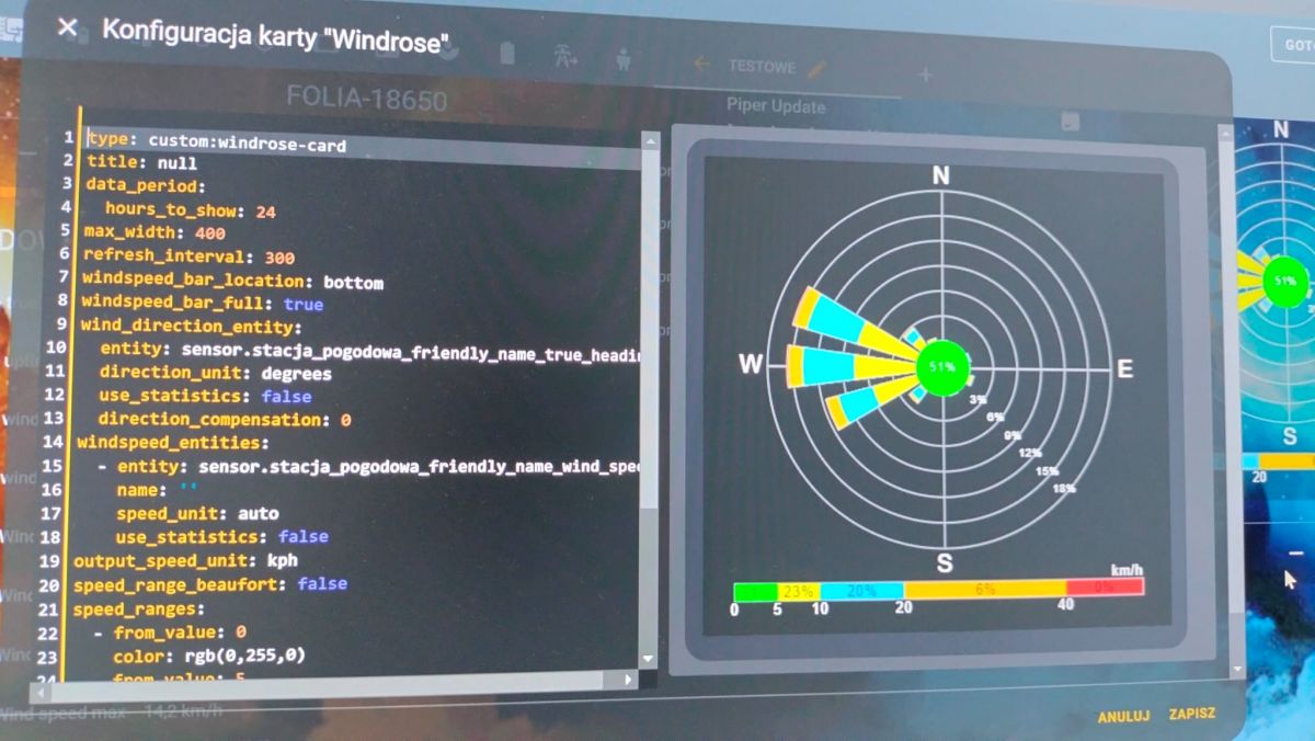

    Some time ago I made a project on a 3D printer for a weather station,
    using the materials on https://github.com/nliaudat/weatherstation?tab=readme-ov-file
    I based the station on the wroom 02 module, because it already uses a built-in socket for 18650, at that time it was one of the better choices for me,
    after adding a voltage divider and LM393, QMC5883L, 5V 0.6A solar panel.
    I set about adapting the Yaml code to my needs, everything in the test phase at home worked quite ok... 18650 cell according to the calculations should last about 30h plus the energy from the panel is known currently very low but in the summer days sufficient.
    I put everything together I tested it works, although I must admit I had to make some corrections to the project from the network.... the biggest misfortune was connecting it by screwing it together like a bolt.... I broke a few cables and changed to L-type connector
    ok to the point, the station worked about 5h after which it said it had enough and shut down at 3.7v :/ I want it to be wireless and support WiFi connectivity.... I can change to 433Mhz but my neighbour is a ham radio operator and he burnt my modules a couple of times already and I would prefer to avoid this :)
    Please advise me whether to look for a solution with support for another cell, bugs in Yaml or forget about it and pull the wire to the station....
    Windrose card configuration screen with wind direction and speed visualization
