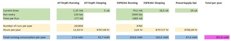

    Calculations
    Before design work can go further, some power calculations need to be made. They are contained in the table below (an Excel sheet with these calculations can be downloaded from the author's website).
    ESP8266 running on battery power for years
    As can be seen from the above calculations, two AA alkaline batteries - about 2000 mAh in total - should allow the sensor to operate for four years in this optimistic scenario. Real time will be shorter; as the author estimates, about two years. This value will be confirmed experimentally.

    During sleep the system consumes about 23.5 uA - the whole system: ESP and ATtiny. This is electricity straight from the battery, without a DC / DC converter, which could further reduce the current drawn from the cells.
    After collecting all the above measurements, it was possible to sum up the current consumption and estimate how long the battery in the system should be enough. The calculations are shown in the table below. It turns out that they are quite similar to the initial ones.

    In my opinion, such a powerful processor as ESP8266 calmly cope with all tasks without Attina.
    First of all, it will consume several times more energy, it will discharge the battery faster. Secondly, it is supposed to freeze and then discharge the battery in less than a day.
    If this ATtiny consumes 23.5uA in sleep mode, it will be with 20% battery capacity (1Ah) per year; if the author managed to get a thesis for 2 years, it is a nice result, and if he wanted to improve it, then it is worth considering, for example, looking for a more energy-efficient uC - or communication at larger intervals.

TL;DR: ESP8266 bursts draw 78 mA for 0.7 s, yet “deep-sleep current is only 23.5 µA” [Elektroda, ghost666, post #17108059] Pairing it with an ATtiny85 halves Wi-Fi connect time and stretches two AA cells toward 2 years. Why it matters: tiny firmware tweaks can turn months of battery life into years.
• Sleep current: 23.5 µA (ESP + ATtiny) [Elektroda, ghost666, post #17108059] • Active transmit: 78 mA @ 0.7 s every hour [Elektroda, ghost666, post #17108059] • Sensor poll interval: 120 s; data upload: 1 h [Elektroda, ghost666, post #17108059] • Estimated autonomy: 2–4 years on 2×AA (2000 mAh) [Elektroda, ghost666, post #17108059] • BOM cost: ≈ US$6 (ESP-12E, ATtiny85, SI7021, TSL2561) [AliExpress listings, 2023]
Why add an ATtiny85 when the ESP8266 is powerful enough?
ATtiny85 draws ≤1 mA during 180 ms sensor reads and 23.5 µA asleep, while ESP8266 idle needs 16 mA even in modem-off mode. Off-loading sensing lets the ESP stay fully powered only 0.7 s per hour, cutting average current to ~24 µA and extending battery life from weeks to years [Elektroda, ghost666, post #17108059]
