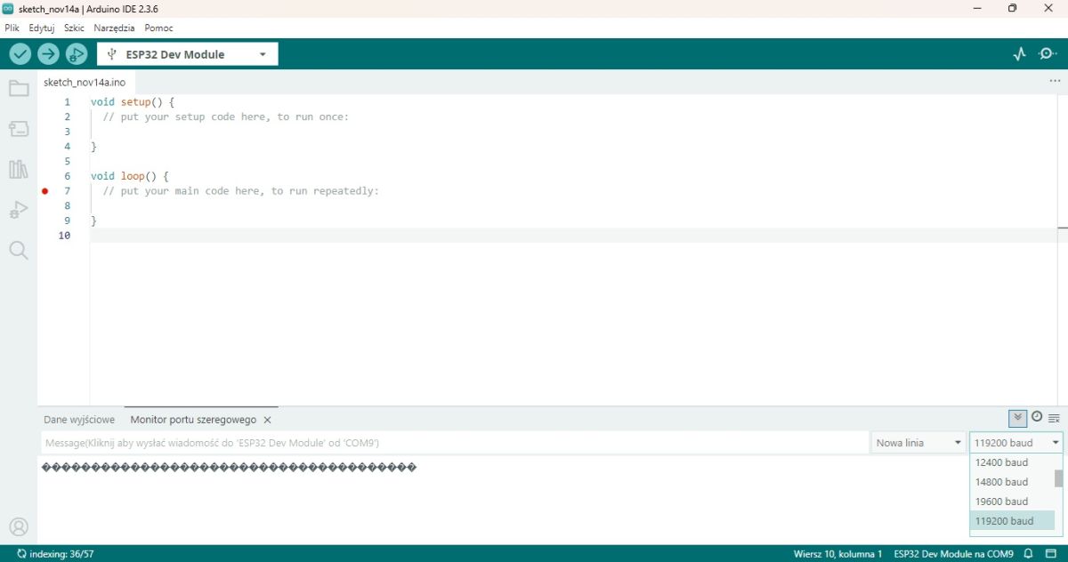

    I have a problem with the Arduino IDE and the ESP32 ESP-WROOM-32U. In arduino IDE 2.3.6 and win11, I do not have the option to select the baud rate of the serial port ANI 9600 or 115200 from the expanded list. There are no such values in the list.

    This is impossible. Show what it looks like.

    This is what it looks like
    Arduino IDE interface with garbled characters in serial monitor I asked AI and he says it's not possible! And yet.

    Start by setting 9600 baud. You can see that the microcontroller is sending something, only the speed doesn't match.

    Not on the list.

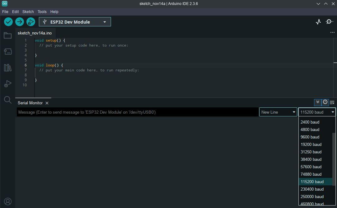

    I own the same version and with me it is on the list.

    But what am I doing wrong that it's not there with me.

    And what is the lowest value on the list?

    1300 - 1600 - 1750 - 11200 - 1480 - 19600 ----- etc much the highest is 12000000 Previously I also wrote about win7 I ESP maybe you know something about it
    Something is not right here (namely that 1 in front).
    If you ignore it, the correct values are: 300 - 600 - 750 - 1200 - 4800 - 9600

    I suggest installing this version of Arduino again, as something has gone wrong.

    A colleague has made a good suggestion. I have the same problem and it turns out that you simply have to ignore the first digit in the speed setting in the port monitor. So for example for the speed "Serial.begin(115200)" we set 1115200 in the monitor and everything works ;)

    unfortunately setting 1115200 does not do anything i have bushes in the read.

    But "Serial.begin" are you set to 115200?
    I have "Serial.begin(115200)" and 1115200 in the monitor and it laughs without any problems on the ESP32 S3.
