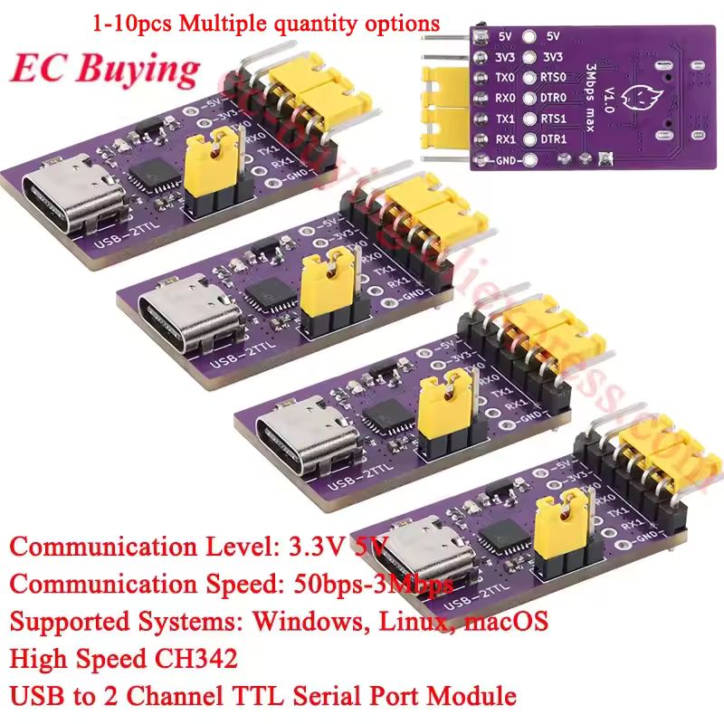

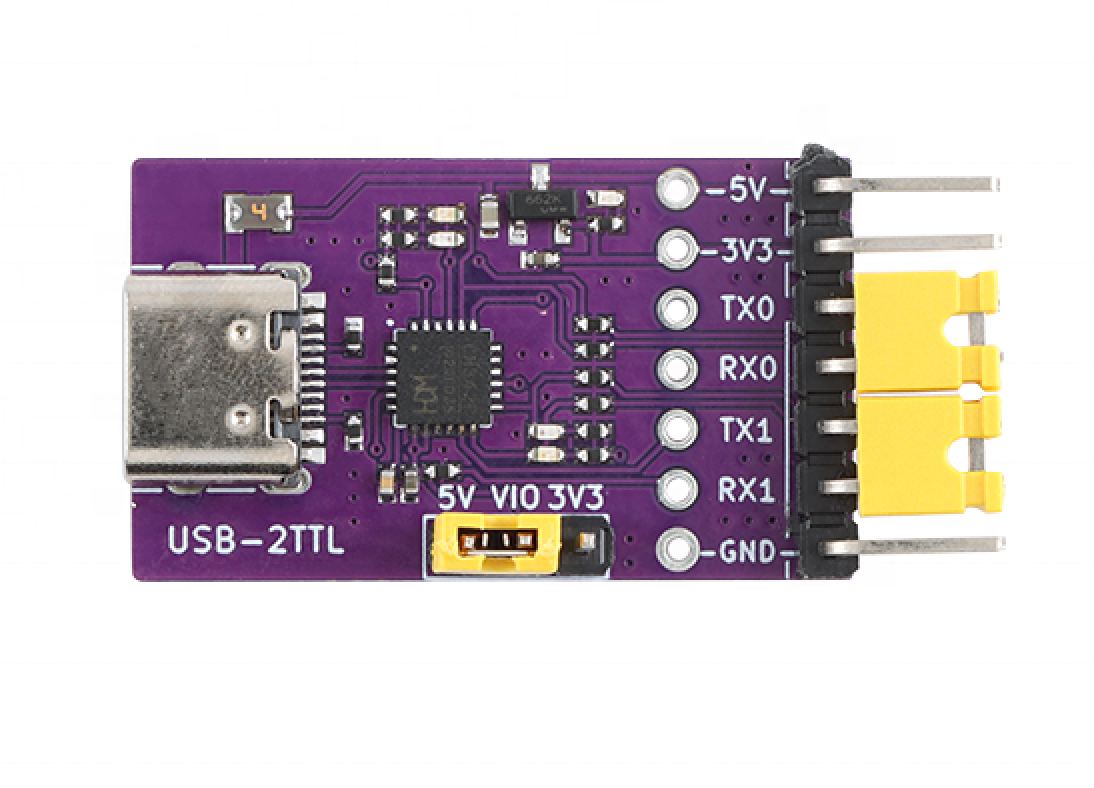

  • A CH342-based USB-2TTL adapter provides one USB connector, two UART outputs, and broken-out DTR/RTS lines for reset and bootloader control.
  • It uses the CH342 in tiny QFN24 (CH342F) or ESSOP-10 (CH342K) packages with minimal external components and selectable 3.3 V or 5 V logic levels.
  • The module sells for about a dozen zloty and uses a modern USB-C connector.
  • Windows immediately detected COM4 and COM7, but the board’s 3.3 V output could not power BK7231 without an external LDO.
📢 Listen (AI voice):
  • USB-C to dual UART converter board with CH342 chip on a purple PCB
    Here's something I've needed for a long time - a dual USB to UART converter, i.e. one USB connector and two serial ports on the output, and this together with the DTR/RTS flow control signals brought out, which can be used, for example, to reset and control the bootloader mode of external devices. The whole thing can be bought for about a dozen zloty, the price depends on the quantity imported and the online shop chosen.
    CH342 USB-C to dual UART modules with DTR/RTS pins and 3.3 V/5 V support
    Like the well-known CH340, this chip gives us a choice between 3.3 V and 5 V logic levels. Also in an analogous way, it has one rather serious shortcoming, namely that it cannot provide a sufficiently large current from its 3.3 V pins for many applications, so if we want to run some Wi-Fi modules with it such as the ESP8266, ESP32 or there BK7231, we need to arm ourselves with an external chip with a 3.3 V LDO, such as the AMS1117-3.3 for example.

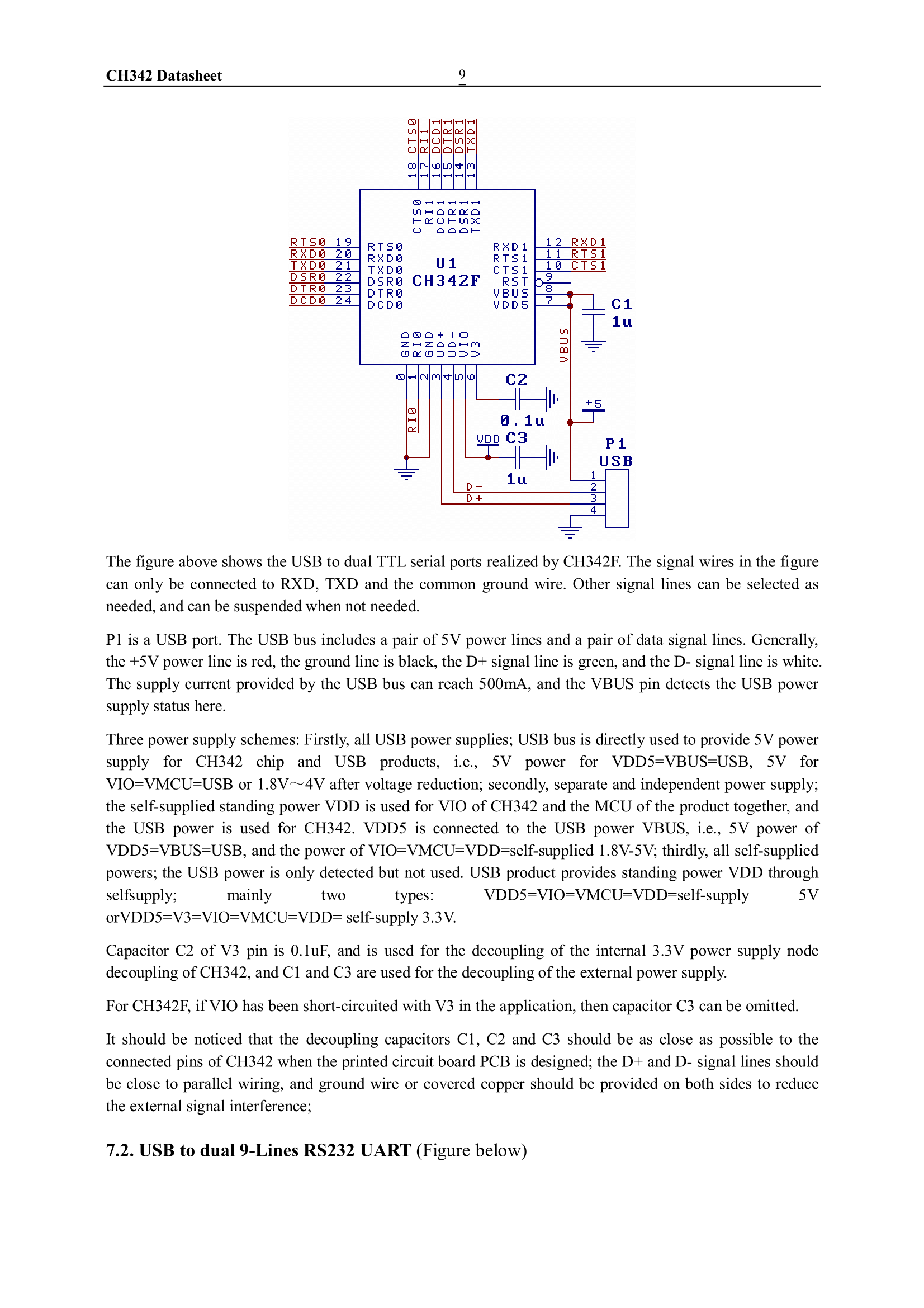

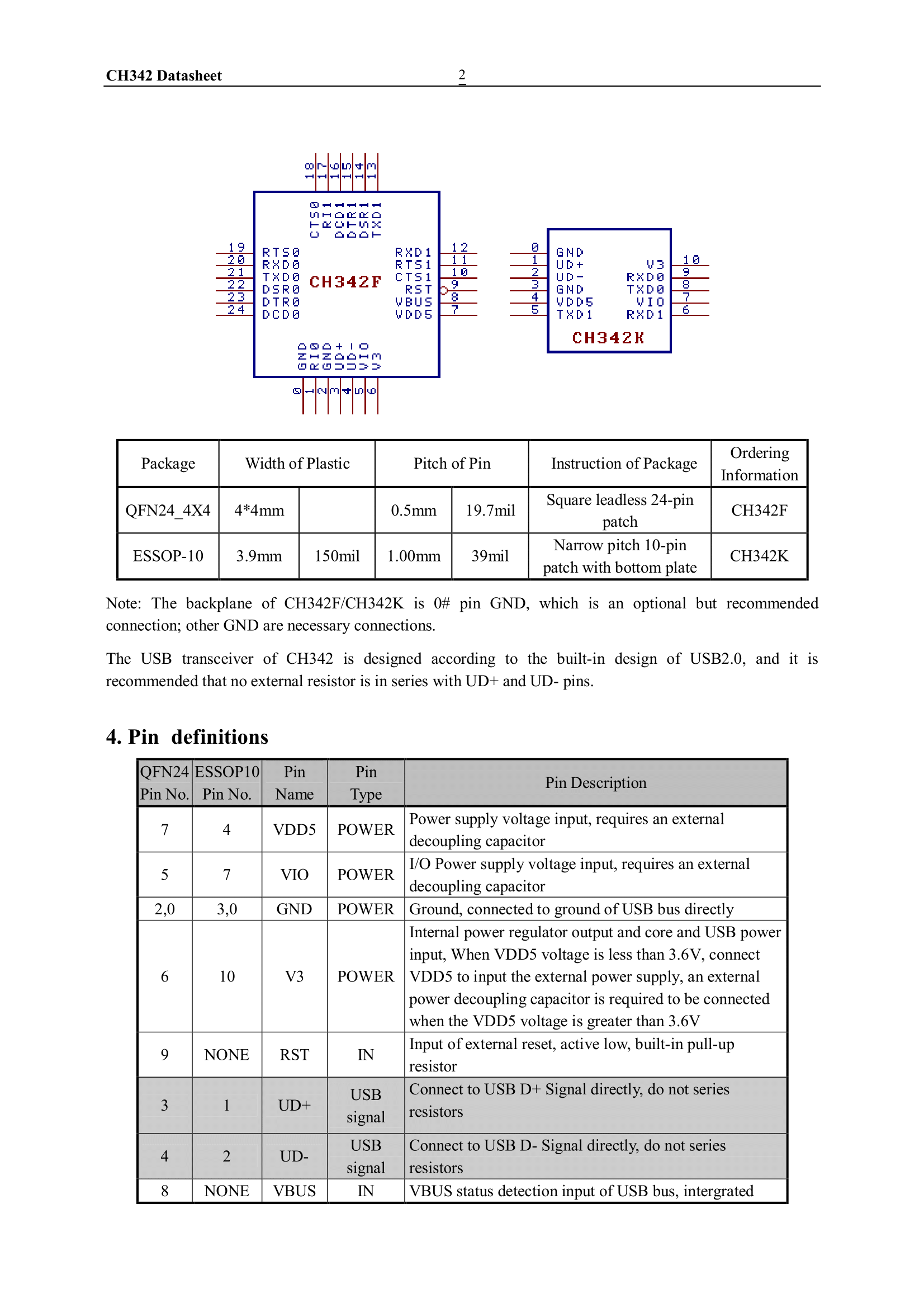

    The CH342 itself is available in tiny housings such as QFN24 (CH342F) and ESSOP-10 (CH342K). The CH342 requires minimal external components to operate.
    Block diagram of the CH342 chip showing USB to dual UART conversion Pin diagrams of CH342F and CH342K chips with detailed pin definition table Block diagram of CH342F with USB interface, dual UART, and filtering capacitors

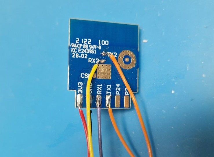

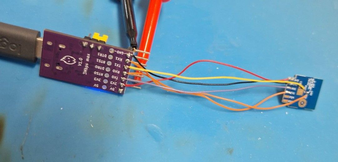

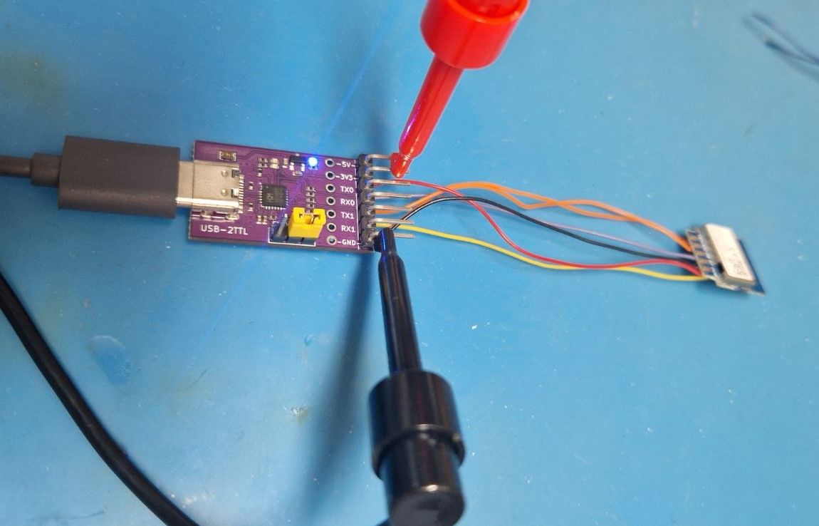

    The main motivation and 'battle test' for this module was to use it to work with BK7231 , as this chip has two UART ports that are both actively used during firmware development - one is used to display the device activity log and the other for programming. Here are the pictures from colleague @DeDaMrAz :
    Electronic module with 3V3, RX1, TX1, RX2 pins and soldered colored wires
    Unfortunately, however, it was not possible to make the absolute minimum connection, as the Beken would not start without an external 3.3 V supply:
    CH342 USB-C module with wires connected to a peripheral device on a blue mat
    USB-2TTL CH342 module connected to device using multicolored wires
    Looks like we're in for an additional 3.3 V LDO hand-soldering to the underside of the board shown. How about finding a module with CH342 and AMS1117-3.3? That would be the best option.

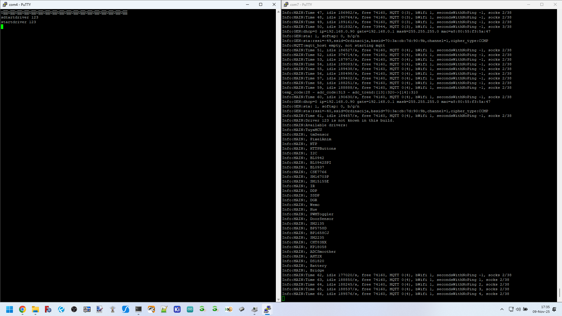

    In any case, the UART works fine - the computer immediately sees the COM ports, here for example COM4 and COM7 and we can operate them via Realterm:
    Two PuTTY windows showing active communication on COM4 and COM7 ports

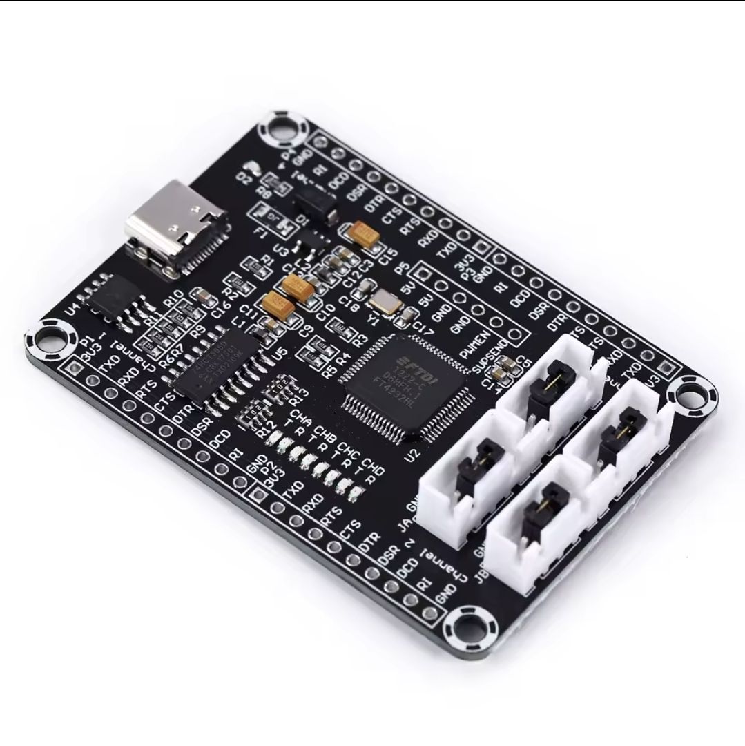

    There is also the FTDI4232
    About this toto. I was just about to write about it - majfriends also have a ready-made one, e.g:
    https://pl.aliexpress.com/item/1005003624740507.html
    The chip itself is sitting on my desk, the FE1.1S expander is still waiting for it - the idea was rather interesting - to make a compatible PCB under Atmel ICE + just FT4232 (I have one of the devices that requires as many as 3 UART ports for full operation).
    At a quick glance I see quite a few ready-made, multi-UART (4-8 channels) devices on Ali:
    https://pl.aliexpress.com/item/1005005750870625.html
    https://pl.aliexpress.com/item/1005007928356683.html

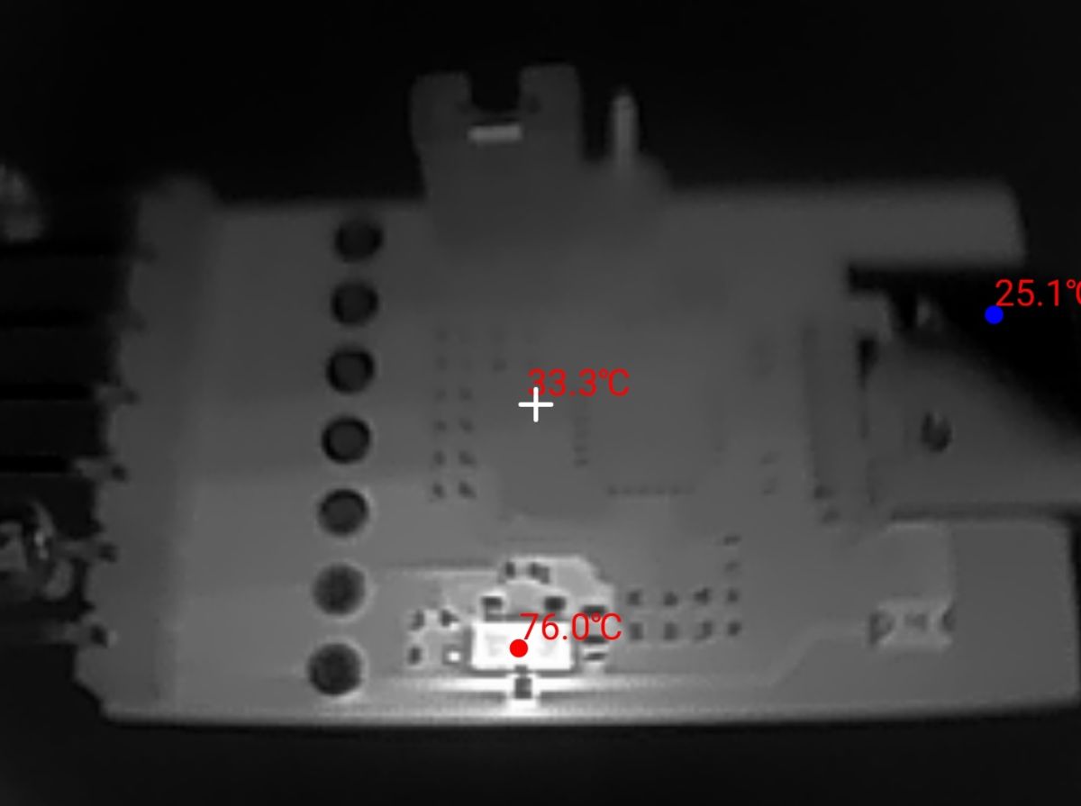

  • XC6206 LDO identified and load tested at 250 mA
    #11 21750330
    Posts: 14743
    Rate: 12839

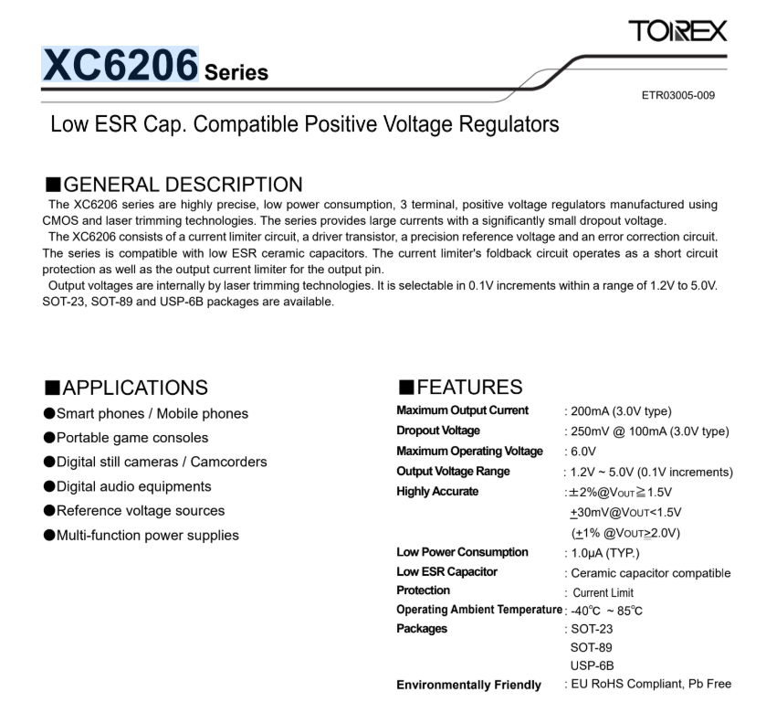

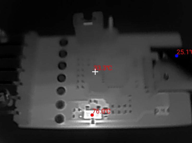

    I will try to check what you have written about.
    @ElektroMusician - then there are two COM ports visible, as in the subject content and in the screenshots.
    I think this LDO from the board is an XC6206.
    Extract of Torex XC6206 voltage regulator datasheet
    Loaded with 250 mA (just over specifications) after about 15 seconds:
    Thermal image of a PCB showing 76.0°C in the lower area under load

    As others have mentioned here there are also 4 channel adapters for the FT4232.
    I was recently building a reader for my own use and was looking for some usb <-> 4x serial port adapter and bought one like the one in the picture from a Chinese guy. It has as many signals out for each port 😊
    USB to 4x UART module with FT4232 chip and micro USB connector
